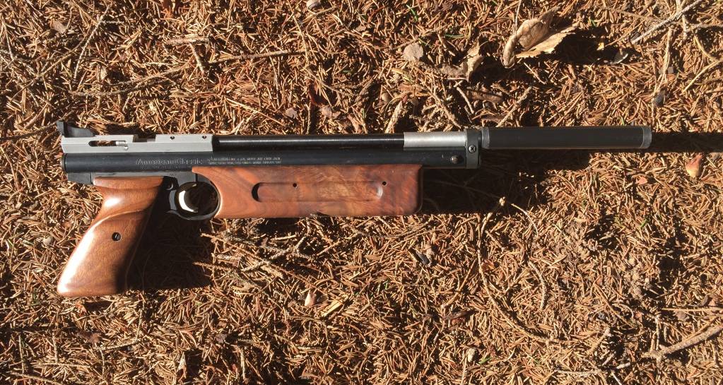

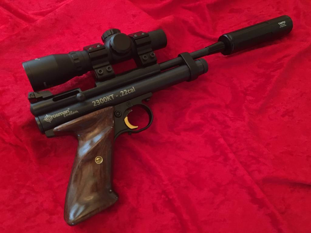

Was wanting to carve some grips to finish this one off but Ron Robinson listed some of RB's work recently and saved me the trouble...at least for now. Thanks Ron! I may refine the shape of the forearm...and scrounge up a red dot....and do some performance mods... but it's getting close. really.... 😃

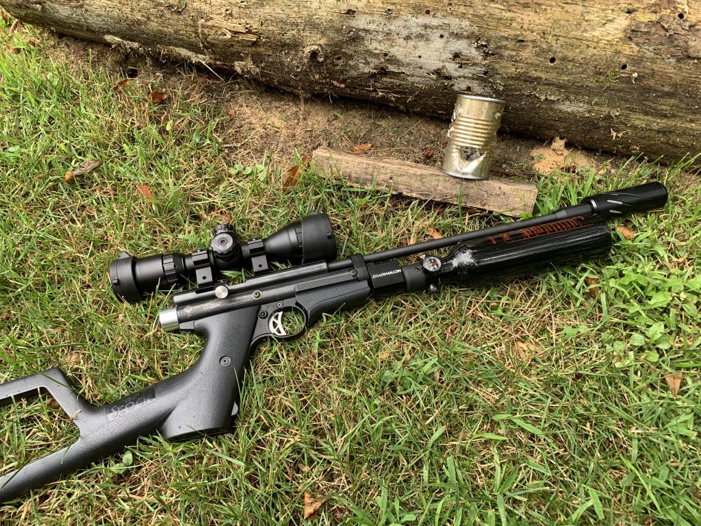

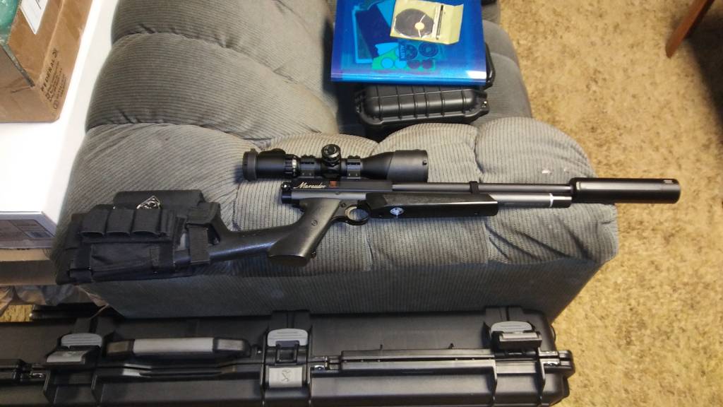

Sometimes we forget just how good of a gun we built years ago because we move on to other guns. It’s raining today so I decided to shoot some stuff that I haven’t shot in a while. I shot a hole in the can and then shot 5 more at the hole. That’s not bad at 50 yards with an ergonomically incorrect gun. Wonder what this thing would do with a good scope.

Looks like you did every imaginable mod lol I wouldn’t be surprised if you had a 2 stage trigger in there.
With a good scope, I think it wouldn’t be to far behind some of your more refined guns
*where'd you get that cool looking trigger

I ordered some stuff from someone and he threw that trigger in a bag. I never used it because I was using a Prod lower and hammer. One day I decided to see what setup performed better so I put the 2240 hammer and lower back on. The 2240 stuff performed better but the trigger wasn’t quite as nice. I remembered that skeleton trigger so I dug out and installed it. Had to drill and tap the bottom of the trigger guard but it works nice. It eludes me who I got it from. Maybe a silencer builder guy.

Yup, that trigger is from TKO.

is that a long LW barrel? Where did you get that? Who has the co2 to pcp conversion hardware, looks like a really fun project.

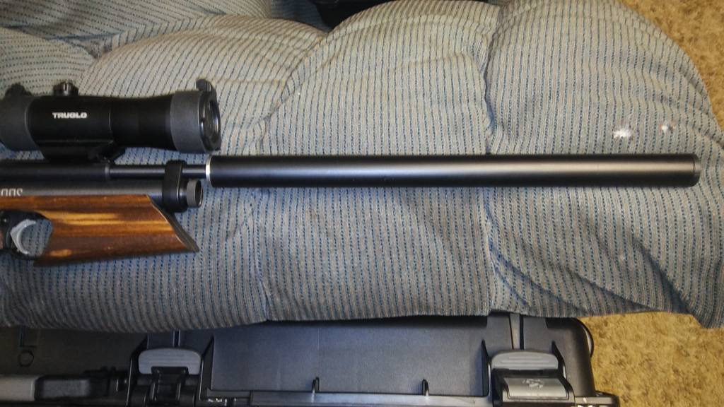

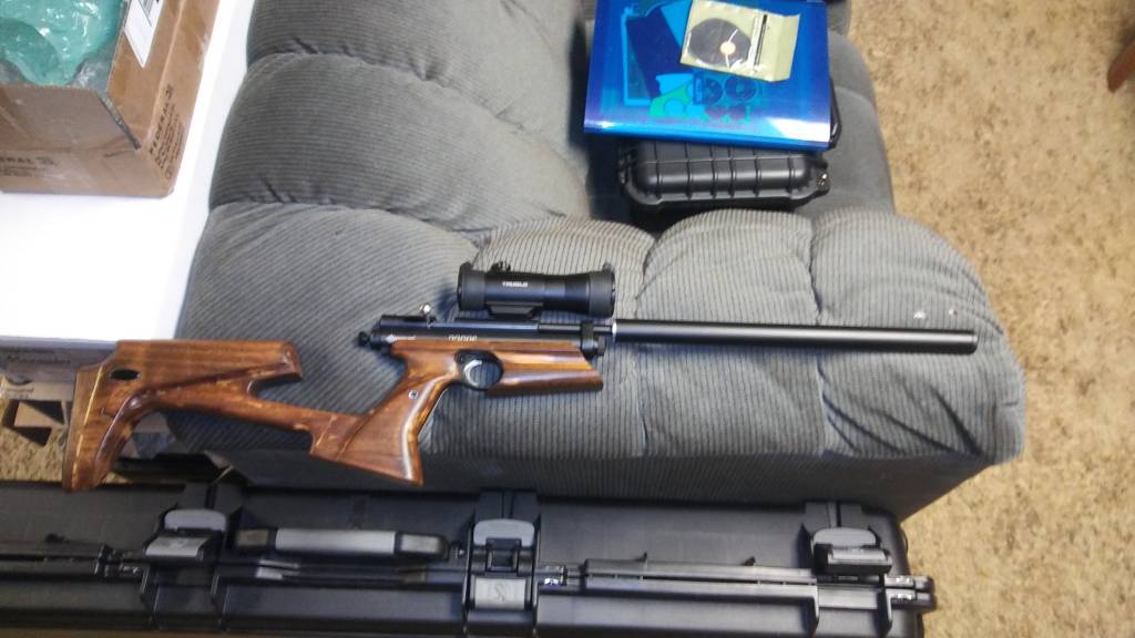

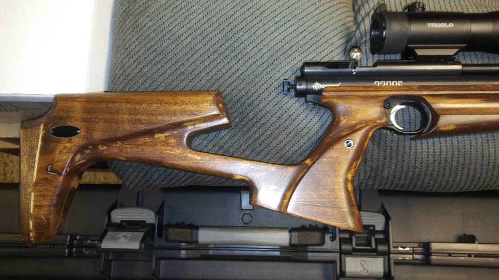

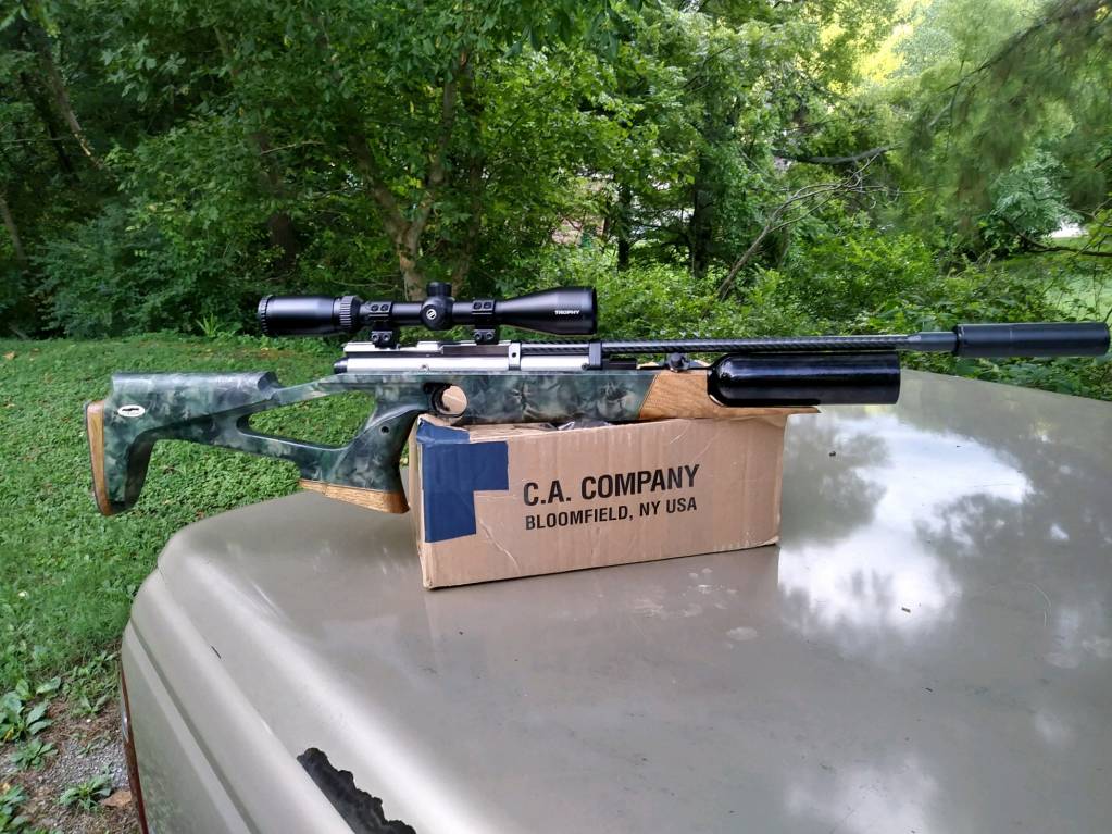

This is the latest rendition of my 2300S. It now is a .22 with a 14.6" crosman barrel, a 2240 valve, modified tom west stock. Red dot has been around forever. I made the shroud/silencer combo. Still have to chrony it to see how it's shooting.
i love that stock , did you cut out a portion? i have been whatching for one to come up for sale, ii have 5 P Rods.. roger

The stock was suppose to fit a 2300. I had to rework the inletting for the barrel band. That was ok for a while but just didnt do it for me. So then I cut off tbe shovel on the forearm. Used to be camo painted, got sick of that real quick. Stripped, sanded, stained and lots of linseed oil.
