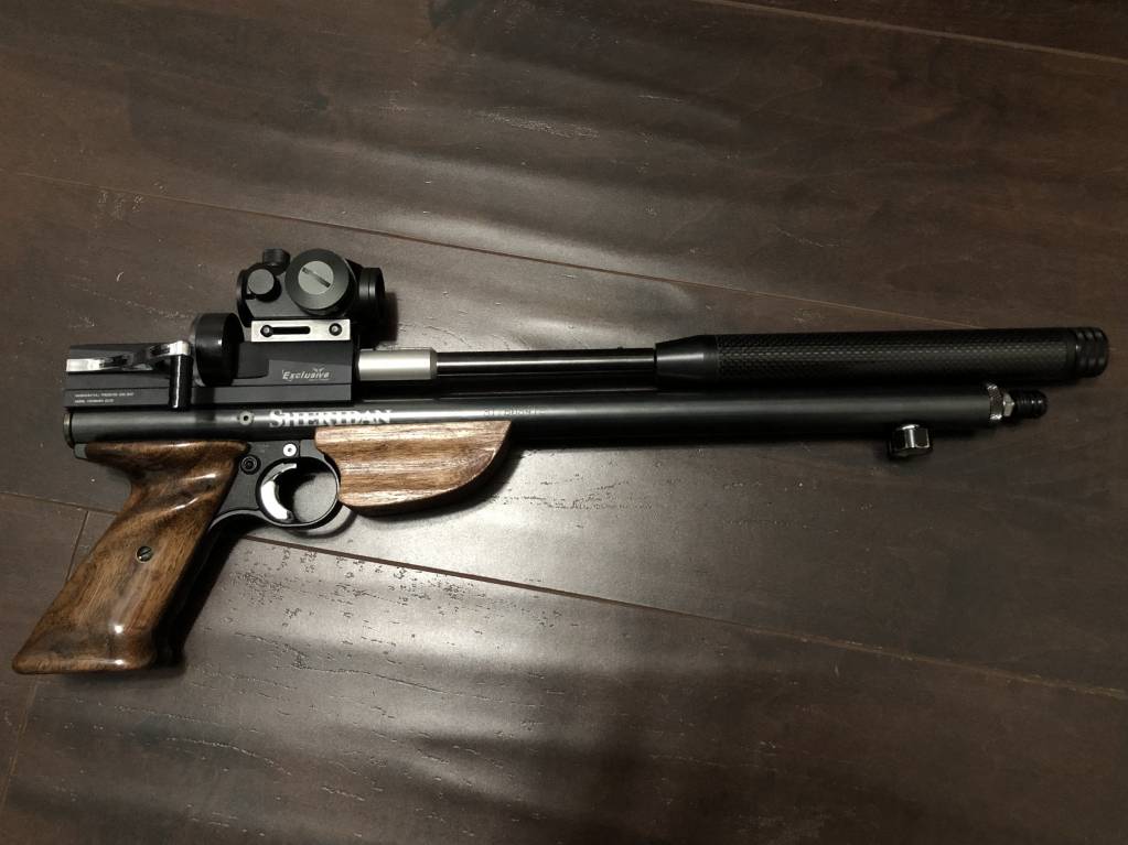

A few of mine

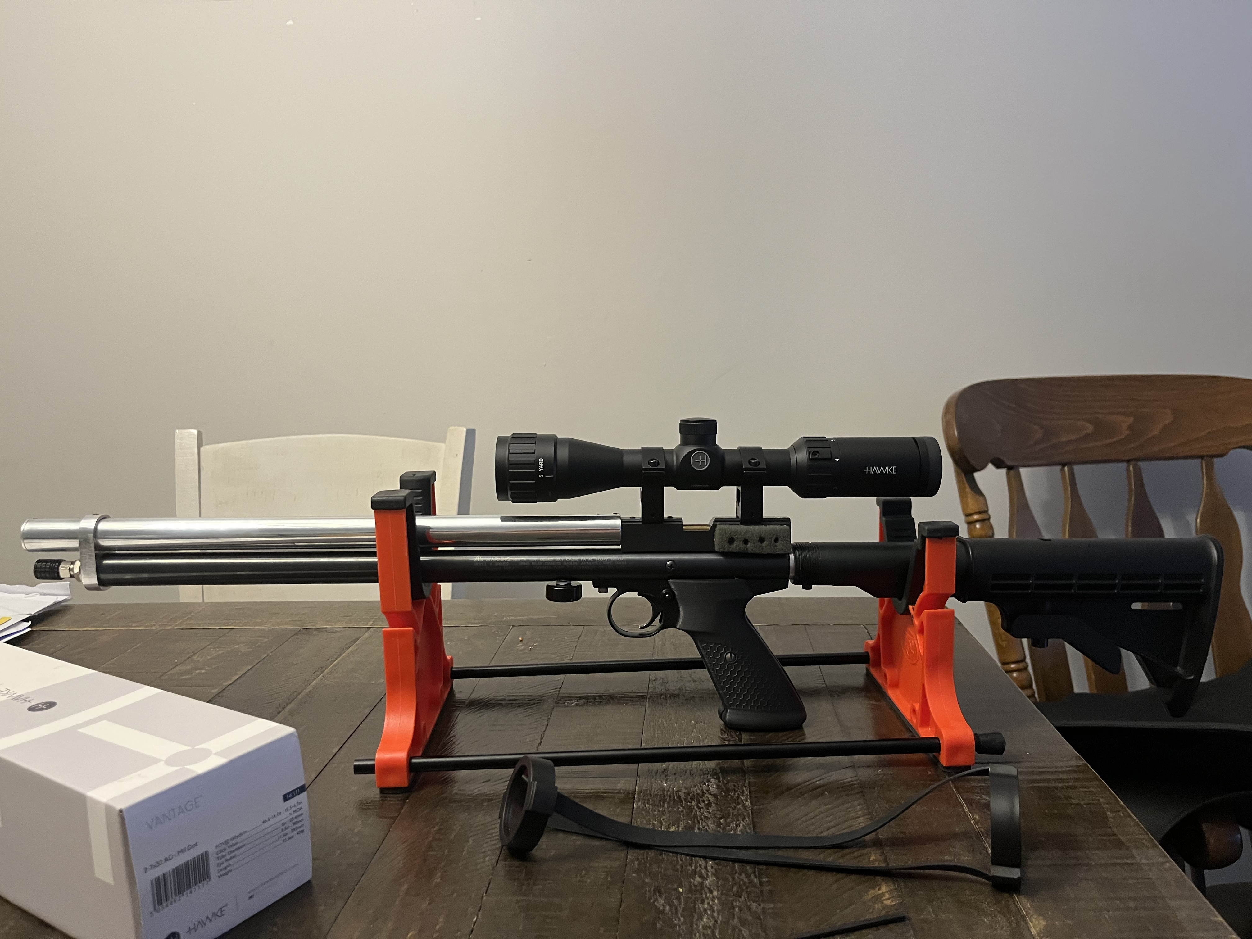

Top is my first 1377. Goal was for a woods walker pumper. Can be broken down to full pistol. Now has a Crosman rear sight.
1377 with folding stock and threaded barrel band.

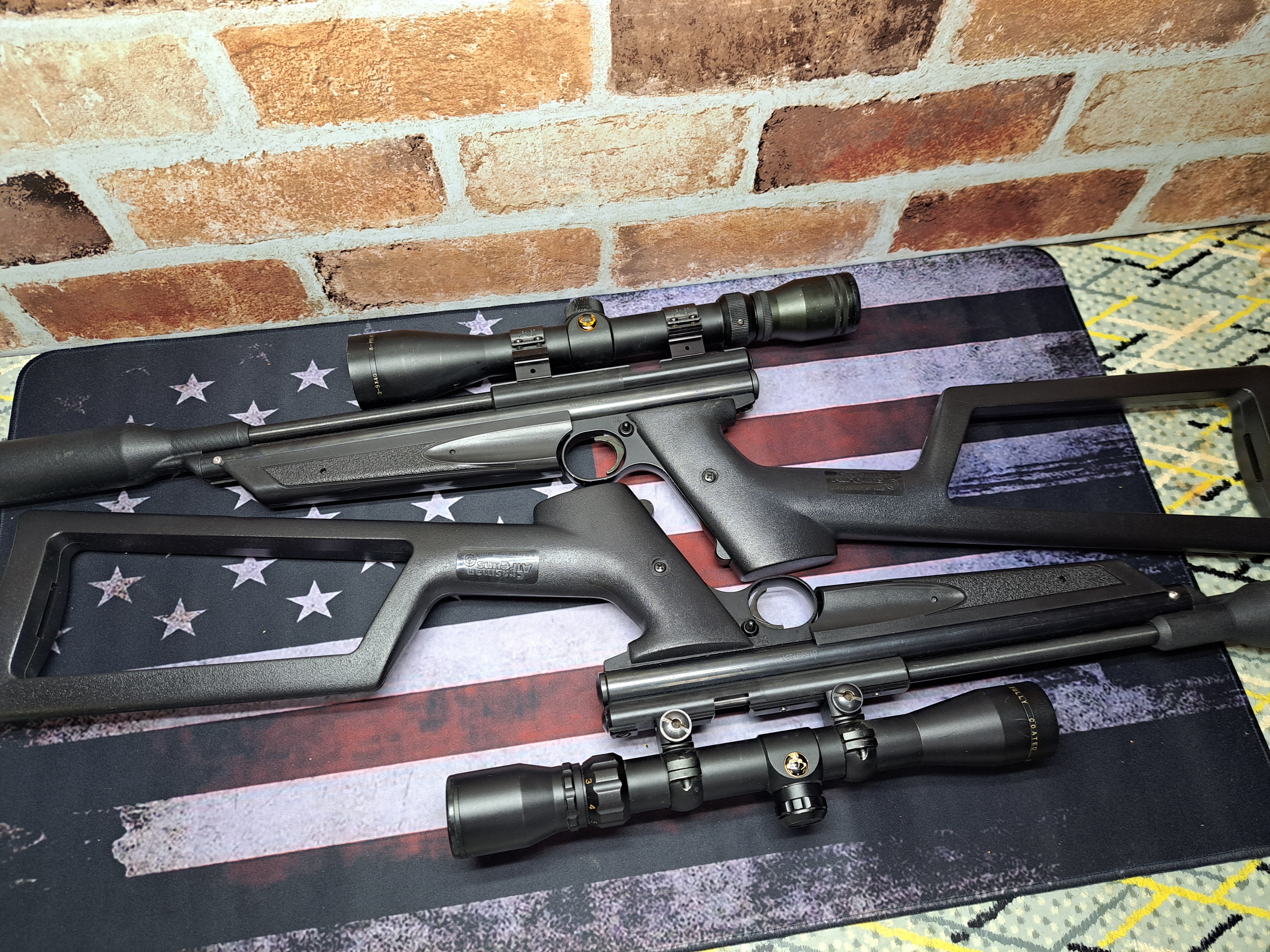

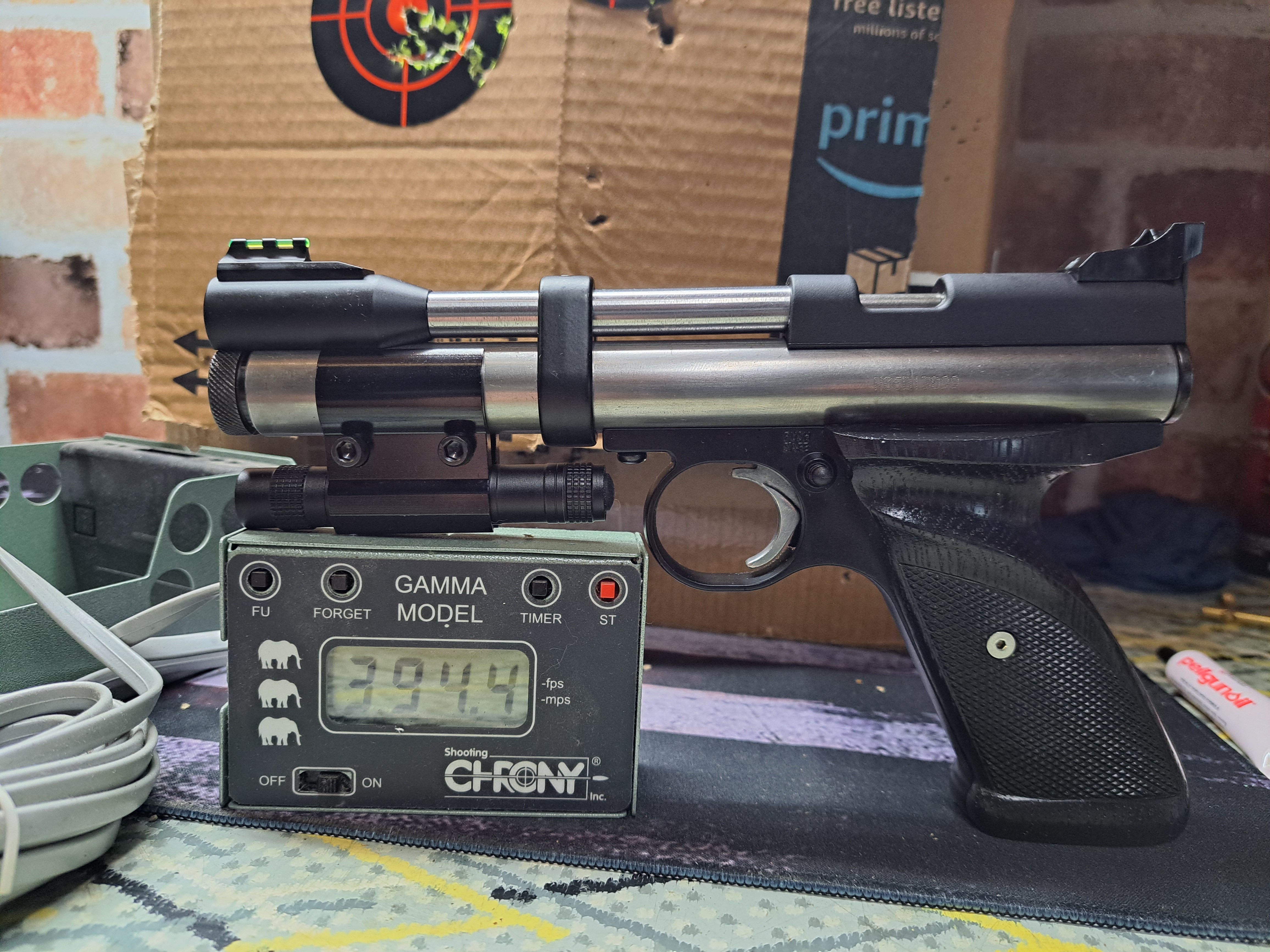

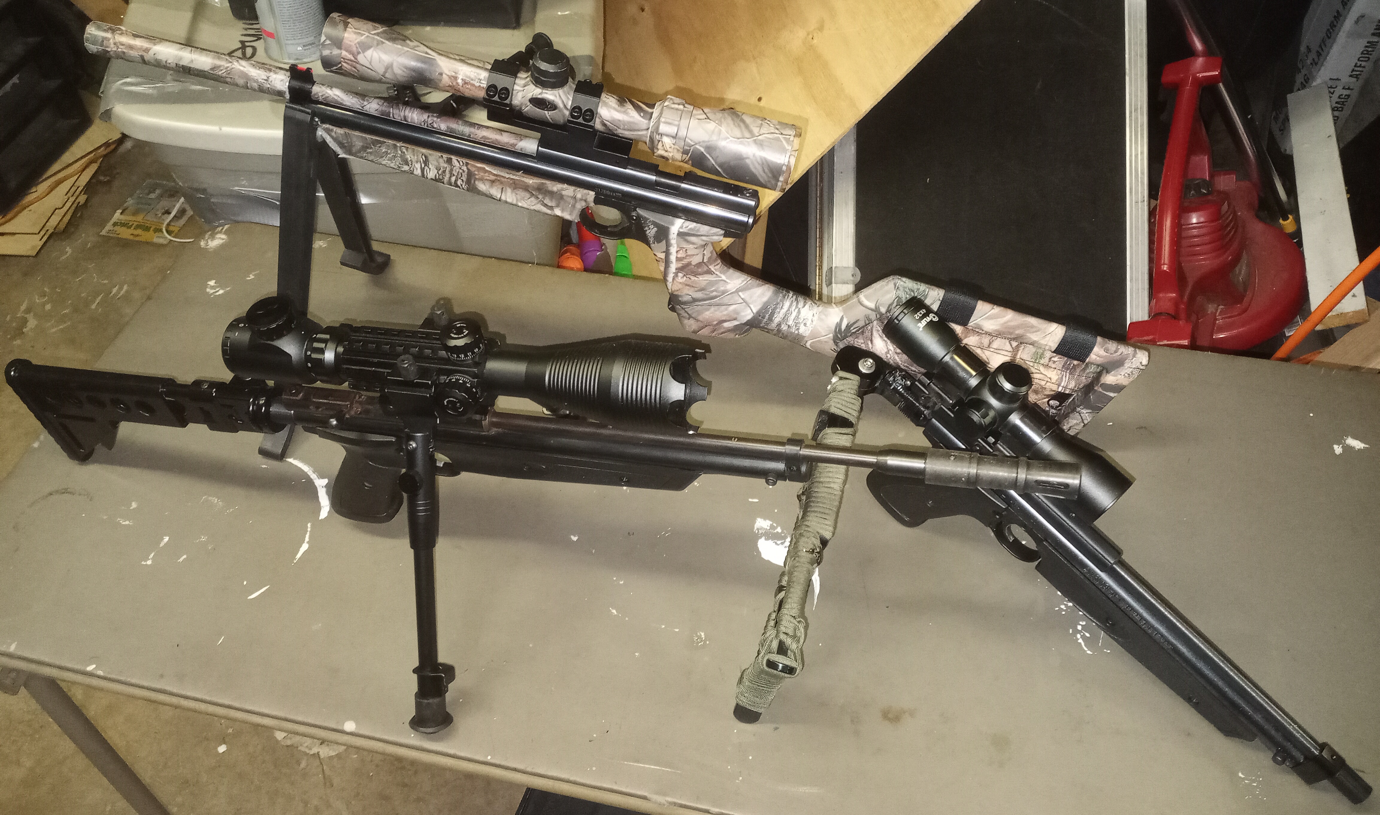

1322 with modified longer Crosman M-4 pump tube, flat top piston 14 inch barrel and folding stock with side mount bipod. View attachment 362583

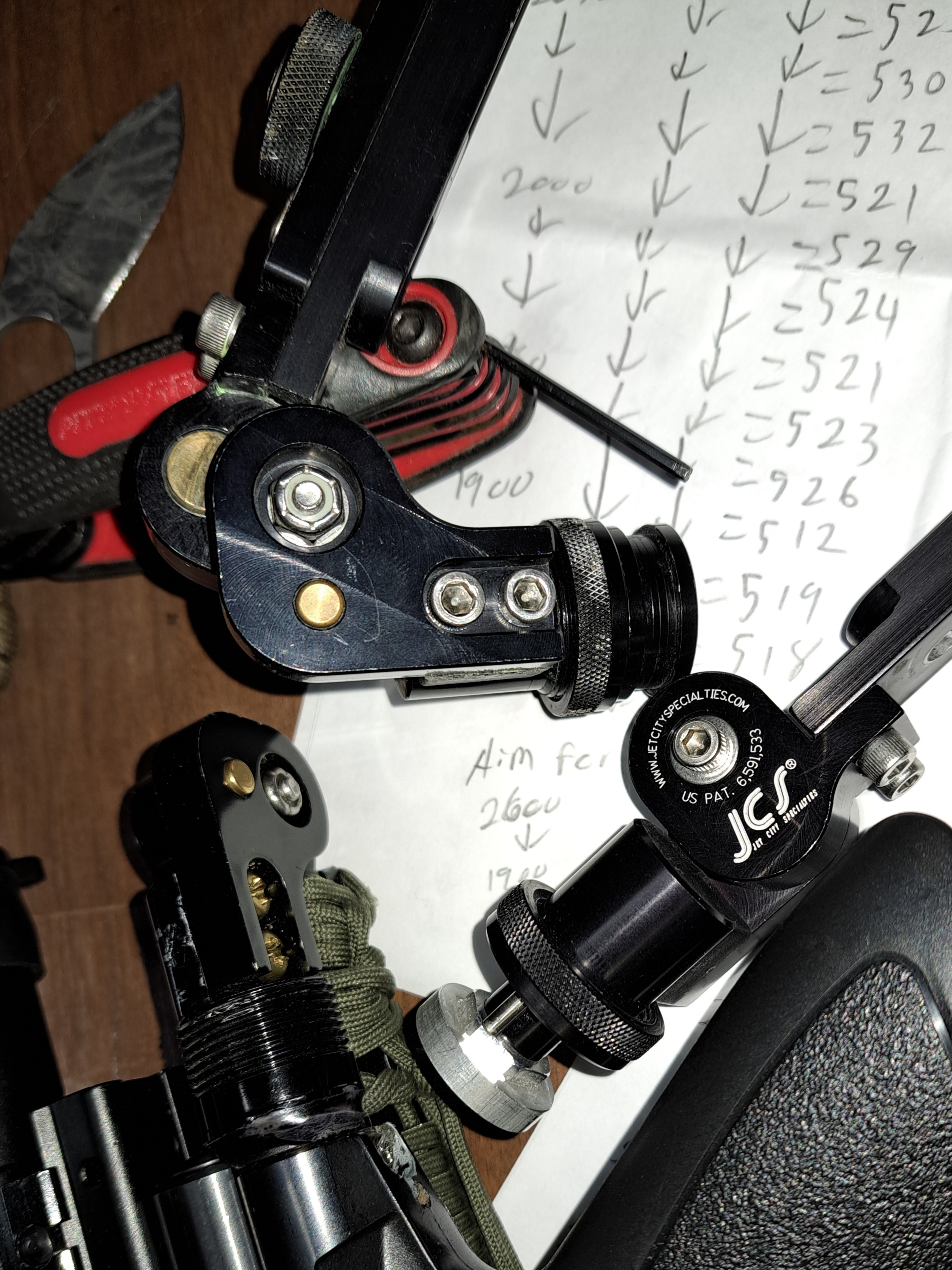

Nice. I'd really like to see some close up pics of that folding stock set up with the paracord on it. Did you make the folding part yourself or buy it from a vendor?
Thanks
Ray

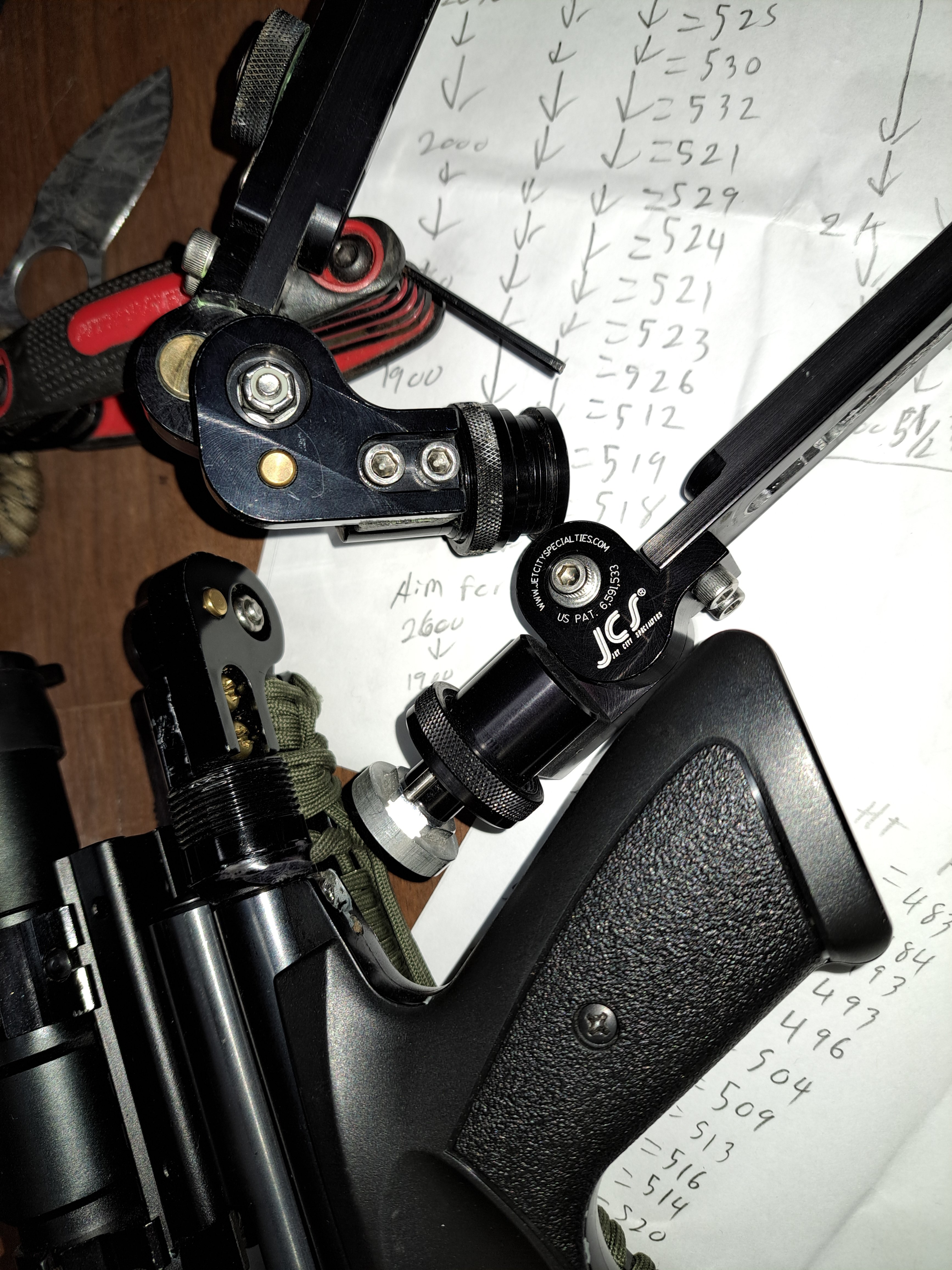

It's a jet city specialties stock for paintball. Push button fold in and out. Lock in both directions. Thumb screw for adjustable pull length. Super light. Picked up a few more and going to do some more builds. That attachment is just a13xx rear end cap drilled and taped for mounting (I didn't mod it). Getting my laith soon and going to build some custom stuff for it to mount better and have a built in valve spring adjuster.
