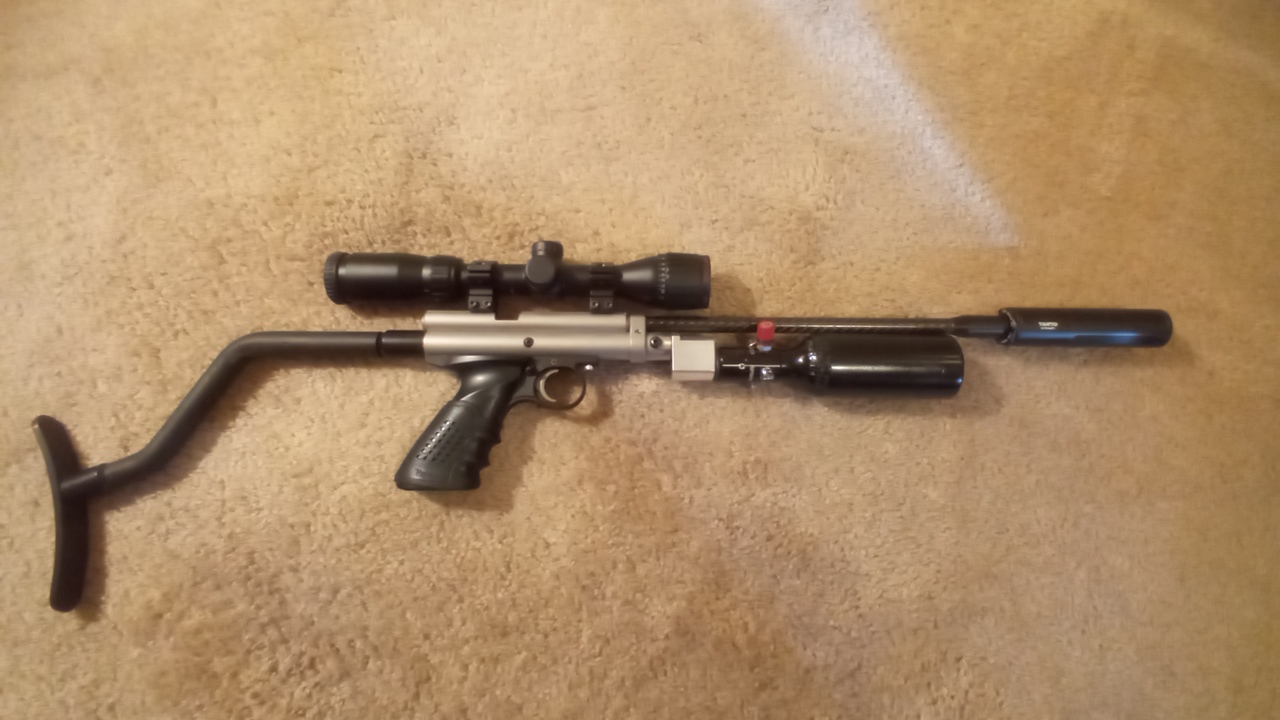

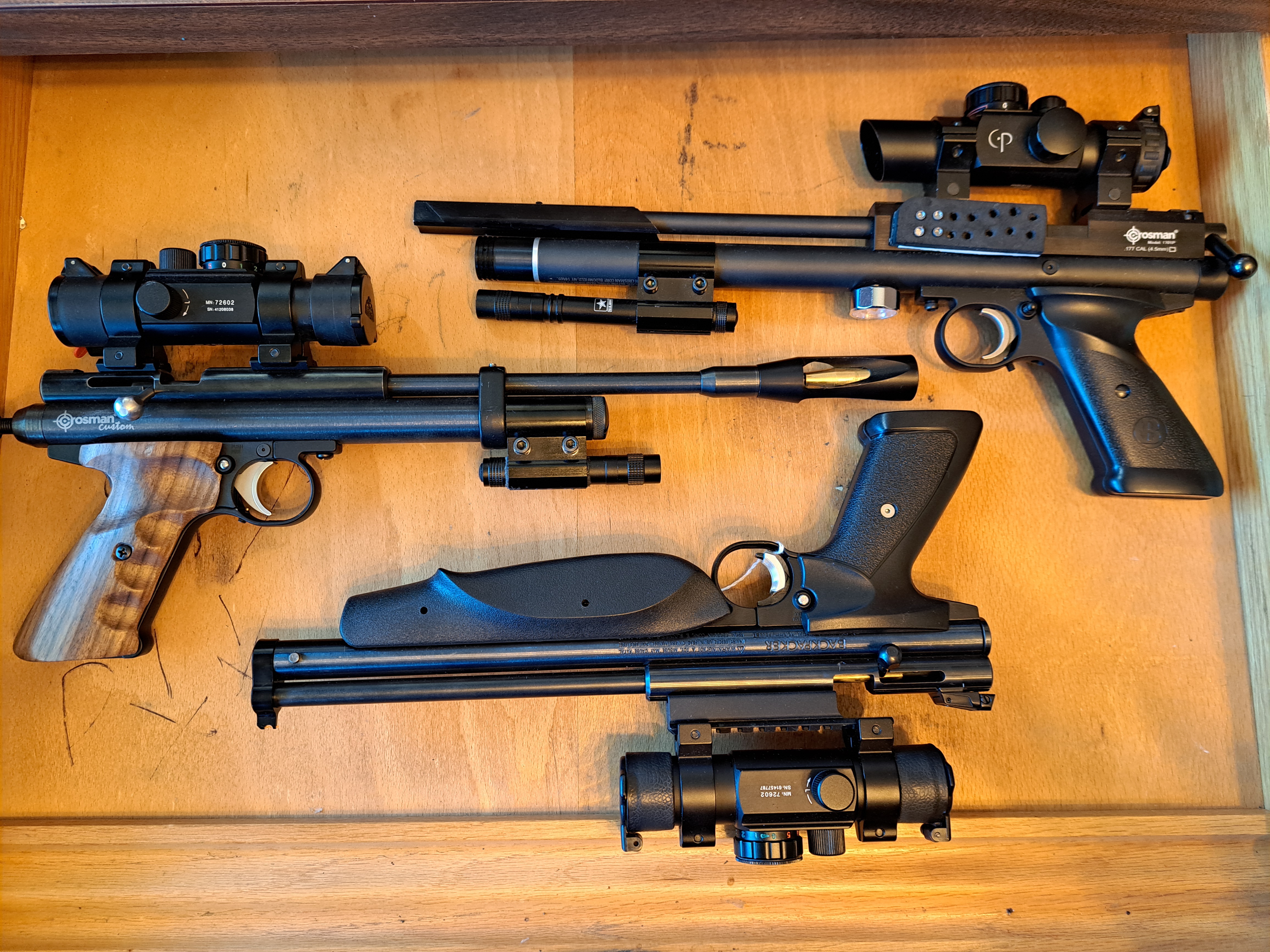

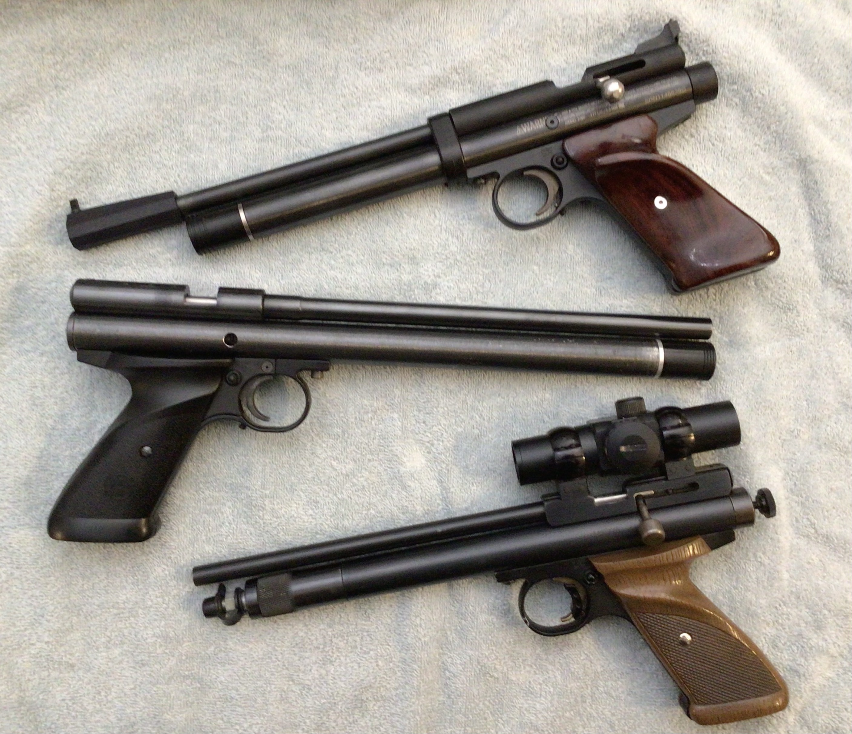

On the bottom is an older 1740 build, using DAQ breech, DAQ bulk adapter and SSP250 barrel, when I was cutting my pcp teeth. Tuned for 10gr pellets at 600fps.
On top - 2400 tube converted to pcp. Shortened Baker lefty breech. 10” LW Barrel. RB grips. Prod trigger, end cap, and hammer. 1701 front site. My valve mods, getting 38 shots at 450fps. I know I coulda just bought a 1701, but why?
In the middle a DAQ 25 cal in progress.

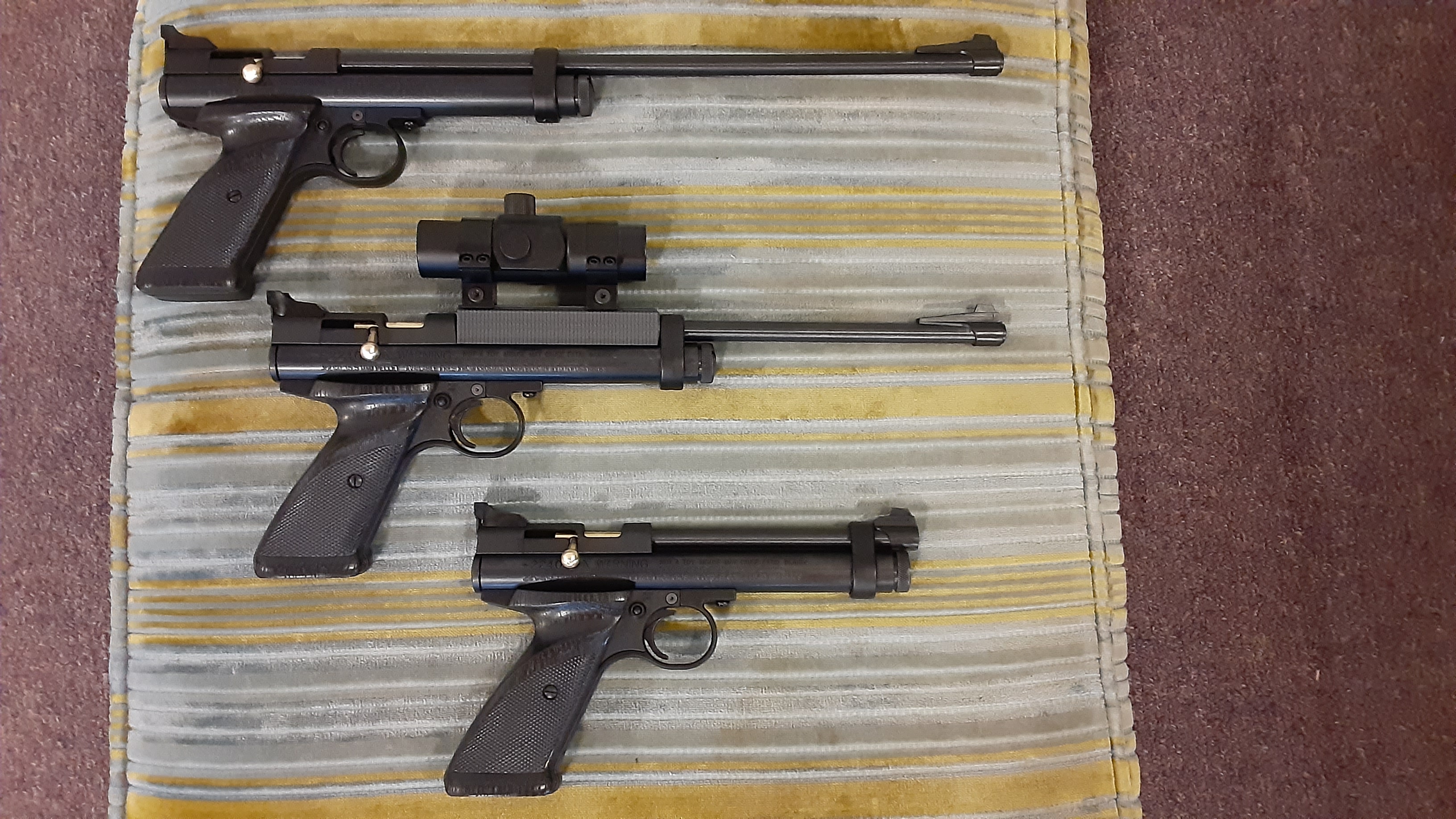

The pcp co2 and pumper hanging out.

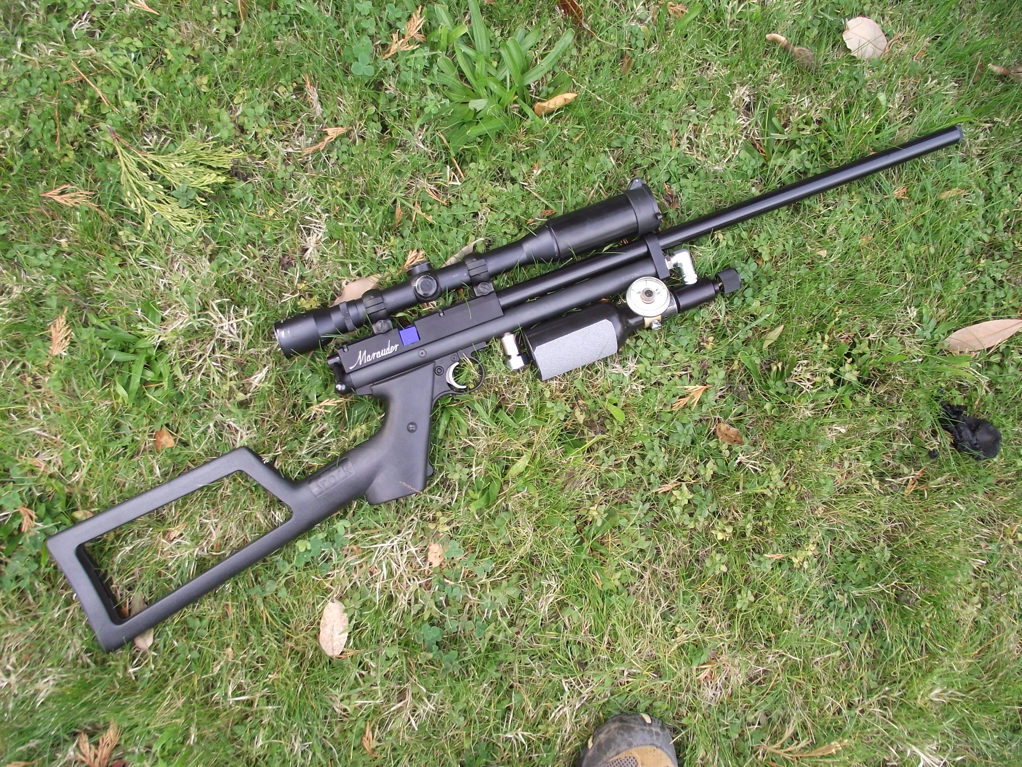

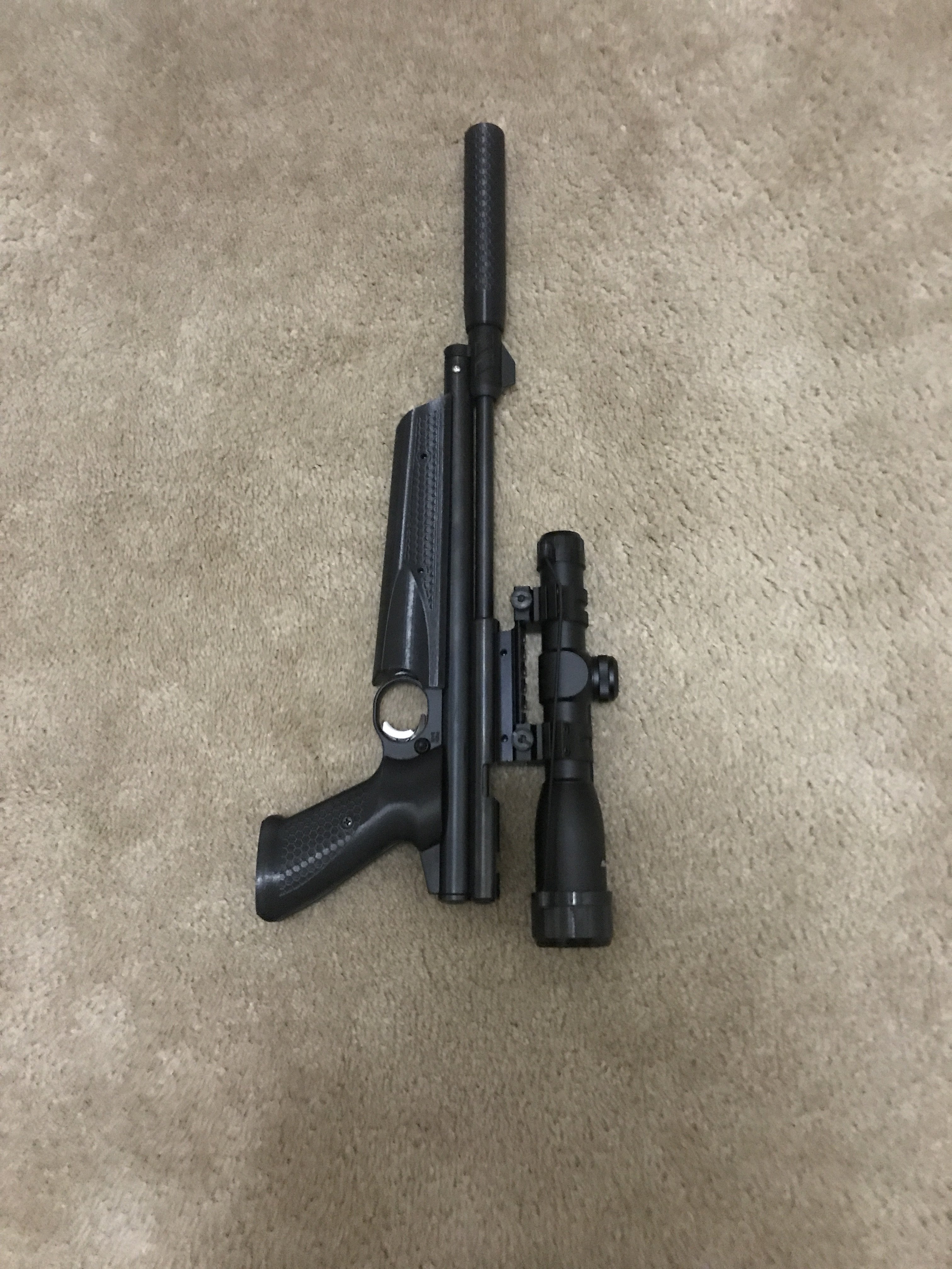

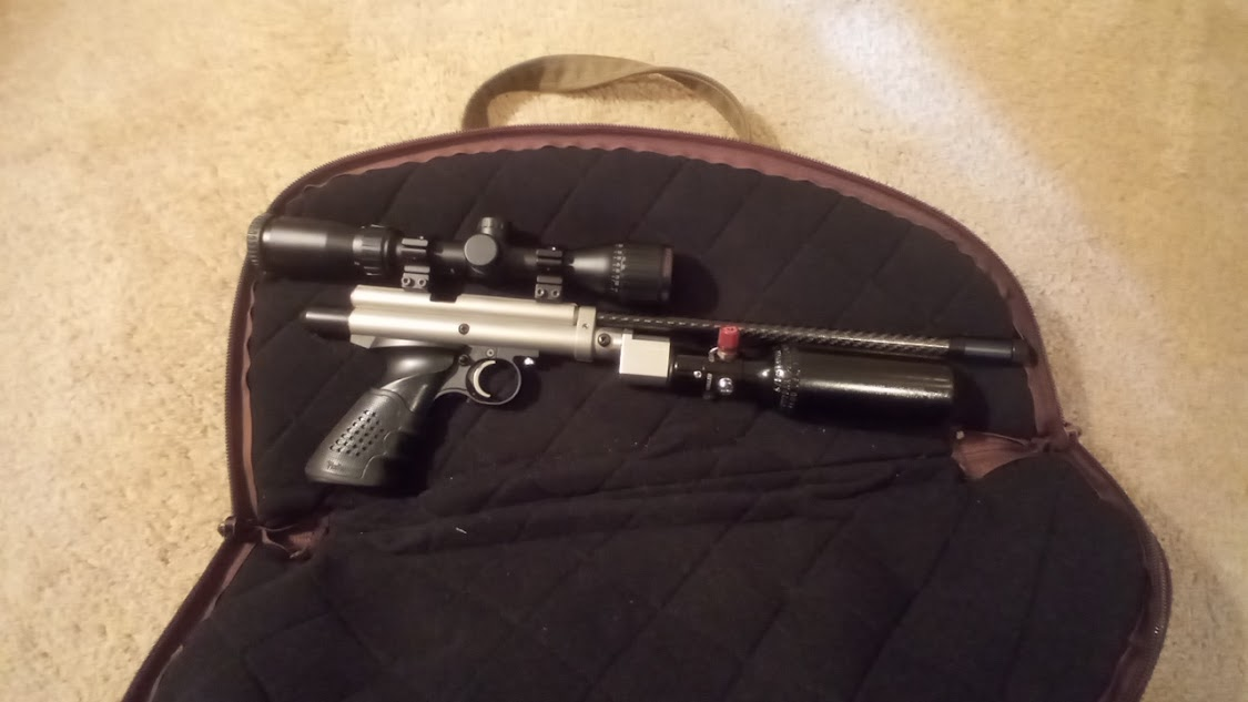

Had forgot about this one ... 1701 tube with a shorty bottle in reverse direction using a 16" .22 cal barrel.
Uses a ninja reg and entire air tube is the plenum.

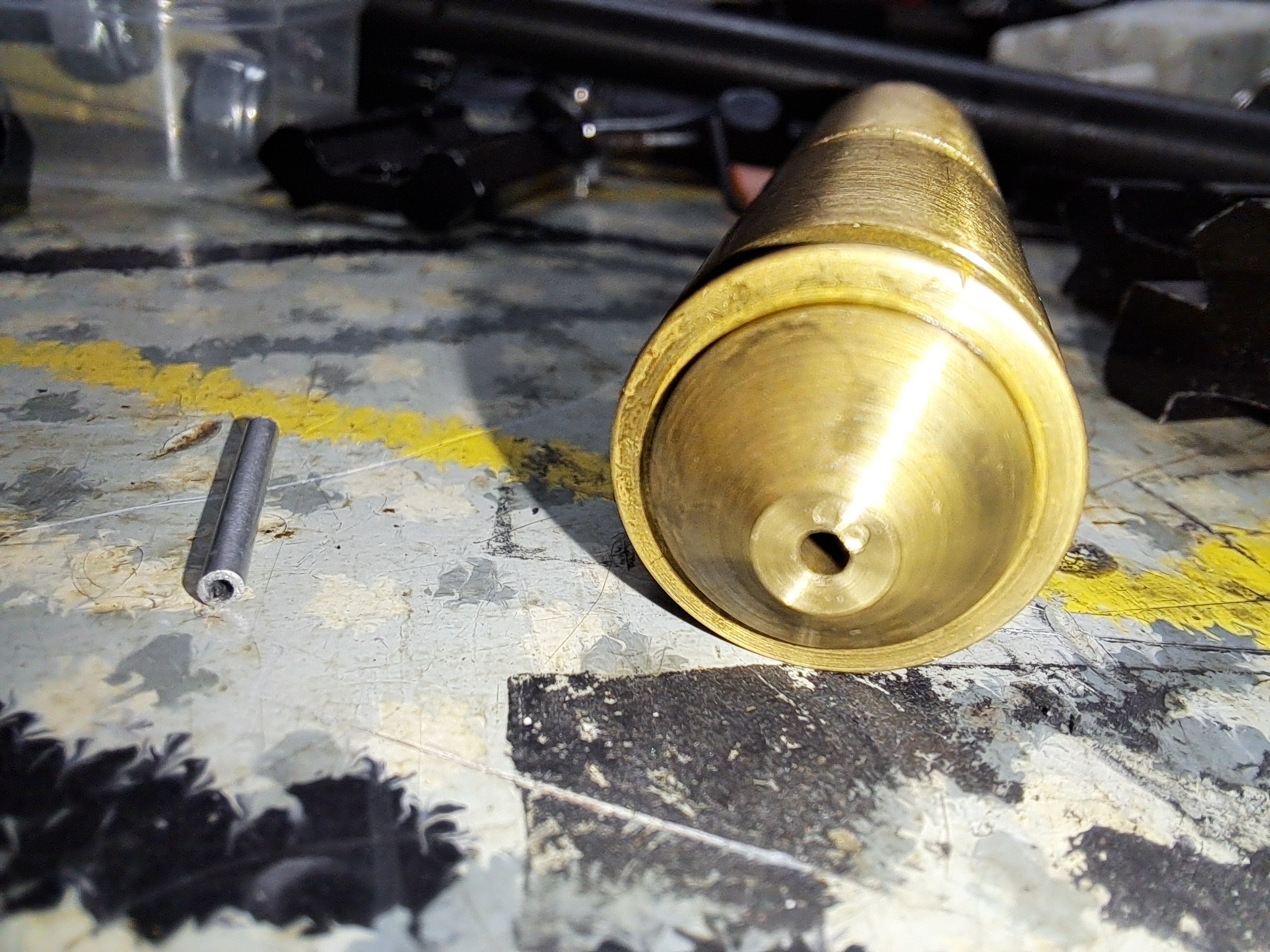

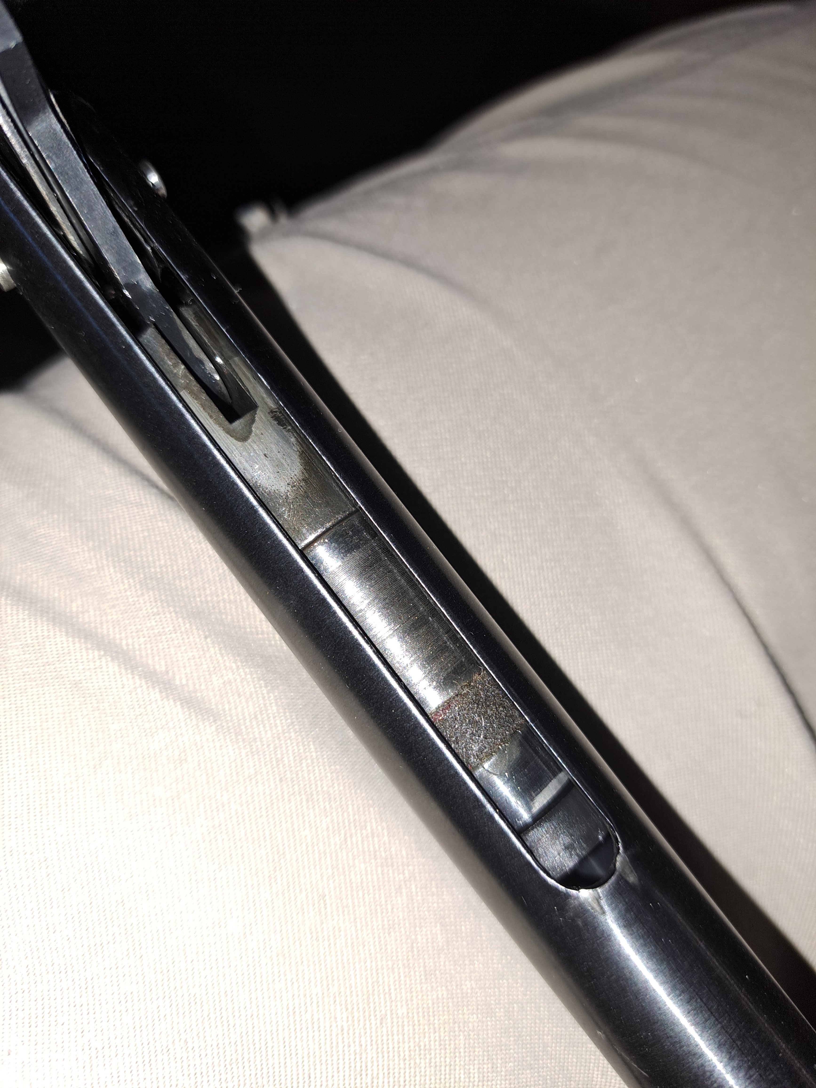

I know I posted this 2289 before, but it's more done than it was before, and needs piston cup shims and will get around to it.
Went from
10 inch .177 (previous builder converted to a LW) to a cut down 14 inch barrel to 12 inch .22
Transfer port barrel port to .157
Angle port valve and opened rear passage arround the poppet to increase flow and increase volume.
Polished the hammer.
Last pistol I built like this with a10 inch barrel did 501fps with 15.49's @12 pumps and could do 556fps with 15.49@16 pumps.
This one has 2 inches and a solid piston with felt wiper over the last build. Idea behind this build was longevity, reliability And just a nice build.
Went from
View attachment 444447View attachment 444448View attachment 444449View attachment 444450View attachment 444451
View attachment 444456View attachment 444464

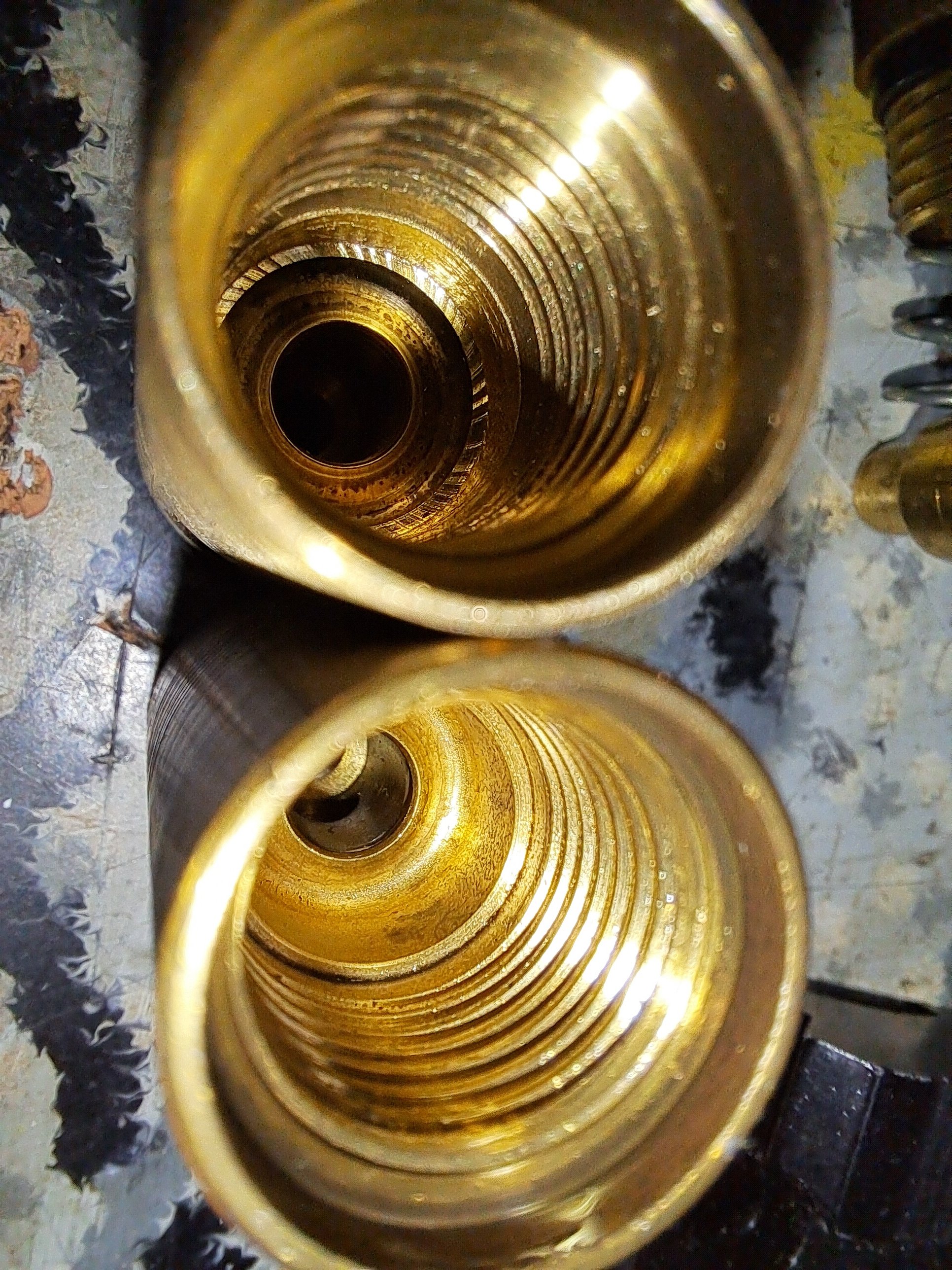

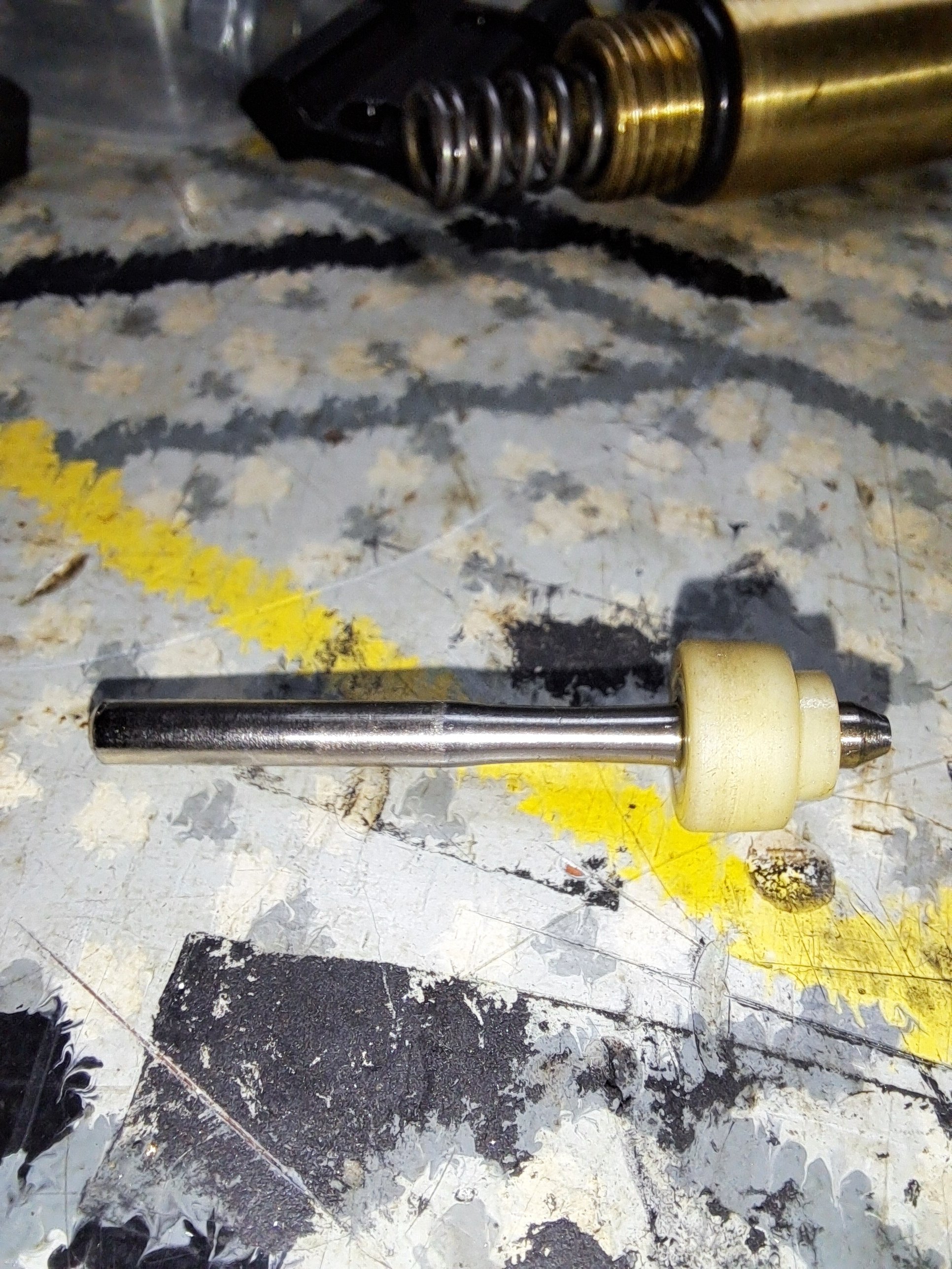

About the brass valve body ... is the modified body the top pic of the two?
Reactions: Bandito
Yes, I read it before in a 392 mod forum where the moder made over 900fps. It increases the volume in the rear and the stored energy (HPA) is near the transfer port making more high pressure air more readily available leading to a faster transfer to the barrel or so the theory goes. My 1477 makes over 1000fps with that mod.
