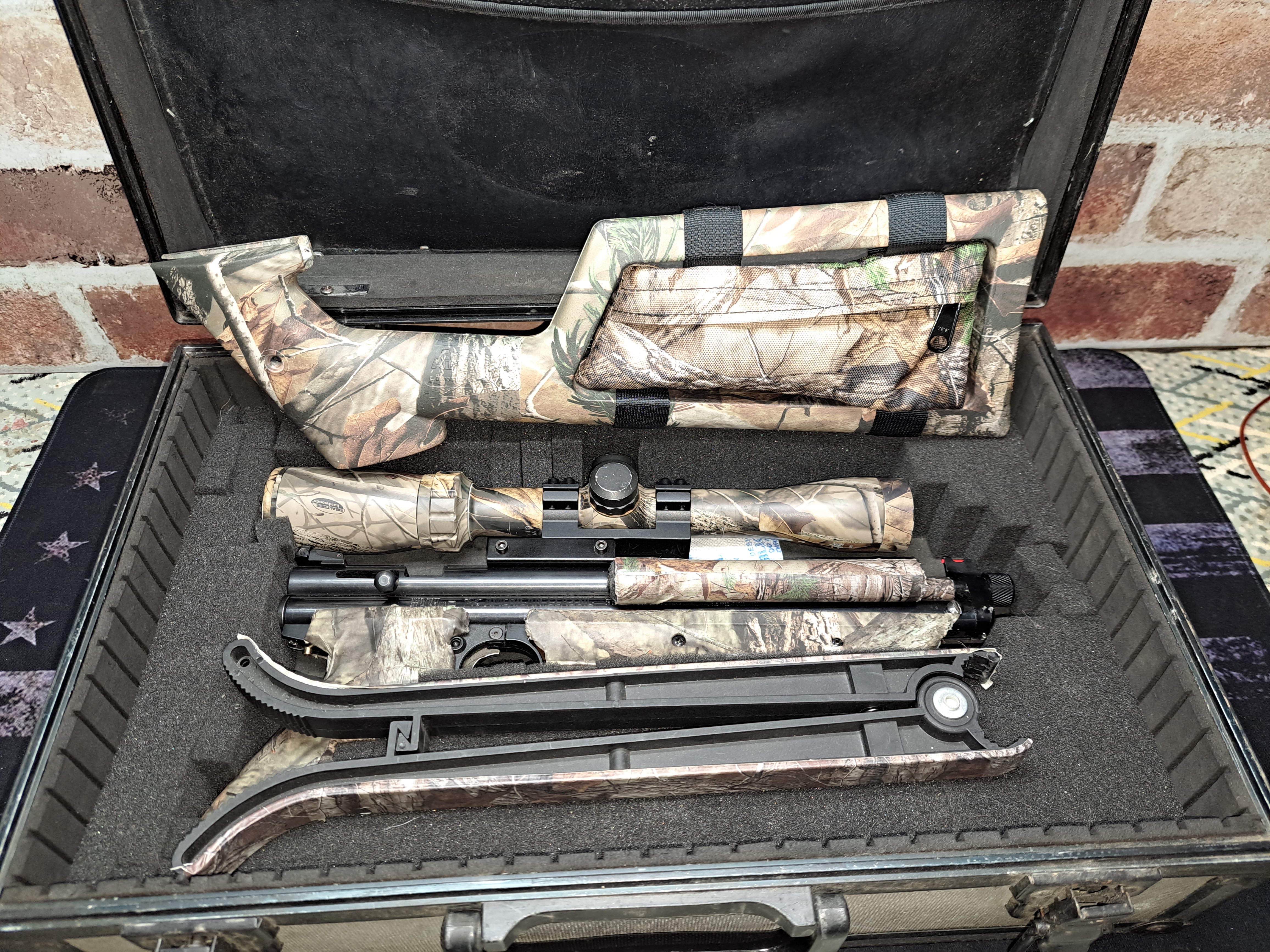

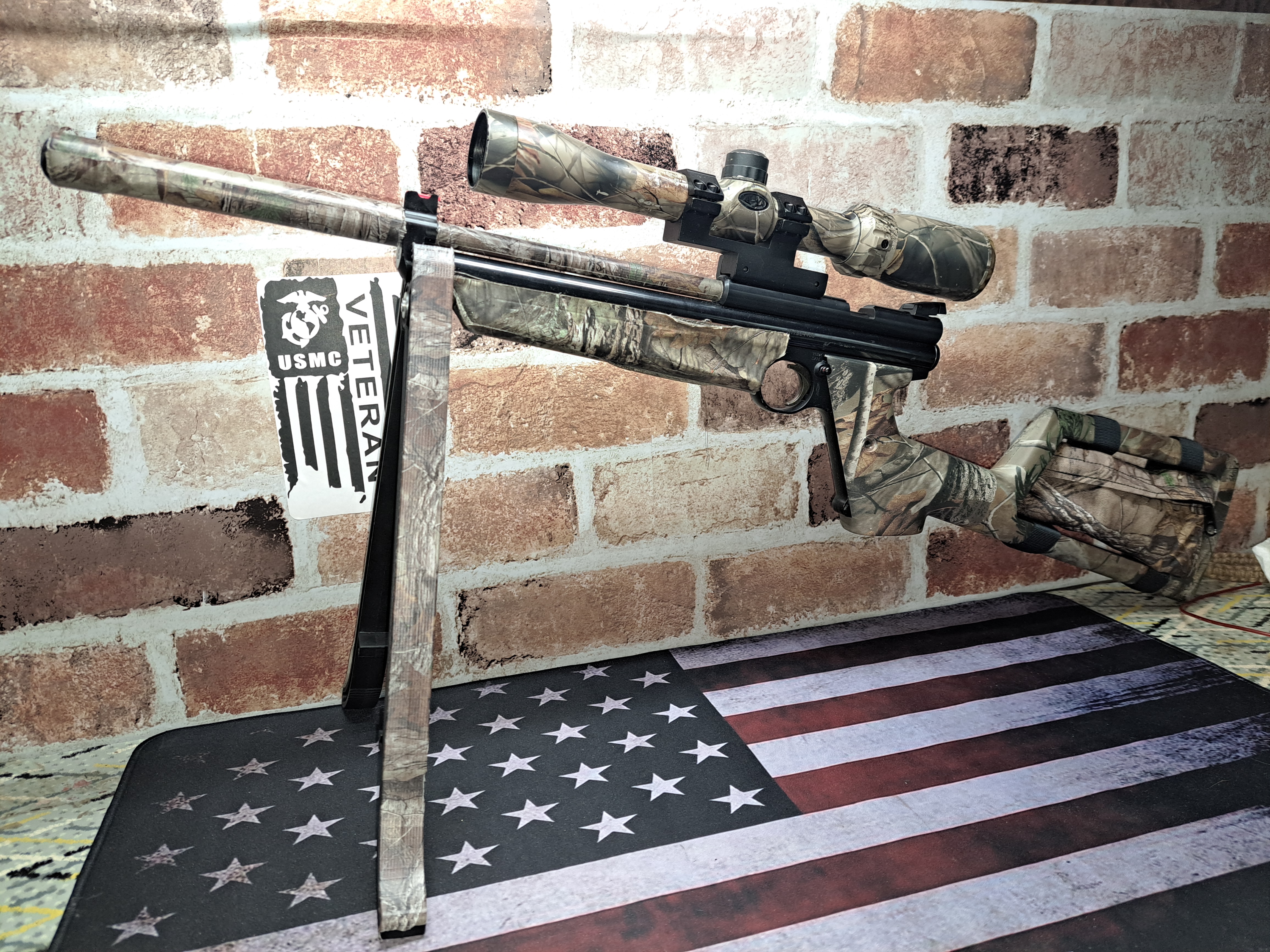

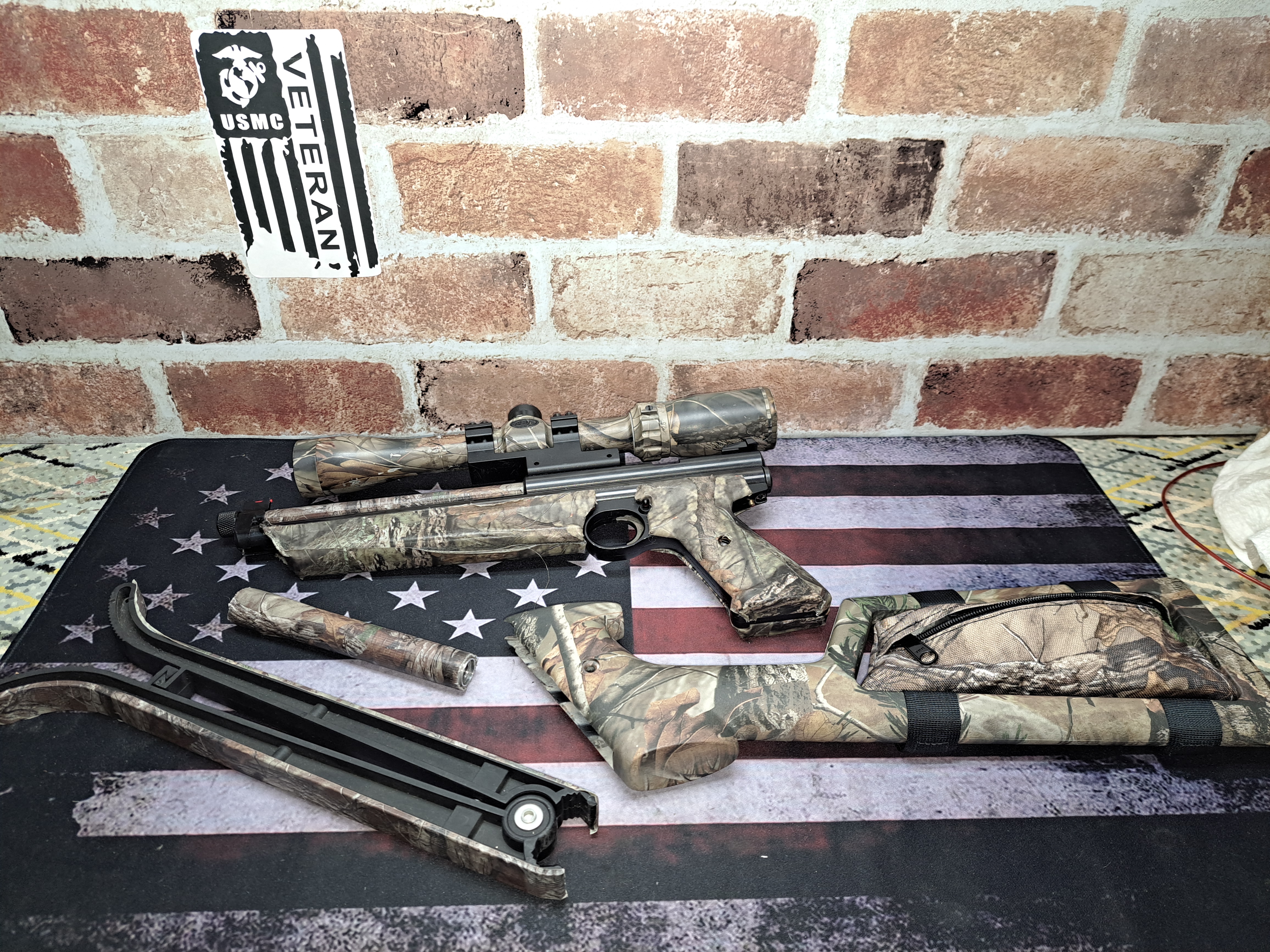

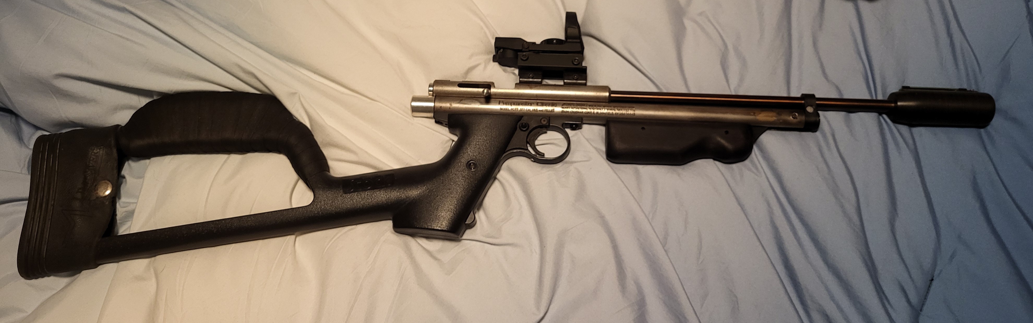

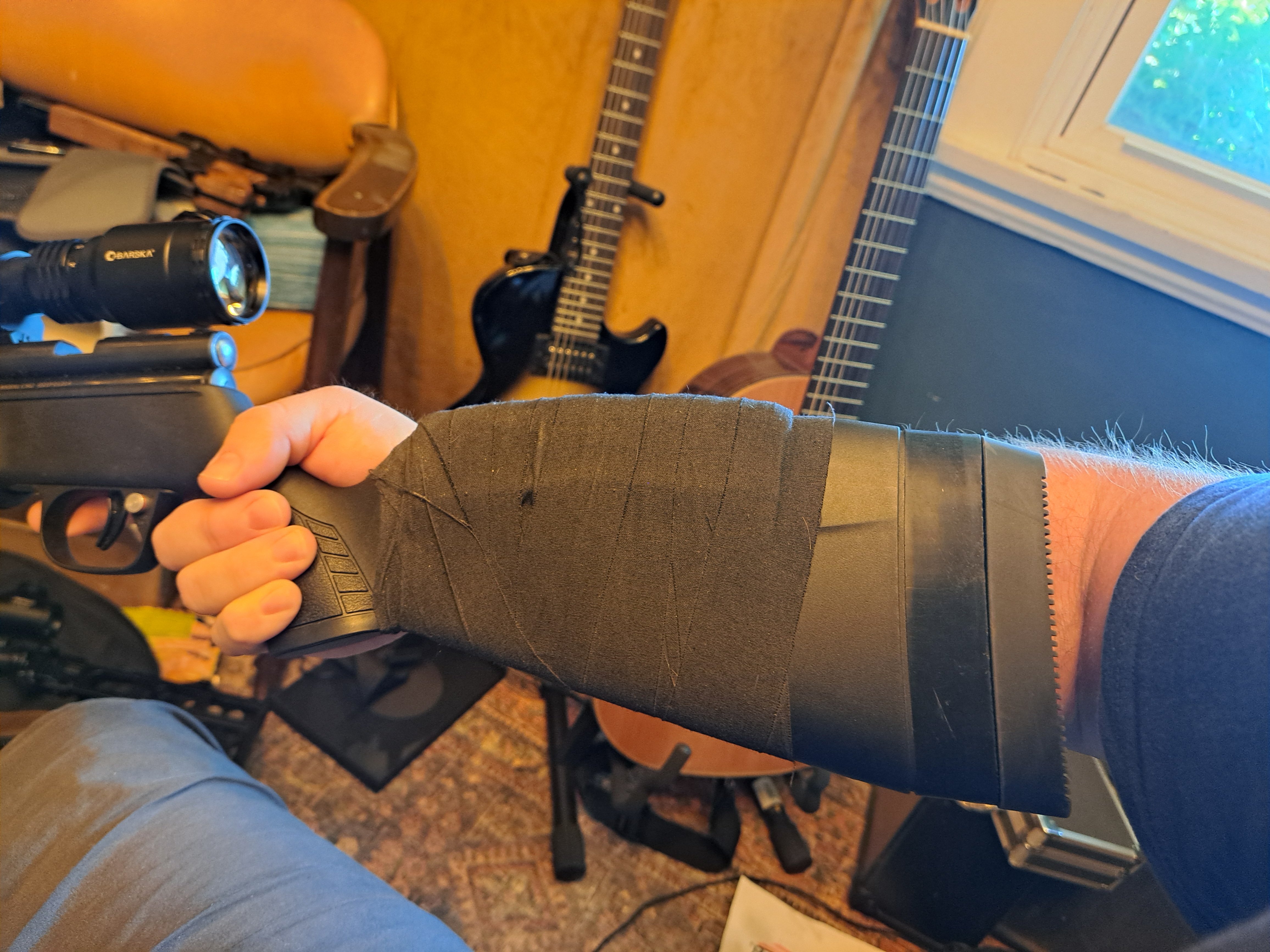

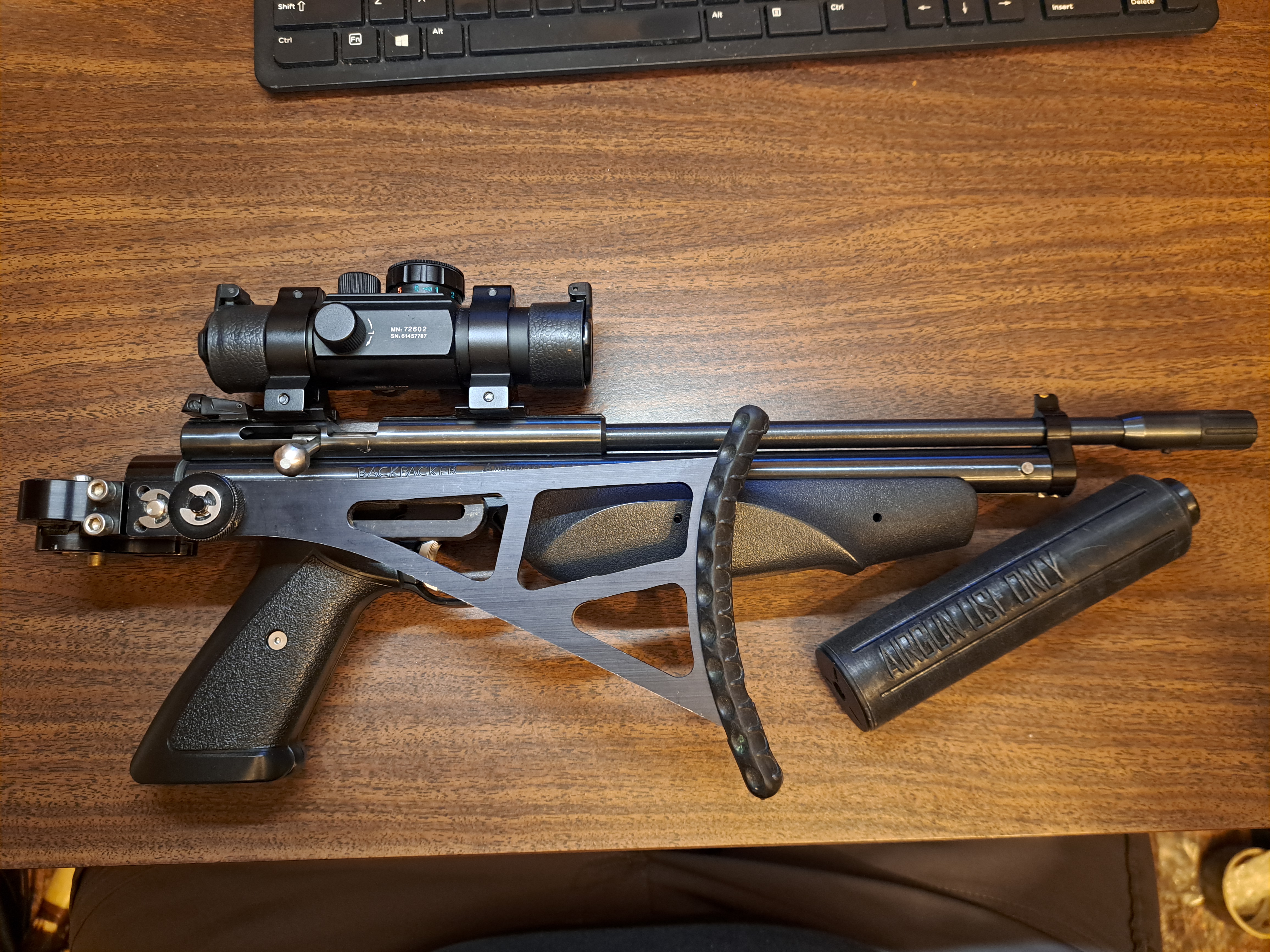

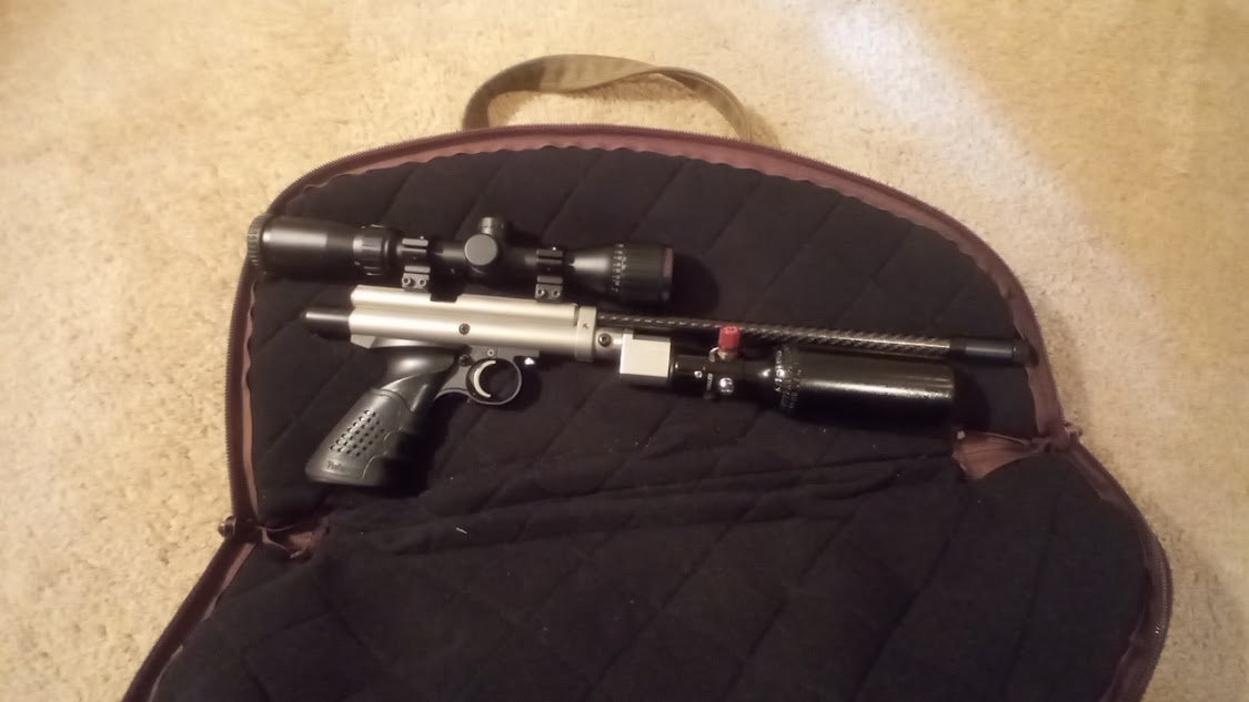

Sweet looking build. Could you tell us where you got that nifty camo pouch that fits inside the crosman stock?The first 1377 I ever built. Can be pistol or carbine mode. Idea was for a self contained woods walker build.

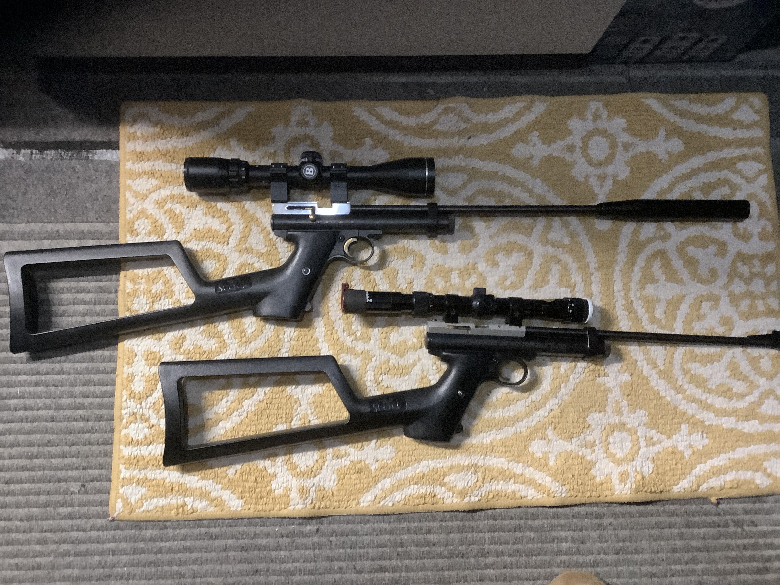

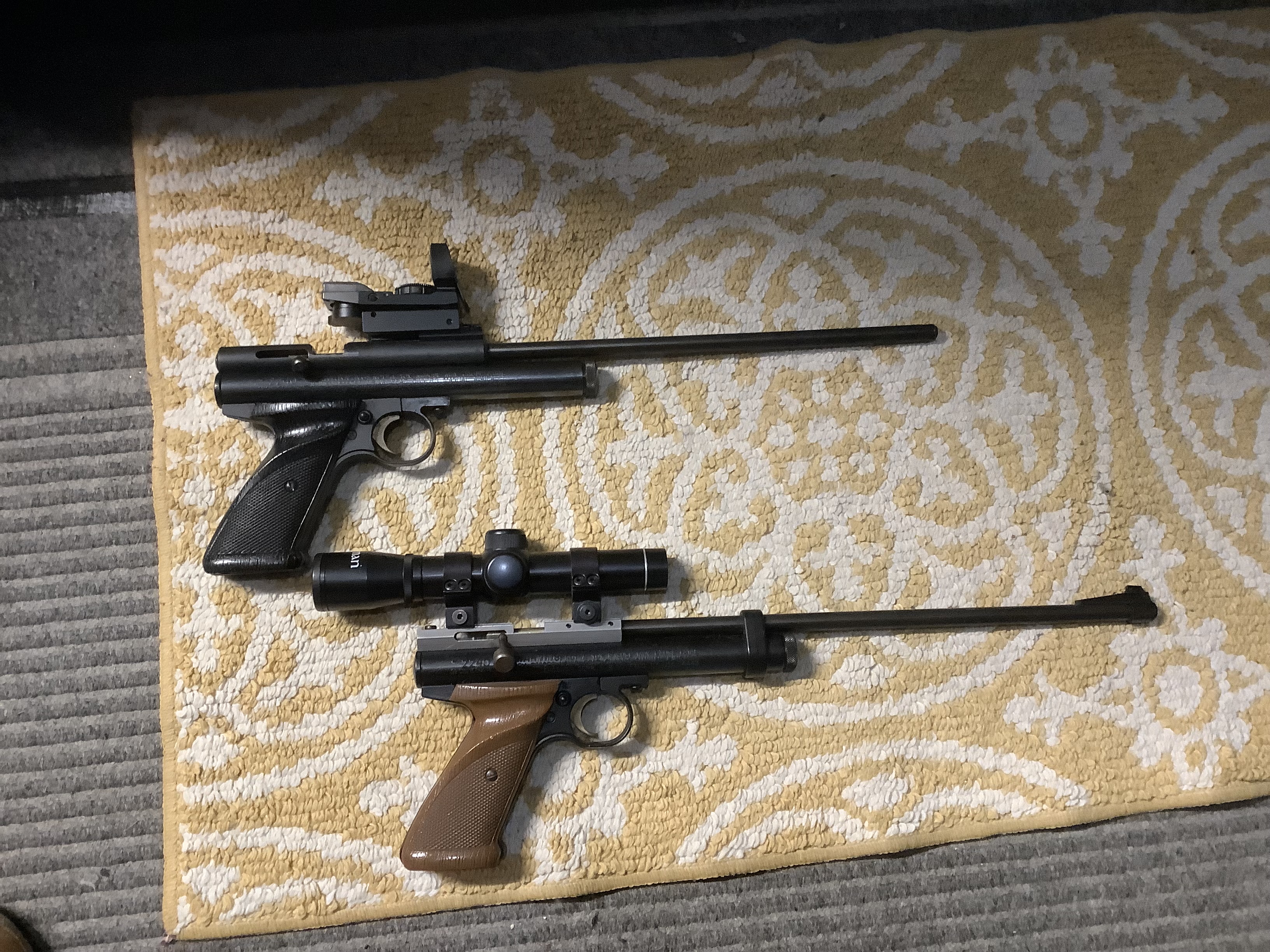

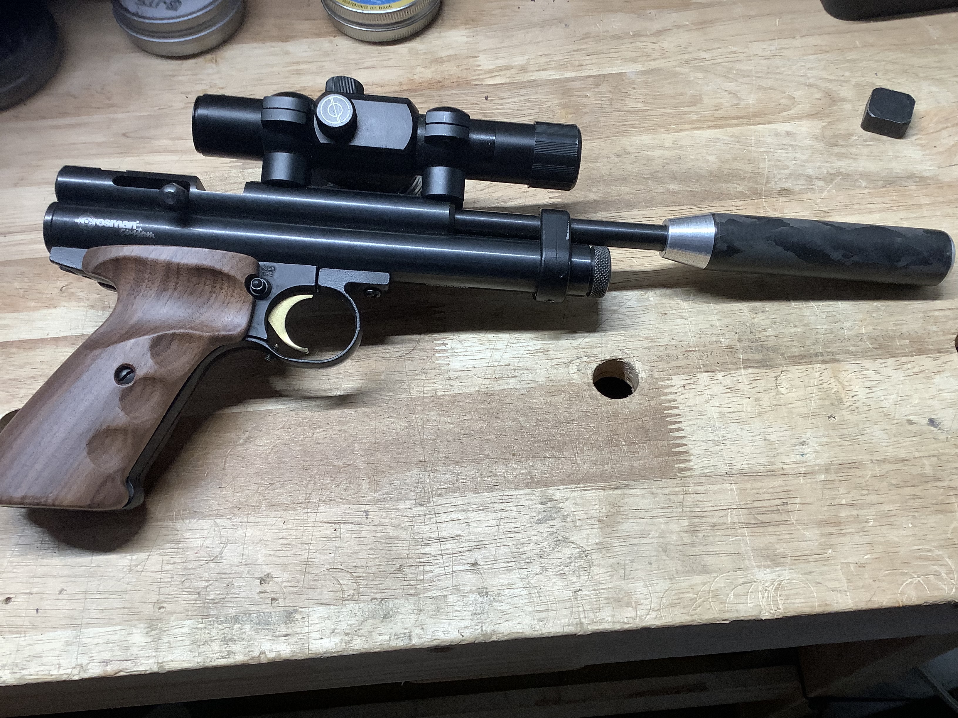

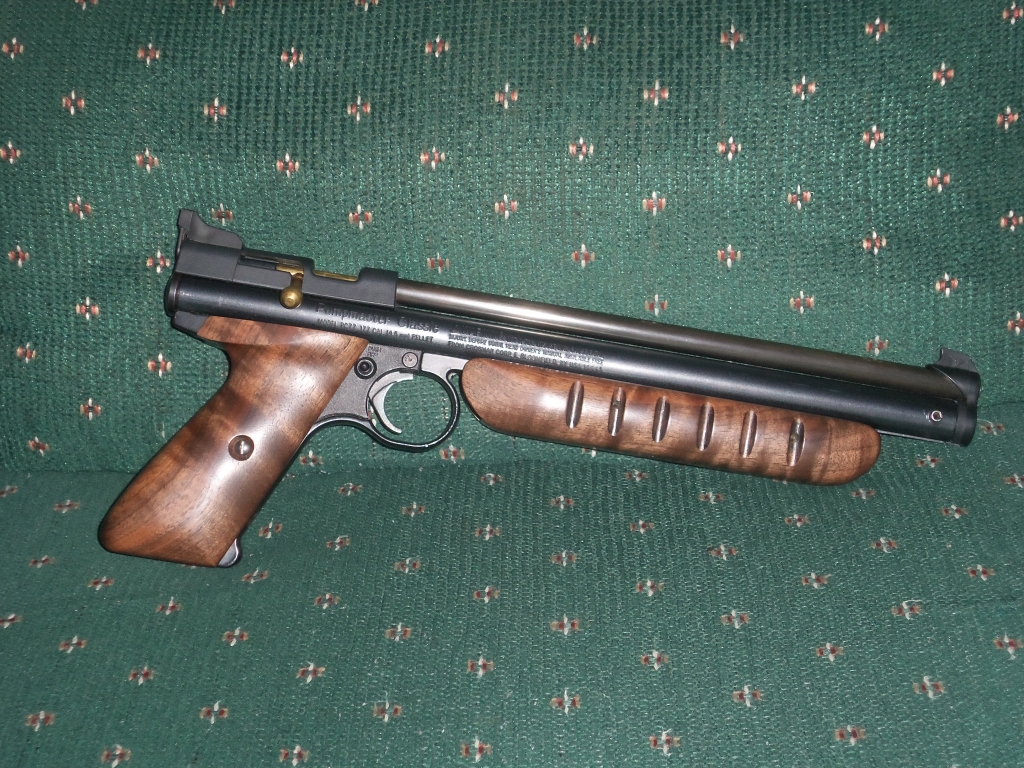

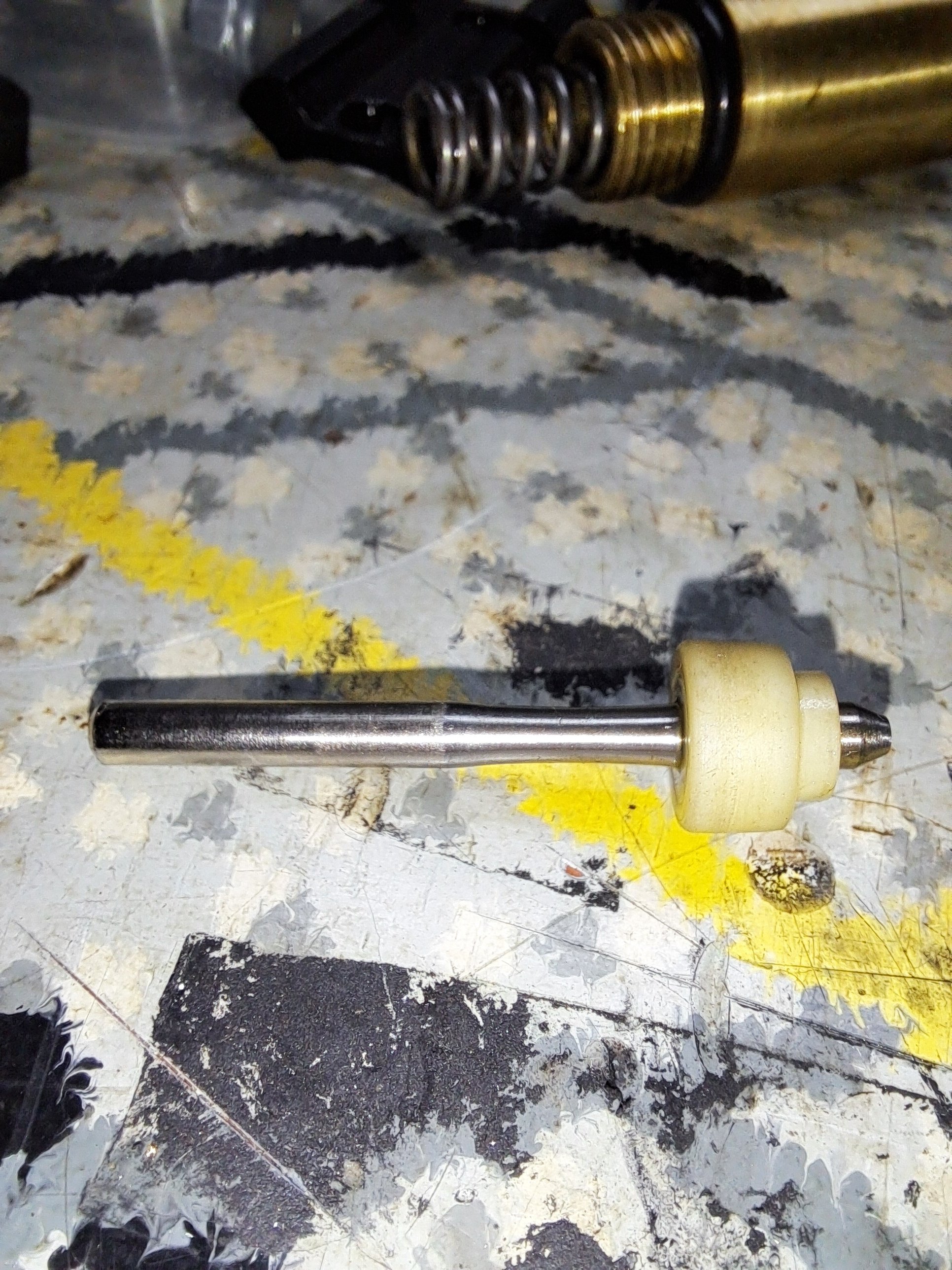

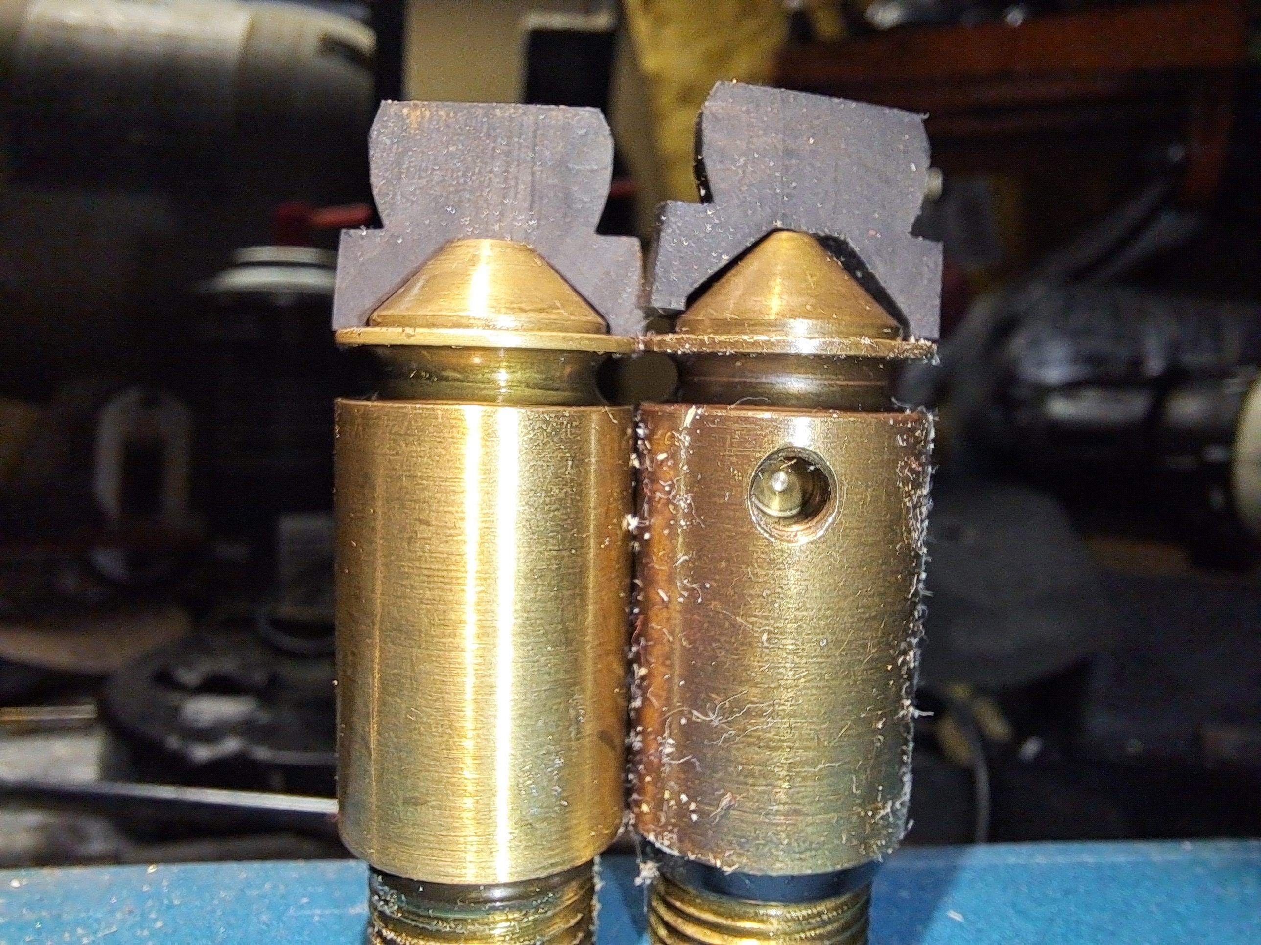

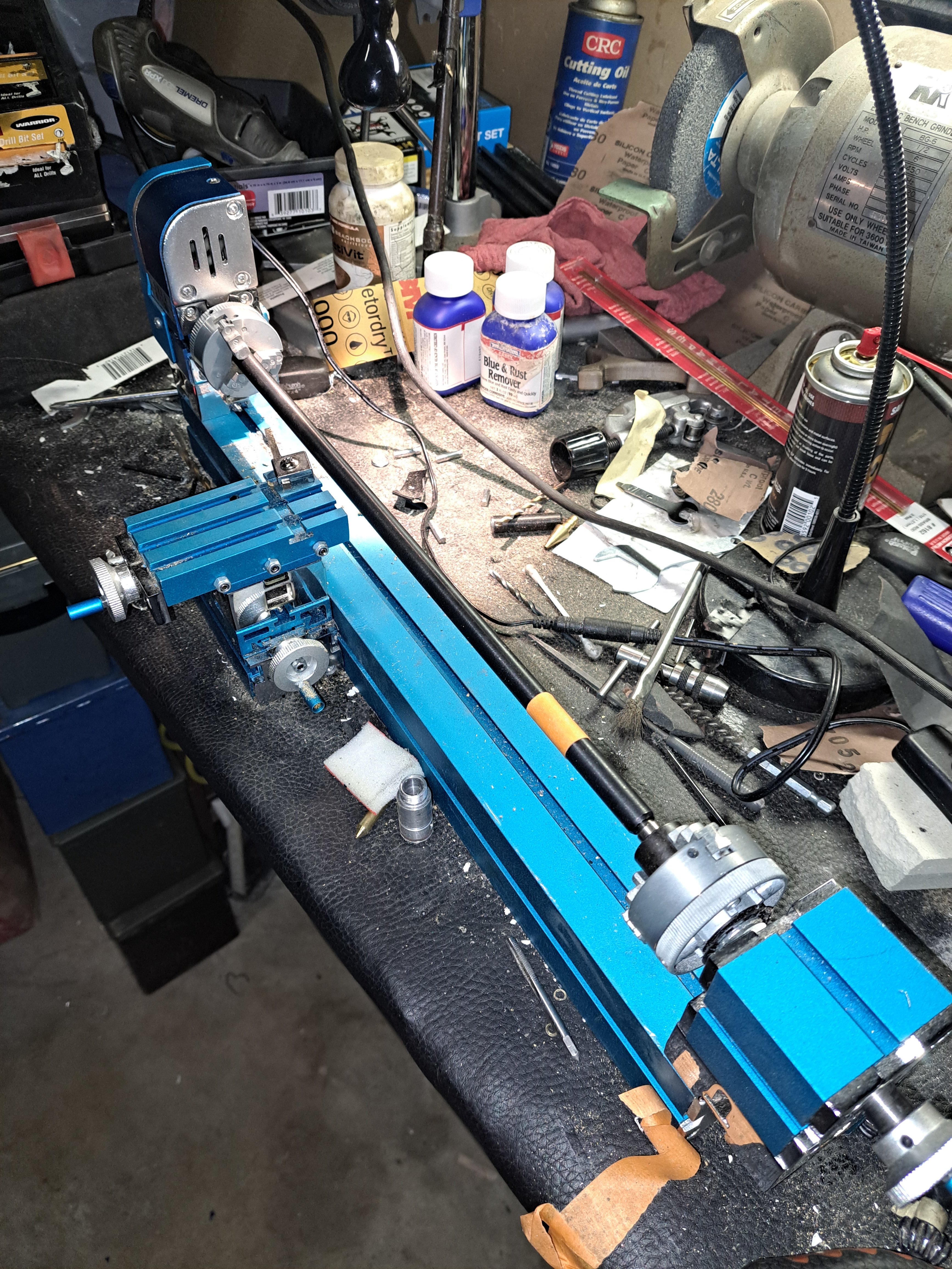

Really nice rig. That is a cool looking lathe setup you have there. Never seen one like that. Got any details on it? Did you build it yourself?I know I posted this 2289 before, but it's more done than it was before, and needs piston cup shims and will get around to it.
Went from
10 inch .177 (previous builder converted to a LW) to a cut down 14 inch barrel to 12 inch .22
Transfer port barrel port to .157
Angle port valve and opened rear passage arround the poppet to increase flow and increase volume.
Polished the hammer.
Last pistol I built like this with a10 inch barrel did 501fps with 15.49's @12 pumps and could do 556fps with 15.49@16 pumps.
This one has 2 inches and a solid piston with felt wiper over the last build. Idea behind this build was longevity, reliability And just a nice build.

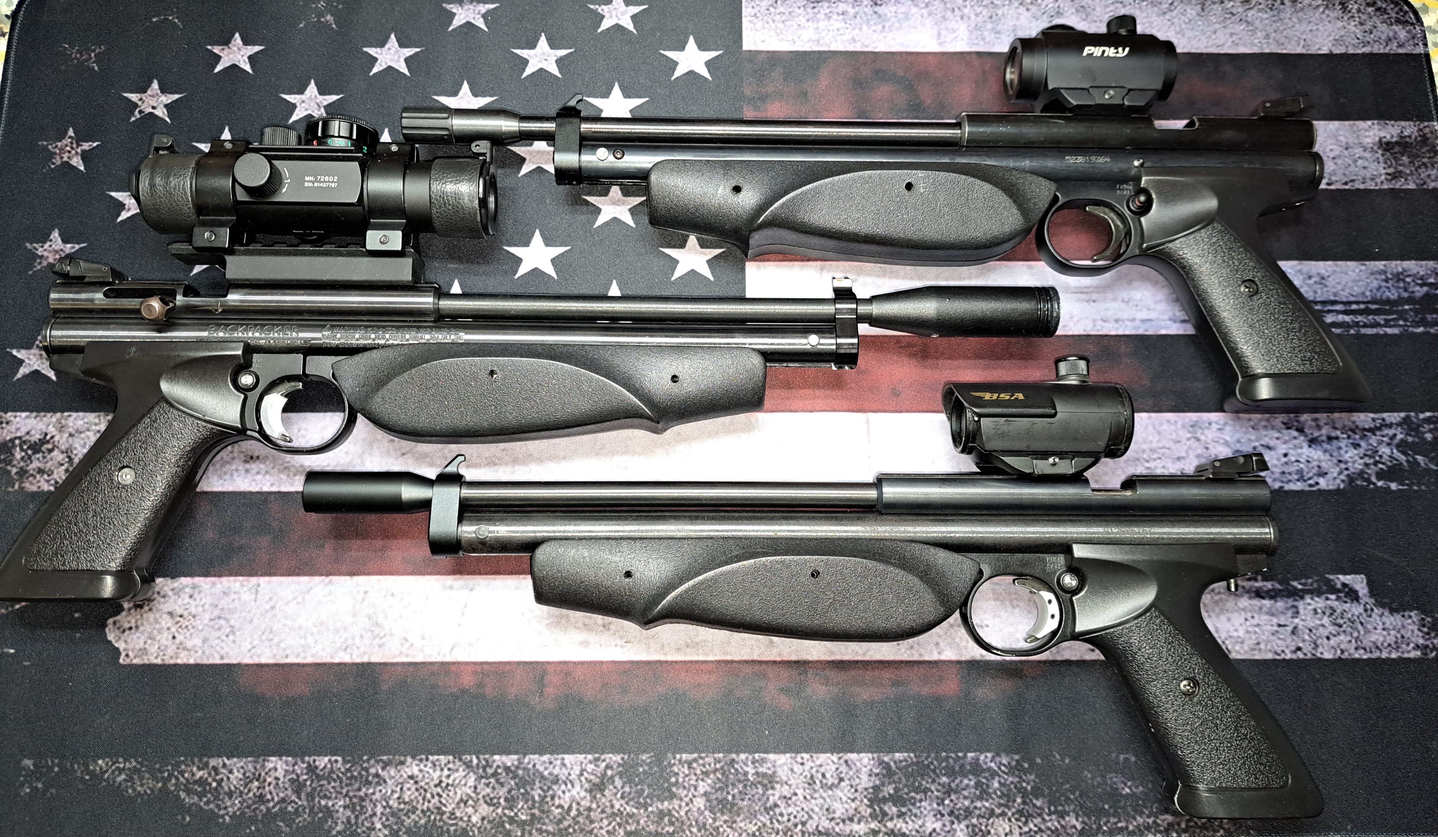

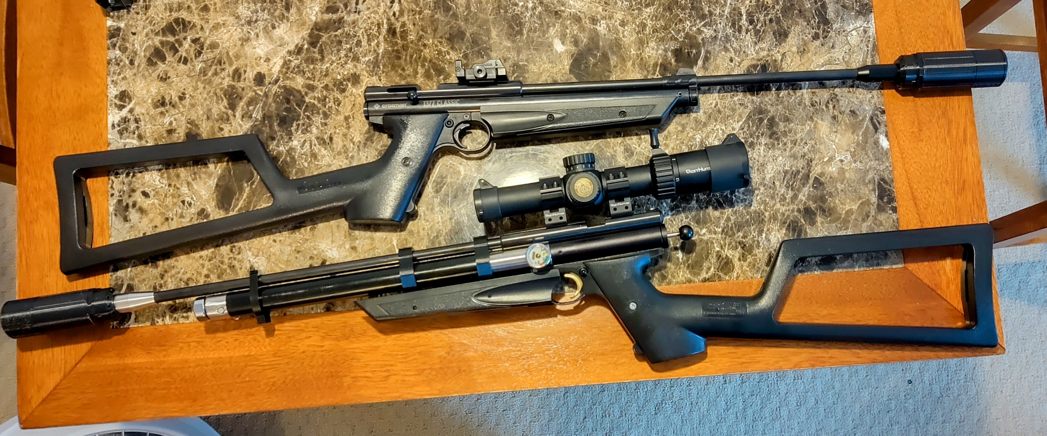

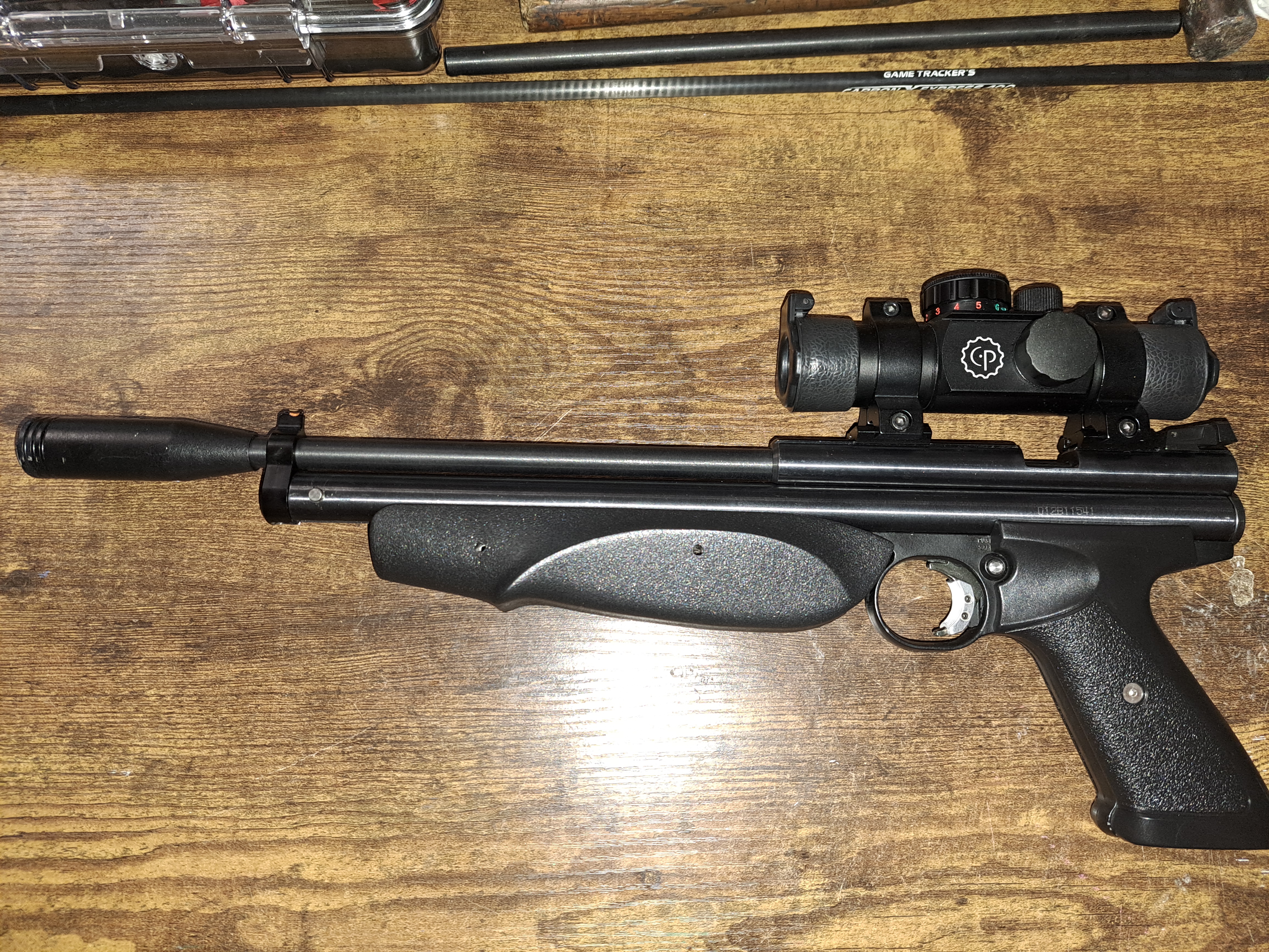

Steve.Sweet pistola my friend, here's my version -

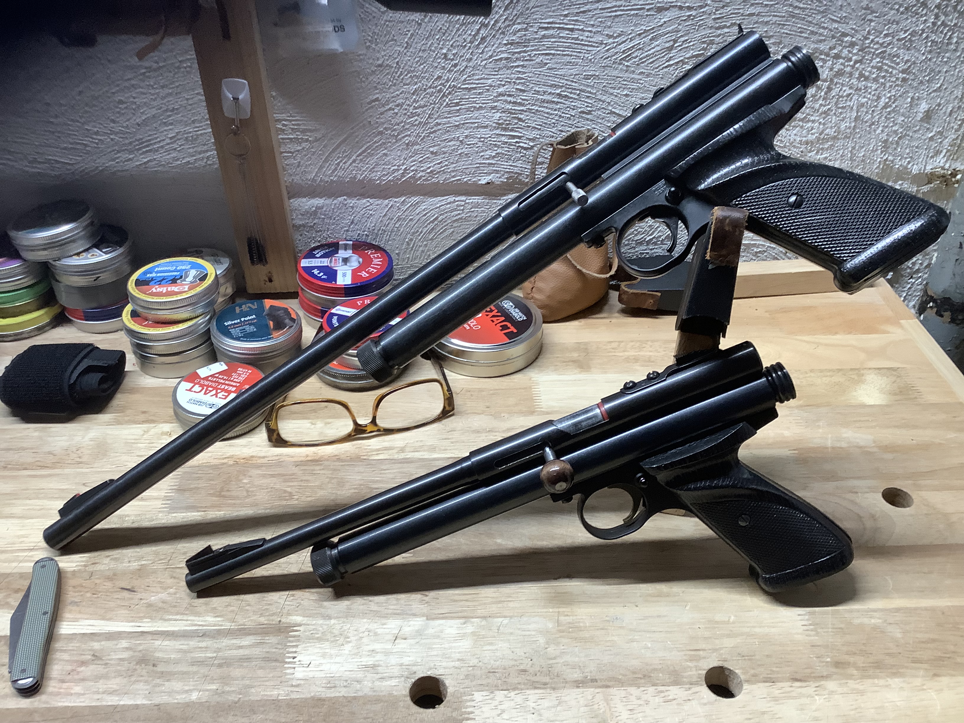

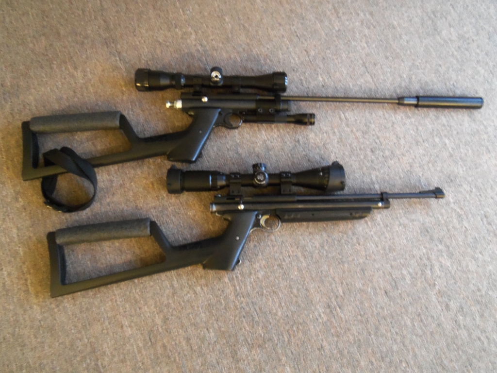

Nice! I have that same long shot barrel build. Haven't had a chance to shoot it yet, just waiting to get some shot shell's.View attachment 451408View attachment 451409View attachment 451407I cant the credit for any I bought them all this way, but they are awesome…

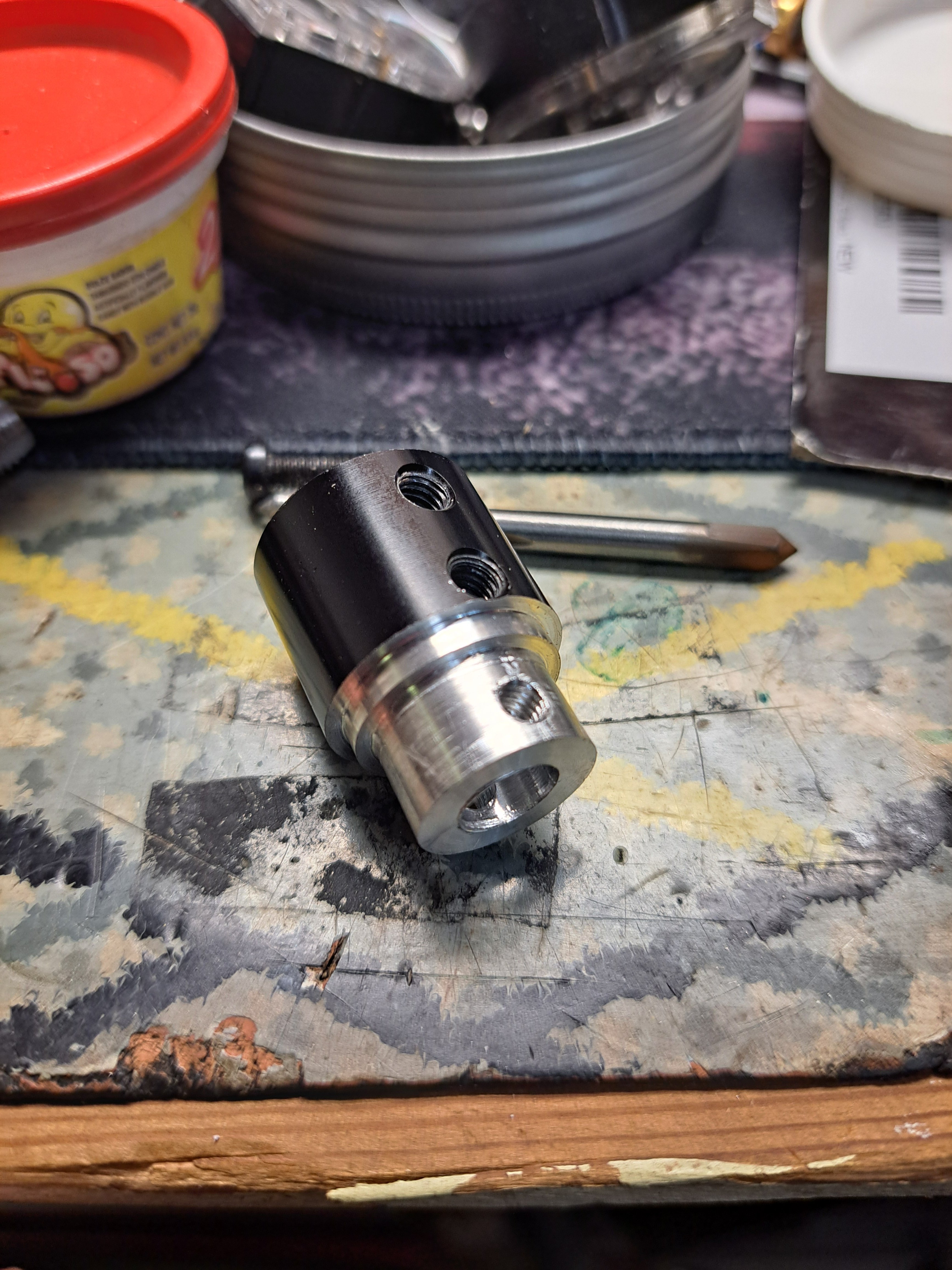

I bought a small lathe due to budget and slowly bought more parts for it. I wish I would have gone all in on something bigger but now see that it's worth it. It's a pouch deal that used to be sold online.Really nice rig. That is a cool looking lathe setup you have there. Never seen one like that. Got any details on it? Did you build it yourself?

What and where did you get that tank?Sweet pistola my friend, here's my version -
It's a Tippman, 9ci iirc. Bought it directly from Tippman online, been a few ...What and where did you get that tank?
