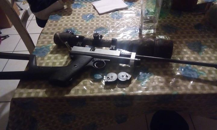

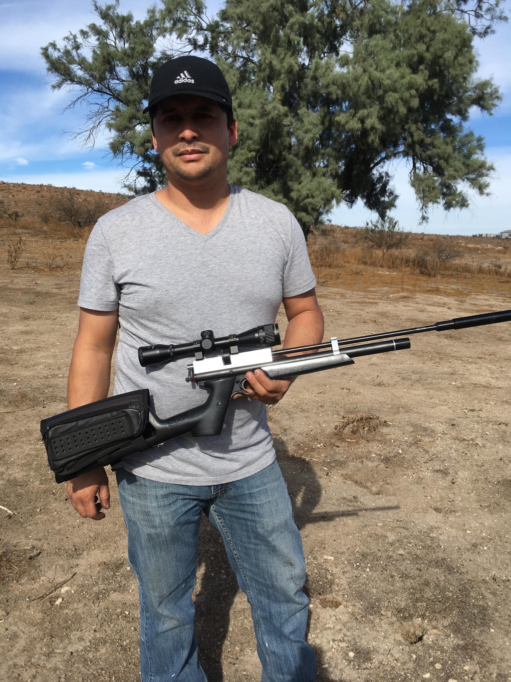

Well I have three multishot pistols
with marauder´s magazine , works perfectly!

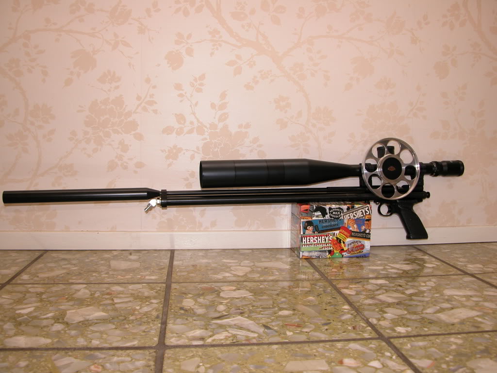

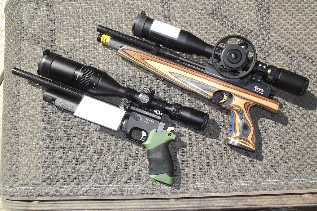

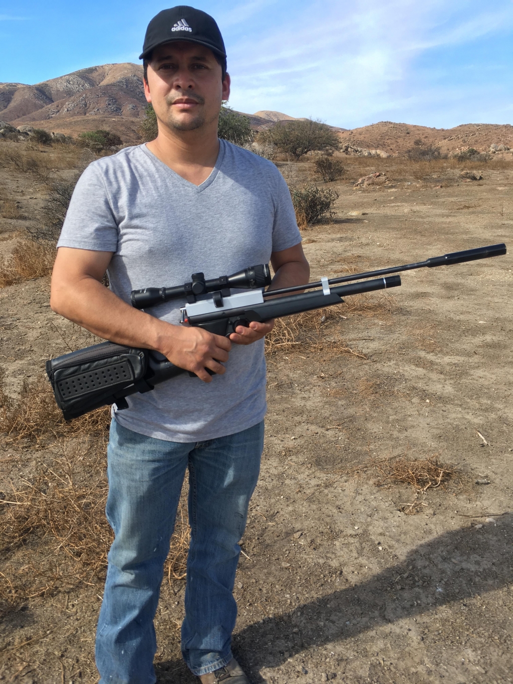

Here is some idea of what you might have to use in "pistol" field target to be competitive at the highest levels if I hadn't fought SO tenaciously to keep some semblance of pistol in pistol field target.
My customized 2240: added steel breech, 14.5” barrel, homemade silencing barrel shroud, polished trigger, sear and hammer, lighter trigger spring, modified valve assembly, homemade combination stock mount and hammer spring adjuster, six position adjustable stock, scope and scope rings, and bipod.
Extremely quiet, lightweight and accurate!
