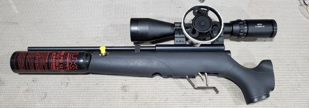

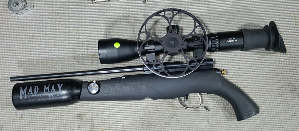

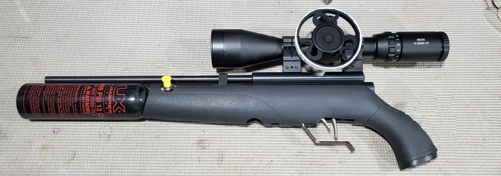

My son's FT pistol
That look like something out of a Road Warrior movie 😁
Which adapter do you use to mount the bottle to the air tank?
If you could have rounded off that pistol grip area a little bit more it would look like a pirates pistol almost
Ray
Ray1377 funny you should say that. I had just watched The Road Warrior about a week before I started this build. That's how it got its name lol. This is my cut down Maximus stock. My son likes the vertical support against his palm/wrist area so he left his like you seen it. That's me in my first match with it in Baton Rouge
Ha Ha, Who says great minds don't think alike??
That is a cool looking setup.
Thanks for the pics

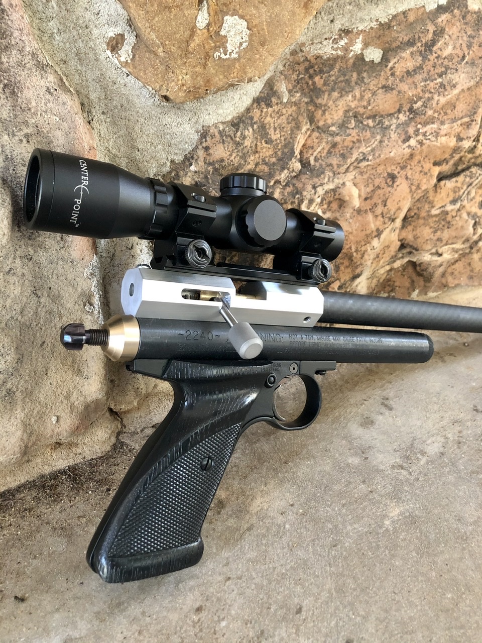

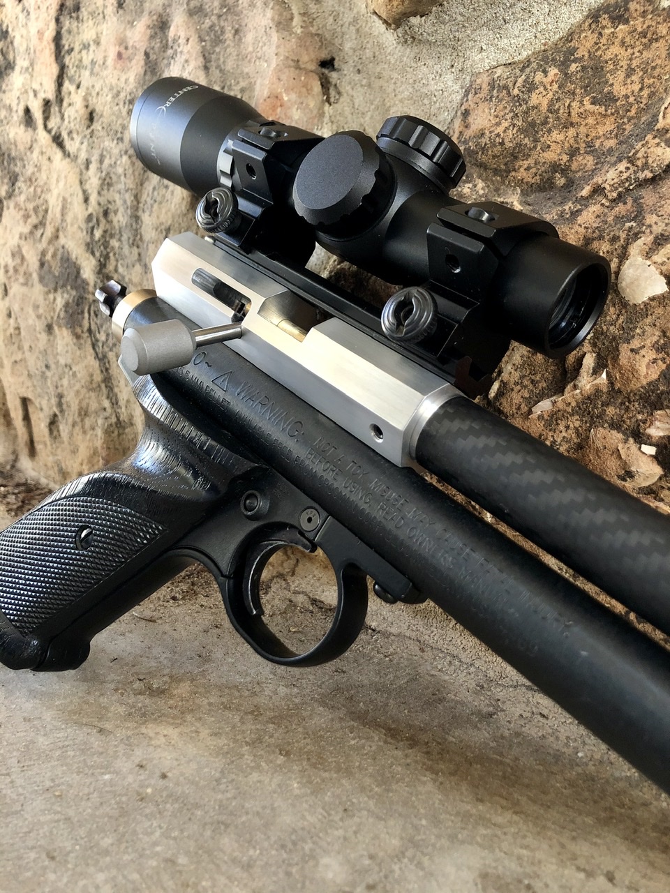

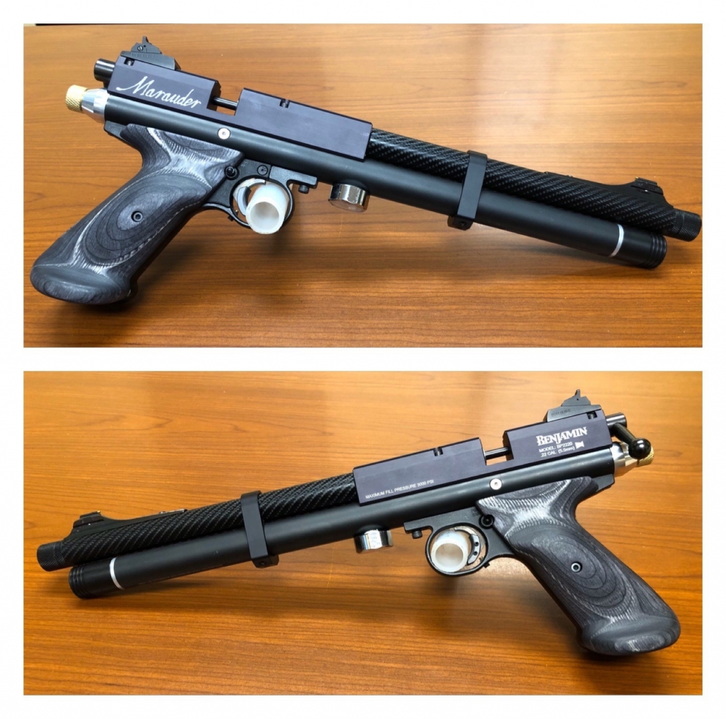

New guy here. Here is my recently completed build. Everything was done by me in my garage shop. New parts are breech, bolt, bolt handle, power adjuster, transfer port, cocking dingus, ( what the bolt hits to cock) and barrel shroud.
1580168042_11547225545e2f736a859a80.18055433_054C02DC-312F-4437-8D00-1796CDAC06B0.jpeg
Incredible roll your own example -
Would you happen to have another one of those breeches you'd want to let go?
SCHWEET!

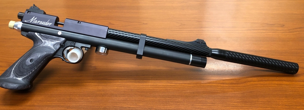

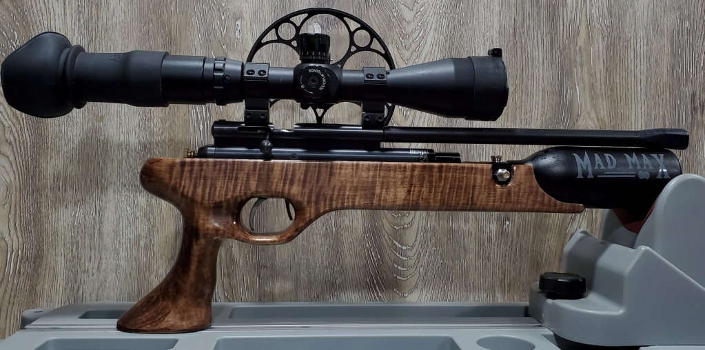

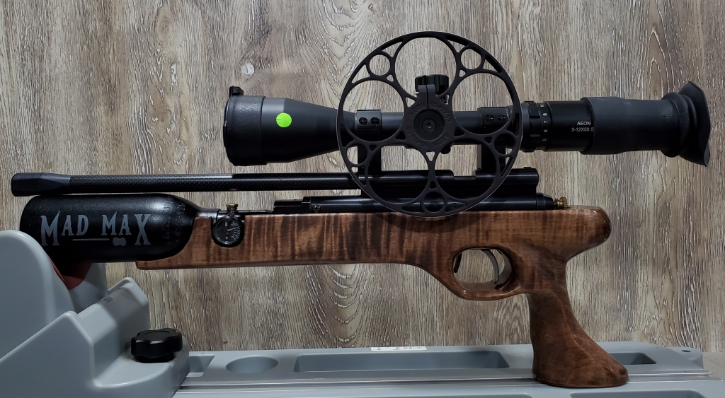

Just got MadMax back from Joe Garland. The Curly Maple stock turned out great, fits my hand really well. He added some carbon fiber and a muzzle cap to the barrel as well. Cant wait for this FT season to start but I only have one Pistol FT match lined up right now.
Nice build, I remember you showing it to the fellas at one of Roz's ft matches -
It's evolved very nicely, must say!

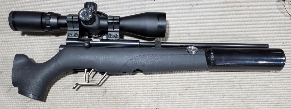

I've been fooling with a bottle build myself, but in carbine form.
What length are you cutting your Maximus tube to? Did you use one of the JDS Airman drop blocks? Ray and myself are inquiring airgun minds and need to know lol!
Also like the way you hid the reg/plumbing in the Maximus stock belly - well done
EDIT YOUR PFT STOCK ROCKS!

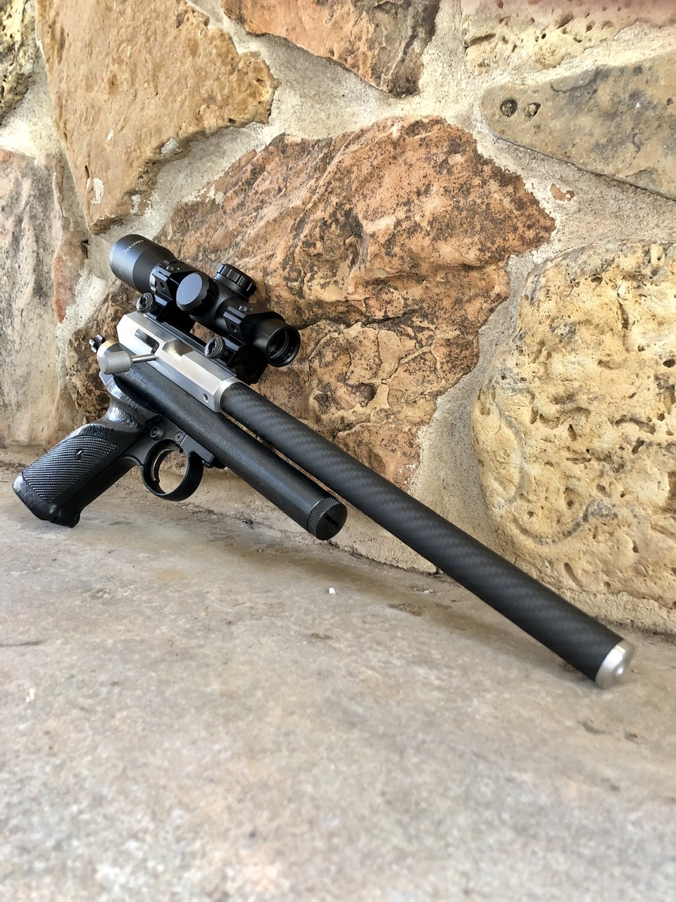

Well I have been werqing on this on and off for twenty years now
Started out as a 2240 pistol
early mods
Fake co2
Added 2250 barrel
Installed System-X dropforward and co2 tank
later mods
Added Bushnell Sportview 4X 32 AO scope
Modified the valve and stem
Installed carbon shroud
Replaced 1200psi Macro-line with 2500psi line
latest mods
Added 13ci 3000psi air tank running at 1200psi now
Put on a CustomAir repeater breech
Made adapters for the breech and shroud and installed a cut down a .22 FX STX barrel
Things yet to do shorten the shroud a couple of inches
Crosman 400 pistol with parts from
400 rifle
2240 pistol
SSP pistol
262 rifle
Have admired your builds for quite a while - very inspiring!

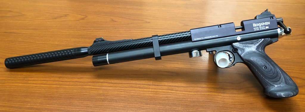

Glad you like them here's another 4 you my favorite 1377
DAQ breach
I fergot who made the grips Actually it was Rick to bad he stopped making them I need another pair and he was good.
Modified valve
Flatop piston
Gamo rifle rear sight modified Crosman front sight
LW barrel
Aluminum barrel band
Carbon fiber suppressor.
One of my favorite guns.
Stolen in late 2010
I have near enough parts collected over the years to make another now but I can never replace the grip set.

Thank you. And no, I don’t have another. That was a trial/setup piece that ended up working as the final piece. While I enjoyed making it, it was certainly a pain in the butt. The extra height over factory means longer parts need to be made. Seemed to be “something” at every turn. Had I known there was a riser for the steel breeches, I’d have likely just bought one.
