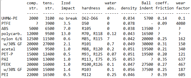

PET-P is a good alternative. to Delrin / acetal. Low cost and similar properties.
PTFE has great self-lubricity but is quite soft in comparison.
Here's a table of common plastics I compiled a while back...
