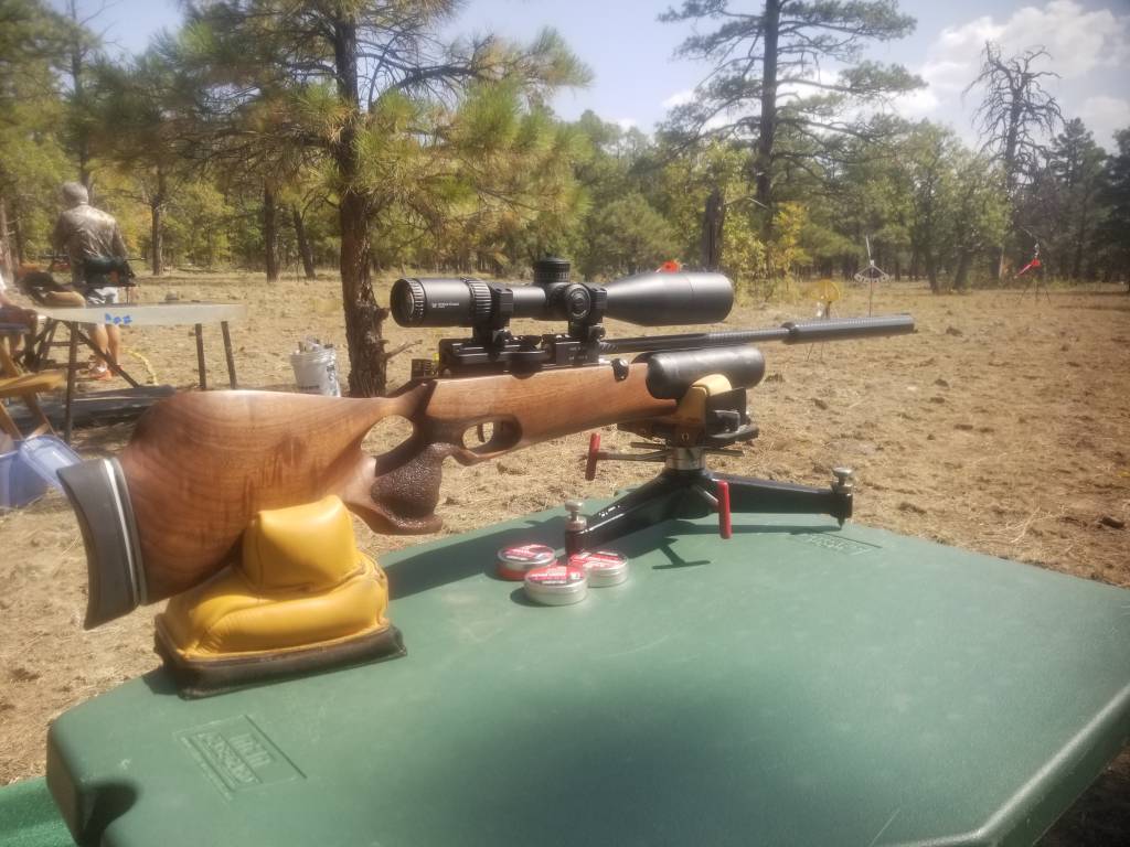

With the stock .30 Bobcat I shot this past Saturday and in November, (it is blinged up with a Reaper Hydrodip) and a Huma regulator, I shot the .30 FX (rebranded JSB) 44.74 pellets straight from the tin. I've never had a problem with flyers with .30 caliber pellets in the older FX ST barrels...
Now, to the other end of the spectrum. For the next couple of XFT matches I'm going to shoot Bleu, my .22 Red Wolf HP with 25.4 grain JSB RD Monsters. Without sorting, the newer batches of RDMs will give you a true flyer about once every ten shots, maybe more or maybe less, but on average. So I SORT them (intentional capital letters). I take a tin, and sort for head size, and cull the ones that are smaller than 5.53 in my pellet gauge. Then I weight them, and only keep the ones that are 25.4, 25.5, and 25.6 grains. I lightly lube them with Ballistol. Out of a tin of 350 FX rebranded JSBs, I usually eliminate about 150 pellets that I keep for tuning and practice.
I started doing this after getting burned with flyers this past Summer TWICE in 100 yard Benchrest events. Once in a TEAM event July in Utah (the flyer knocked me from 2nd to 8th), and once at EBR 2021 (the flyer knocked me out of qualifying for the 100 yard finals). In the first example, I hadn't been sorting at all, and had a flyer go outside the 4 ring. Then I started sorting as above, and shot RMAC without one flyer in the two qualifying rounds and the one final round. At EBR I thought I had sorted enough pellets but forgot that I was also shooting Bleu in the 50Y BR event and used them all before the 2nd 75 yard qualifier. Again, I got a flyer that was outside the 4 ring and that caused a low enough score to not make the 100 yard finals on Sunday (it was a lousy card but would have been good enough if...). Bottom line is I'll never shoot .22 RDMs again in competition without meticulously sorting...
When .22 RDMs are good, they are VERY good... In the first RMAC 100Y qualifier Bleu with RDMs shot the highest overall score of the tournament - 229-8X. But if you don't sort them they're guaranteed to break your heart! ;(

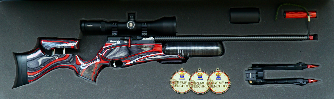

In 2018 I cleaned house on the EBR AFT course 40/40 (1 mulligan).
Daystate Redwolf HP
  • .22 caliber
  • OEM everything (except I polished the barrel) and tuned the GCU.
  • MRD 935fps
  • I paid a neighbor kid to inspect & weigh over a dozen tins. I did not head size them.
  • I use Gunzilla as a lube (1 spray top & bottom of foam) with all my pellets.
  • No moderator
  • Athlon Cronus scope
  • Sportsmatch adjustable rings
After that I pretty much retired from mainstream competitions. A few years later I decided to scratch the itch and compete in a local event here in Texas.

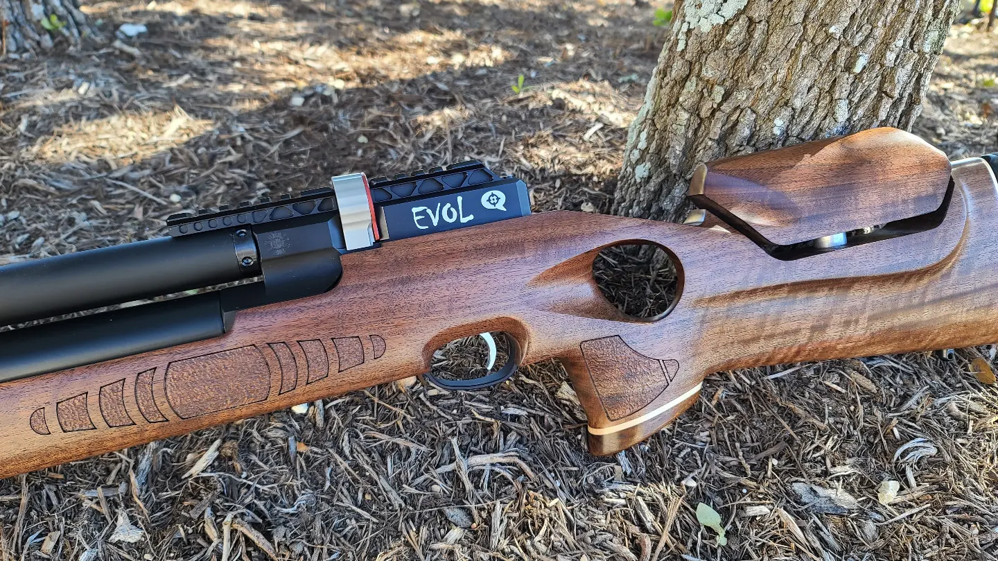

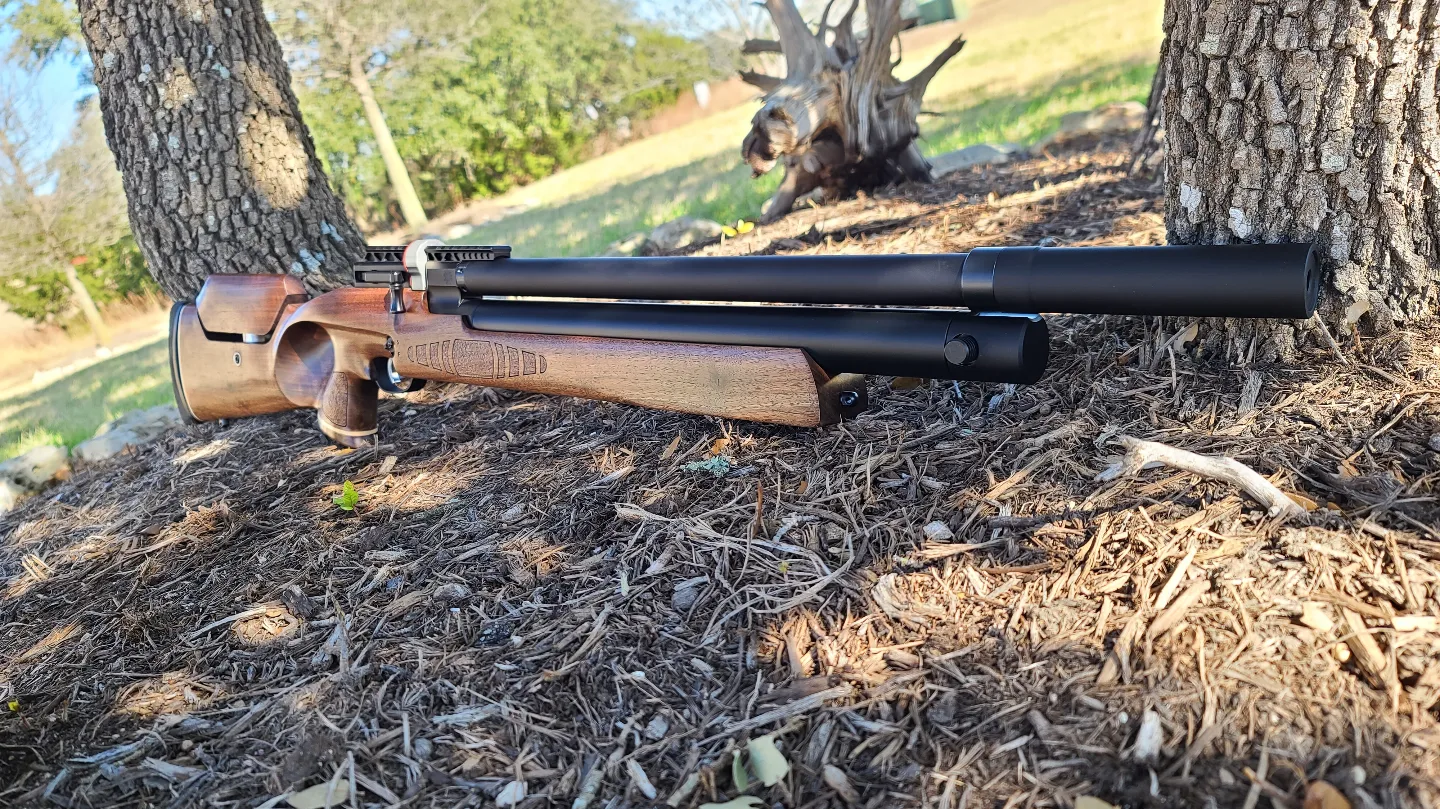

Hoping this Evol will be a real shooter! Came to me shooting MRD at 920fps. I've yet to see what velocity it likes best.
View attachment IMG_20220122_100708_999.1643244108.jpgView attachment IMG_20220122_100708_787.1643244108.jpg
-Michael
