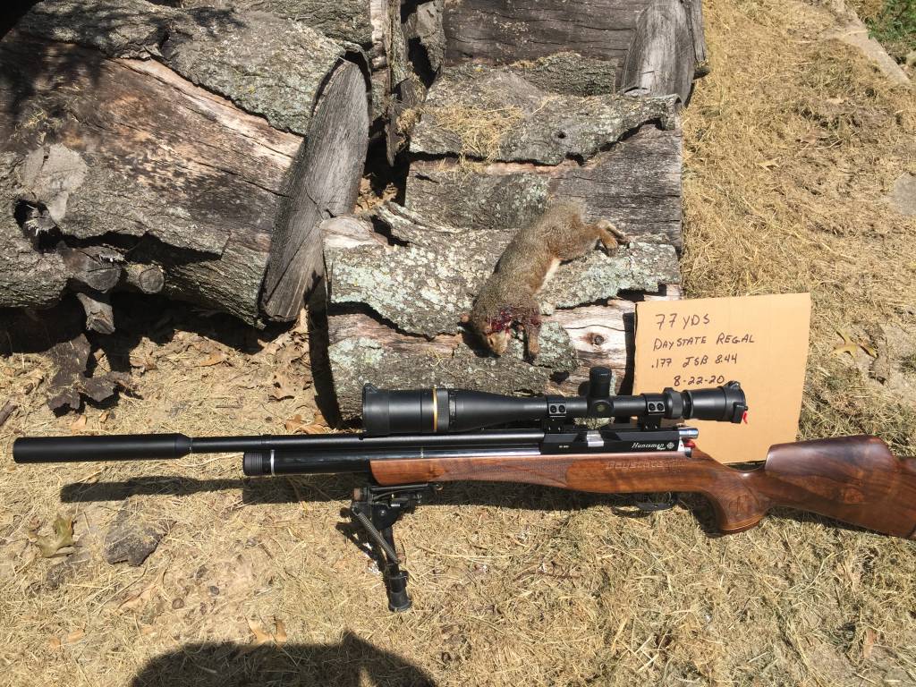

I picked up a 6.5X20 EFR at a gun show several yrs ago that was used and an excellent buy. That was back when I shot a lot of rimfire matches. When I got into airgunning I shipped it to leupold and had mildots installed ,use it on my .177 Regal squirrel hunting Love it!
Thanks Matt, no wind in the woods to deal with, long shot on a fire trail, normally don’t try that distance with.177 but that day.... I was in the zone !
