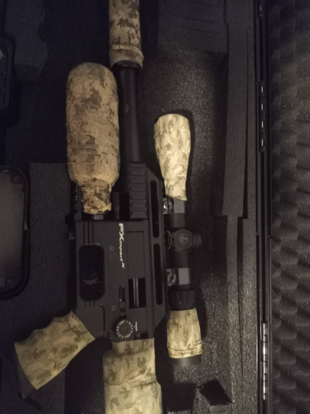

just put fx carbon fiber liner. Had to wrap pencil on sand paper with vise grip on bottom and lap thread like fire starter. Carbon fiber fit my m3 barrel nut thread but had to sand thread for m2.
