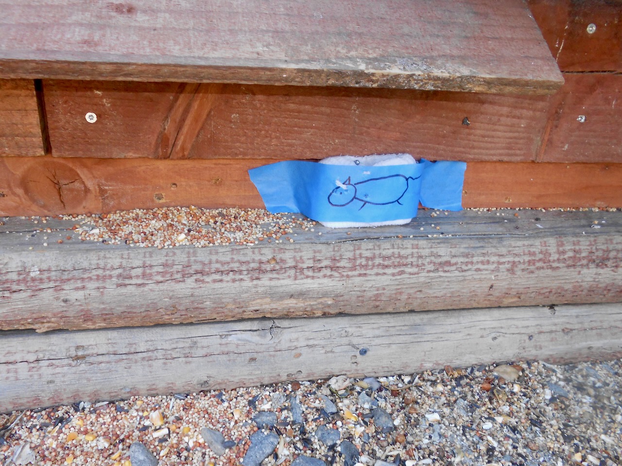

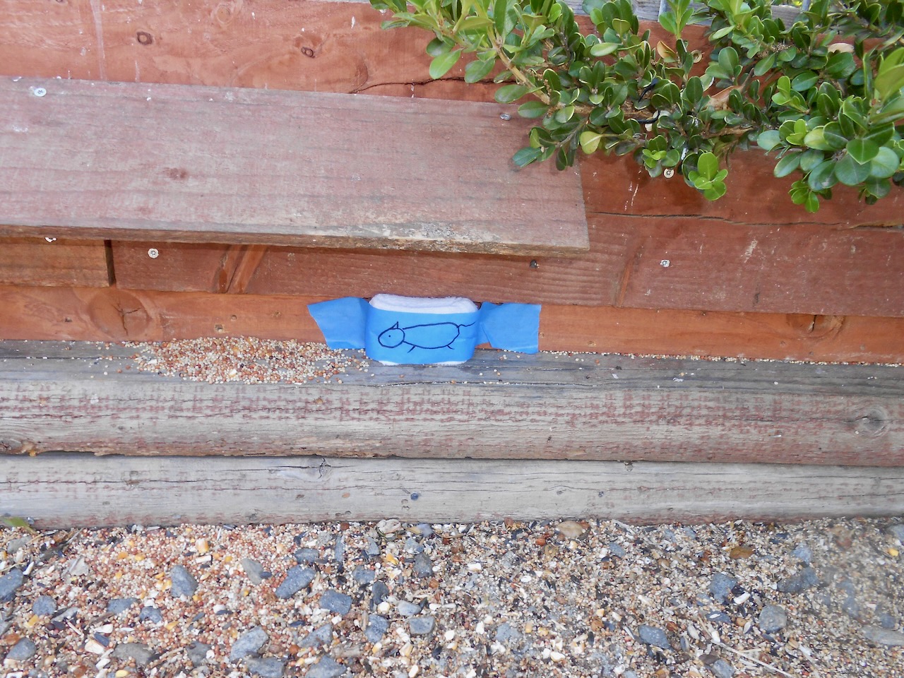

I set up a night time target backstop for my Rat plinking effort. It is lit by an LED that I use in red mode. And, add to that, I've recently had both eyes reworked for cataracts.
I had plenty of Rats showing up, and I thought that I was missing them (probably hitting them, but blowing through them). This was making me a bit crazy. So, I set up a faux Rat.
A faux Rat?

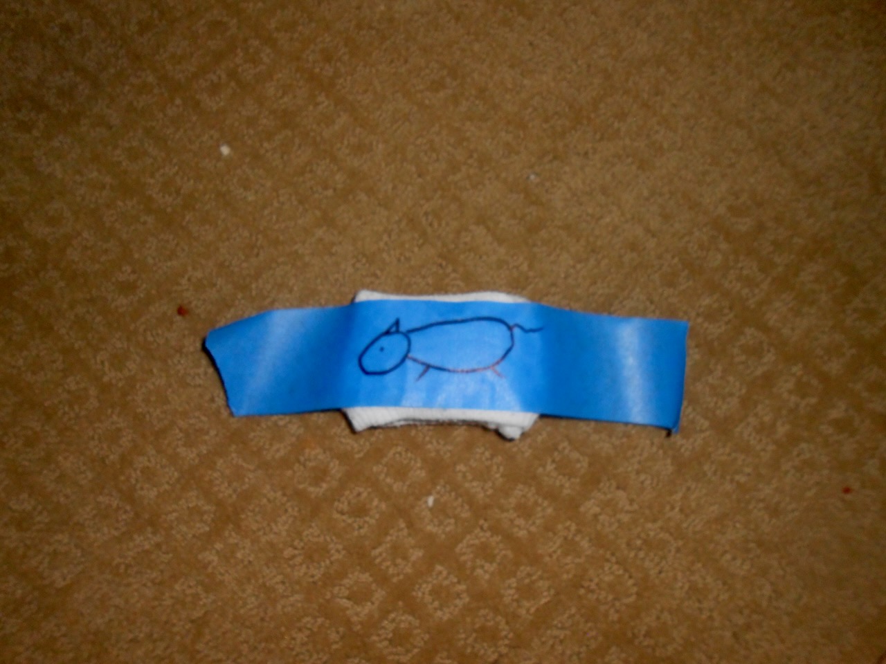

I took an athletic tube sock, and, started rolling it up at the toe end. I rolled it up until I was at the elastic collar. I used the elastic to enclose the rest of the rolled sock, to create a sock sausage. This sock sausage is the diameter and length of a rat, at least its vitals region.

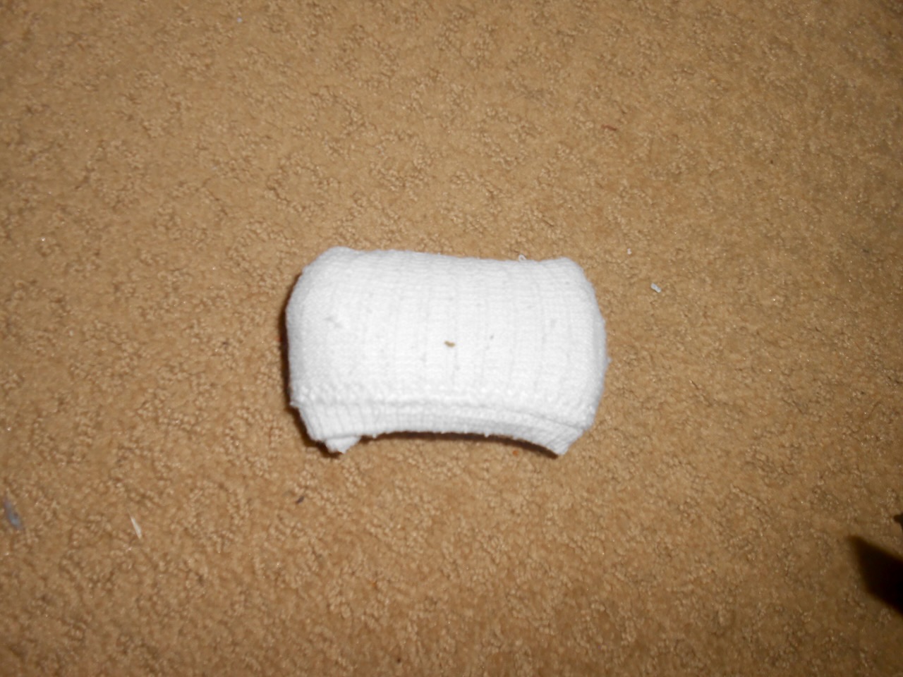

In this bottom image, you can see where the sock has captured a shot pellet.
The pellets from my Crosman 2289 do not penetrate the sock, all the way through. Rather, it catches them and holds them. It is also a far quieter backstop than the wooden fence boards.
This also really well defined "same hole" shooting.
Because the sock captures and holds the pellets, I was able to same hole the target, literally same holing. I know that because one pellet hit directly into the backside of an earlier pellet, and, the two forged themselves into one long pellet.
