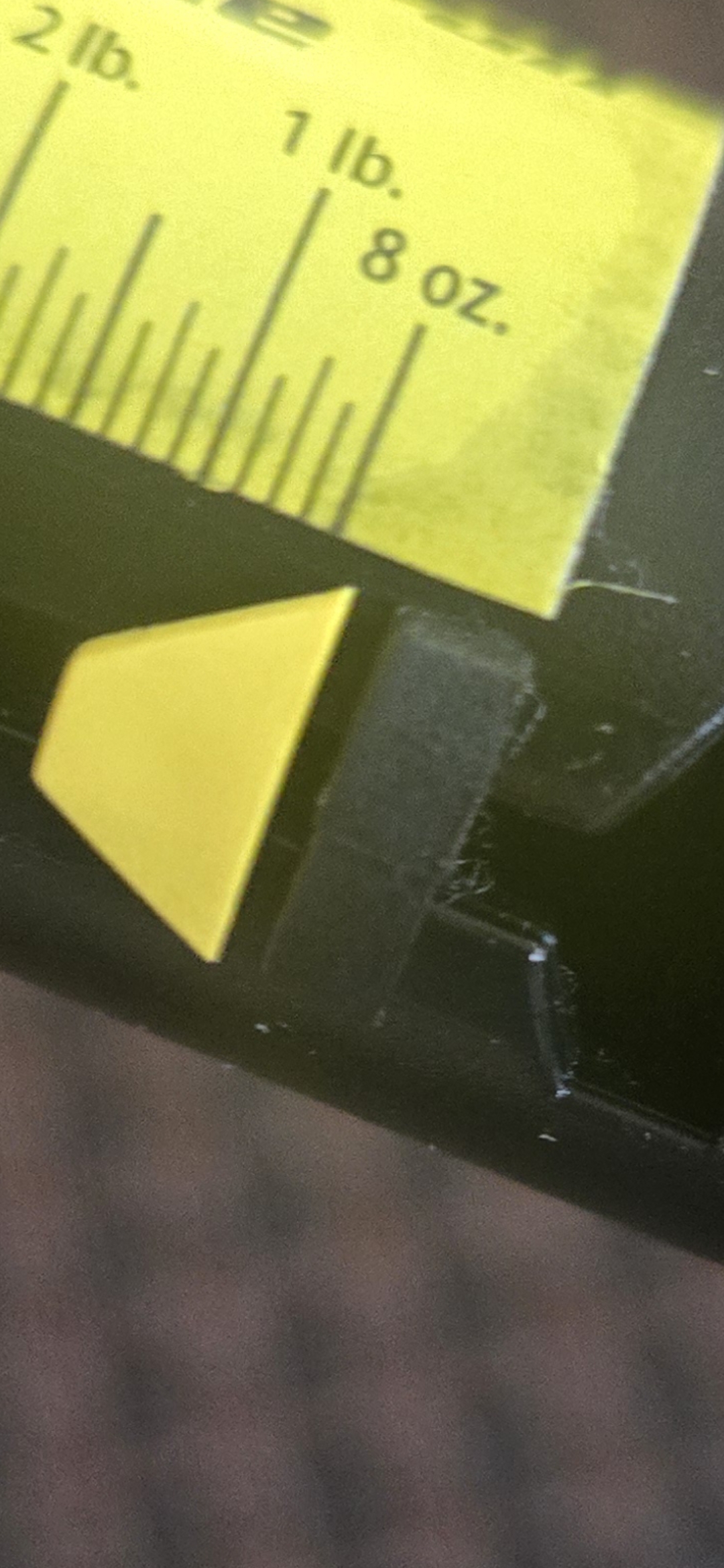

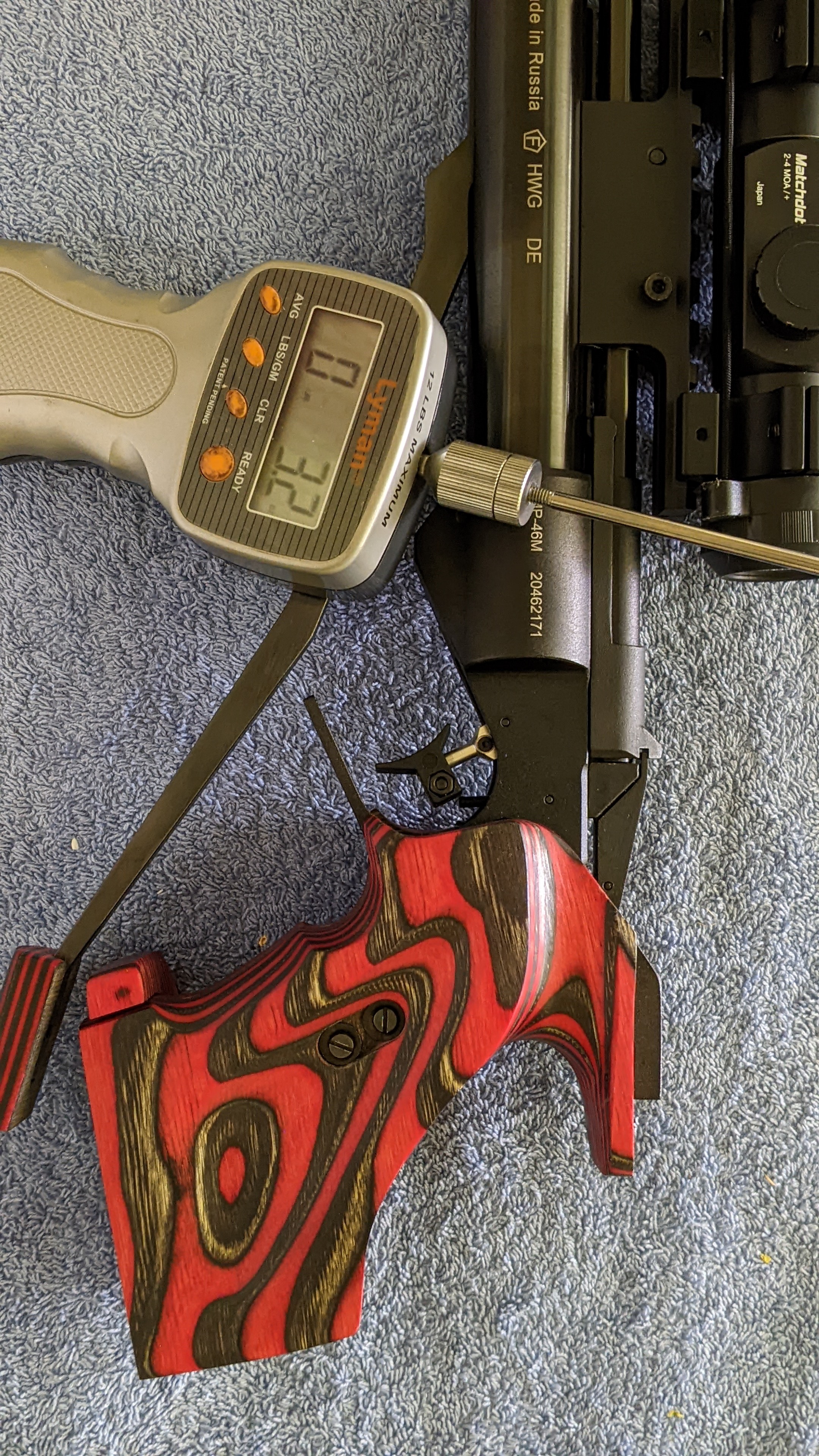

What tester are you using, and when was it calibrated?
Most times the crap gauges you buy are inaccurate and garbage. Any amount of twist or side torque will give a false reading. You need to have the rifle bolted down, and the gauge in a jig exactly parallel to the trigger. And then have the ability to pull directly back on the EXACT same spot in the trigger.
If you can't do that....then don't take the measurements seriously

Actually read and do some searching. The amount of variation in those basic gauges is amazing. To actually test a trigger you need a test stand. Other wise your results are all negated and subjective.

In measuring trigger pull, your technique has to be correct. If pressure is applied in a very fast motion, a spring activated gauge will read heavy, and a digital measure will usually be low. It's important that you gently squeeze pressure, just as in actually releasing a shot. I don't understand the purpose of this thread, but a photo of a trigger gauge is meaningless, as is even an accurate measure. A one pound crisp, high quality release is easier to shoot well than a creepy, erratic 6 oz trigger.

I have the same crap gauge. It’ll tell you how many pounds but it gives no data on less than a pound. The half-pound marking is dubious.
I do recall checking mine by picking up a known weight by the hook and mine was pretty close for that.
