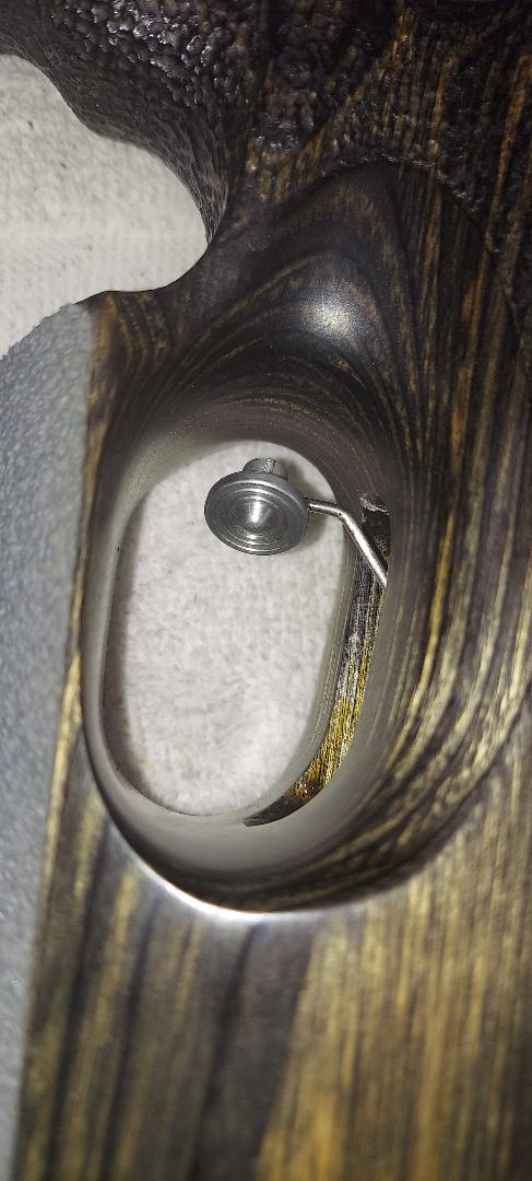

Triggers set up as SINGLE STAGE and using a button type contact are the BOMB !!! The contact area is VERY small & you can feel it against your finger tip pre break point ..... set as such a conventional curved "Blade" is too vague covering too much finger area and the break or really having a feel is soooooo light it does indeed honestly not work well at all.
Here a button type.
The O.D. about 3/8" and the raised "Button" that allows finger sensing and position @ .125" at base to an @ .080" rounded tip.
Trigger pull weight give or take 2 ounces set as a single stage and very intuitive in using (y)
* You can rest your finger on it and know your on it !!! ... pressure beyond feeling the contact pressure it fires & it's Just sublime.
