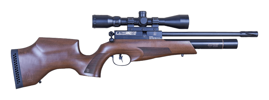

This rifle new is $859 at AoA. This one is in .177 or .22. 32" long . . .60 shots per fill . . . Seems like the perfect backyard friendly pester to me.

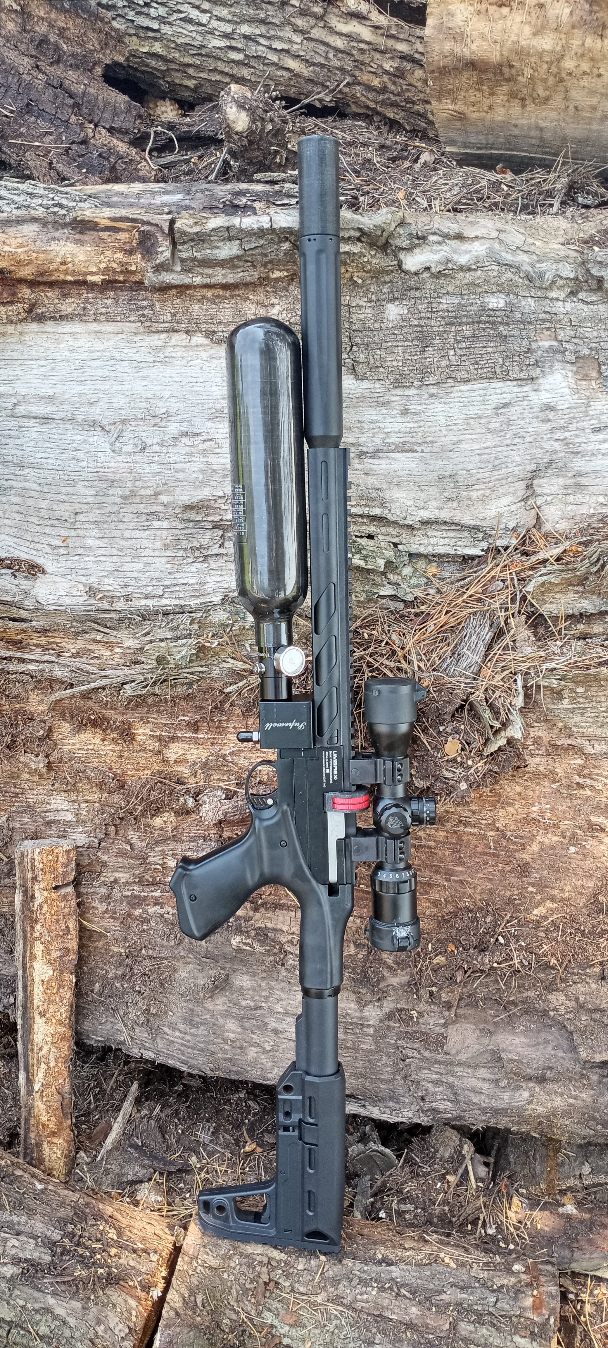

Hmmm, Notos with a bottle (you choose the size), regulator, drop block conversion. Up to 4500psi fills.
I do the conversions inhouse, they are very affordable.
