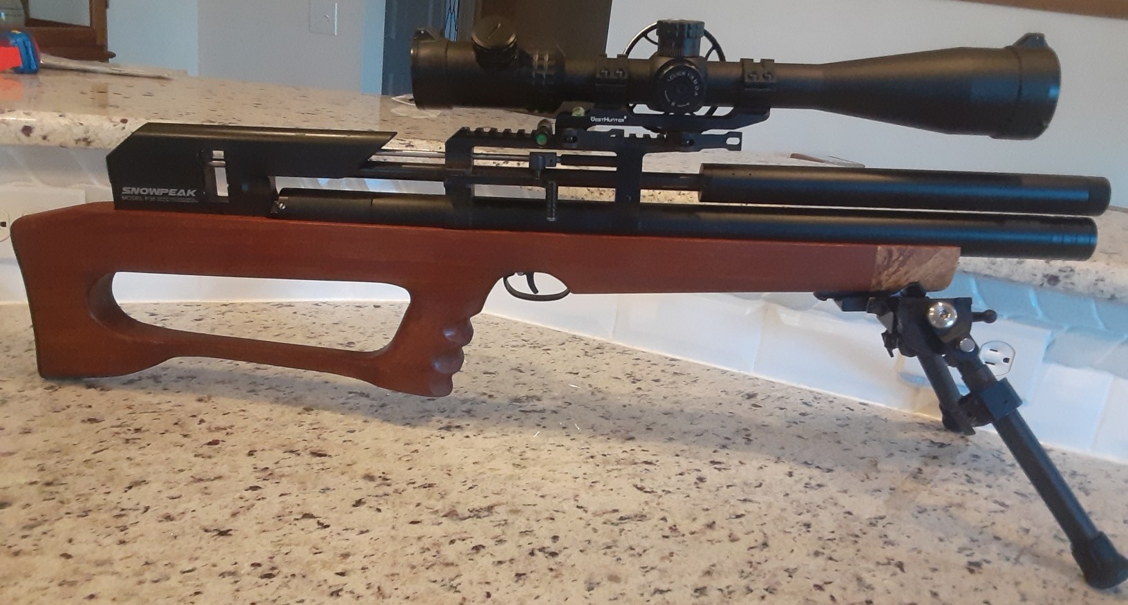

The picture is my P35-25 tuned to almost 50 fpe in it's home made stock. It gets about 40 shots per fill with this tune.

The OP also mentioned target shooting at 30 yards. My P35-22's top 30 yard challenge target is a 200/15X. My P35-177's best is a 194, I think. My P35-25s best is a 192. I retuned the 25 to raise it's power and it's accuracy improved a lot. I'm messing with the tune of the 177 to see if I can improve it at the moment. I haven't shot the 25 much after the retune, I am supposed to have a new barrel on the way. The 192 is out of only a few targets since the retune, I'm sure it will do better. They are accurate guns. The 10 ring on the target we use is about 1/8th of an inch in diameter. The X-"ring" is a dot.
