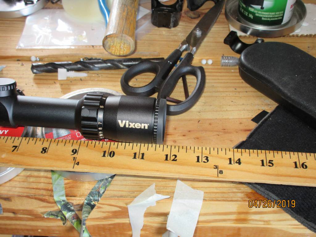

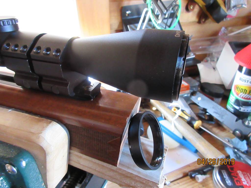

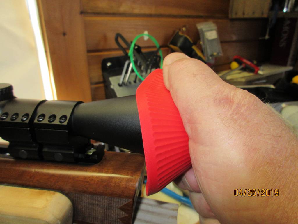

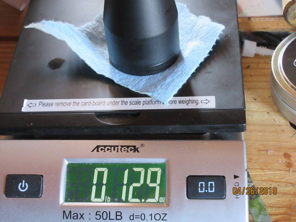

Lightweight Vixen 1 inch 3-12x40 scope, I may put this on my Vixen when I get it.. How is that, a scope named Vixen..😁 I bought this from Cheaper Than Dirt. Very crisp glass, ret could be a lil thicker for these old peepers, but not bad. I changed the parallax from 100 yards to 40. Was easy to change, the objective lens locker ring was easy to loosen, did it with a rubber jar gripper by hand, no glue like some are today. Will work well from 20-50 for hunting. Starts to get a little out of focus at 60 yards on higher powers, due to the parallax change I did. Might make a good tree squirrel scope, at least it does not weigh a ton, like some I have. Will see. Made in Japan. 12.9 oz.
