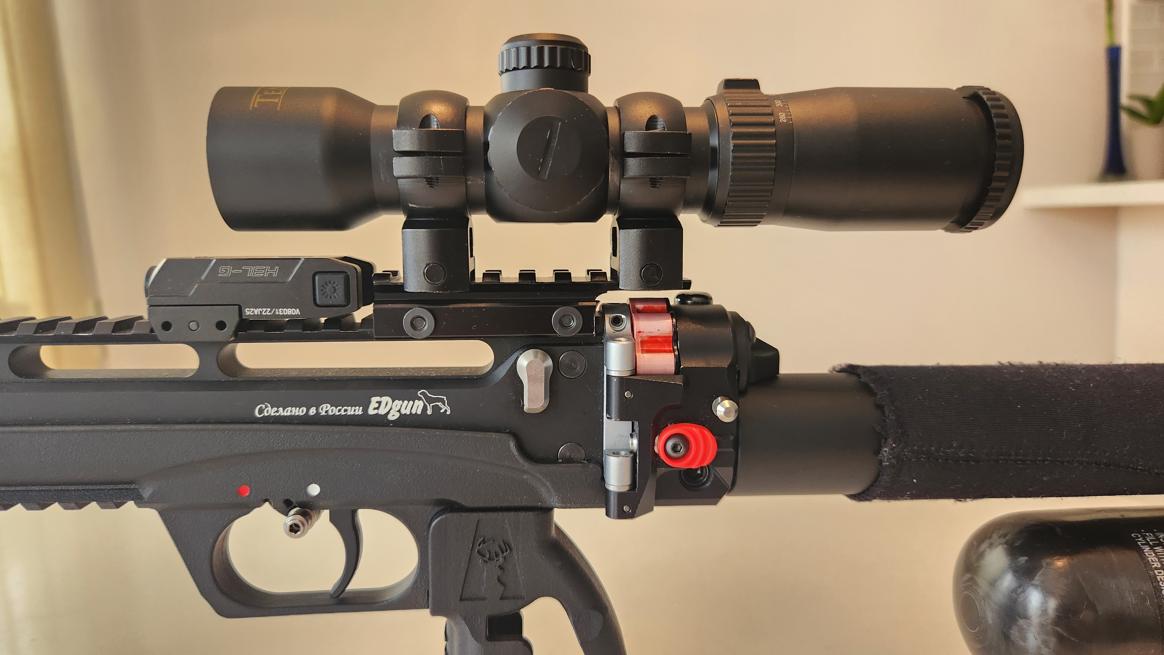

I just pulled my wallet on a IO prism sight, this is my second attempt. First time I had the 14x50 but traded that one because it was extending beyond the L2 mag very aggressively. Now I am getting this 5x30 with longer eye relief, but also shortening my LOP (replacing the air tube with 40 mm shorter) so I can mount this scope more forward.

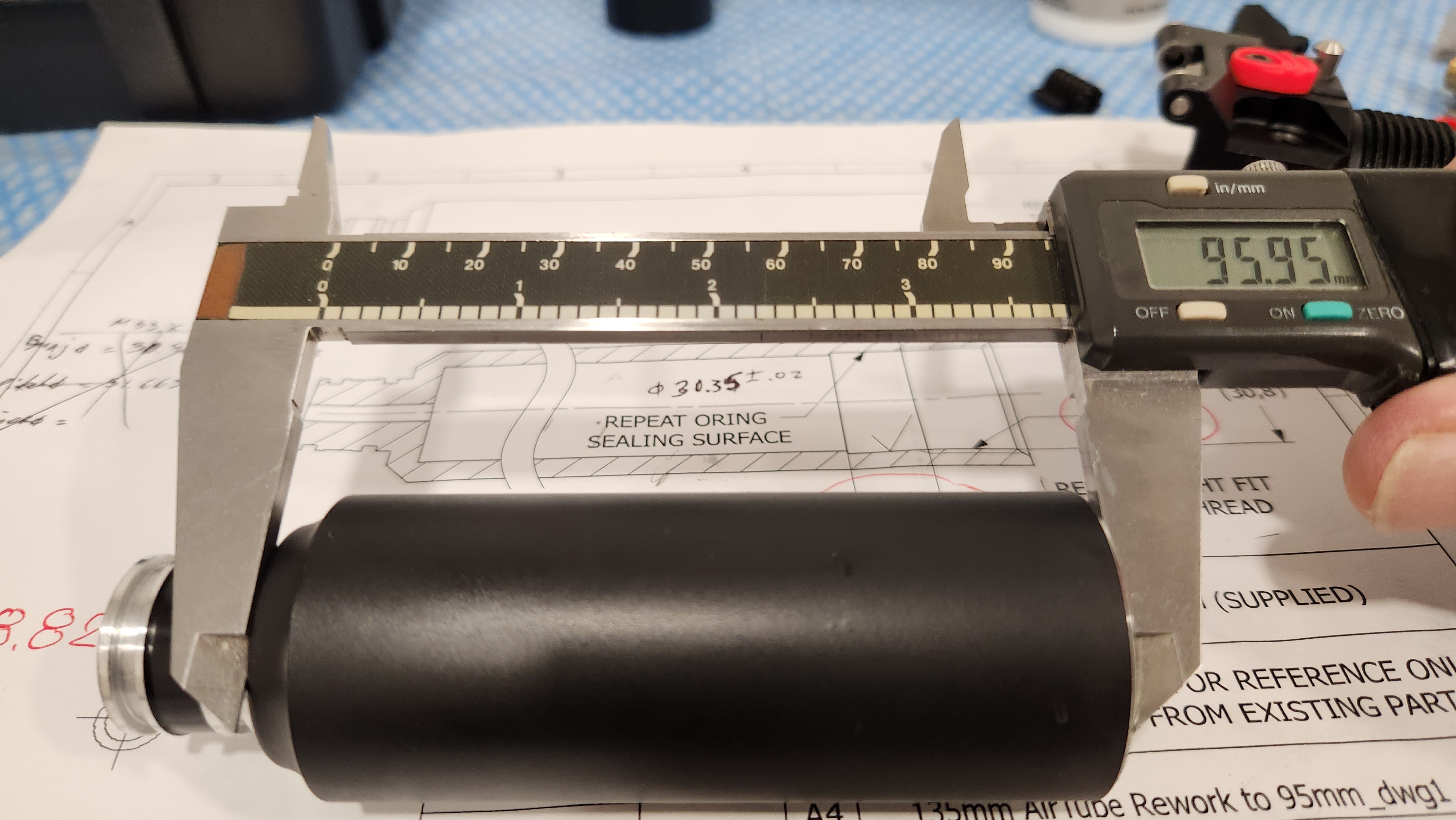

I will take the air tube today to a cnc lathe shop, I want it shorter for 40mm. The guy is busy right now, but he can re-cut it for me in couple days. Also taking two AP barrels to remove the M14x1.25 and re-cut to 1/2-20 so I can use the FX shroud.
A shorter LOP shall give me a more comfortable eye box with this IO 5x30 prism sight.

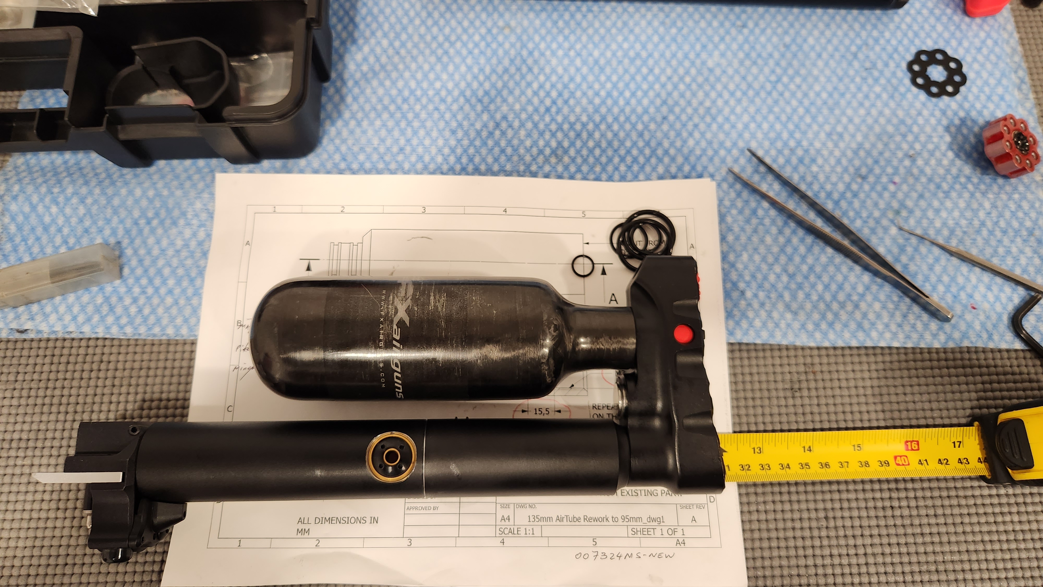

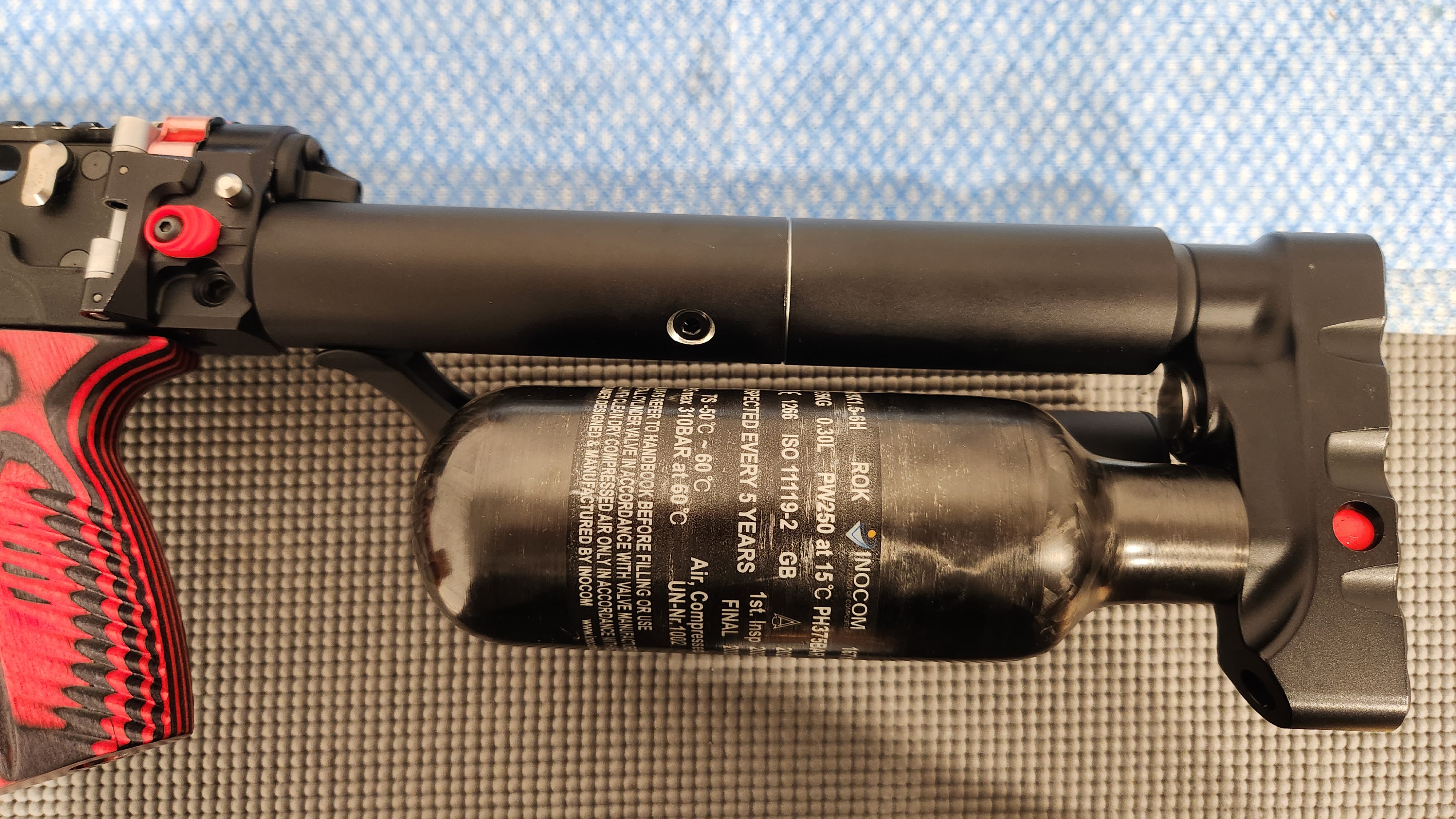

I received my parts from the machine shop and today I put my L2 together.
This what I did :
Cut the length from 136mm to 96mm, and that shortened my LOP for 40mm, which is finally correct to my body/posture.
This means, any shorter eye relief scope or sight can be moved forward still maintaining the eye box.

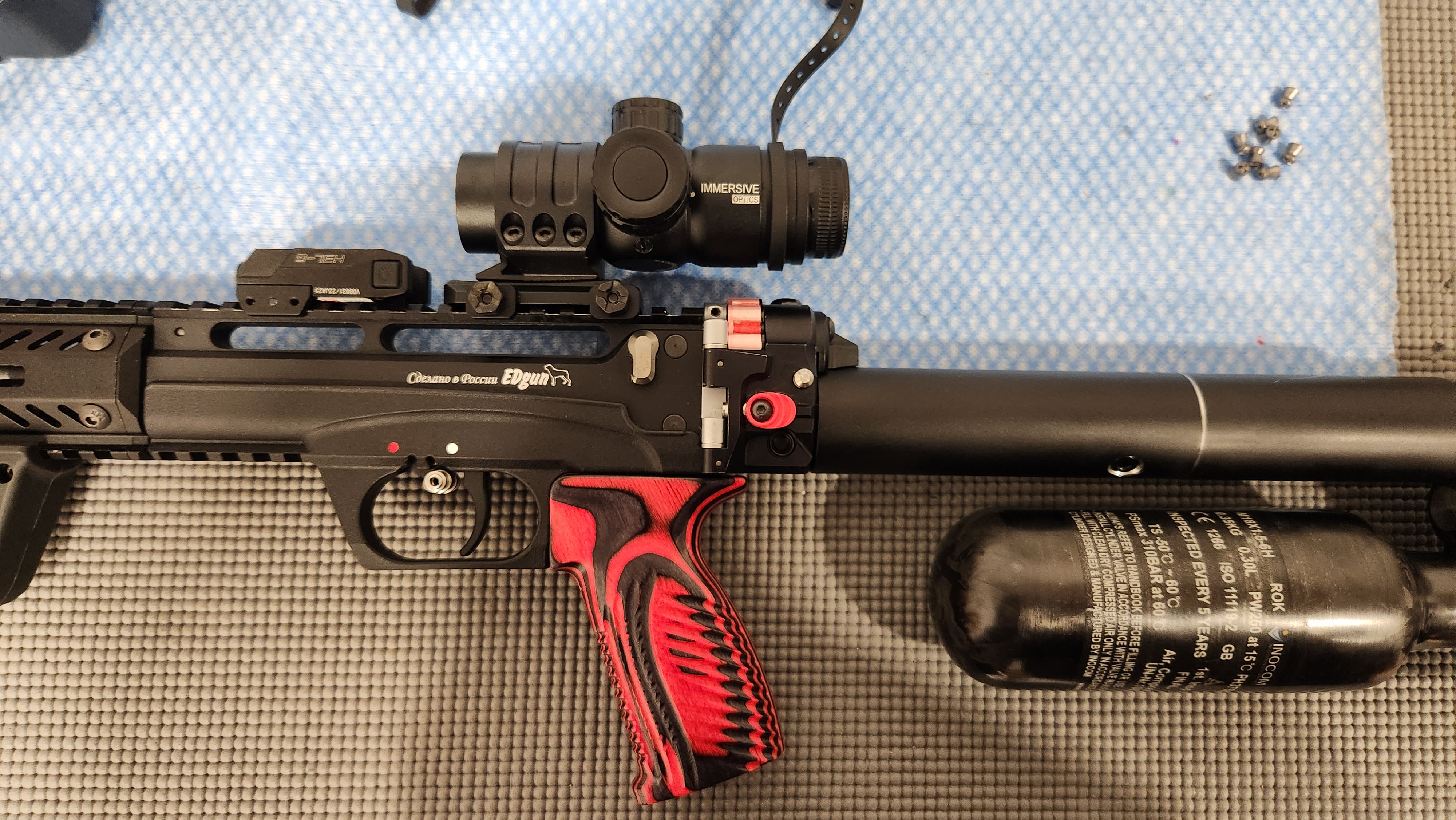

My new IO 5x30 is in the mail, I think the ETA is tomorrow, will post a pic when ready.
