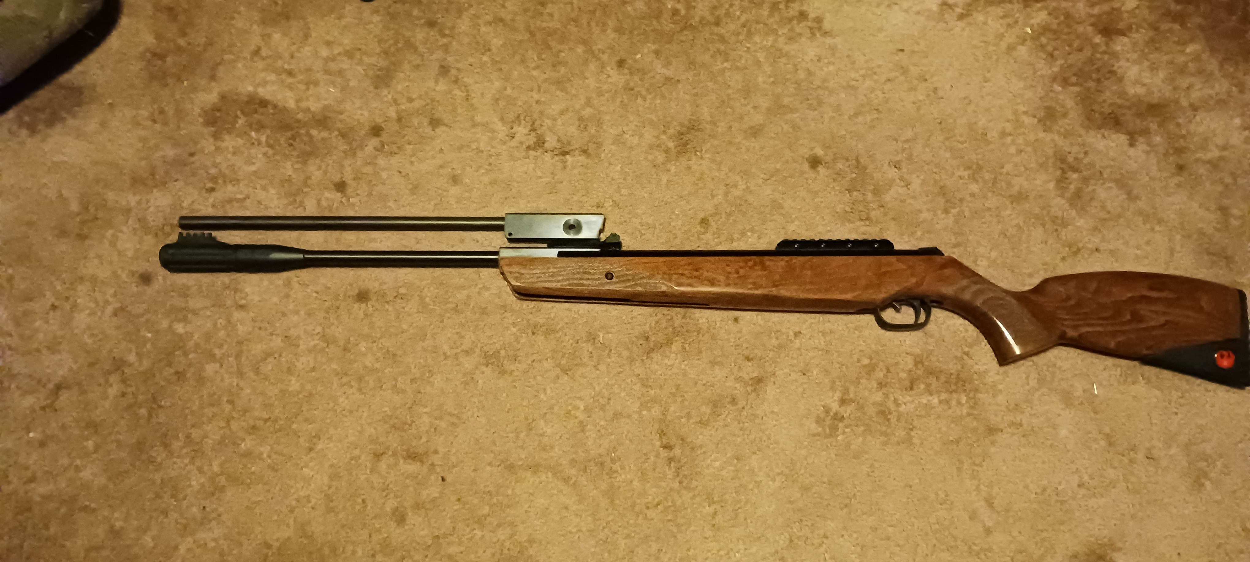

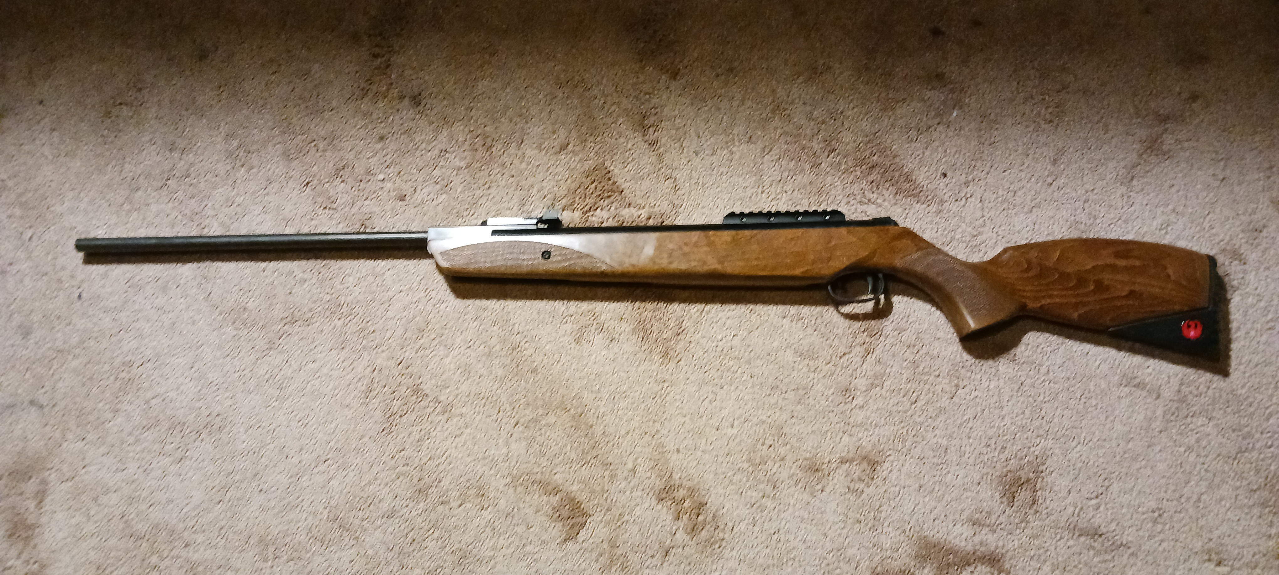

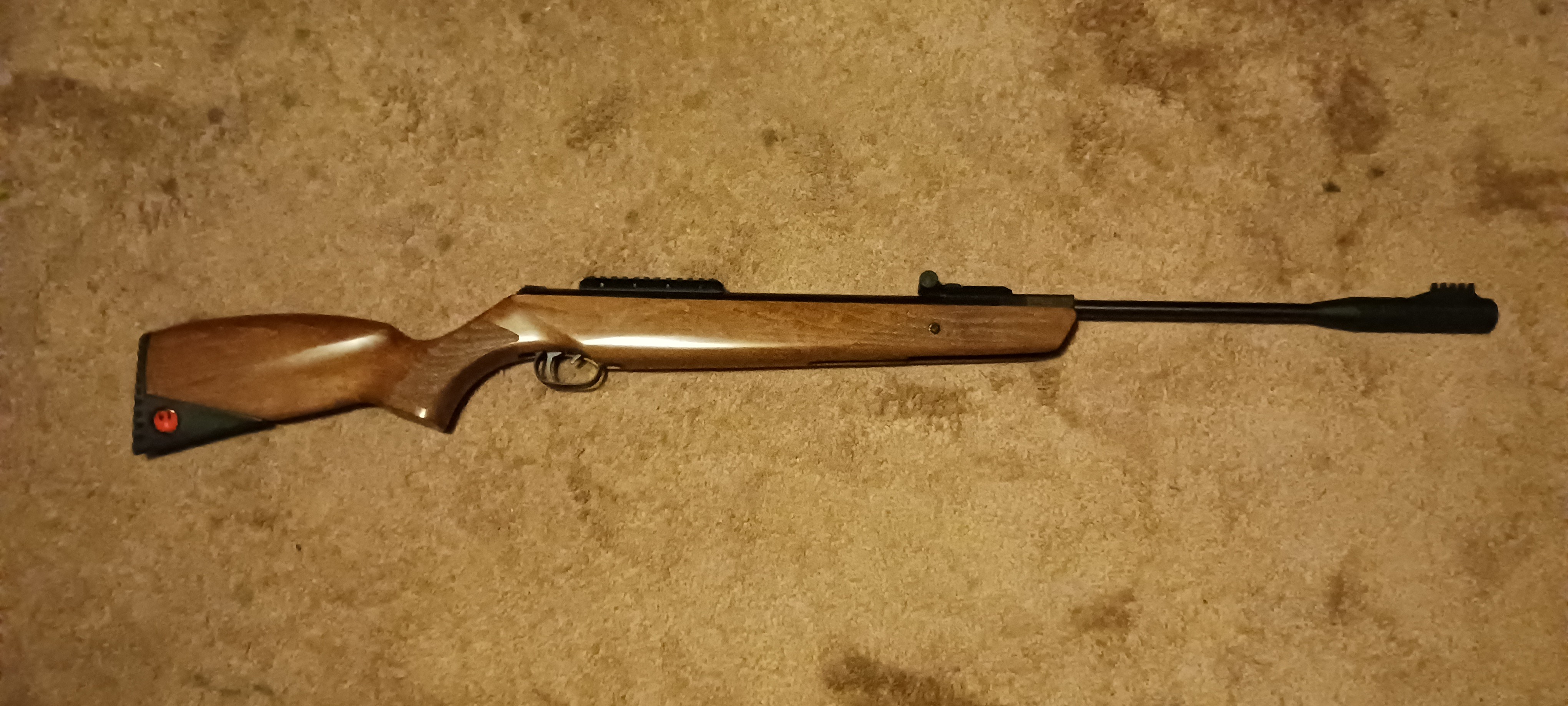

Like I needed this. Bought this Ruger Yukon .177 for $80. My thoughts were. I have a couple extra barrels from a XS28M. Have the .25 on mine. So I'm going to use the .22 barrel from the 28 swapping them out. Mike M told me no problem will work perfectly.
I probed the muzzle baffle and the barrel is shorter on the Ruger. Installing the .22 from the XS28 the barrel will be longer about 4 inches and the rifle itself should have
a cleaner look.
Hope the barrel swapping works out. I'm not a fan of big heavy springers spitting out tiny .177's. I don't know anything about the Ruger Yukon, but it's a good-looking rifle with attractive wood. Nice buy for $80.
That is my thoughts. It needs the .22 barrel. It will probably shoot a 21.5 grain nice. We will see.

The barrel is changed. I would like to find a simple slip on front sight, with a grub screw for holding it. The barrel is 16mm.
Anyone know we're I could get one. I'd like to shoot with open sights. View attachment 328784
