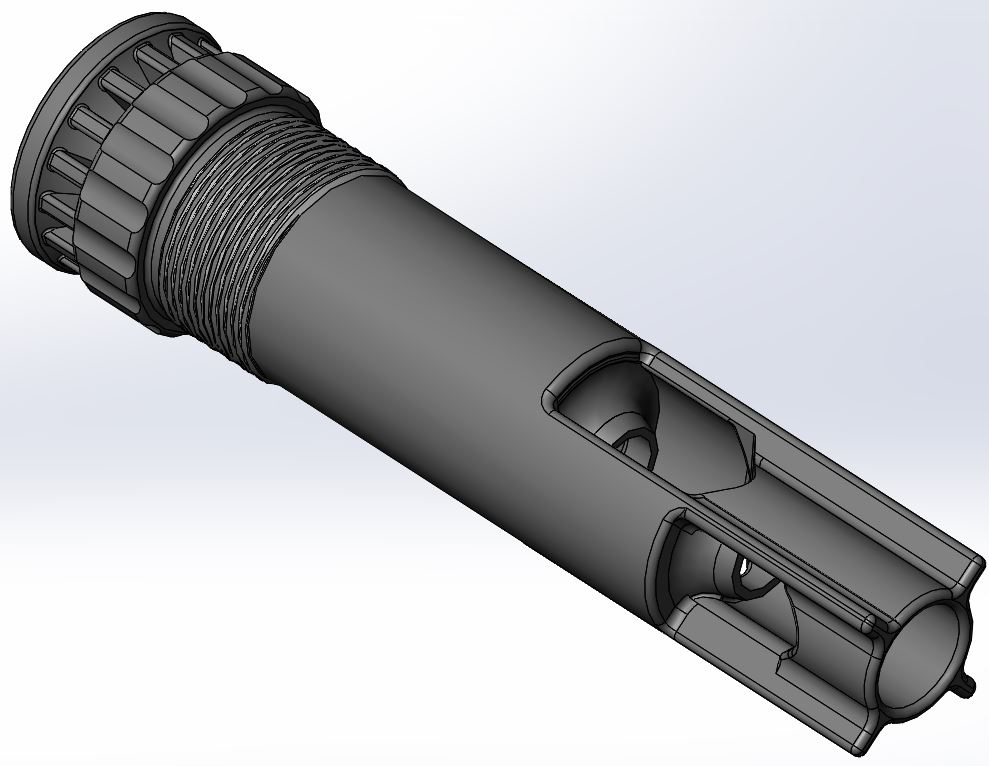

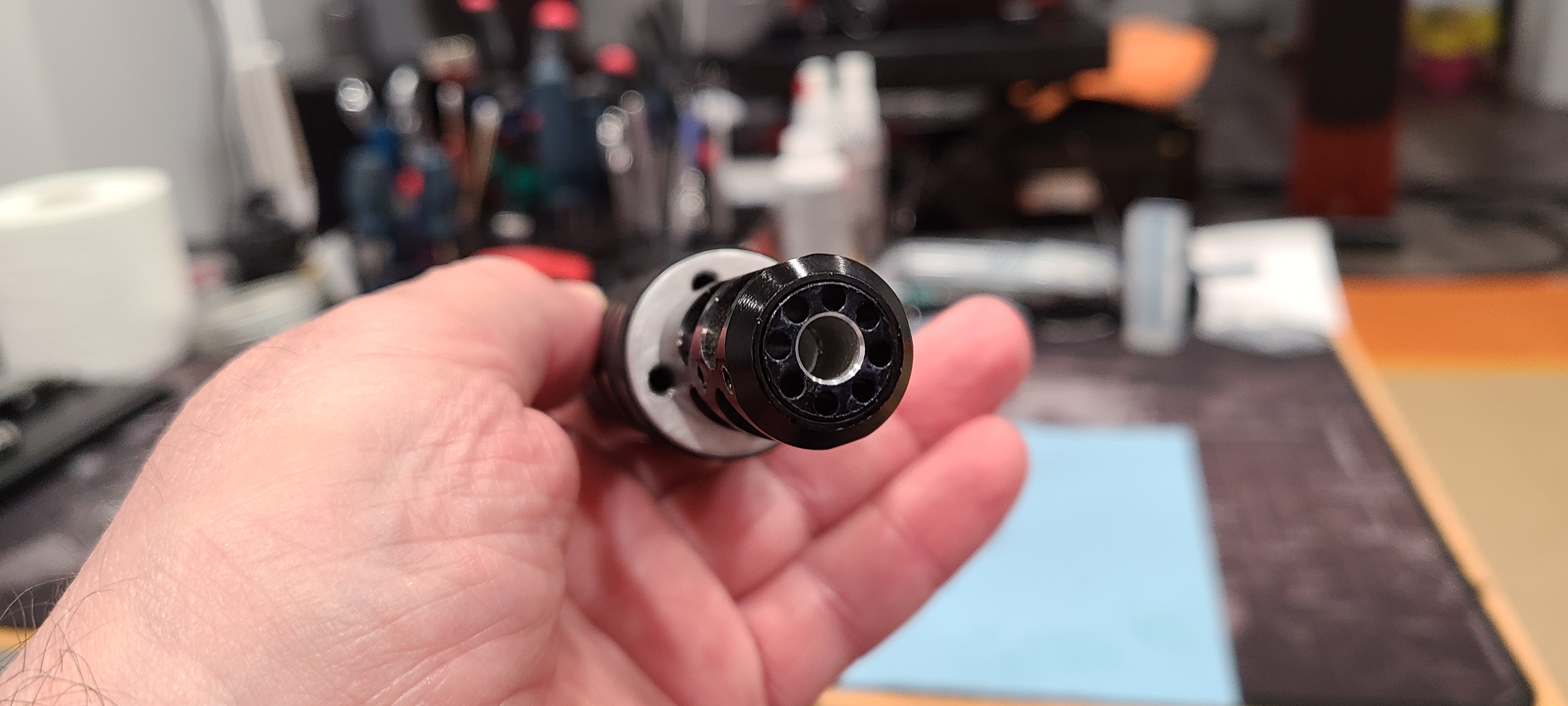

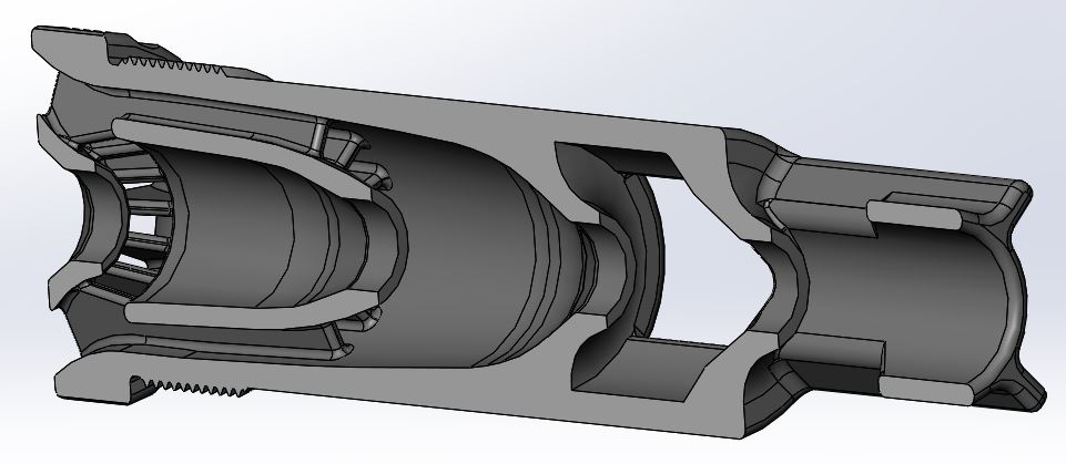

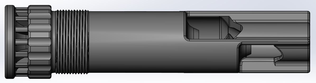

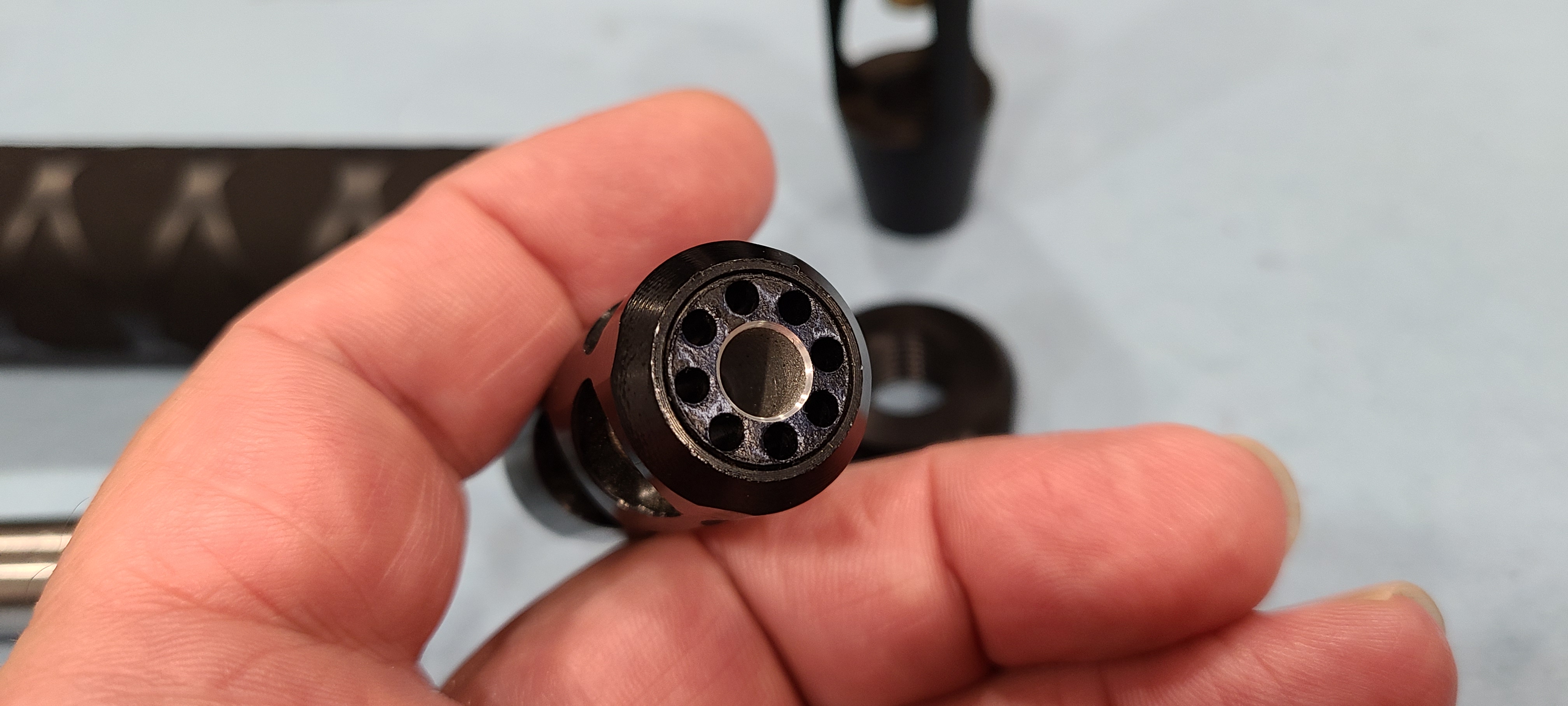

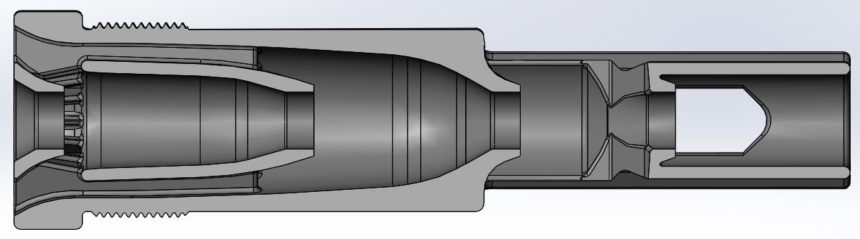

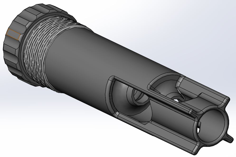

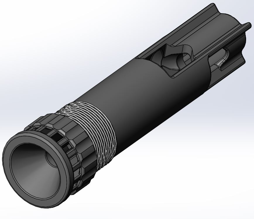

What are your goals / concerns? The guys that tested my linear and radial comp designs said it was loud, compared to the muffler inserts I designed for the Avenger PCP. I think that was expected. Its purpose is only to clean up the air in the pellet path.
Here is the front end of such a 3D printed air stripper / linear comp I designed for the Avenger. It sports a double reflex air stripper, feeding the rear of the shroud:
Here is a variant with radial vents in front of the shroud:
