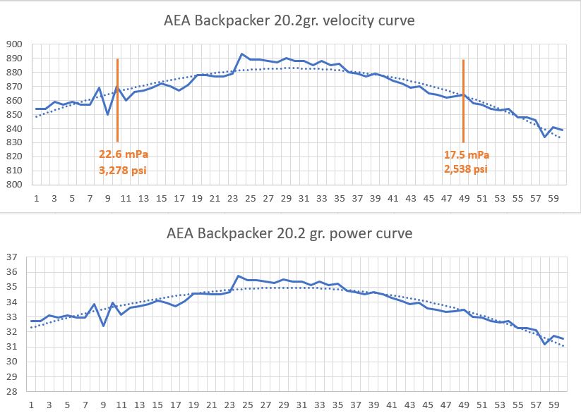

Here is the velocity/power curve I generated from 20.2 gr. NSA's. They weren't accurate or reliable in the magazine but it gives an idea of the amount of shots you will get at a reasonable velocity range. I will rerun sometime with JSB 18.1's which are very accurate and reliable in the magazine.
The string starts at 24 mPa and goes to 16.1 mPa.
I've been filling to about 22 bar and refilling at 18 bar.

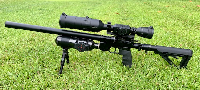

I mounted my ATN 4K Pro scope to the Backpacker today. After sighting it in, I calibrated the RAV (Recoil Activated Video) and shot these 10 rounds to test it out. Not too shabby for a compact semi-auto!

This should be good enough for shooting rats! Here's a picture of it all set and ready to start taking out some little fur balls!
That simply looks awesome! I'm VERY tempted by the ATN 4K scope
If you do decide to get one, go for a refurb! That one is a refurb and I've not had a single issue with it! I also have one I purchased new that was nothing but problems. It continually locked up, went blank, froze, etc! I contacted ATN and they issued an RMA, my replacement is on it's way. I hope it's as trouble free as this one has been. Also, go for the 5-20X, you don't have to zoom as much and the video is clearer. That one currently on the Backpacker is the 5-20X. The replacement I have coming from ATN is a 3-16X, it will go on the Backpacker when it arrives and this one will go back on my Crown Continuum!
Thank you for the great info! I just pull the trigger on the 5-20 4k pro refurb with refurb range finder, in theory I'll be straight up cheating in 7-8 days, can't wait! I hope i have the same luck with the refurb as you did, it saved over 200 dollars on the combo. Given it's directly from their site and I even created an account I shouldn't have issues with warranty, granted I hope I don't have to ever use it.
Also saw your remote setup and had to have it!
