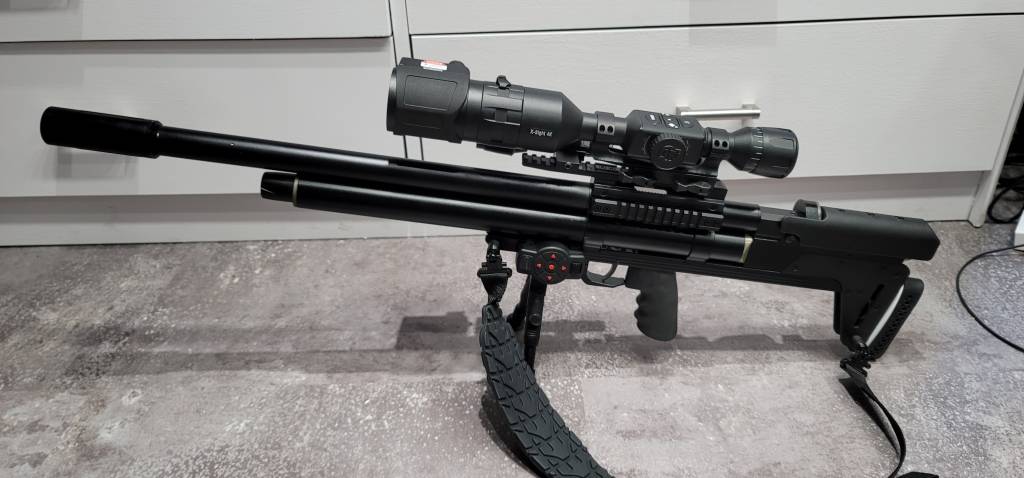

Little semi-auto AEA backpacker harvests it's first squirrel.

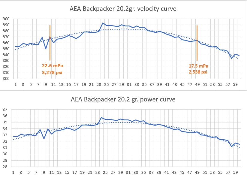

It looks like that Huma regulator would fit, and then you could air up the bottle to 4500 PSI and get more consistent and a higher number of shots per fill. The only real issue I see is that Huma's own documentation is iffy at best as to the maximum pressure setting, Huma lists either 150 or 170 bar and Trenier says it's a max of 190 bar. 150 bar is about where my gun starts to act unhappy and doesn't cycle semi-auto reliably. If it can go up to 190 bar that would be perfect as it's just on the down slope of DanielL's velocity chart:
<--- credit goes to DanielL for this

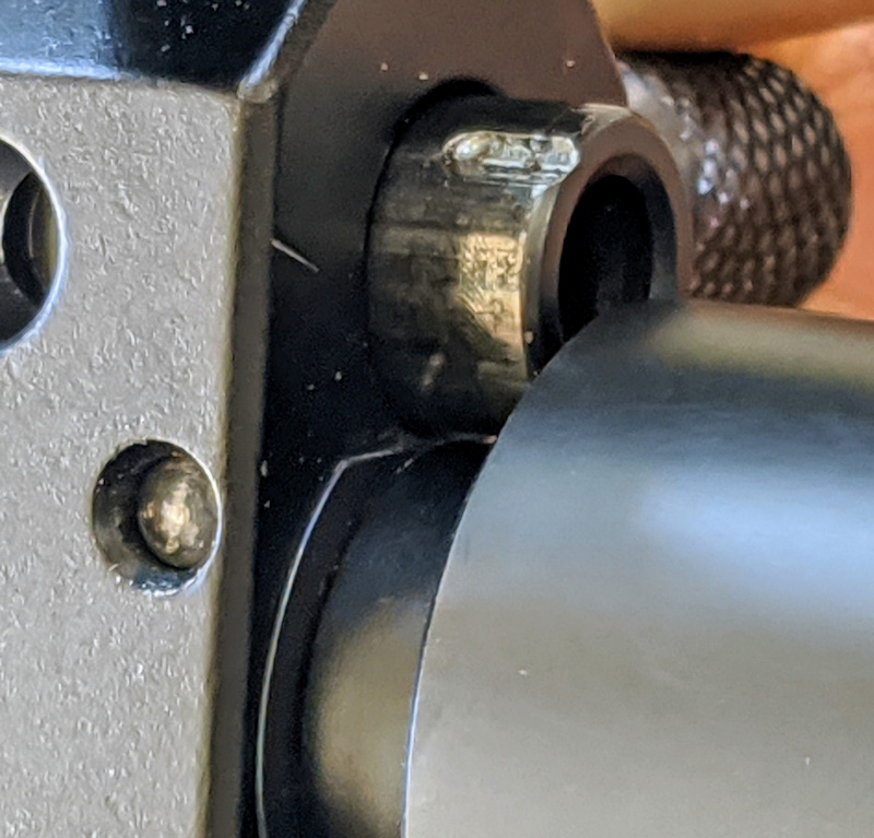

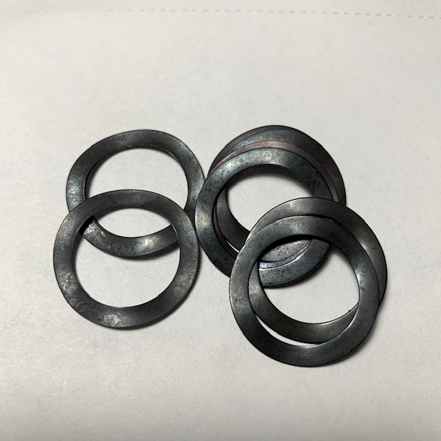

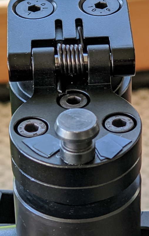

I received the wave spring washers I ordered from McMaster Carr. Just 1 is all it took to eliminate the slight wobble where the folding stock adapter attaches to the breech. It feels rock solid now!
Here's a link to what I bought if anyone else is interested: https://www.mcmaster.com/catalog/126/1394
The size is ID: 0.689"; OD: 0.937"; Thickness: 0.012"; Working Load: 40 lbs
These fit perfectly and are barely noticeable. The working load is plenty strong enough to give a good solid feel, but not too much that you can't compress it enough to get the pins seated. It's definitely an improvement!
Got mine today and put on semi-auto and lever action. Worked great. Thanks for the suggestion. Lever action's bolt travels further so I had to grind away one side of the wave washer and orient it correctly. That was a PITA.
There was one other looseness to be fixed; the folding pivot. I added two layers of electrical tape to the end by the closing mechanism and now there is no rattle whatsoever. 👍

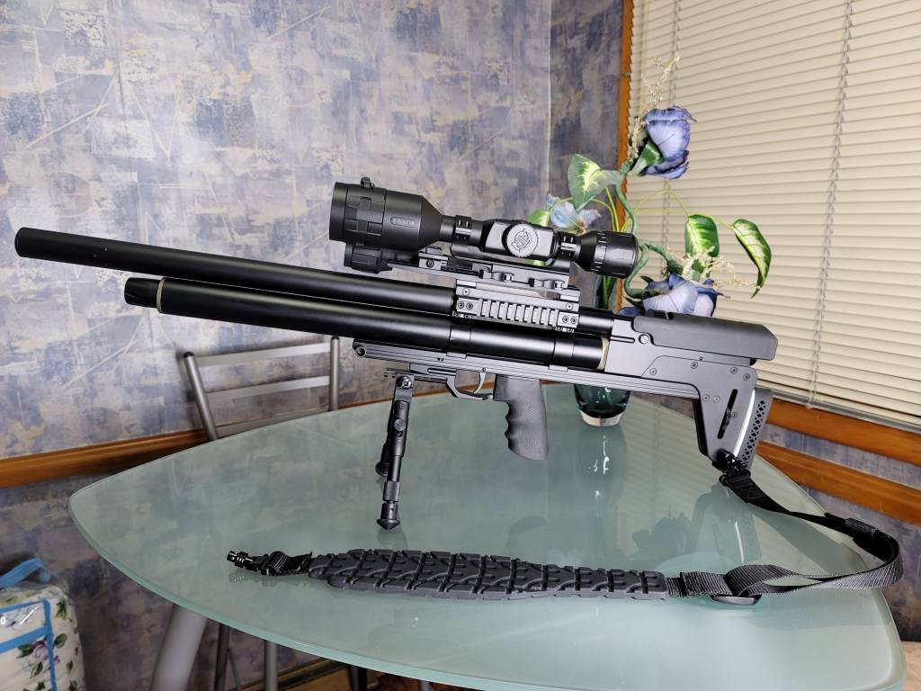

I bought the AEA HPBP .25cal. I was in love with the gun, but for $850, a few things started to get under my skin:
  1. The advertized power was 80fpe, but the gun only does just over 50fpe. This is because it only has the soft spring. We are supposed to get a strong spring, but that hasn't happened, and probably won't happen.

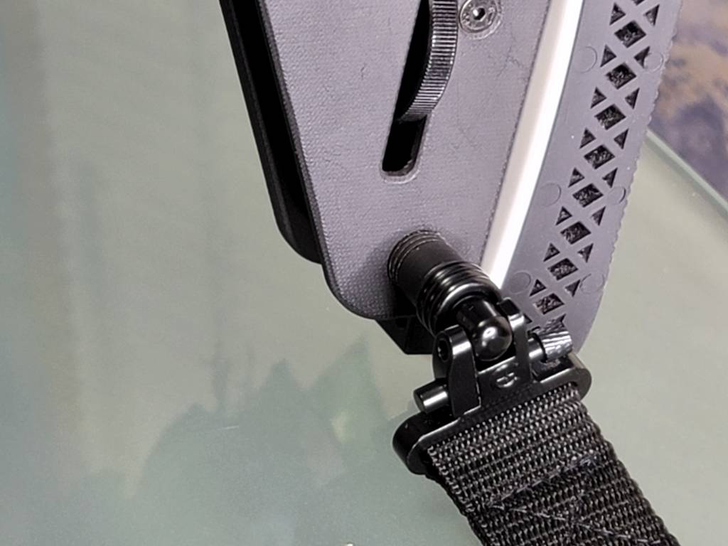

  2. No Sling Mounts: So I installed MagPul system mounts myself.
  3. The Trigger Guard pic rail is only mounted to the frame with one screw. If you use it with a bipod, it will work itslef loose in short order.
  4. Out of a few hundred rounds, I've gotten around 3-4 magazine jams. The gun was within the specified pressure range for semi-auto function.
  5. I hate everything about the trigger. I measure 7.5 pounds and I pull damn near every shot because of it.
  6. I added a DonnyFL Tatsu, and when installing it, the shroud material was very soft and prone to cross threading. This had the suppressor cock-eyed a few times, but I bought the .30cal version which gave me some slop so I didn't clip pellets. Hard to saw how well this will hold up in the future.
    [/LIST=1]
    Currently, the gun is now jammed. I have contacted the distributor for a return for repair and modification for the bipod pic rail to be moved to the frame. I really do love the concept, but these mechanical semi-auto guns trigger pull just is killing me! If I just shoot the AEA for a week, then I start to get used to it. But if I shoot my Benjamin Bulldog just once and have to go back to this single stage crap, I most always feel like the gun's safety is still on; it;s just that hard to pull!
    I think I may sell it at a slight loss after return from the dealer and go with something else...
