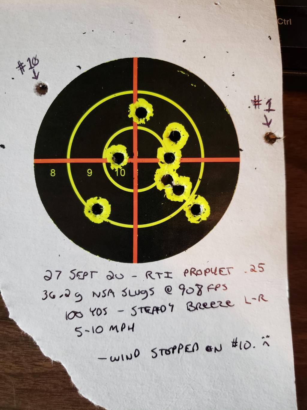

Playing around with another one of my toys. It's amazing how the slightest little changes can make a big difference. Readers digest - I had an initial tune set on this gun shooting 36.2g ( .25 cal ) slugs at around 906fps. They were pretty good at 100 yards but I thought could have been better / a tighter group. I figured if I adjusted the power a little to send them 915 - 920fps that might tighten them up.
____ NEGATIVE ____
Instead the grouping (at pretty much all ranges - 40, 70, 100 yds) opened up and got worse. I backed it back down and now have it settled at around 908fps. Not to shabby considering there is a little bit of a breeze going on now - good thing about the wind was that it was mostly steady. Operative word in that last sentence - "mostly".
Marked - shots #1 and #10. #1 was basically the sighter - ok - wind is pulling a bit to the right - I'll just compensate and hold off to the left. Guess what got turned off / stopped at shot #10? {sigh} lol

Ummmm ... if memory serves - you too recently purchased an RTI Prophet? " Every first shot on a new magazine is off because regulator pressures seem to change as the gun sits. " - I believe as mentioned recently, this is, unfortunately, a known "bug" with the RTI reg. Hopefully they'll address it / come up with a solution and replace existing customers regs or at least offer up a good one for a reasonable price point. I just dry fire a shot after each fill and watch the reg gauge settle to where its supposed to be. Ideal? - No. Waste of air - yeah. {sigh} Better than wasting a shot though.
As to your gun apparently "changing all the time" (?) - it certainly shouldn't be doing that. Find an ammo that it likes, figure out a reg and hammer spring setting, get it zeroe'd at ( in your case - 25yds ) and then just go from there. If 25 is you're zero then you'll have to figure out your hold over / hold unders and/or get an app like strelok pro and mark up the elevation turret on your scope so that you'll know how much to dial it up/down for a target at a given range.
Twiddling with them ( the guns ) is part of the hobby (I believe) for a lot of the guys in here - myself included to a degree. I've got four now - three of which I no longer fiddle with - it can take a while and some hair pulling (lol) to find and settle on a good tune. My .22 Taipan Long shoots lights out ( like laser accurate ) with it's current setup - I'm currently shooting 23g H&N slugs out of it and it's crazy accurate and I still get a decent shot count out of it as those slugs are on the light side (for slugs) but they still pack a punch on woodchucks and other critters - out to and beyond 100 yards. All I do with that one now-a-days is feed it air and ammo, and periodically clean the barrel. I ain't dinkin' with it! :)
The fourth gun that I recently purchased is my RTI and I'm about done dinking with it now (finally) as I ~think~ I've found a pretty decent tune with it and the NSA 36.2's.
