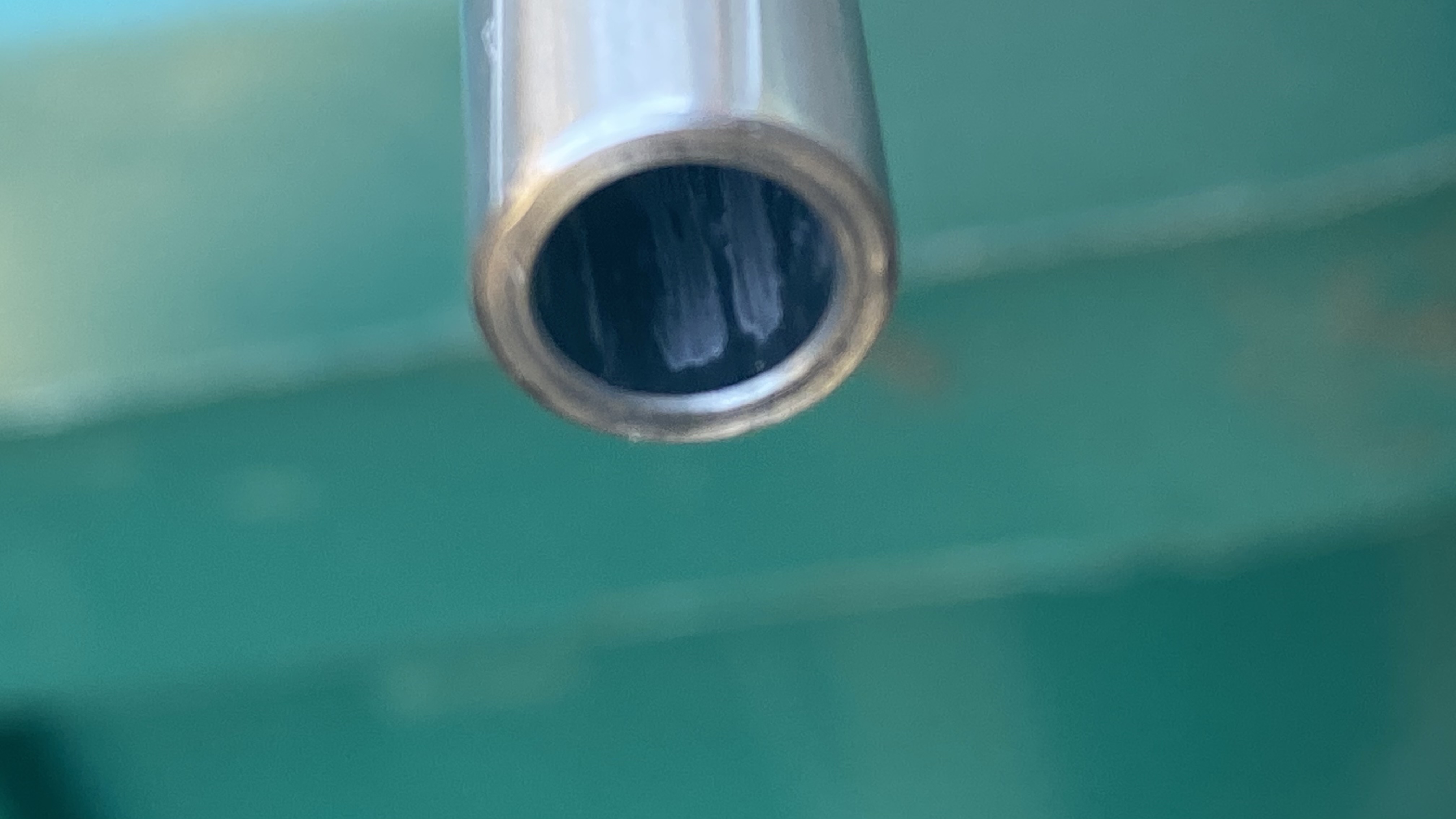

I tried Altaros queen slugs dry, fouled up the barrel in just over 100 rounds. So definitely need lube! Will try pledge also.

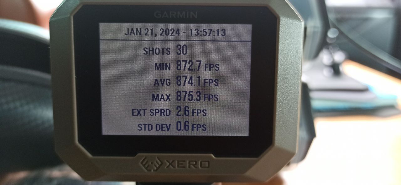

Personally, I shot for several years without oiling (lubing) our slugs, but recently I started lubing especially for the long versions of the ATP Super King 59 and 67gr. It is possible to shoot without lubrication, but by lubricating you can increase the time before it is necessary to clean the barrel.
I personally used the classic spray from Balistol for a long time, but I also tried the Power Air Gun Oil and both worked very well. The advantage of Power Air Gun Oil was that it is, at least for me, gentler on the skin and is less greasy, so the slugs are easier to hold in the hand when loading into the magazine.
Greased slugs also have no problem achieving a consistent muzzle velocity, although there could be some variation with large temperature fluctuations. (I haven't recorded this yet, as I haven't had the opportunity, fortunately, to shoot at -20C for example)
