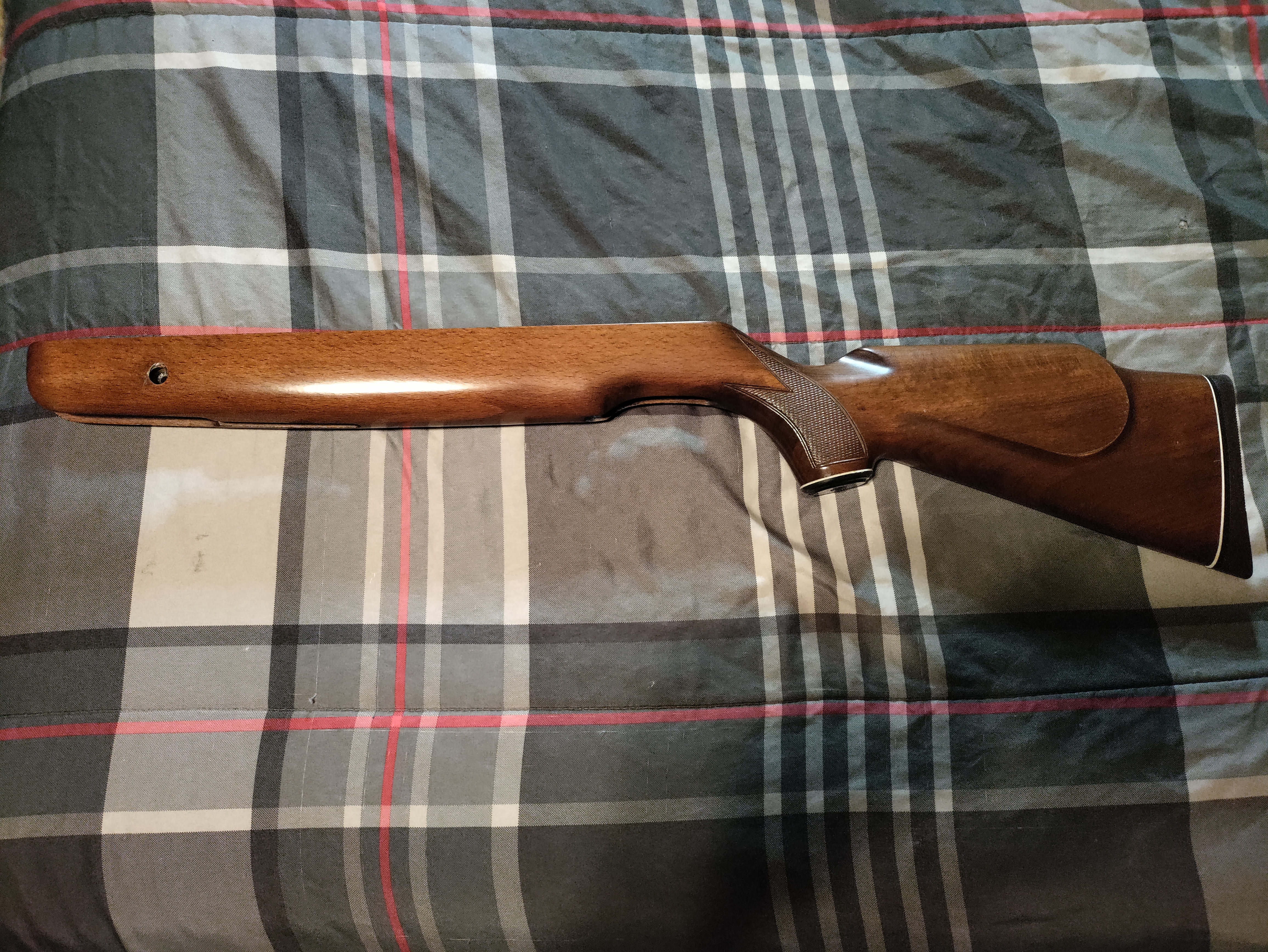

This is the original stock that came with the gun.
Someone drilled the forearm screw holes deeper for some odd reason and I'm going to make some custom cups to take up the space! That's why it's in an older 97 stock!
The last owner didn't know how to fix the original. 104xxxx serial number and it is a Mk1... One of the very last!
The last owner didn't know how to fix the original. 104xxxx serial number and it is a Mk1... One of the very last! View attachment 278873
That’s a dandy find! Congratulations.
Another fix would be to remove the star washer and gently grind the bottom of the hole flat. Leaving the small star washer indentations is fine. Then JB Weld a Hard Maple or Beech plug to about an eighth inch short of a total fill. Then re-drill the hole as it was originally done. Keeps the stock and gun totally original.

That's actually a MK2. The underlever catch gives it away. MK1s had a ball bearing catch.
Also, the MK1 didn't have the anti-beartrap and no threaded lug for the front trigger guard screw, and consequently no pocket inletted into the stock for it.
Reactions: Bolillo
Hmmm! That might be a better plan. I do have some hard maple dowel that would work nicely!!!
Interesting!
So it's an early Mk2 then? And right before the change over point to 26mm!

Well its a little strange that yours has the larger loading port cutout like the very late MK2 and the MK3 like we know today.
I have three Mk2s, and a MK1 and all have the smaller loading port.
But by the number yours is an '86, same as at least one of mine. I cant remember the year of the others.
Either way, in my opinion the MK2 is better than the MK1. You get a solid underlever retention setup, a stock screw lug, and the fit and finish has been better on the ones I've owned/handled.
You did good. Especially getting a .22 of that vintage that shoots well. Mine is horrible. Enjoy it!
And fix that old original stock, they handle soooo nice and just look right.

Yes, re-plug and drill the holes ... nobody would notice with cups. The original stock is much preferred - it's a Santa Rosa - keep it OEM if possible.
