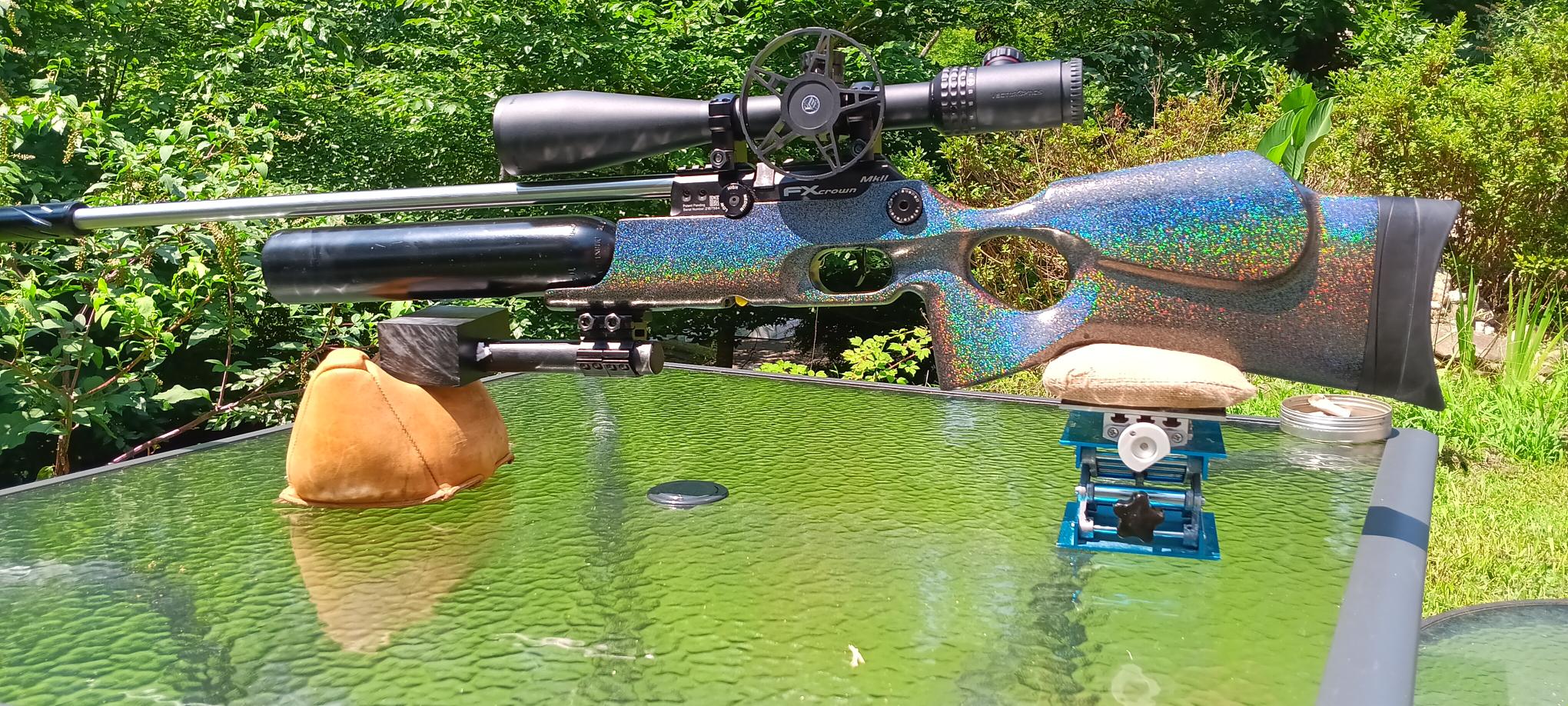

Fredick should run for politics .I think that FX would be better served by getting their heads out of their assholes and addressing the POI problem and fixing it rather than pretending that it does not exist . For what an FX cost the consumer should not have to figure out how to solve the problem after they buy it . I played with my crown for a year. I reinforced the liners with fiberglass and even drilled holes in the shroud to fill it with spray foam .I never was able to solve POI problem .I didnt want to keep the gun but I didnt want to sell it and screw someone .I recently put a LW stainless barrel on it and it is now capable in competing in serious BR competition events I have 3 RTI Prophet1s and a Vulcan3 and they all are excellent at holding POI. I will never buy another FX
