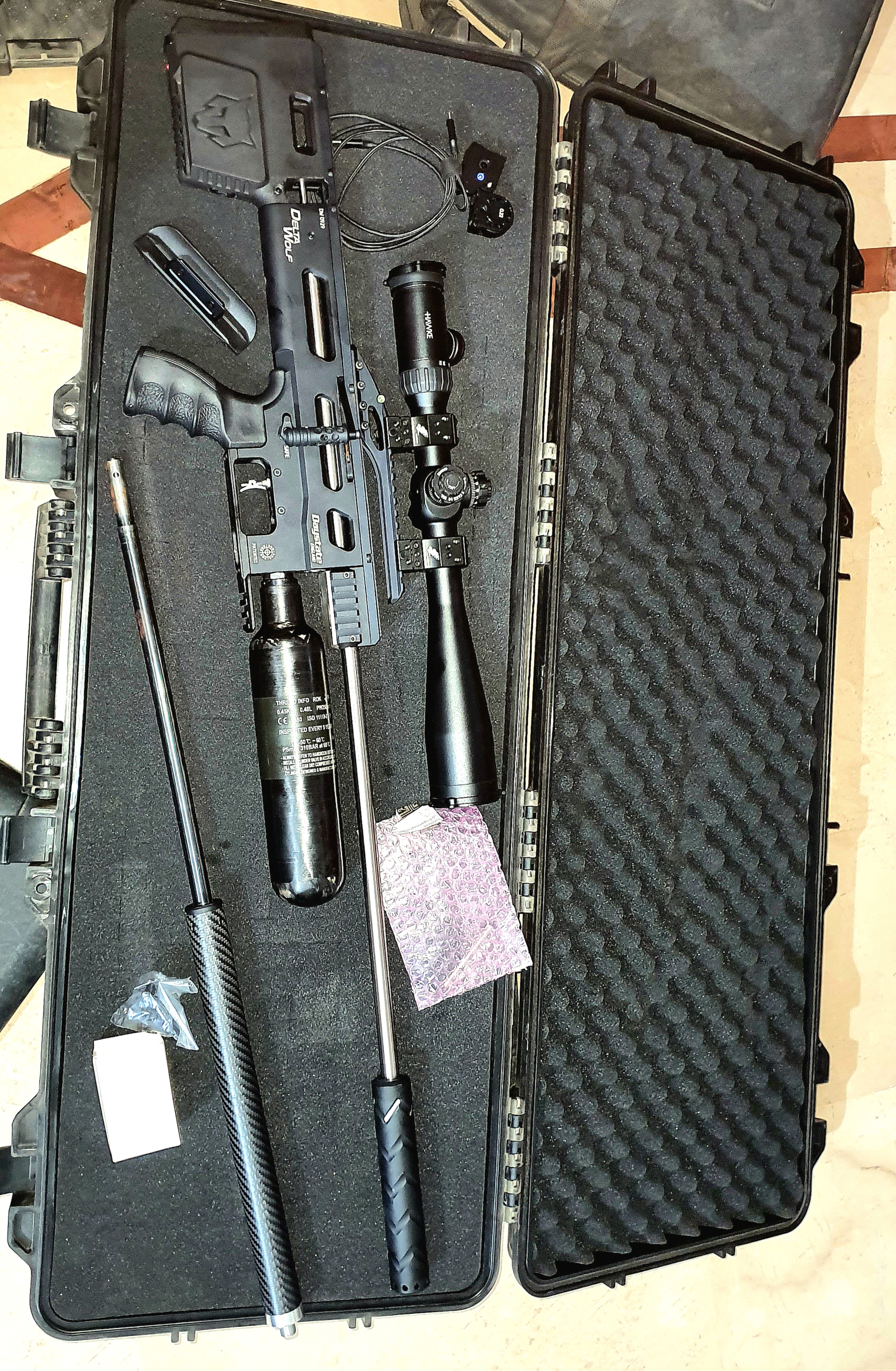

I have a custom RAW that Allen Zasadney did for me, it was originally a .35 caliber and he converted it into a .22 by putting a FX Superior barrel liner in.
He beds the liners in epoxy and they become one with the barrel.
It is very accurate and no POI issues so far.
He absolutely loves the FX liners and is having spectacular success with them.
He’s doing a custom Steyr LP for me and it too will have a FX superior liner epoxied into the prepared barrel.

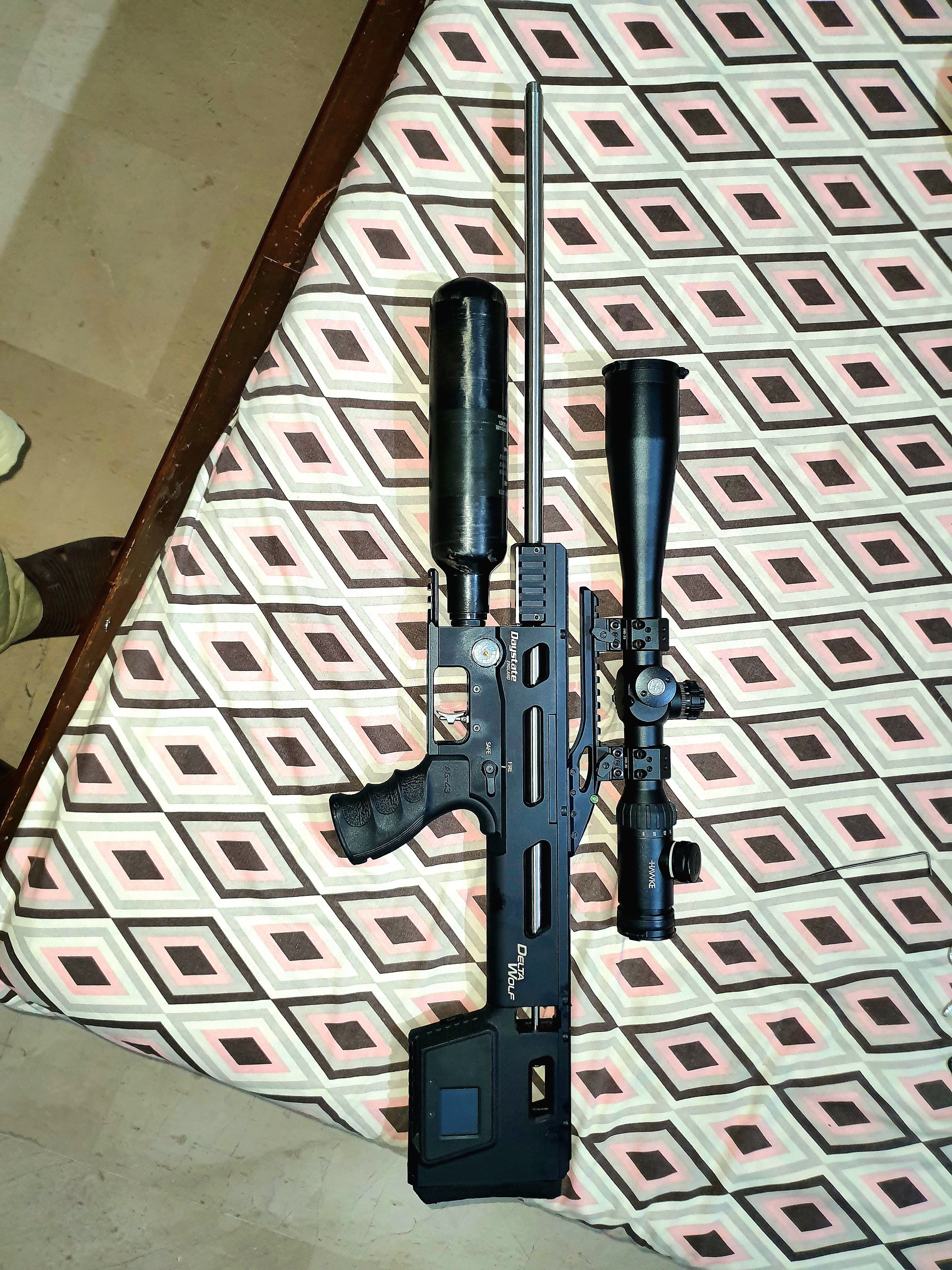

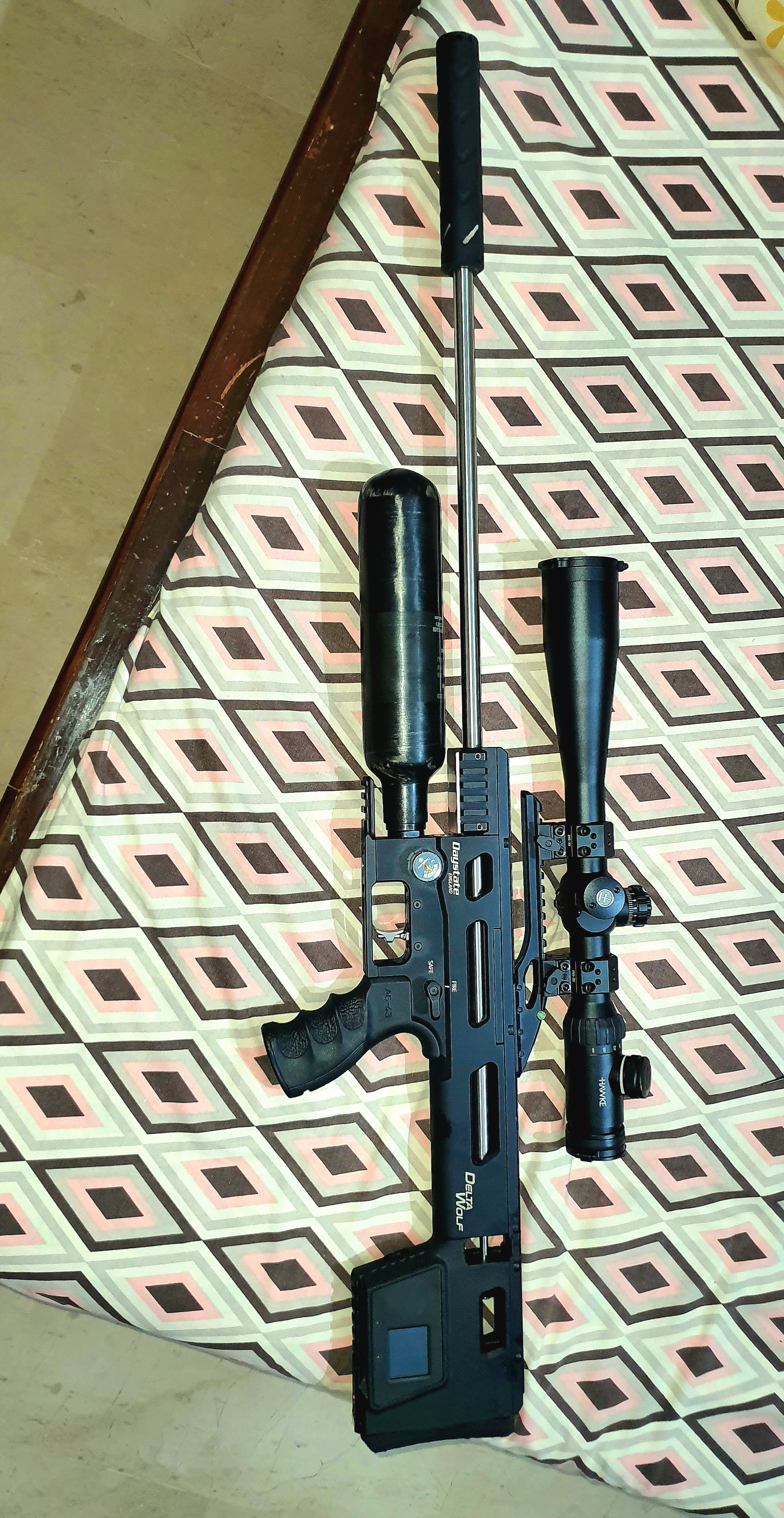

I too love FX liners as far as accuracy is concerned. I understand that as you have explained, if the liner is epoxied inside a thick carbon fiber tube or metallic tube, it is very successful.
The matter is same that when the liner is in fragile position like I side FX barrel housing, it can move a bit while if we glue it and make it sturdy, it becomes very good. Further the free floating barrel system of RAW is very convincing.
I have read that not only AZ but many other tuners also use FX liners which reflects their liking of these liners.
Off course these liners shoot great if properly secured.
I have myself installed FX liners on Daystate Delta Wolf and achieved great accuracy at bench.

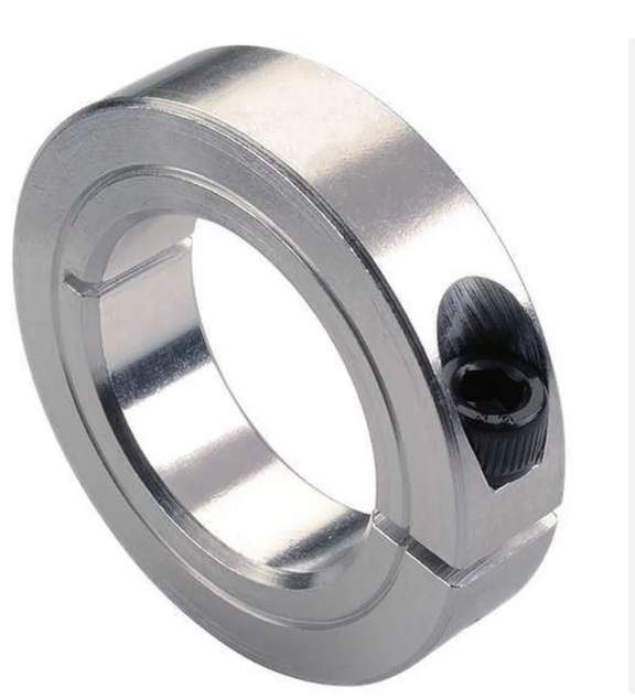

Don't you think it's the way the barrel is kept in the action that makes POI shifting occur ? Tiny grub screws to hold a 500 , 600 or 700 mmm assembly in place , that's a lot of cantilever .
I often wondered why they don’t hold the barrel via a pinch clamping arrangement.
A pinch clamp is like the shaft collar shown in picture, except the receiver is split at 12 o’clock and two or three socket head cap screws cause the barrel to be gripped 360°.
