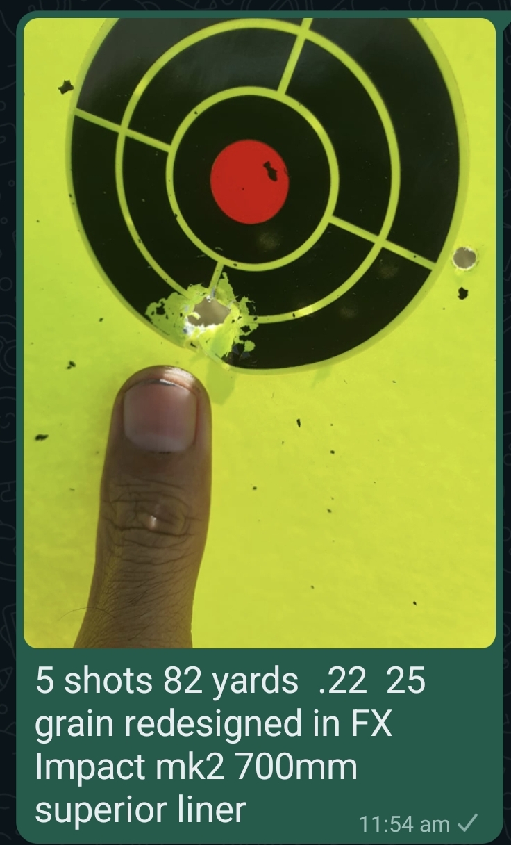

When Impact is properly tuned, its a great shooter. I have just shared a group on another thread of this forum. I reproduce it here to show my liking. But I understand that everything has its pros and cons and we should accept all of this.
With this tuning, my Impact out shoots me every time at the bench. IT IS A FACT.
But as it goes out in the woods, it shifts POI until I install barrel tensioning kit.
IT IS AS SIMPLE AS THAT.
So I understand that strgthening the barrel system is the fix that FX has already introduced.
