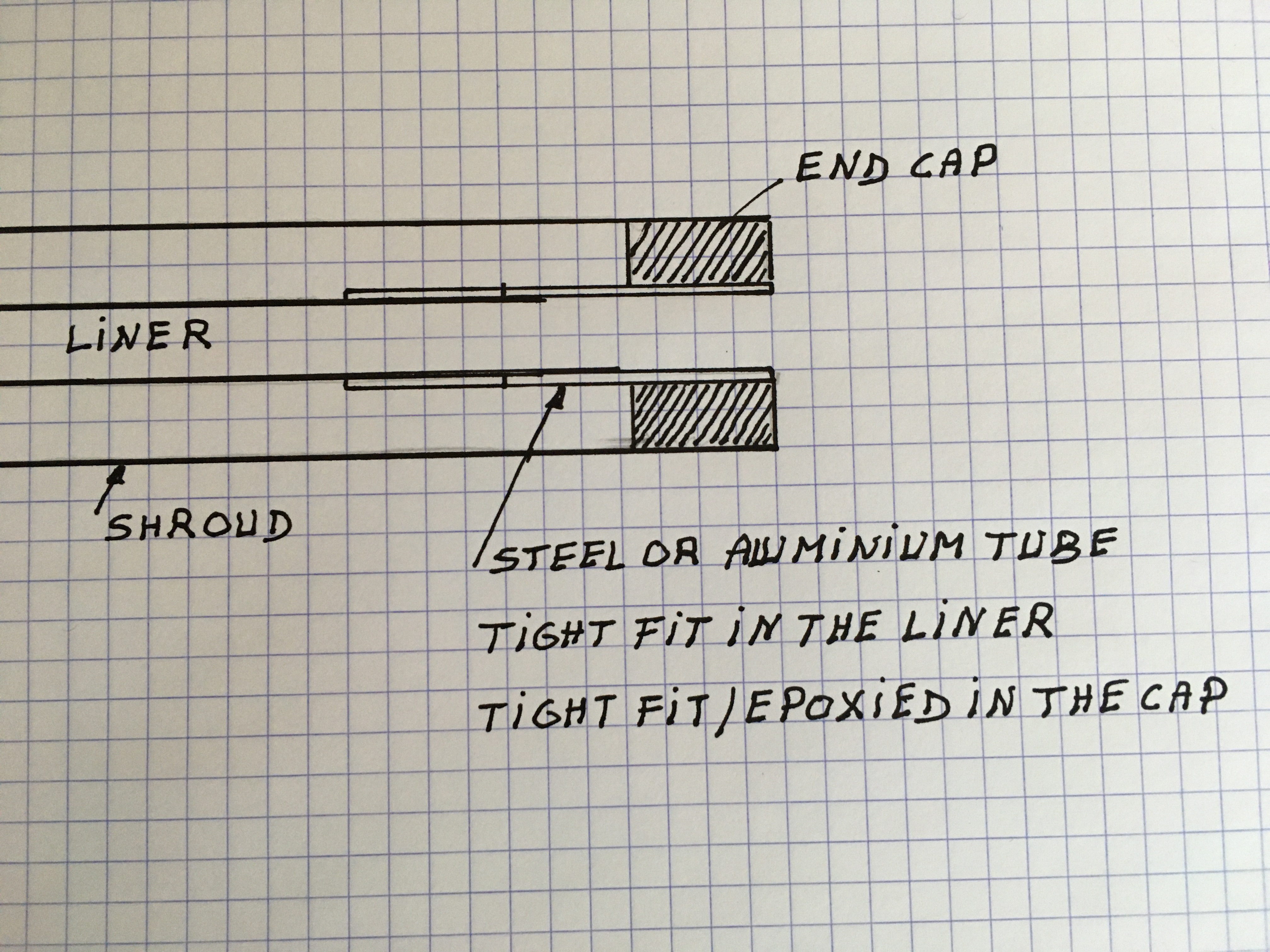

FX guns , A Wildcat MK1 with the first concept of "smooth bore" , which means a heavy barrel , 16mm od , totaly smooth until the last 10 inches at the muzzle . Never had POI shifting issues , same with the Boss . Not the same with the Crown or the Dreamline. Maverick doesn't show a lot of POI problems , probably because the barrel assembly is kept in place in a stiffer way.
I've never put a lot of trust in the "liner in a tube in a shroud ", even in the Superlight system. Last week I put a Superlight barrel .30 on my Crown , and I had the feeling that the spacer , mainly the one near the muzzle , had not a tight fit with the shroud , so I modified the system . I machined a steel tube to go around the last inch of the liner with tight fit , and to go into the end cap of the shroud , also with tight fit and epoxied . So now the end of the liner is kept in place with the shroud in a very solid way . The first groups were very good .
The drawback of this setup : air from the liner cannot enter and expand into the shroud , so the gun is louder than before.
This is maybe not THE solution to decrease POI shifting problems , I just wanted to try something :).

See drawing below .
Years ago I had discovered that the Impact's barrel liner nut was "sloppy" and caused POI shifts at each shot from barrel liner harmonic whip shifting the liner inside of the nut slightly. It made two distinct groups, back and forth with each shot. I did a write-up on it with my fix of wrapping the end of the barrel liner with Teflon thread tape so it takes up this little bit of space and centers the nut onto the liner and can't shift back and forth. It is less permanent than the epoxy.
