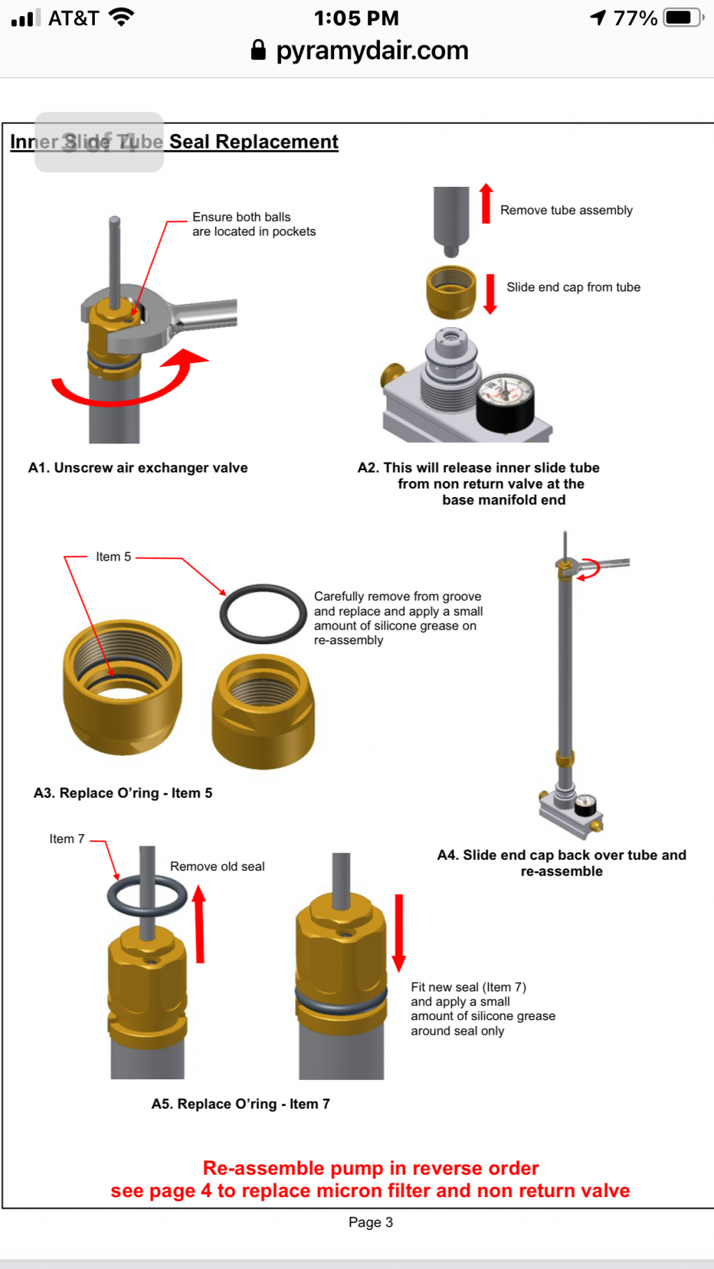

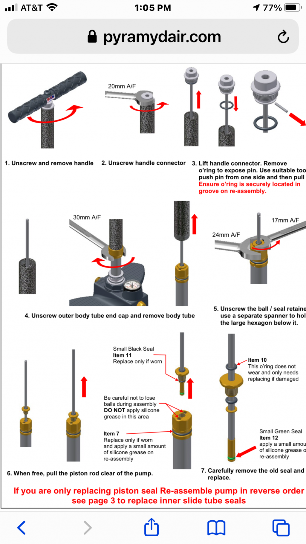

I've owned many but Hill MK1-3 were the only Ernest Hill ones. I had no luck whatsoever with any Benjamin pumps. I love Crosman & liked the guys at Sun Optics, but tolerances on a Benjamin's were sketchy. I had to rebuild the Benjamin and friends at least 20 times. Any Hill it was always #005 replacement & general service.
ive had my benjamin for over 12 years and its served several guns nonstop with zero failures .. but then again i dont sit out there all day everyday shooting out multiple 500 tins of pellets a week lol ... that said, its worst enemy is moisture, and im sure with any pumps it is, learn how to break them down lube and dry them out .. i have a couple of new sets of seals for my 12+yo benjamin pump but havent replaced any yet lol ...

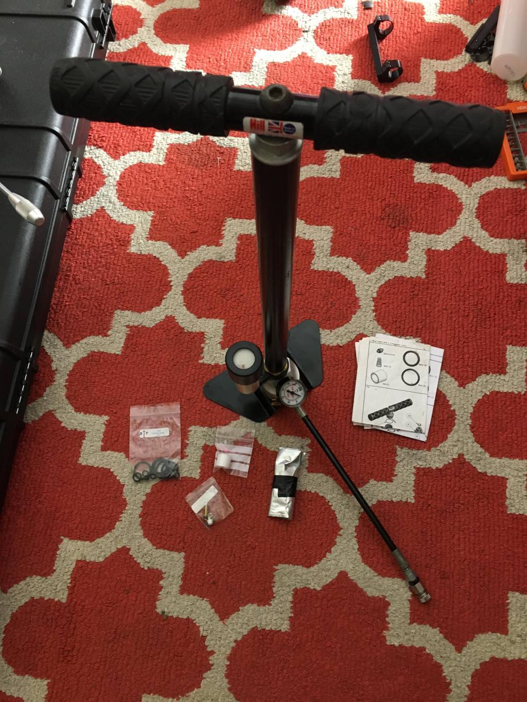

 I've owned the original (Yellow) Hill nightmare pump, the 2st FX Blue pump ( 2 of those and the second one had a gauge reading 70bar LOW so I over filled every rig in the house, fun but stuff does happen) and a "Vevor" pump which was to be the AV G4 but...... . Purchased the Vevor from Mike Melick for $110 (?) delivered, cheapest pump sold in the U.S. at that time. Used it, lent it out to several people at least one of whom shot a LOT (a tin a day+) and the darn thing is still flawless after 5+ years. A screaming value at that price and these day's $50-60 https://www.amazon.com/VEVOR-Airgun-Pressure-Stirrup-4500PSI/dp/B078V1RM4F
As it has never needed a thing other than some drop of silicone I cant swear to the tolerances but it HAS been used a lot whithout issue so it seems they must be good enough.
It is also the easiest to use with apparently the same fill rate as others.
I also could help but buy the $21.00 to your door pump that was on sale last month (how could folks resist? And I no longer even use a pump) and haven't even put it together but just one stroke (and hey just 1, it will break in) sure seem rough feeling, who knows but I suspect tolerance are not as good as the Vevor.
At least on mine it beats the FX gen 2 and hill MK III(?)-tried a friends- hands down even if priced the same.
