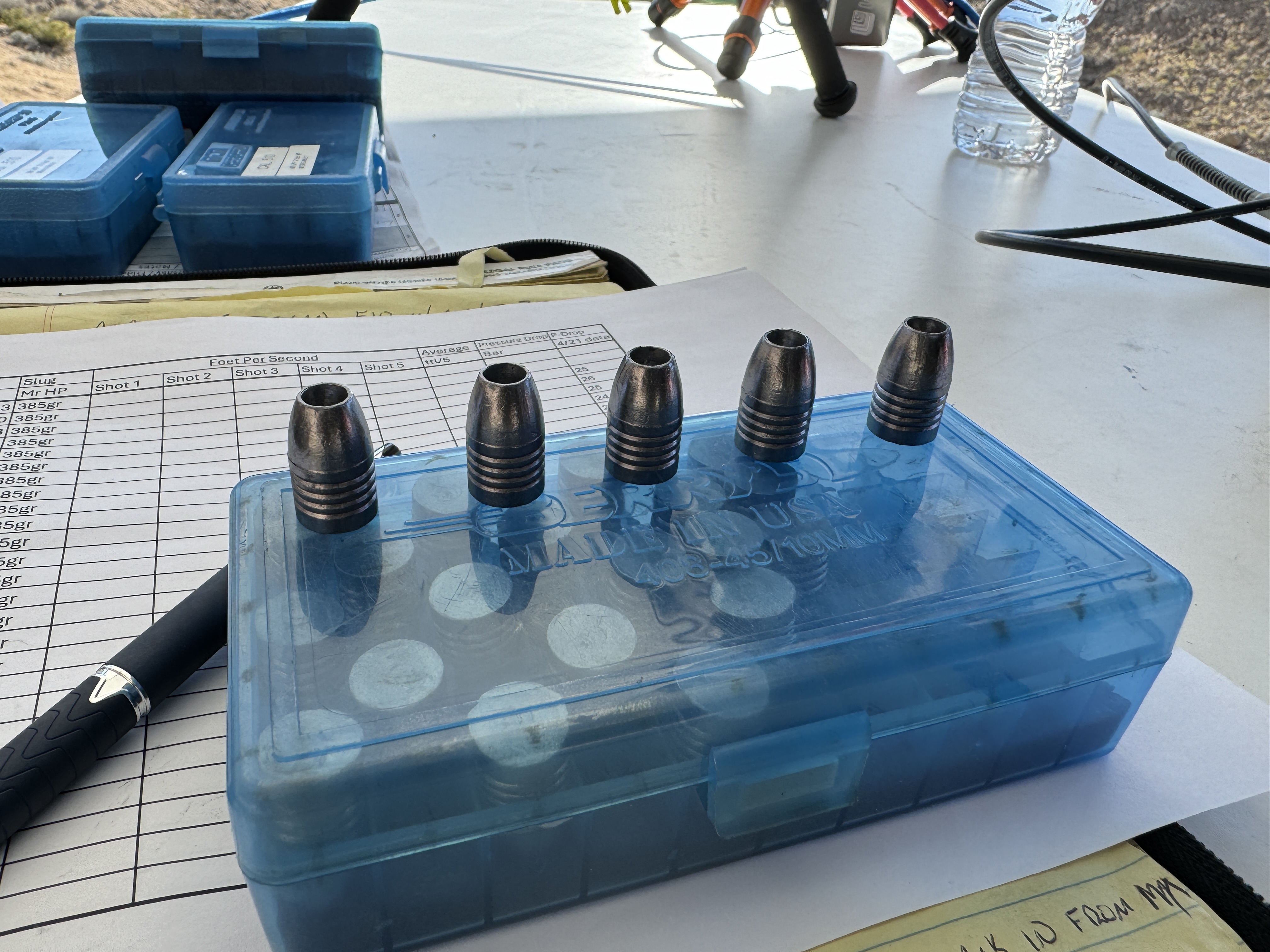

Barrel has not been touched. I achieve extreme spreads of under 4fps because I put my time in on tuning the rifle to the specific slug I'm shooting. The pills are also given a lot of love, each one is carefully measured to make certain it’s perfectly round, each is weight matched, then sized before receiving a final coating of dry moly.Wow excellent shooting .510 Texan.....Did you have to fire lap or hand lap your factory barrel? It seems the .510 lother Wather are the worst of the bunch....So I assume a good barrel and not much leading? Keep up the good work!!! Nice Rig
I'm sure that moly coating works well just like powder coating does...Used to moly coat slug for 8 twist 22 cal powder burners back in the day... With good results.. That's sweet your barrel is a good one... How are you measuring your slugs for consistently in diameter? Measuring or die? Trying to get better...Barrel has not been touched. I achieve extreme spreads of under 4fps because I put my time in on tuning the rifle to the specific slug I'm shooting. The pills are also given a lot of love, each one is carefully measured to make certain it’s perfectly round, each is weight matched, then sized before receiving a final coating of dry moly.

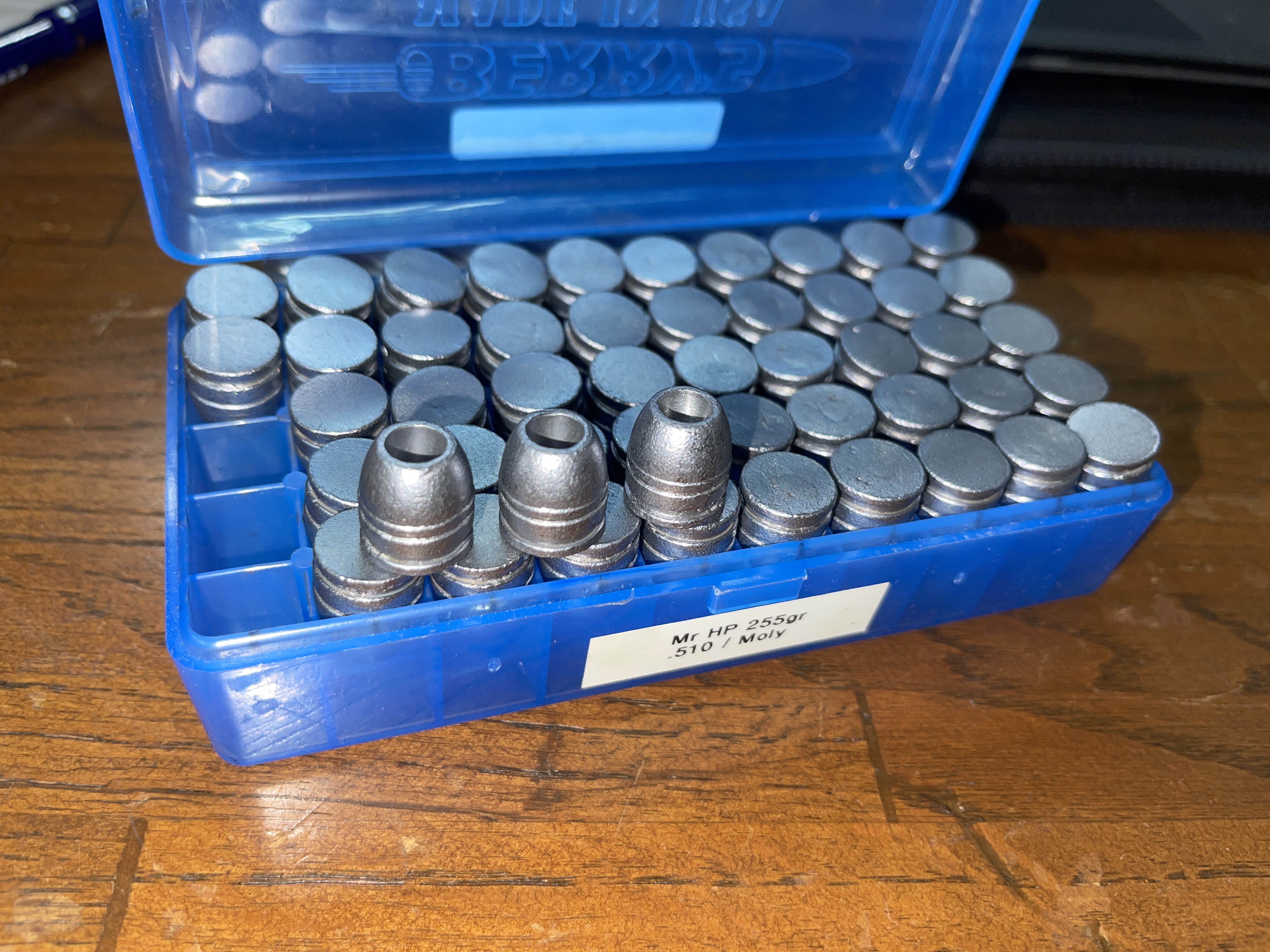

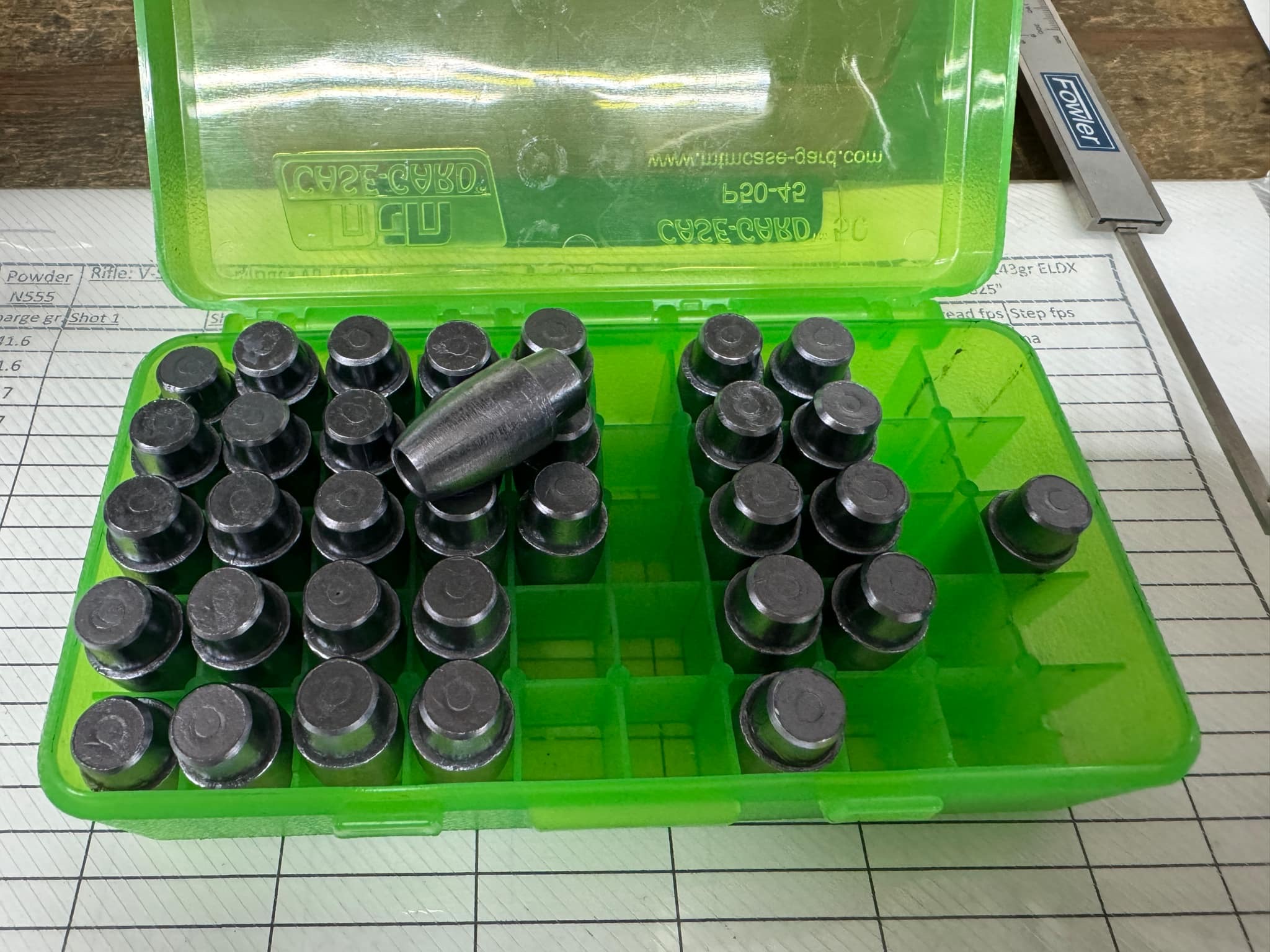

Looks like a good mold. I believe the .308 may have some advantages over the .510 for long range applications, I’d like to get my hands on a .308 and a .45 one day for testing. As for home casting, I recently started experimenting with casting my own .510 and I have found it very challanging to get a perfect slug with proper form and weight. I’m still learning, and unfortunately, I only get about 10-20 perfect pills out of each 100 I cast. I call these my HPLRHC. They are a 342gr boat tail HP that are showing promos, but proving to be a real challenge to produce.I specially ordered some new airgun specific slug molds for long range .308 shooting. They are now available on the Arsenal order page:

Good questions, and slug selection is a process I put way too much time into.I'm sure that moly coating works well just like powder coating does...Used to moly coat slug for 8 twist 22 cal powder burners back in the day... With good results.. That's sweet your barrel is a good one... How are you measuring your slugs for consistently in diameter? Measuring or die? Trying to get better...
20% sounds rough. Probably a temperature issue. I was casting pure lead last night and kept having to crank the temperature. Started the pot at 780f and ended up at 830f. Even then I had to regularly heat the mold with a torch to keep them filling out. Tapping the mold a bit right after filling seems to help as well. 175gr slugs, 90% were +/- 1gr. Having a good sprue plate that is held down on both sides really helps get flat bases free of flashing, and keeps the weight more consistent.I’m still learning, and unfortunately, I only get about 10-20 perfect pills out of each 100 I cast. I call these my HPLRHC. They are a 342gr boat tail HP that are showing promos, but proving to be a real challenge to produce.
You can buy a PID controller for your regular Lee 4-20...like a $100.00 on castboolits.com. a member builds them there...You plug your pot.into PID controller set temperature and cast...I usually run between 800 and 850 degrees.. I started sorting slugs and got disappointed.... Slightly for the effort... At 50 yards with no sorting they will shoot....stack... At125 yards 3 moa consistently.. I don't know if it's my barrel but having hard time getting it better.. I have all the mitomito micrometer ,I just don't love using them20% sounds rough. Probably a temperature issue. I was casting pure lead last night and kept having to crank the temperature. Started the pot at 780f and ended up at 830f. Even then I had to regularly heat the mold with a torch to keep them filling out. Tapping the mold a bit right after filling seems to help as well. 175gr slugs, 90% were +/- 1gr. Having a good sprue plate that is held down on both sides really helps get flat bases free of flashing, and keeps the weight more consistent.
Looks like those boat tails were chamfered after casting. Was that due to a sharp edge?
PID is worth every cent. Going without it the swings are wide and results will vary just as widely.You can buy a PID controller for your regular Lee 4-20...like a $100.00 on castboolits.com. a member builds them there...You plug your pot.into PID controller set temperature and cast...I usually run between 800 and 850 degrees.. I started sorting slugs and got disappointed.... Slightly for the effort... At 50 yards with no sorting they will shoot....stack... At125 yards 3 moa consistently.. I don't know if it's my barrel but having hard time getting it better.. I have all the mitomito micrometer ,I just don't love using themFor my new longer range of at least 230 yards ,,I'm going to have to start letting my ADHD take over....Thanks friends

That particular three shot group was untethered using Mr. HP 385gr slug. Rifle was set at 4,175psi and shot 1 was 915fps, 2 was 919fps and shot 3 was 914fps. for my rifle at this slug weight its the sweet spot for stabilizing velocity and air consumption. Every rifle has a similar sweet spot for a selected ammo, ya just gotta put in the time to find it. See my post in the link below.Great looking group. What ammo and velocity?
