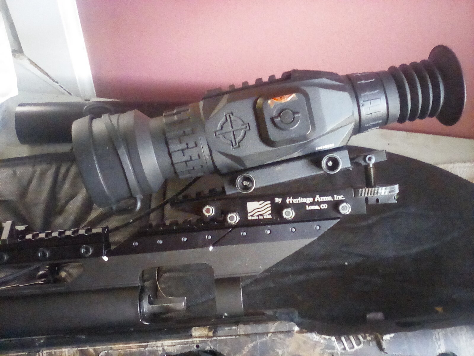

I watched that Long range deer kill on YouTube too. They were using and promoting ATN with laser range finder calibrated ballistic. Most all long range subsonic shooting is done with coldshot adjustable base because of the huge amount of moa or mil adjustment. Point being how much adjustment can be used on a ATN digital scope with automatic ballistic calibration. So I'm really sceptical of that video.... I have some experience slinging some lead long range with my 50 Texan...Its extremely challenging will so much drop...A Texan 50 with 4500 psi African Air Ordinance Upgrade will shoot 650 grains at over 900 fps in 34 inch barrel.

Yes ballistics the same with African Air Ordinance 4500 psi upgrade in 30 Texan will shoot 230 at over 900 fps..the lee 230 grain vld has a .630 b.c.. The big 50 with upgrade is at 900+fps with 650 spire point boat tail .5 b.c. These valve's are safe with helium too. A booster pump is needed for 4500 psi big bores. Helium would get another 30% faster. So the 50 with a 650 grain has 1000 foot pounds of energy at 300 yards. So 1200 fps with a 650 grain is pretty sufficient with .5 b.c. I would say a custom real bench rest barrel needed Benchmark Krieger Hart Grid etc.. At minimum hand lapped factory barrel. My optical setup with 144 mils dialed in...

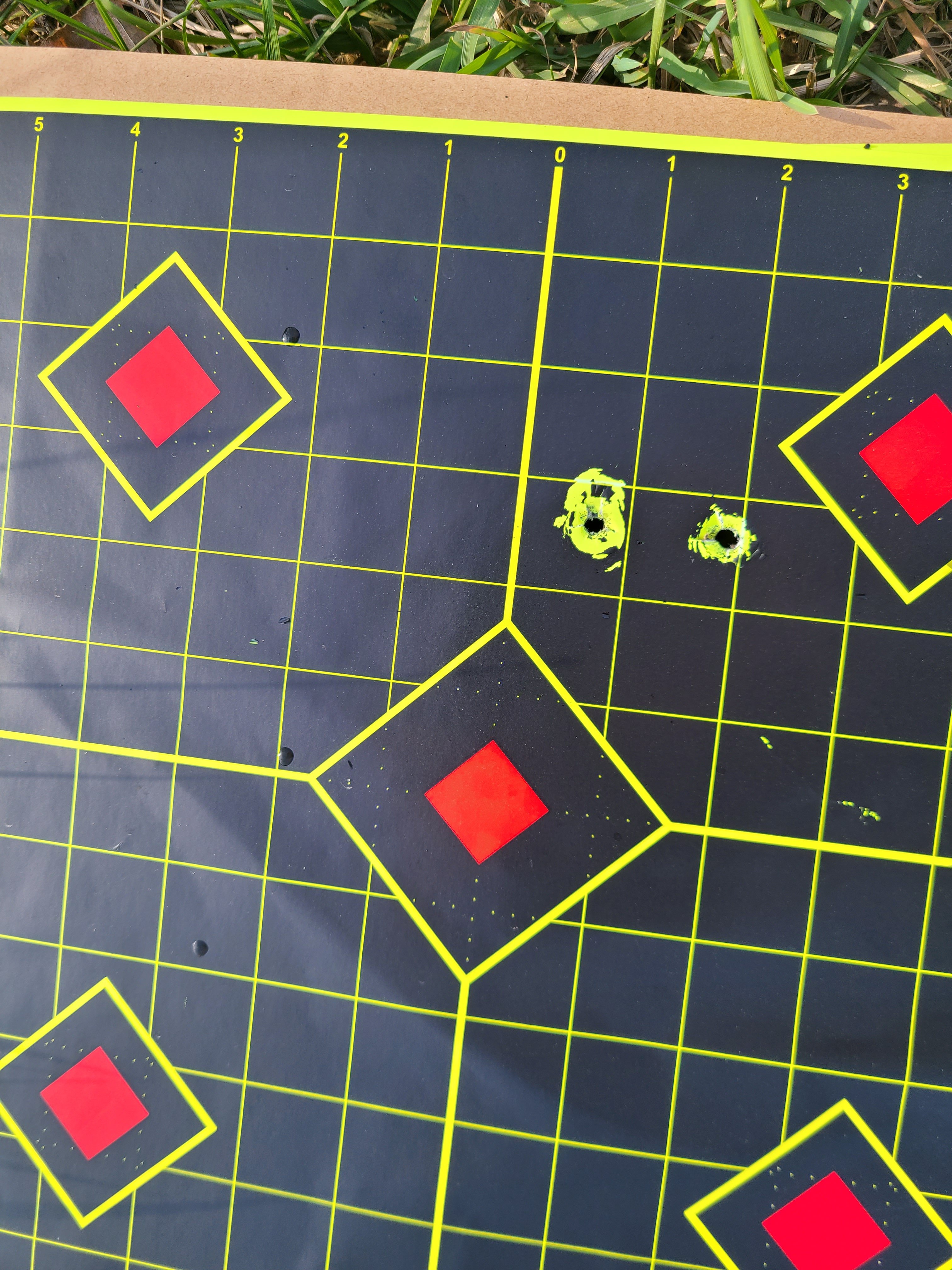

336 yard shot today with .357 texan, shooting 174gr higharc hunters at 880fps
