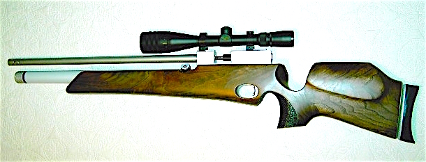

RAW is an excellent option and Martin is now making shrouds with the standard 1/2 UNF end cap so a Donny/Hugget etc. Can be added.
A RAW .30 is a thing if beauty at 100 yards and of course the Red Wolf Safari is a great option...
The Delta Wolf is an up and comer and in.25 or .30 will easily compete...
Pic of new RAW shroud/end cap

Though my regular field target rifle is a RAW, it is probably the shortest and lightest RAW ever built (to my specs). My only hesitation in recommending you a RAW is your high priority, "I want as light gun as reasonable". From what I can tell, RAWs have only grown in size and weight since mine was built. And short as mine is, it's heavy for its length despite Martin making it to my same high priority as your's, "I want as light gun as reasonable".
Where did you find out about this shroud/end cap?
