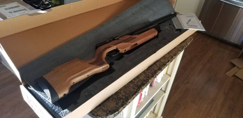

Look what the brown box dropped off?
Benjamin Kratos .25

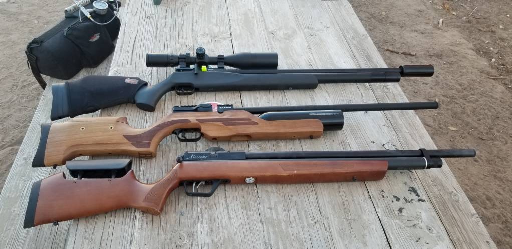

Going to do a comparison between two similar priced pcp. All three are in .25
I'm going to throughly clean the Kratos and get some chronograph numbers tonight and then see how it shoots at 50 yards. I already shot the Mrod at 50 yards a few hours ago and it did really good. I haven't shot the mrod in a long time and it really is a good gun.

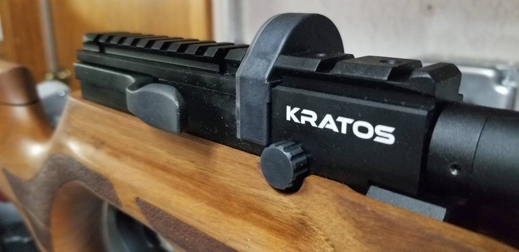

I really enjoy my Kratos 25. I switched out the steel tank for a cf tank and the first part of Airgun detective video trigger job, adjusting the sear screw so that it now works and breaks at 1.5 lbs. I have not exchanged the oem spring for a shortened ball point ink pen spring or polished the parts yet because 1.5 lb is where most of my rifles are at.
The power adjustment knob on mine takes it from 400 FPS to 880 FPS with AA’s version of the Kings’. I turn it up to 500 FPS shooting at 10 yards for best stability.
Changing out the bottle to a cf bottle requires some sanding of the stocks’ barrel channel.

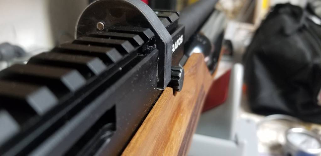

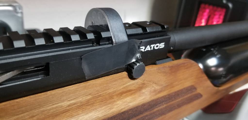

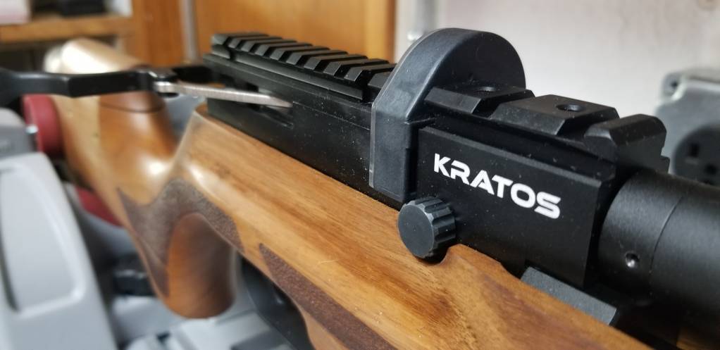

Another problem worth mentioning is the mag. After shot number 7, the mag will rotate hard enough to move the mag when you cock the gun. Several times the mag would move to where you won't be able to push the probe forward. Here are several pictures explaining what I mean:
Here is the mag with the cocking handle closed
Now here is the cocking handle open and the mag has moved out just a little
I solved the problem by taping the mag in place so it doesn't move out. It looks getto but it works.
