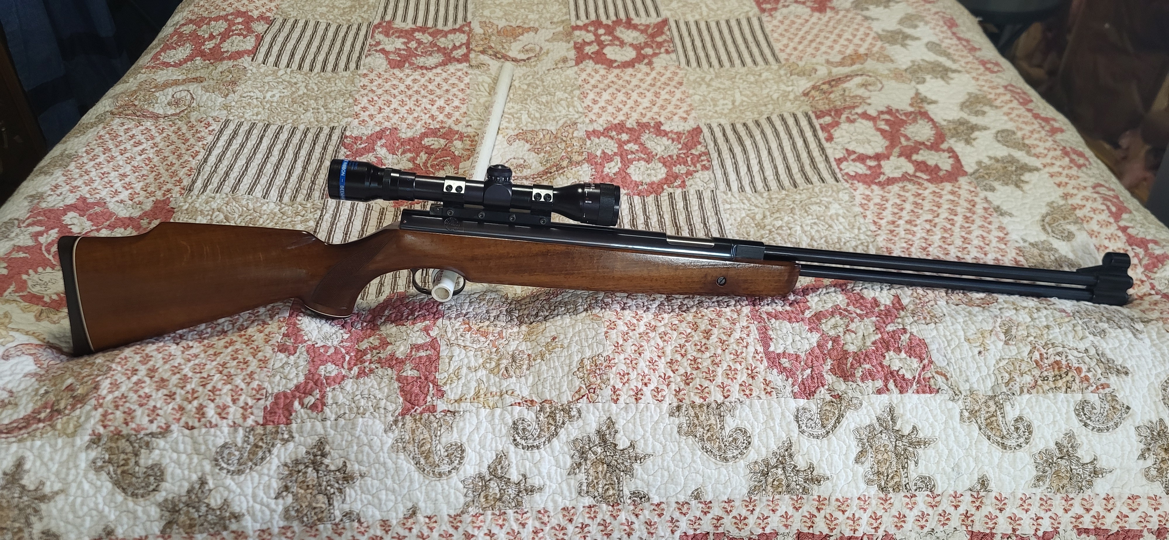

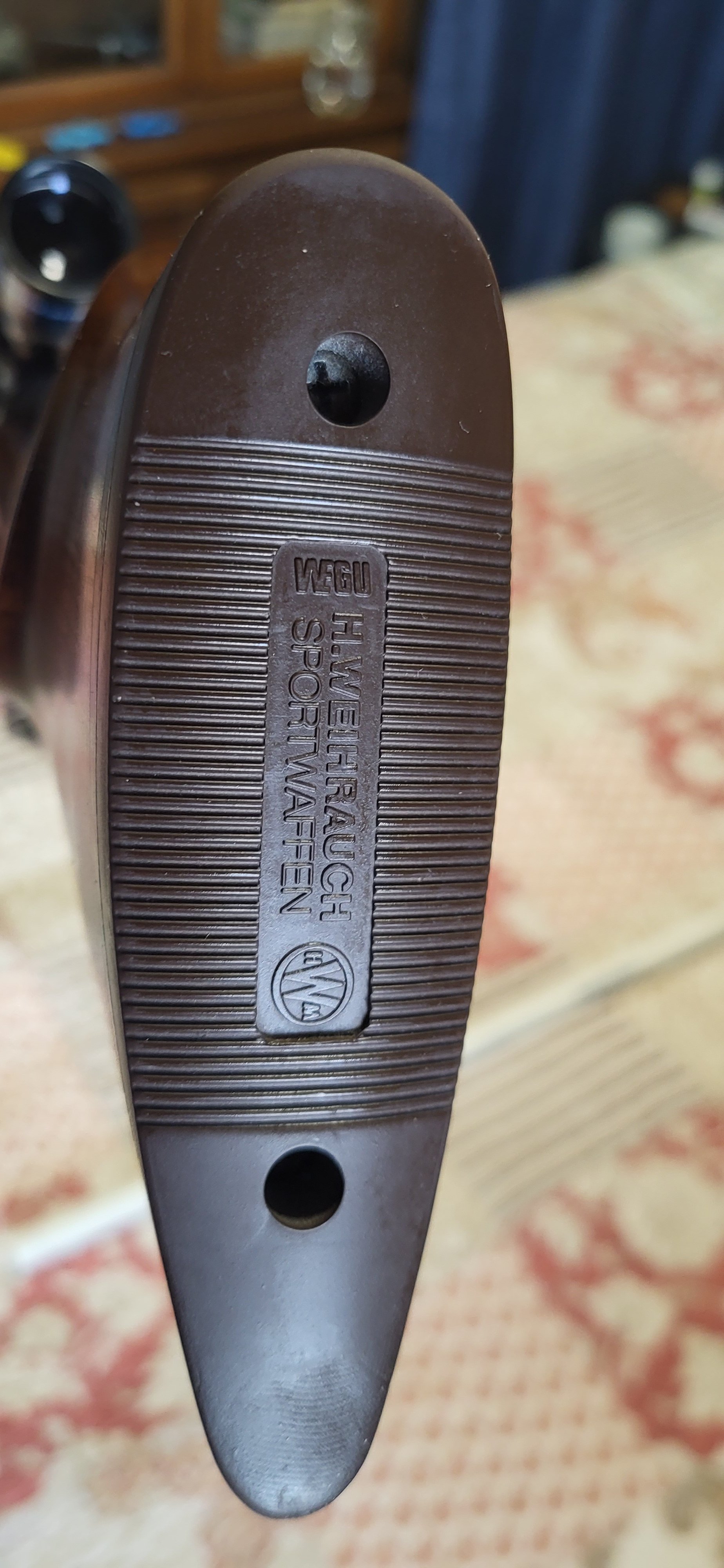

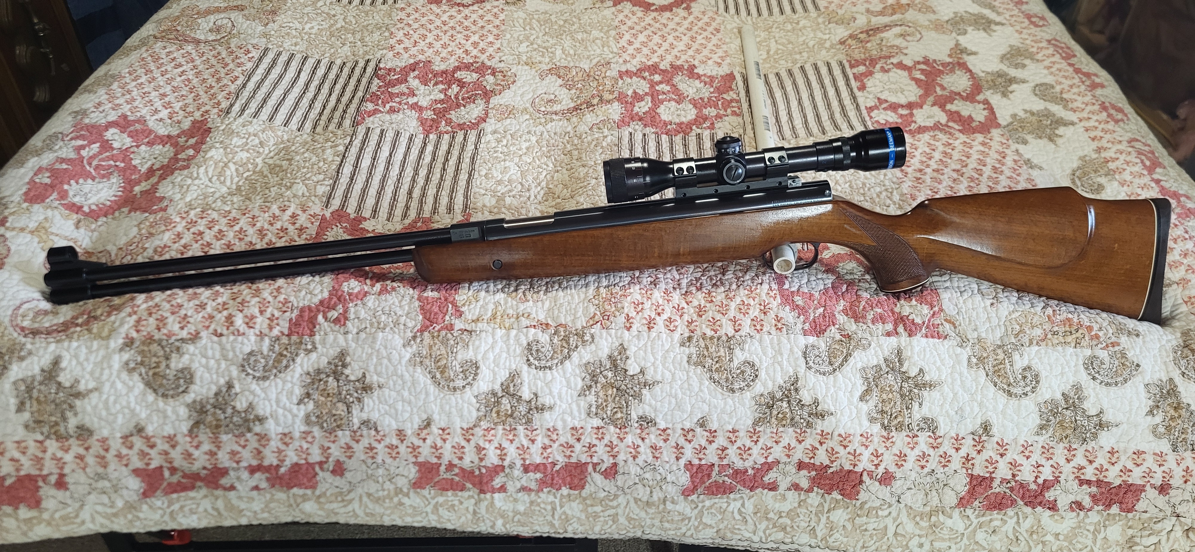

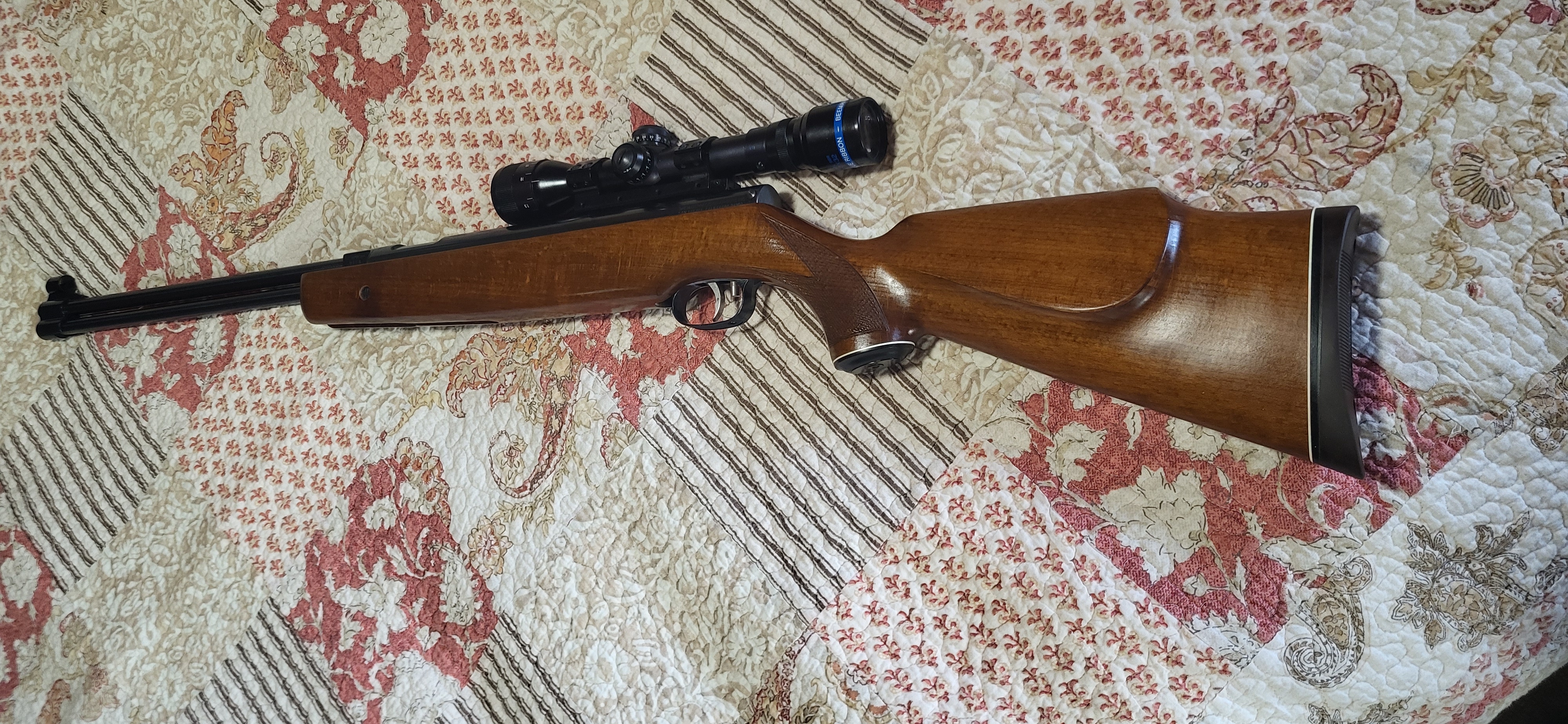

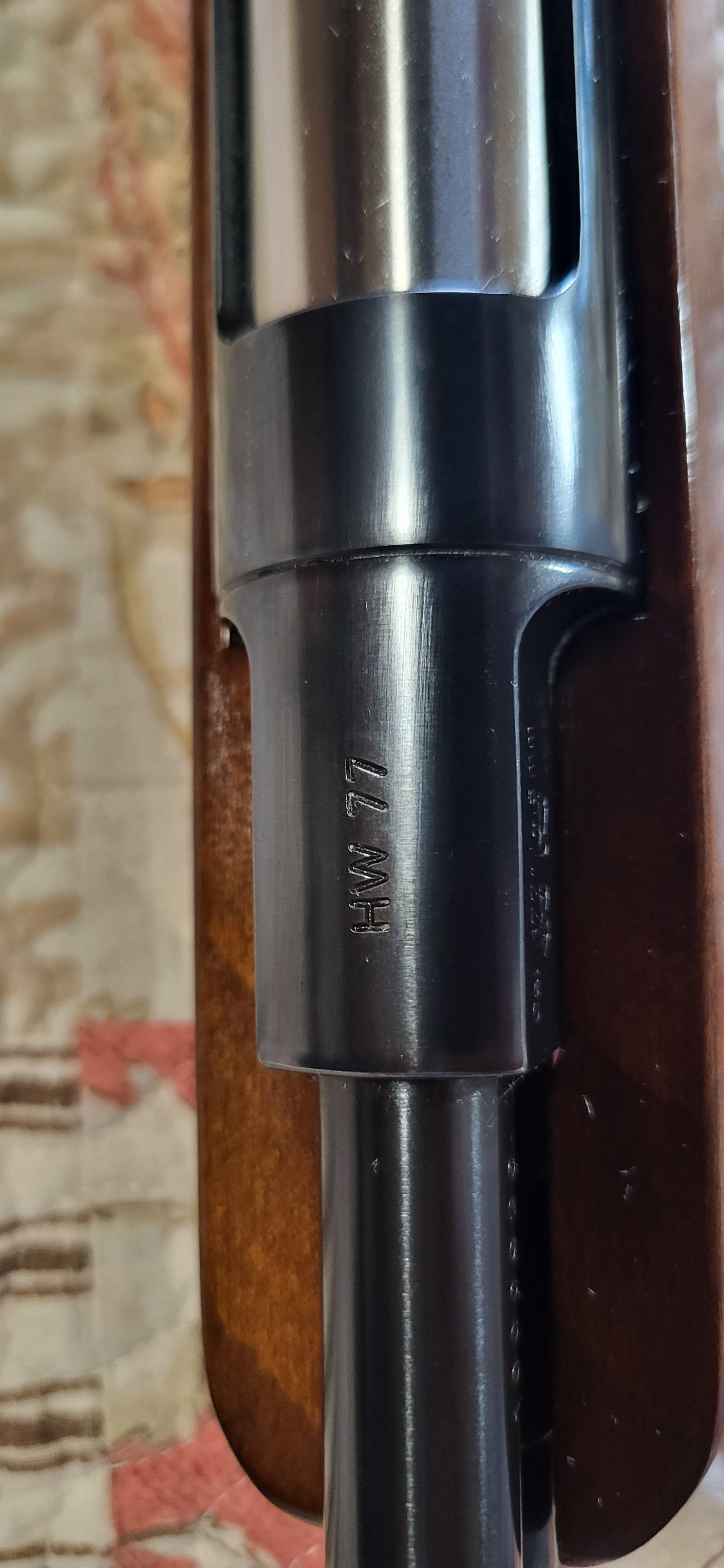

HW/Weihrauch Look what UPS just dropped off. A 77 Mk1.
Last week I posted about a rifle I won on ebay. It was a bit of money for me and I said I was done buying airguns before but BOY am I glad I bid on this.
I've always wanted a 77 with the earlier stock. I like the traditional rifle look of the longer 77 with the lower comb stocks.

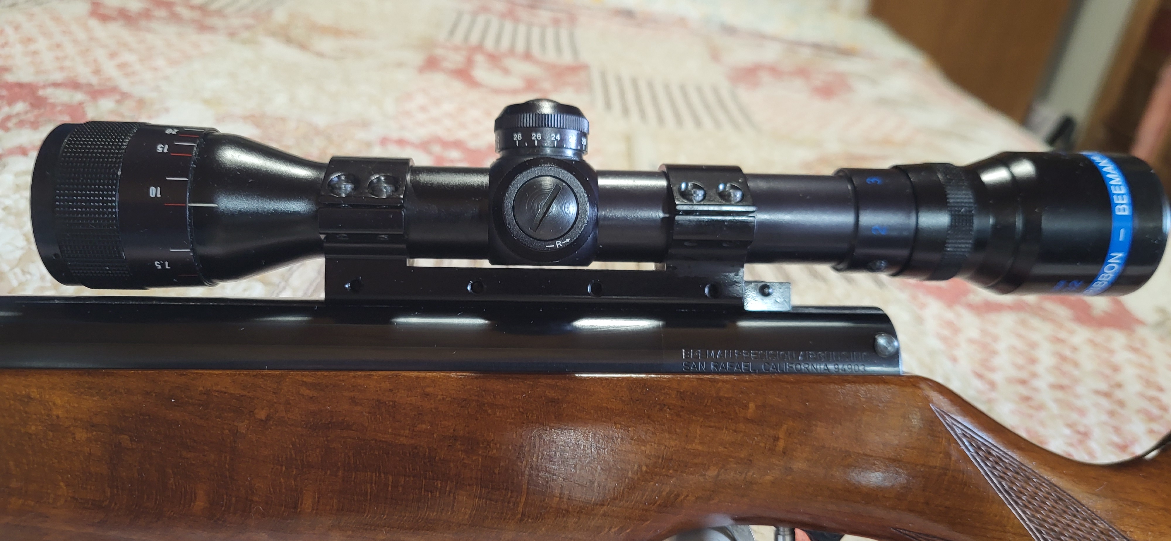

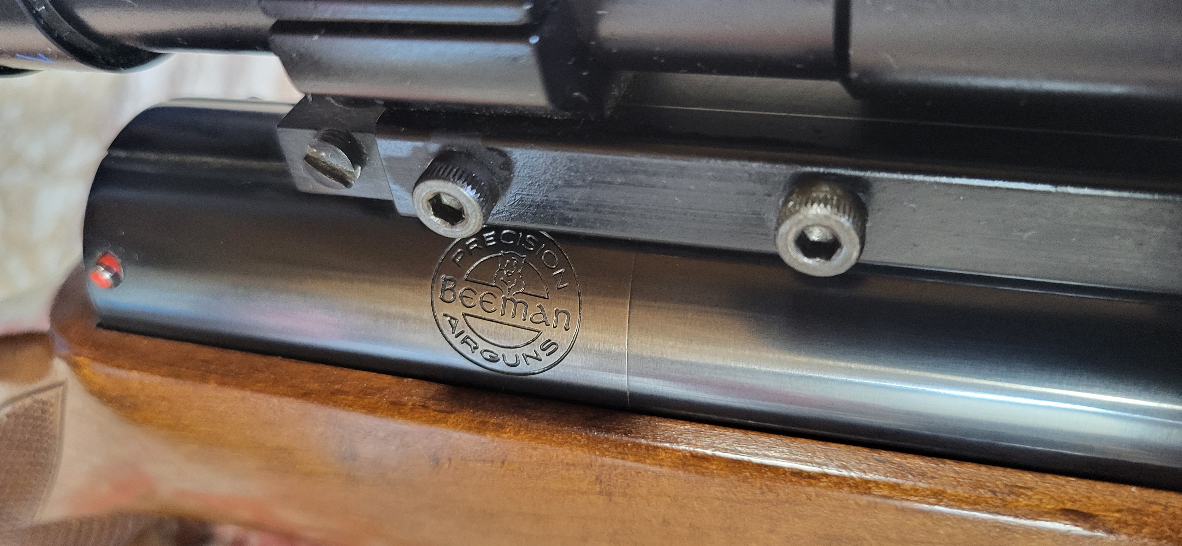

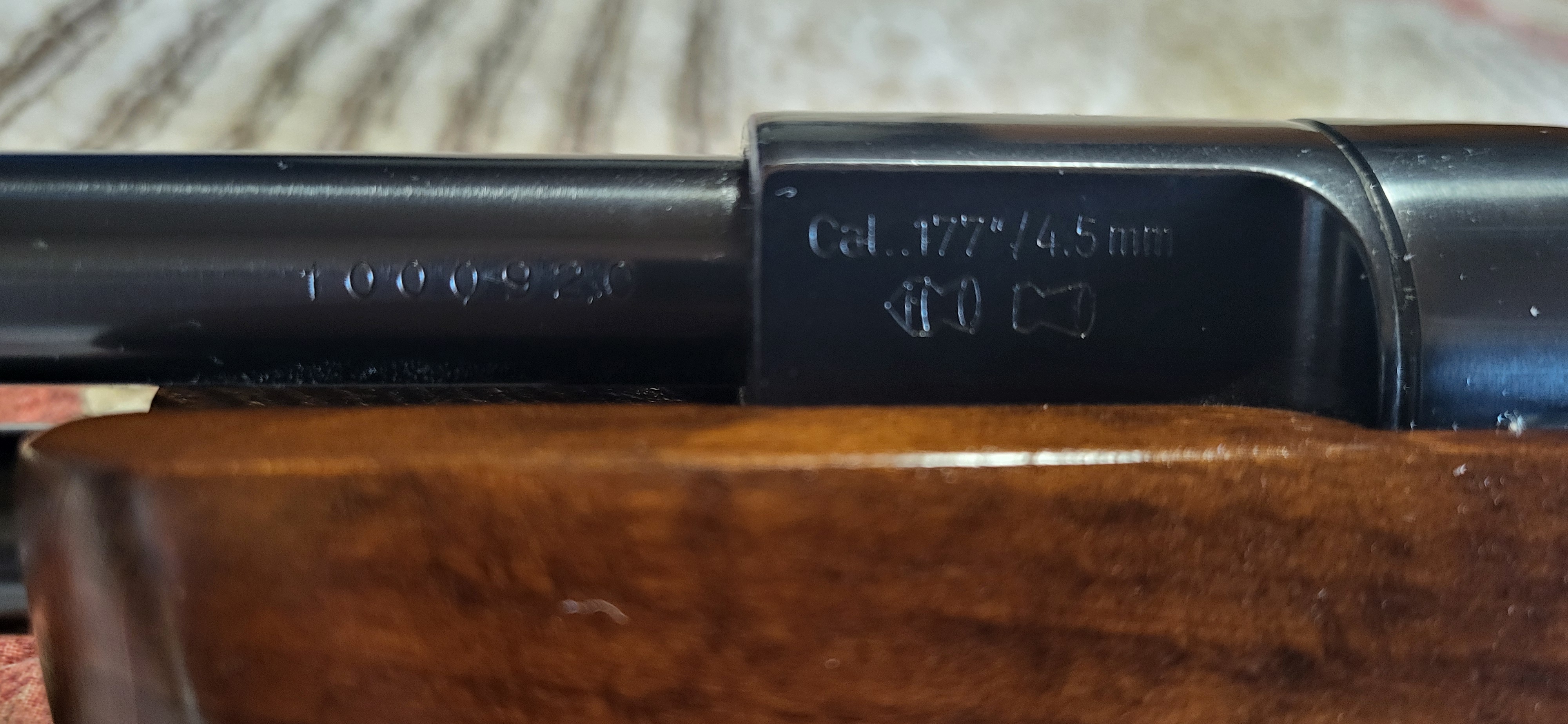

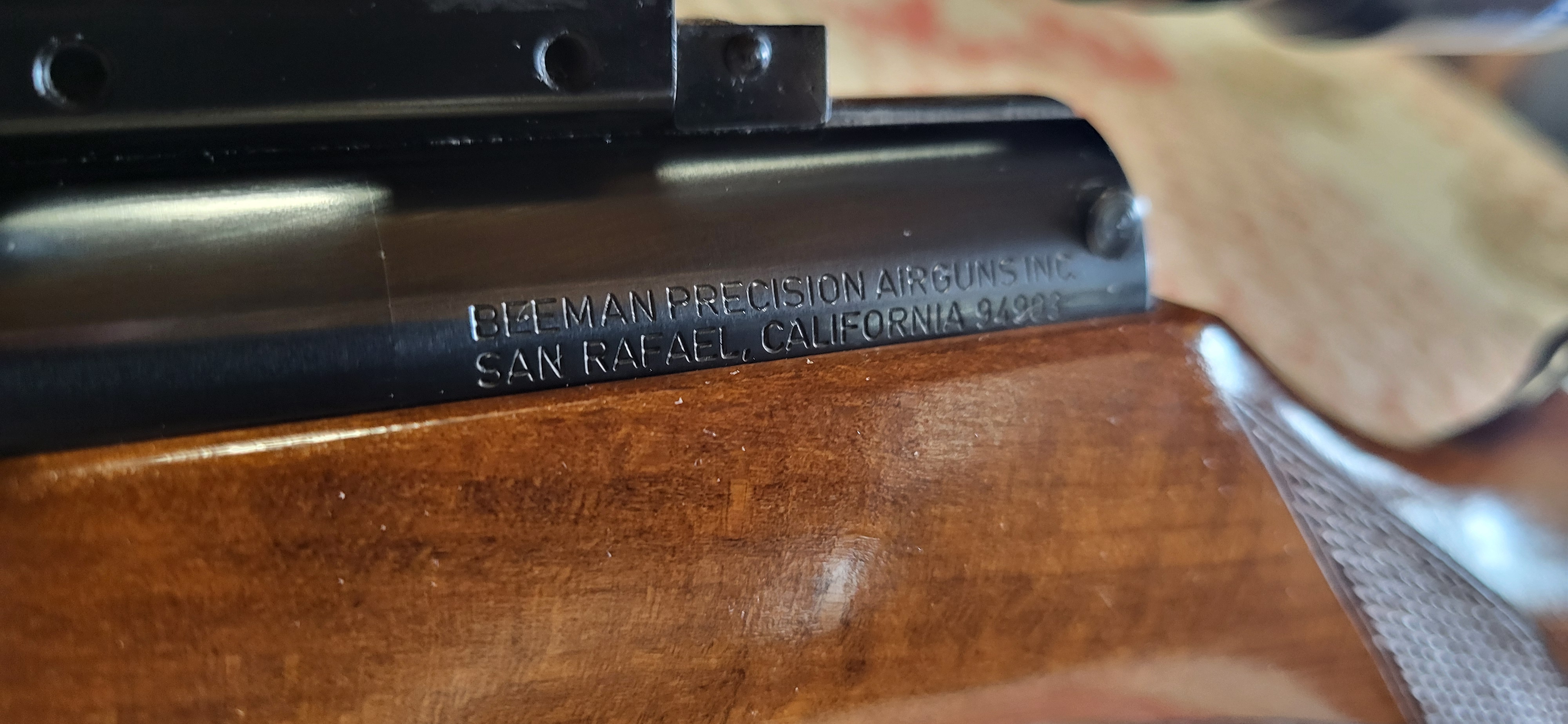

Not only is this a 77 with a low comb stock. It's a Beeman 77 MK1 with a Goudy stock. Its like a time capsule. It also has the time appropriate Beeman scope, scope mount and scope stop. All in near new condition. It looks to have the original front sight hood.
Although the rear sights weren't included the sell says he can probably find them.
I actually thought the scope was mounted 90° rotated. Turns out it's not. The windage turret is on the left side.
Something I've never seen. The scope seems nice but I have yet to play with it. The gun is still acclimating to room temp and I don't know how the scope functions. Its stiff and I don't want to force it. The power ring and occular all turn together. Maybe one of you Blue Ribbon scope fans can explain it to me.
That's it from a very happy guy.
Be well all
Ron

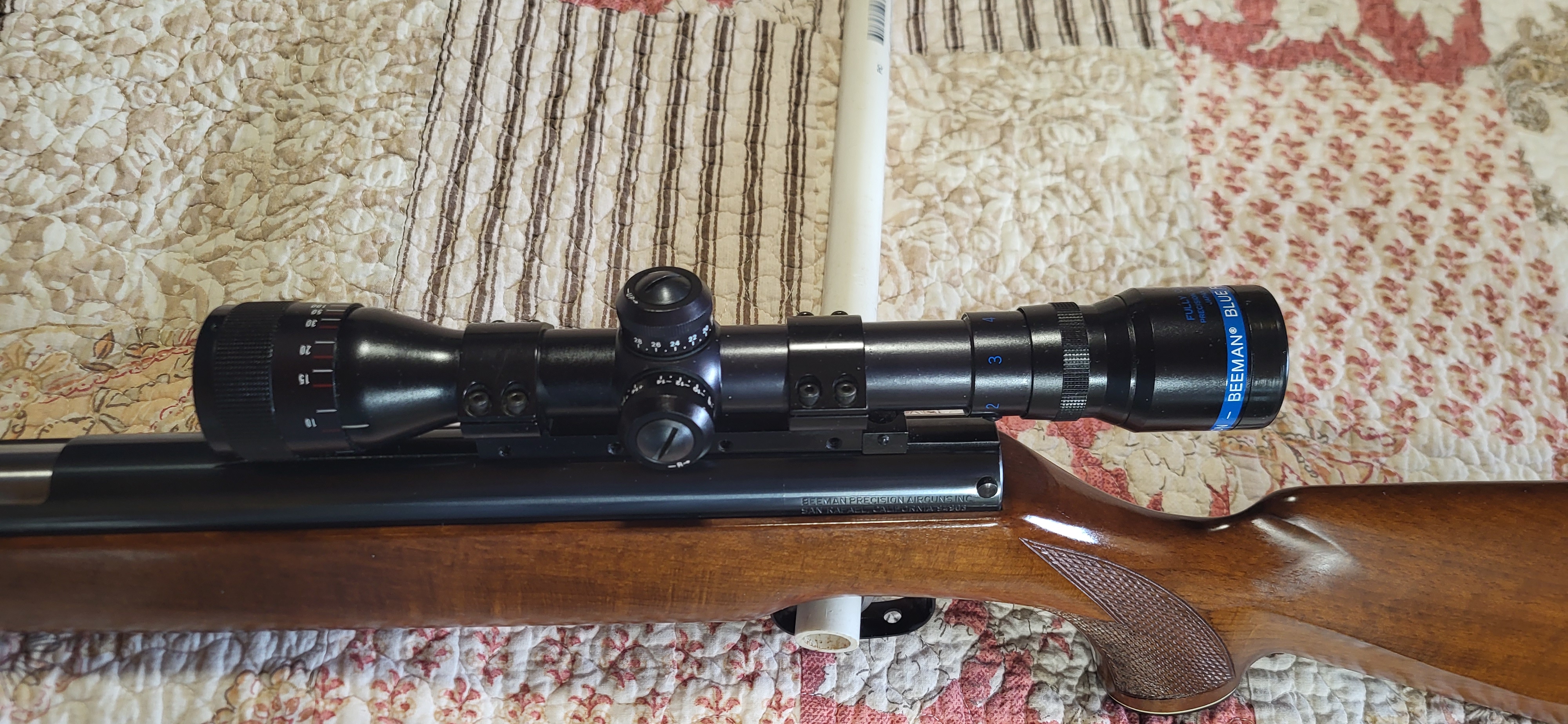

Nice, well kept rig. When those turrets get stiff the plastic collars can strip and you can't get a replacement. Sell it to a Beeman scope fanboy before that happens. Get enough to pay for one of those Airmax I know you like. (y)
Thanks for the information. Everything moves smoothly as of now. I'd like to keep it all together as a time capsule. If I wind up shooting it alot I'll put my extra 2-7 Airmax on it to save wear and tear on the Beeman scope.

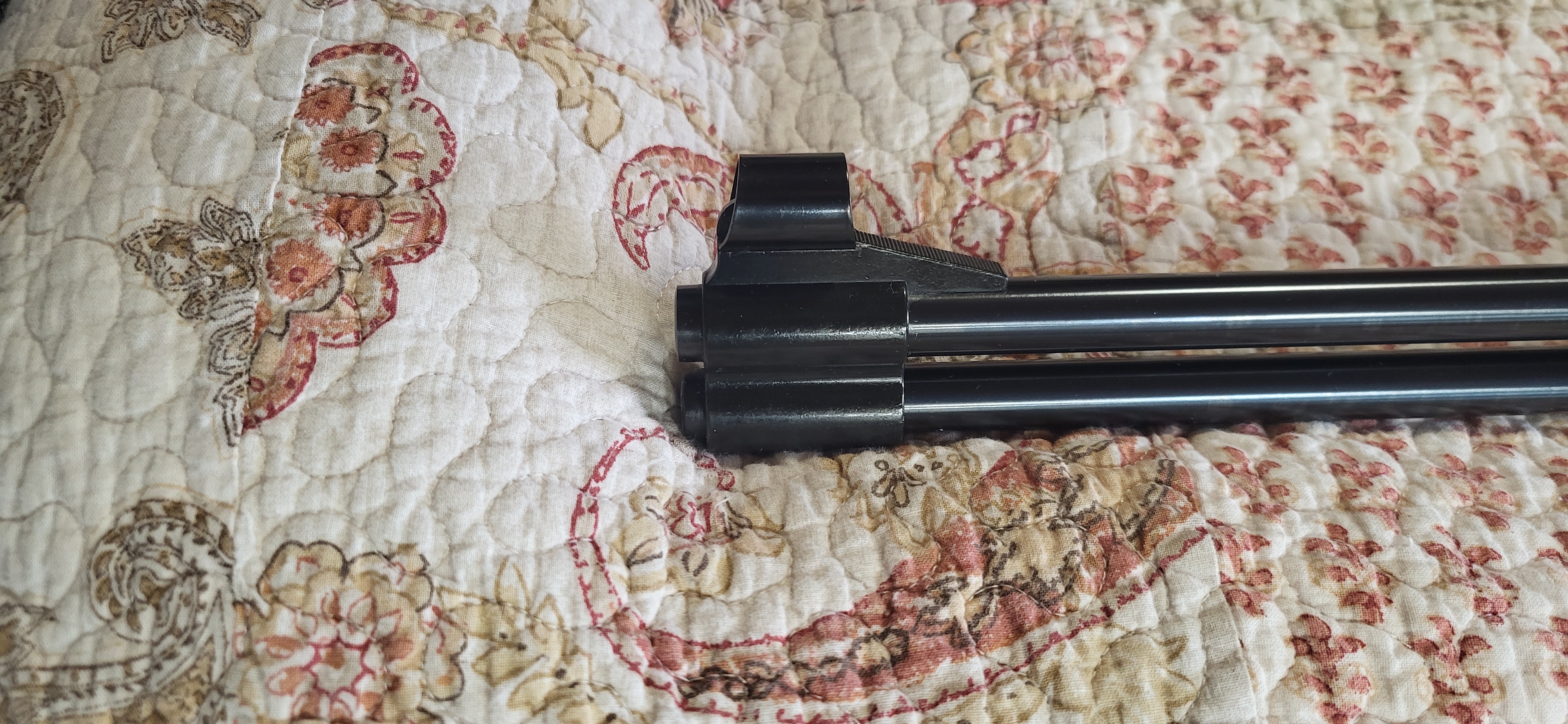

Not only is this a 77 with a low comb stock. It's a Beeman 77 MK1 with a Goudy stock. Its like a time capsule. It also has the time appropriate Beeman scope, scope mount and scope stop. All in near new condition. It looks to have the original front sight hood.View attachment 526554 Although the rear sights weren't included the sell says he can probably find them.
View attachment 526549View attachment 526550View attachment 526547View attachment 526551View attachment 526552

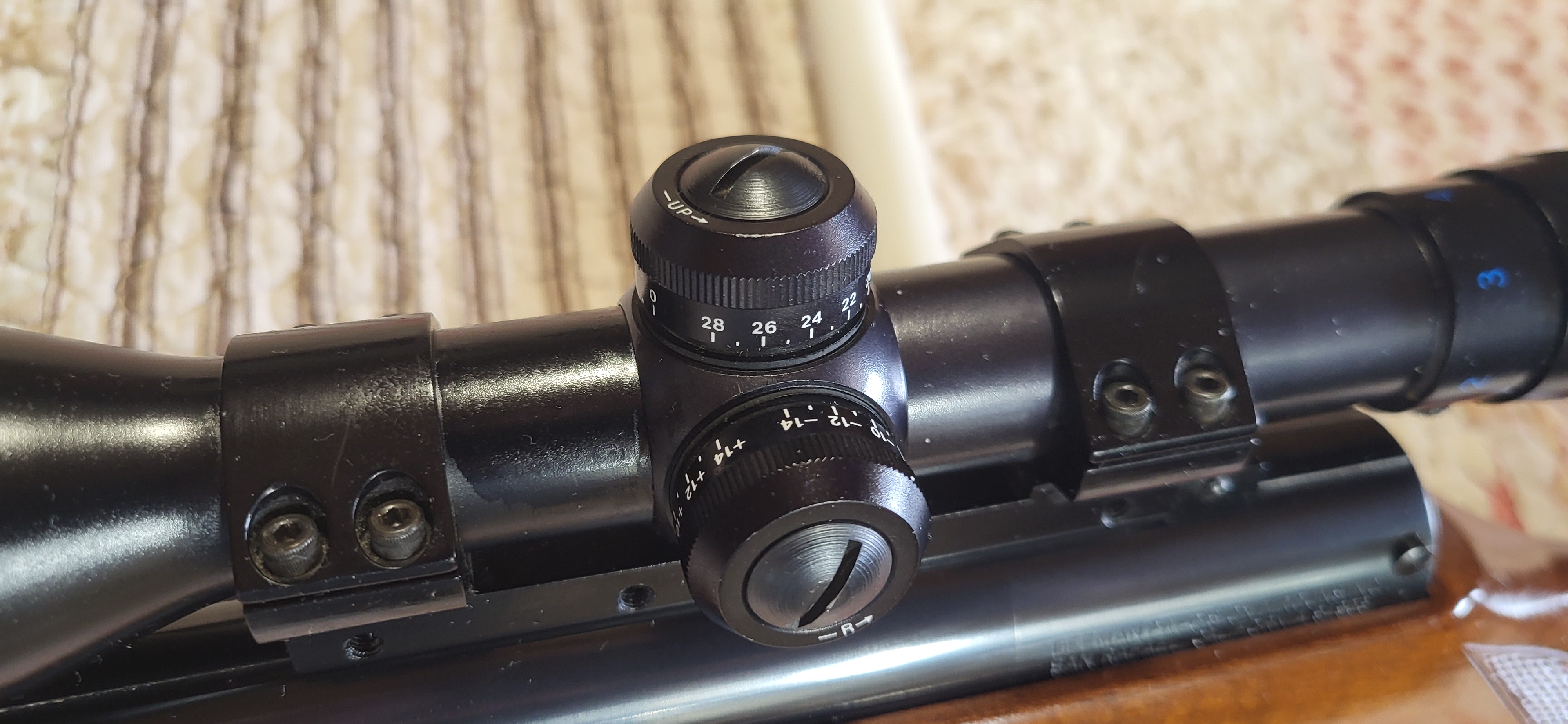

View attachment 526553Something I've never seen. The scope seems nice but I have yet to play with it. The gun is still acclimating to room temp and I don't know how the scope functions. Its stiff and I don't want to force it. The power ring and occular all turn together. Maybe one of you Blue Ribbon scope fans can explain it to me.
View attachment 526555View attachment 526556View attachment 526557
Be well all
Ron

It's just been brought to my attention that the Mark 1 has a different non removable front sight. The cocking arm release is simpler with no button. I'm not used to that. I keep pressing a button that isn't there 😅.
