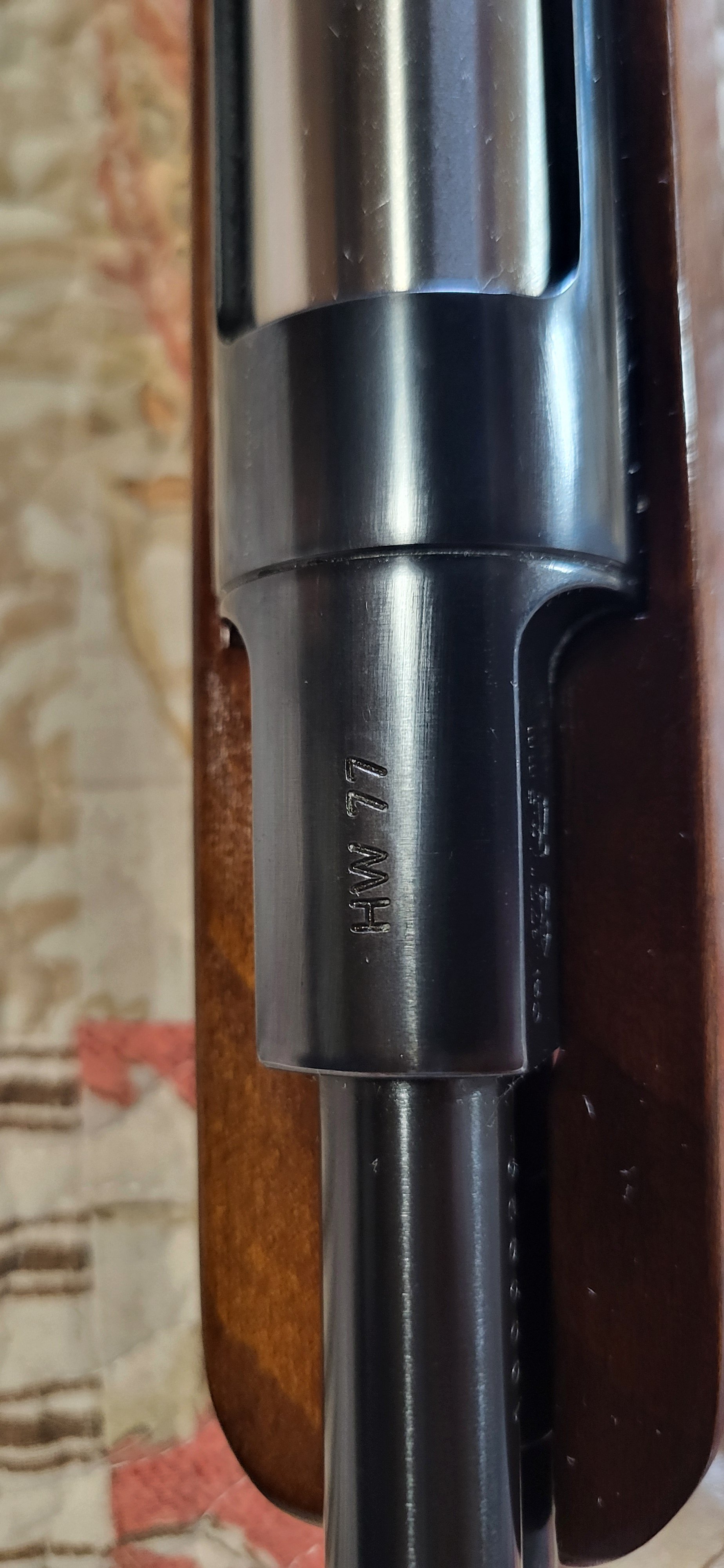

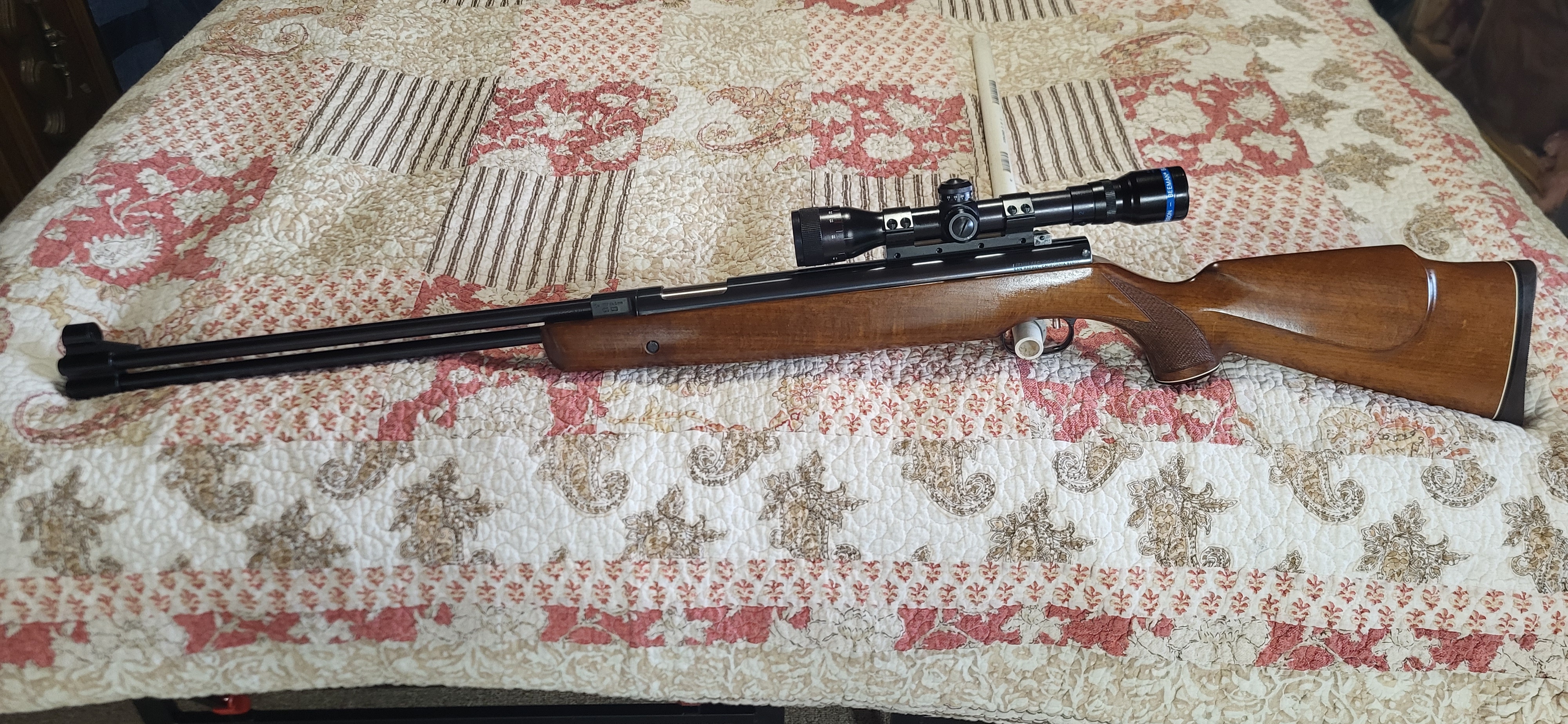

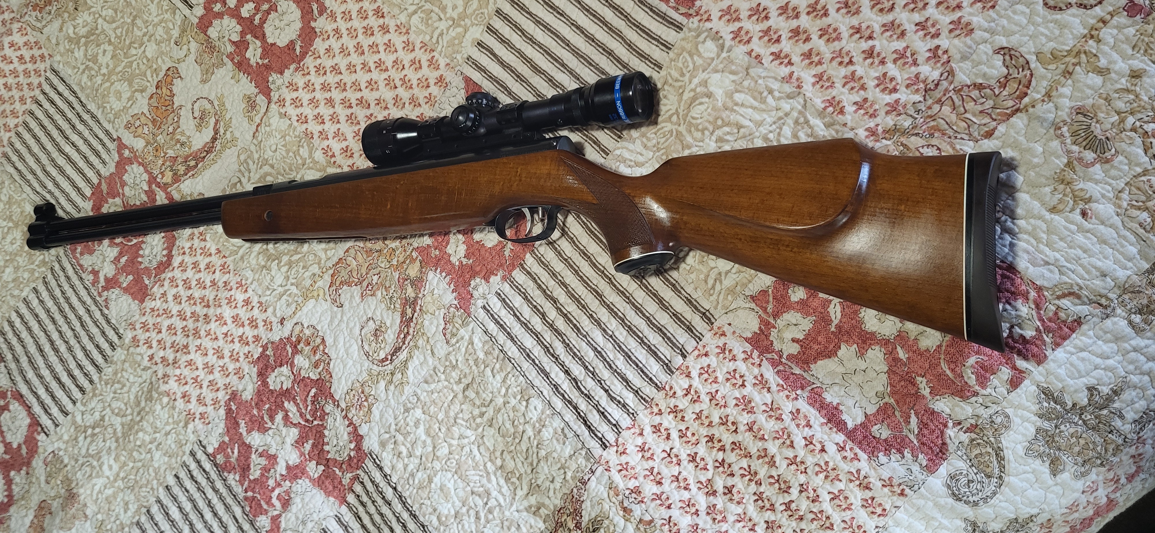

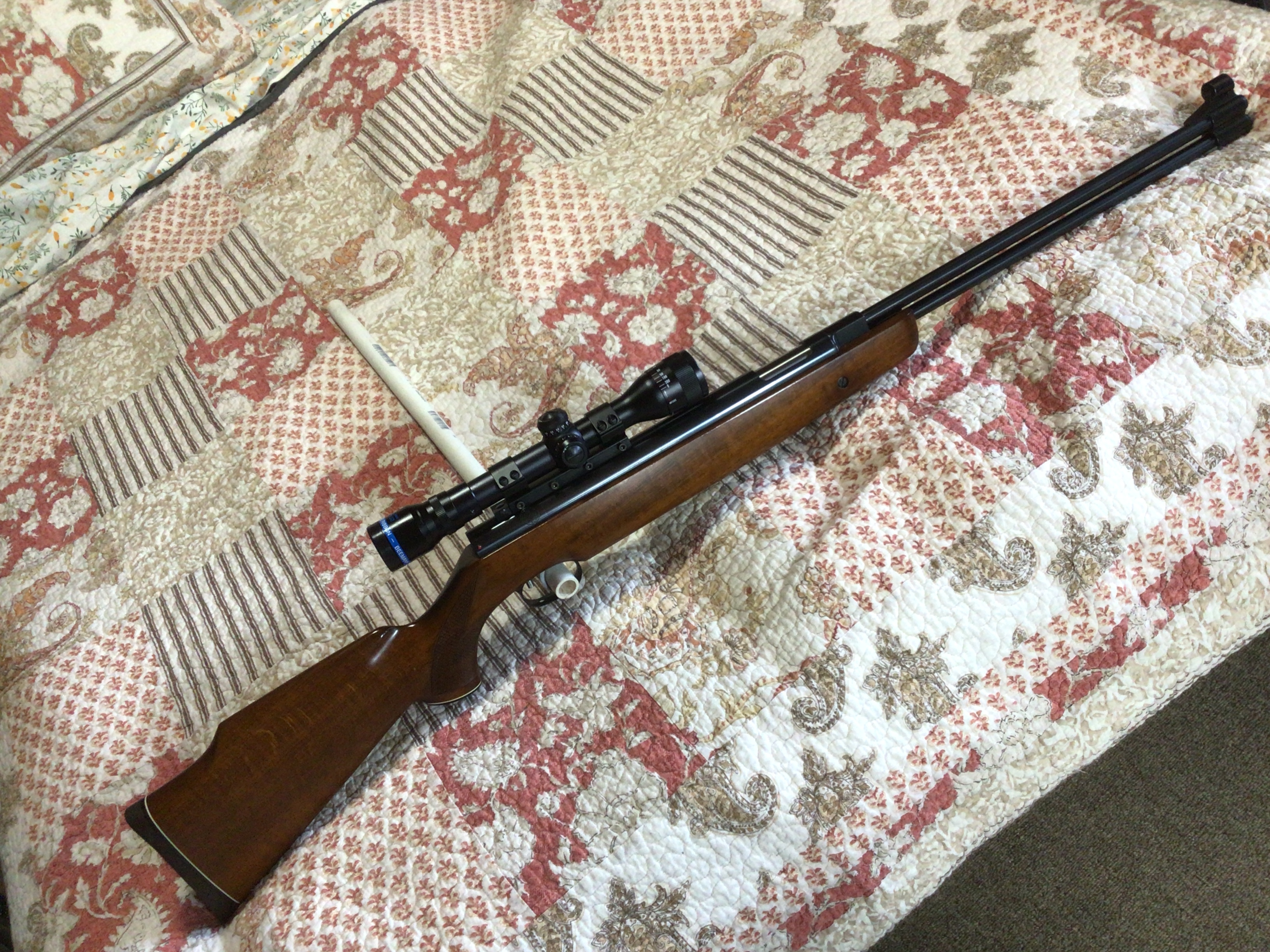

HW/Weihrauch Look what UPS just dropped off. A 77 Mk1.
Last week I posted about a rifle I won on ebay. It was a bit of money for me and I said I was done buying airguns before but BOY am I glad I bid on this.
I've always wanted a 77 with the earlier stock. I like the traditional rifle look of the longer 77 with the lower comb stocks.

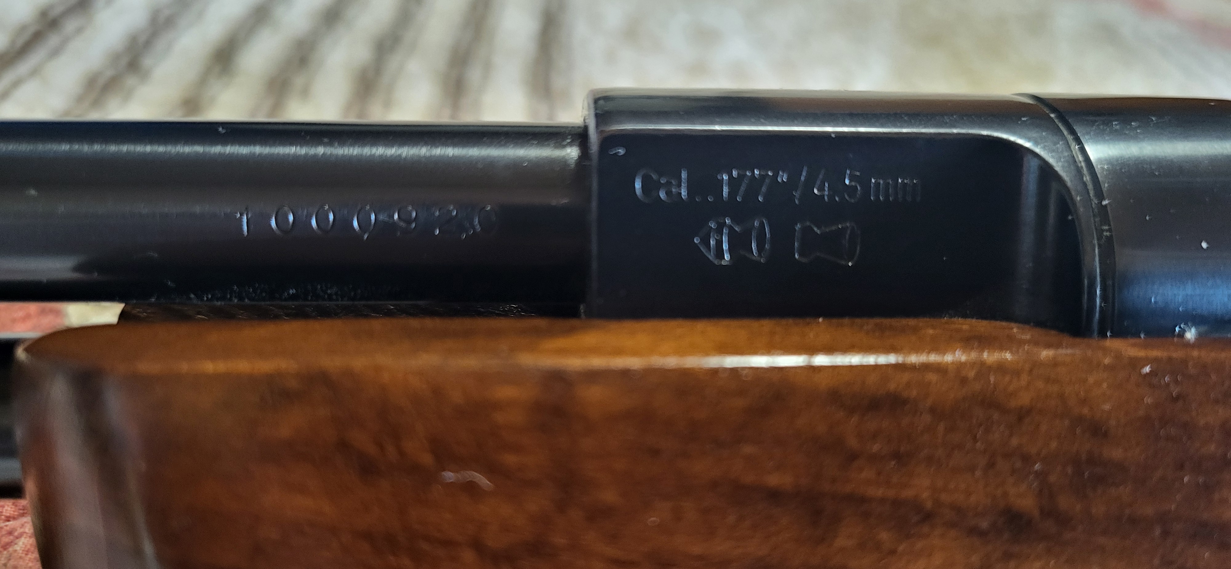

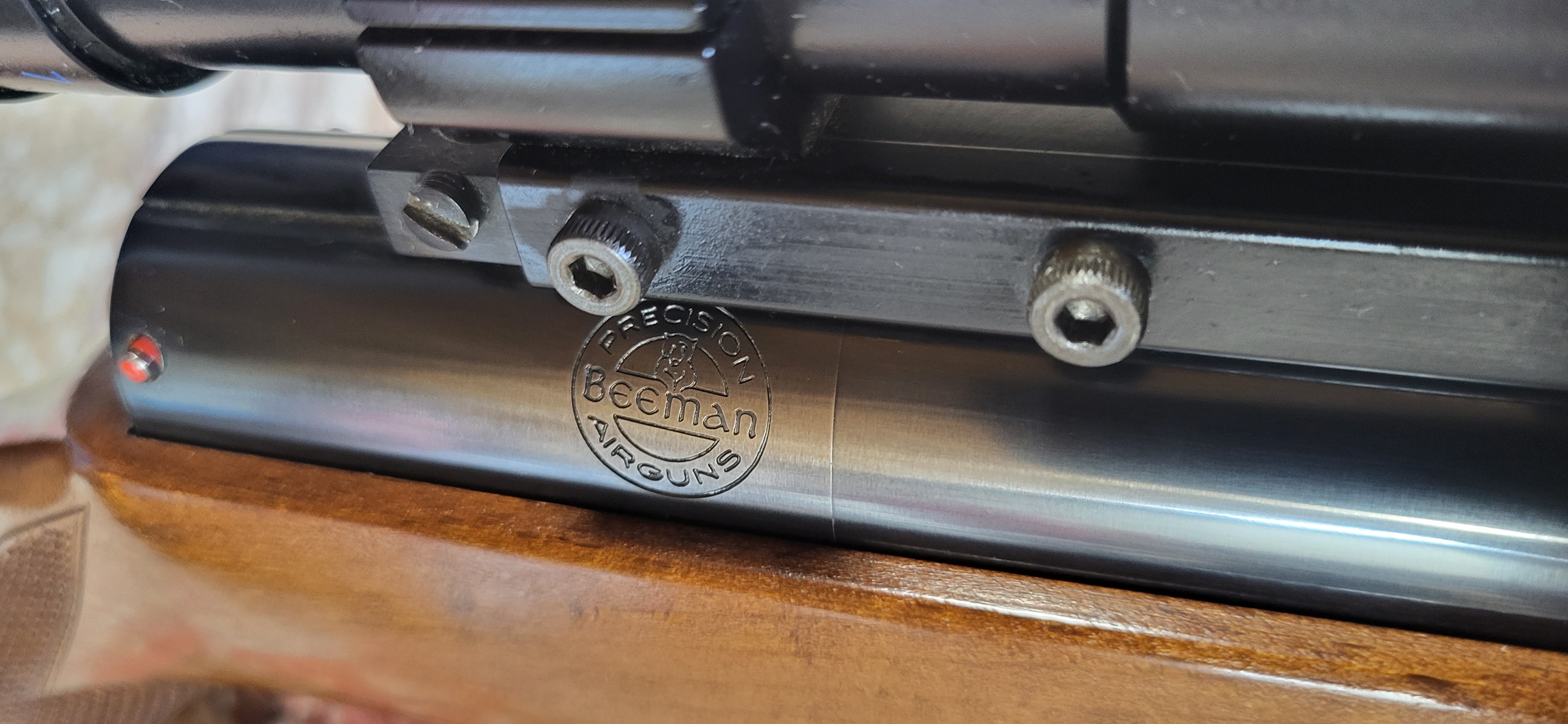

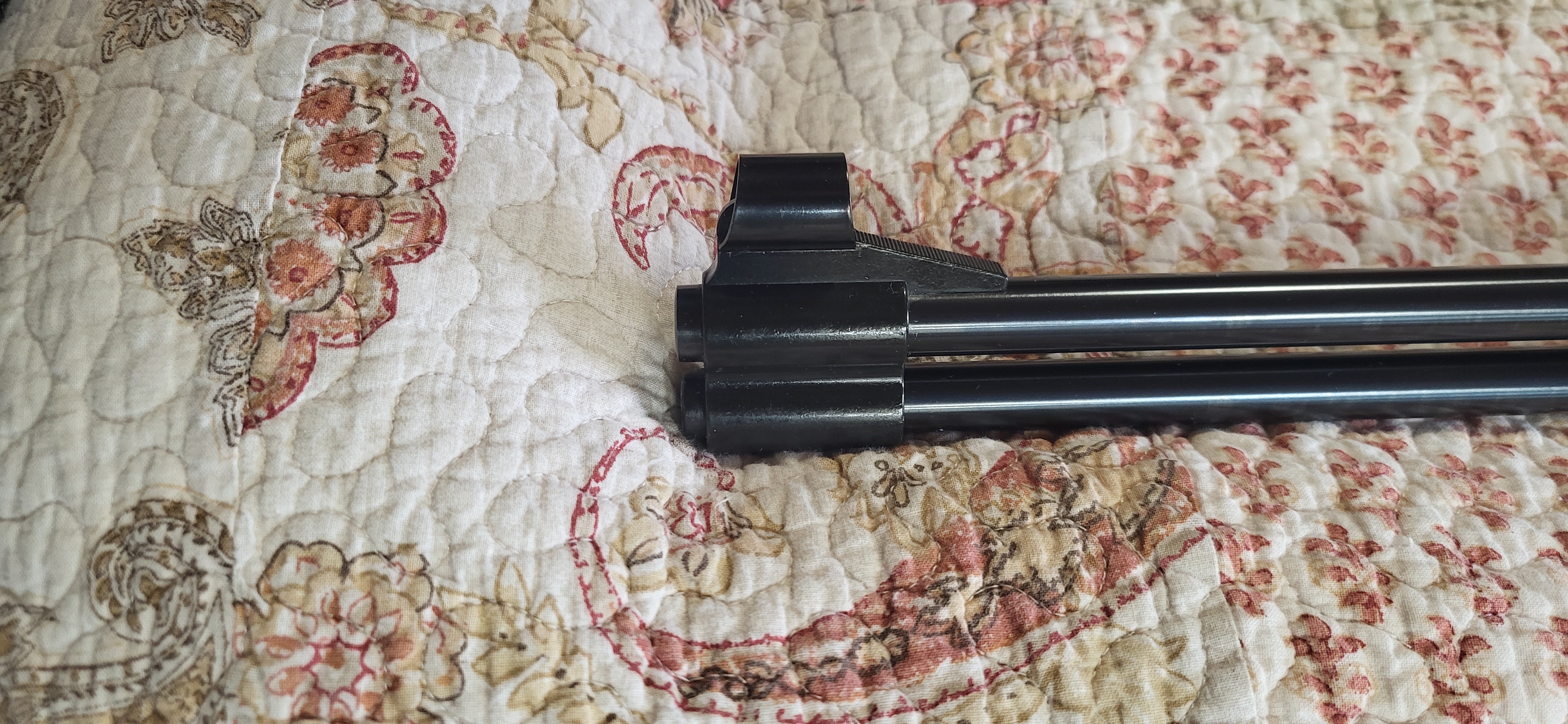

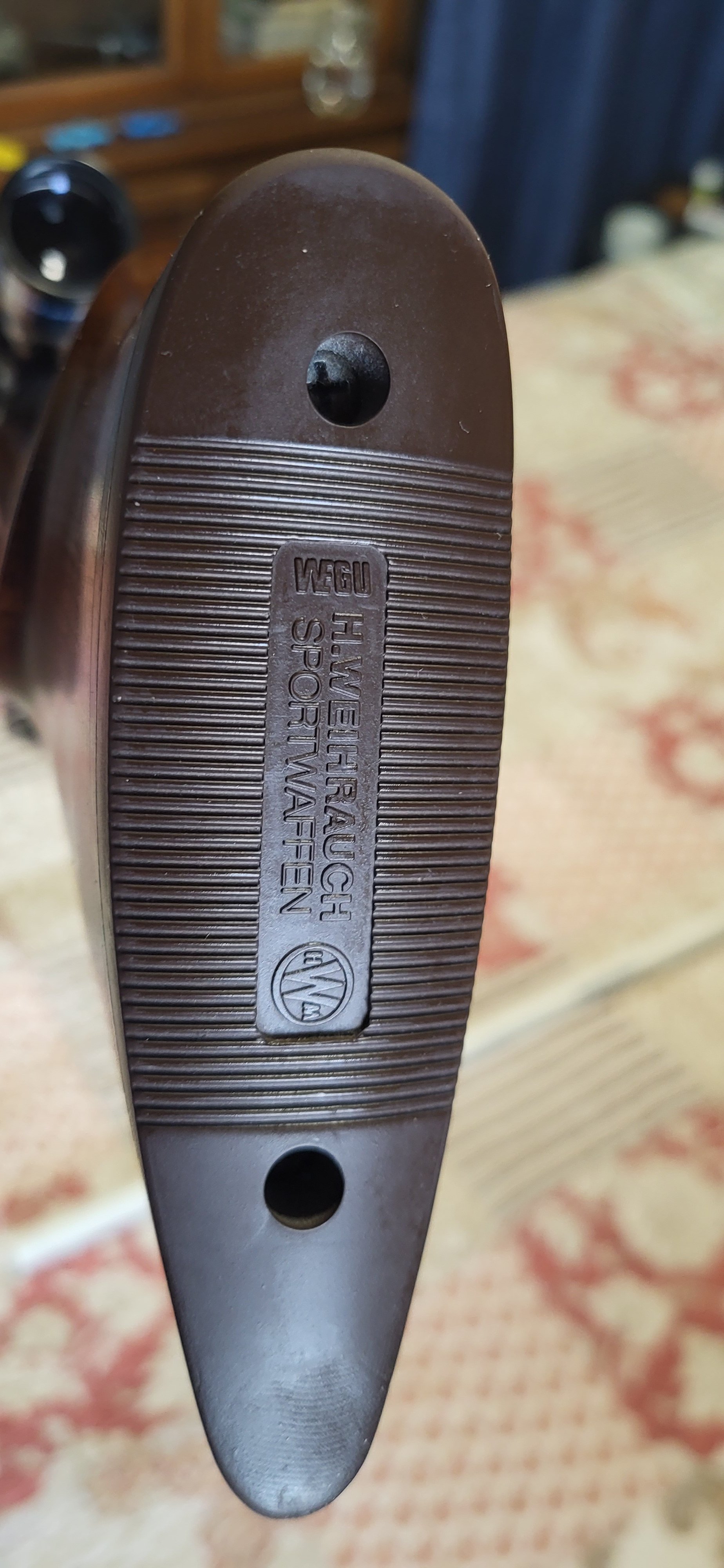

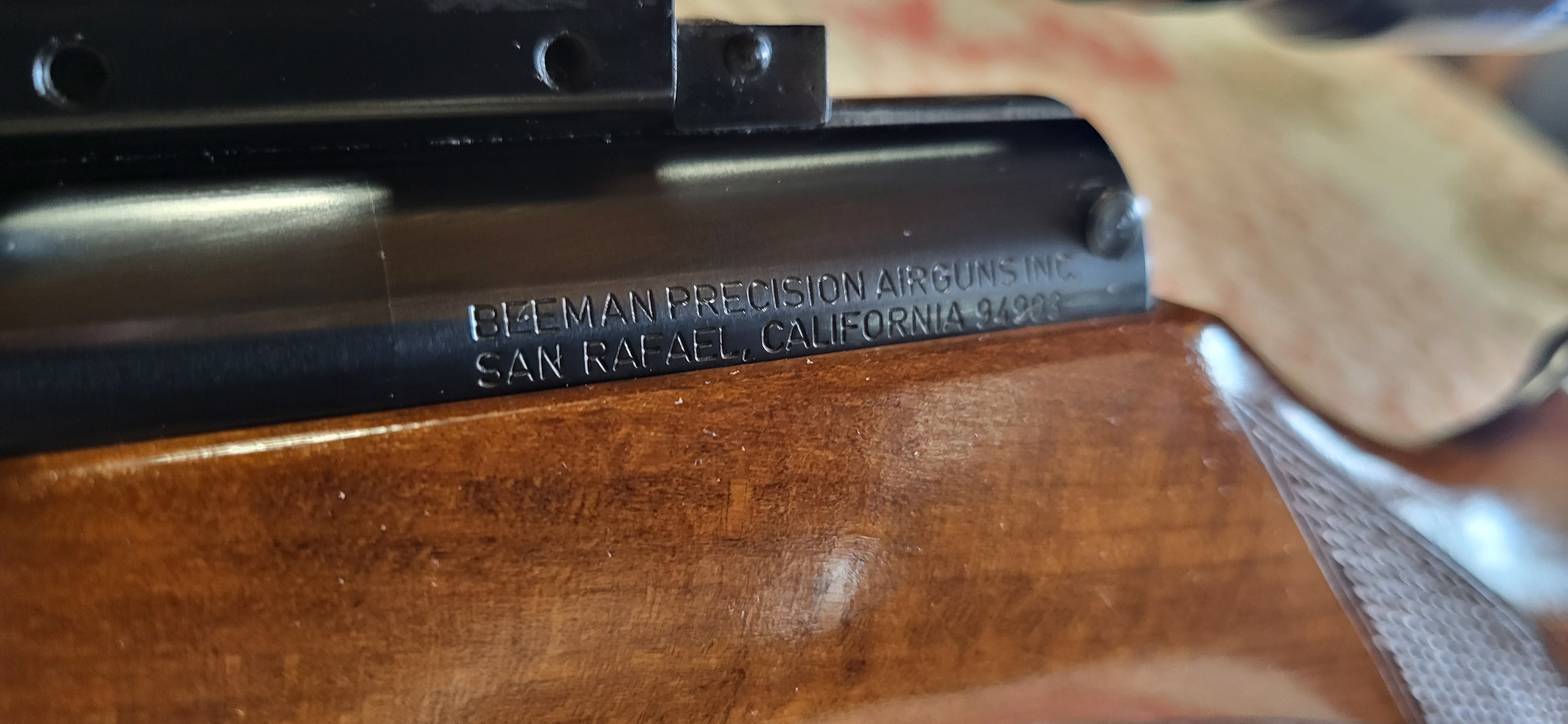

Not only is this a 77 with a low comb stock. It's a Beeman 77 MK1 with a Goudy stock. Its like a time capsule. It also has the time appropriate Beeman scope, scope mount and scope stop. All in near new condition. It looks to have the original front sight hood.View attachment 526554 Although the rear sights weren't included the sell says he can probably find them.
View attachment 526549View attachment 526550View attachment 526547View attachment 526551View attachment 526552

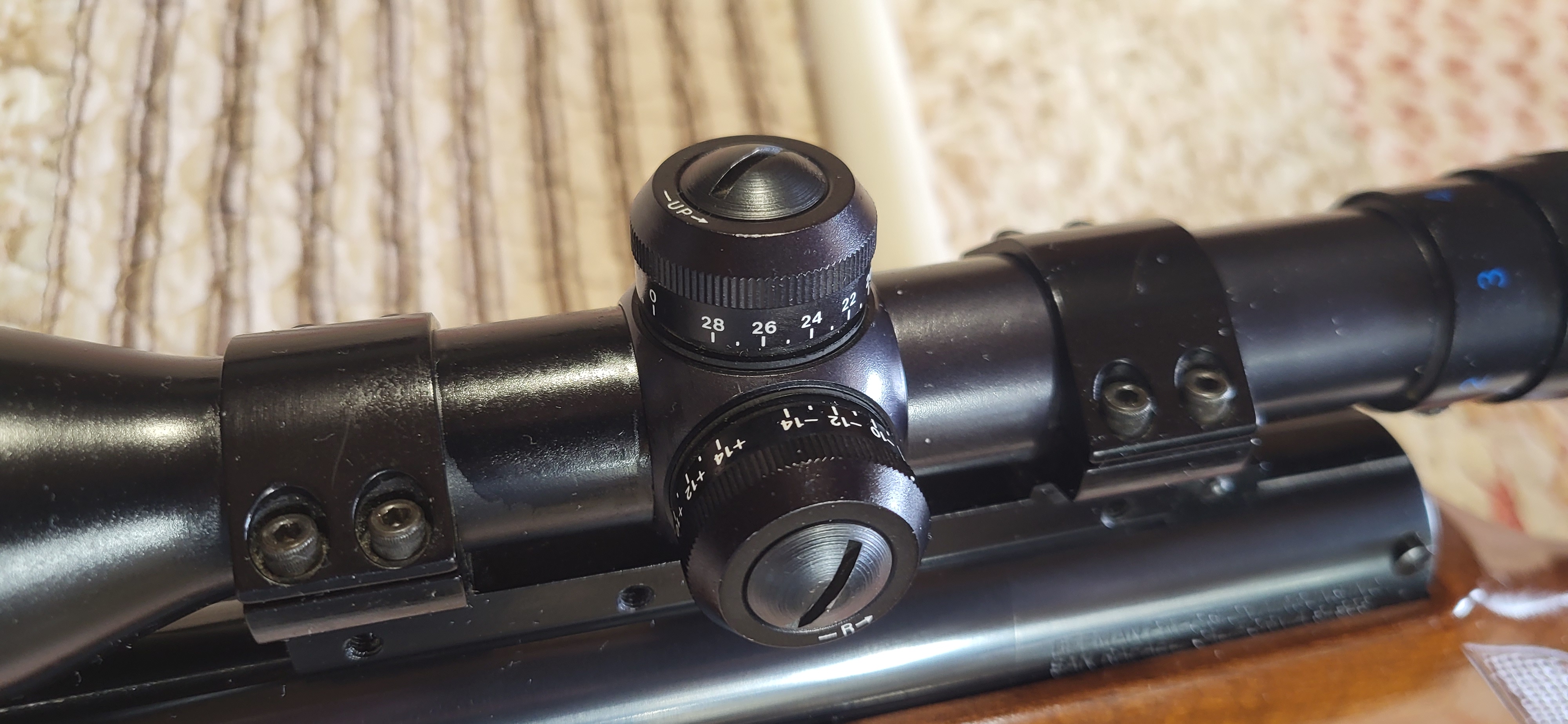

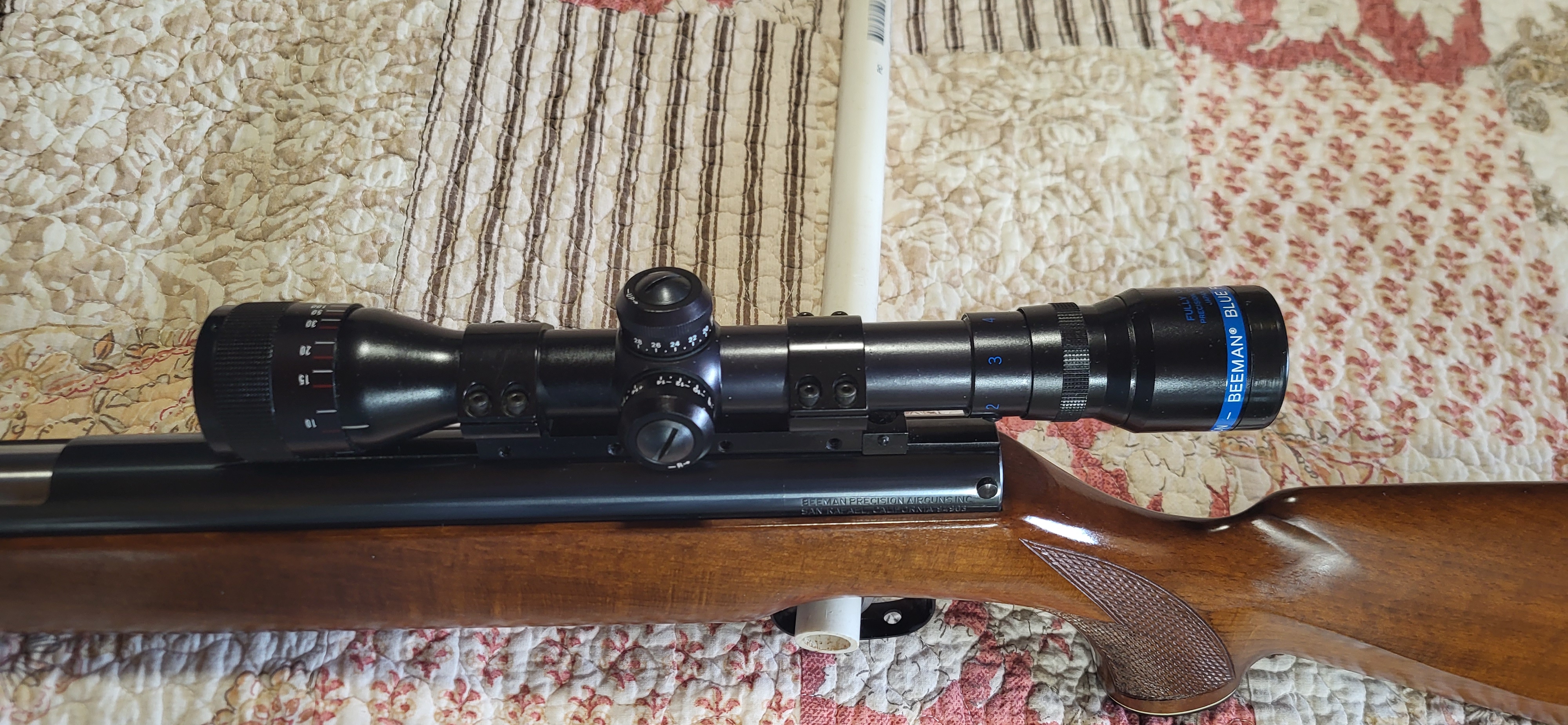

I actually thought the scope was mounted 90° rotated. Turns out it's not. The windage turret is on the left side.

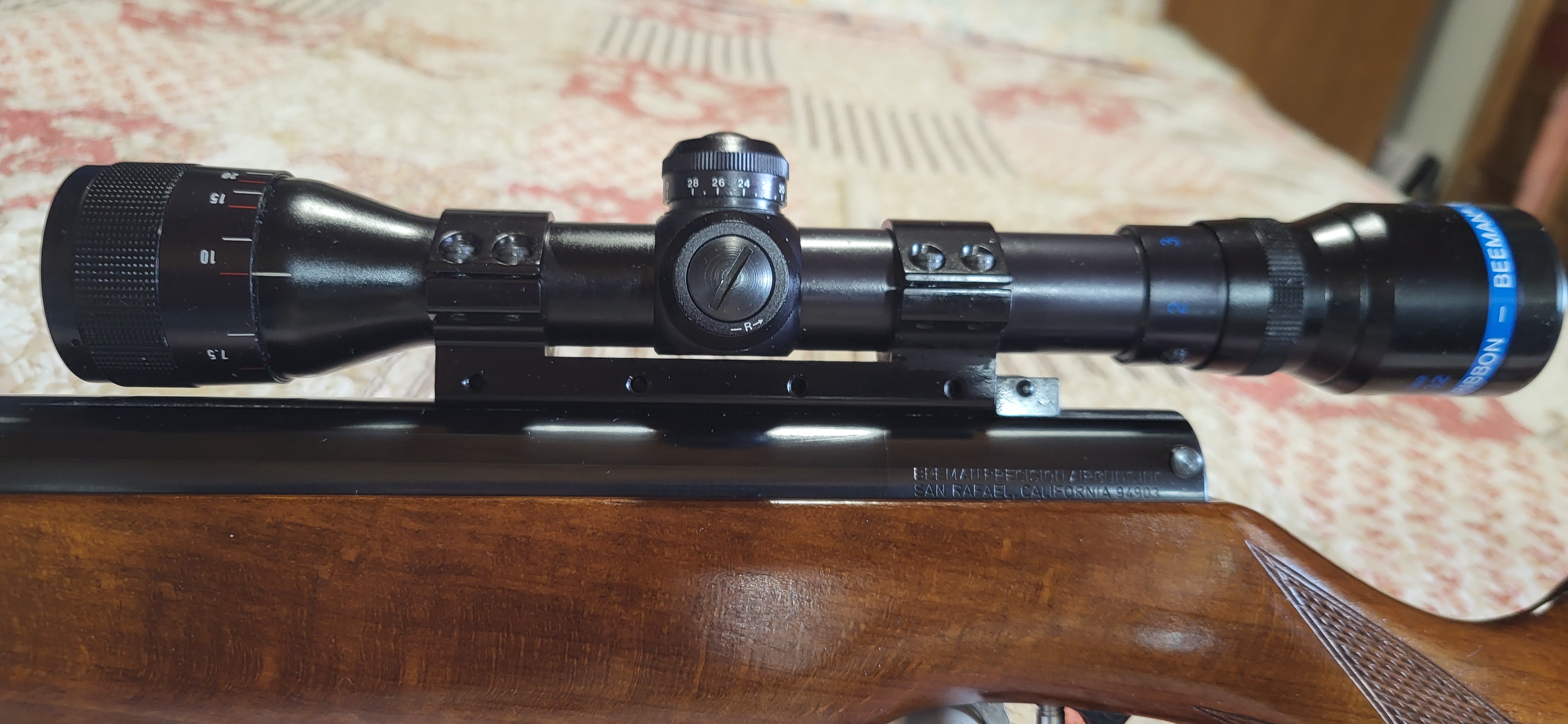

View attachment 526553Something I've never seen. The scope seems nice but I have yet to play with it. The gun is still acclimating to room temp and I don't know how the scope functions. Its stiff and I don't want to force it. The power ring and occular all turn together. Maybe one of you Blue Ribbon scope fans can explain it to me.

As far as the stiff ocular and or objective, a drop of Ballistol and let it work.

The Mark 1 to the best of my knowledge is the earliest 77 version made. It uses a 25mm piston and sliding compression tube. The advantage of that is the reduced piston weight reduces recoil energy. I don't have to explain how that benefits accuracy to you.
A smaller diameter pistion has less surface area so it's less prone to piston bounce under the same back pressure. Similar to hydraulic theory wher a smaller pistion moves further but requires less pressure to move than a larger piston under the same load.
Also a smaller piston seal has less surface area. Less surface are reduces thermal expansion issues because the expansion disparity between the steel tube and piston seal is less. This is why why my 25mm Hw30s suffer less TE issues than my 26mm 50, 95 & 97. Those in turn suffer less TE issues than my R1.
Incidentlly AA TXs run 25mm pistons with hollow seals that experience less TE than the same size Weihrauch full cap style piston seals. For all the reasons above, 97s that are tuned for FT will sometimes run 25mm pistons when available. More serious FT 97s look nothing like the original inside.
The outer receiver on the Mark 1 is the same as the later 77/97 series. All you need to convert a later gun to 25mm is the piston and sliding comp tube. Another perk of that is all the guns use the same stock inletting, so stocks are interchangeable. For instance I can put my Goudy 77 stock on my late model Laminate 97 and vice versa.
It's just been brought to my attention that the Mark 1 has a different non removable front sight. The cocking arm release is simpler with no button. I'm not used to that. I keep pressing a button that isn't there 😅.
The loading port is a little smaller on the Mark 1 as well. When these guns first came out they were very popular FT rifles. Several custom shops would mill these open for easier loading during competition. Shortening the barrels to reduce dwell time and muzzle flip was another popular mod. Weihrauch incorporated threes popular mods in the next generation of underlevers with the introduction of the 77K and 97K.
That's all the differences I know of. Oh wait one more the Mark 1 has no ABT so it can be decocked. I guess it predates our ridiculous litigious society.

Today I cleaned up, mounted the scope to the correct clock position and set the eye relief. Interestingly the scope has numbered turrets, a resetable zero and zero stop system. All admirable features by today's standards much less something forty years old.
