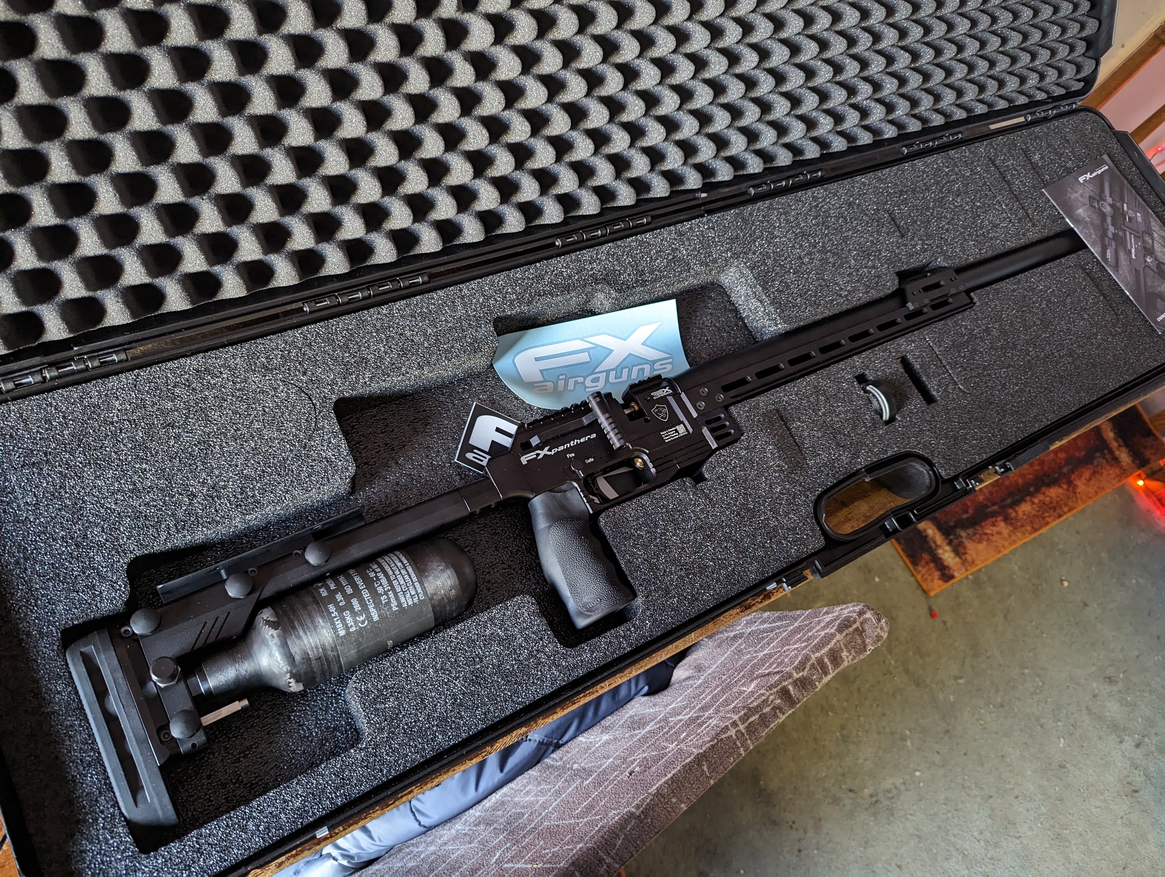

Look what ups just dropped off *cue the brand haters*
Gunna see if the optics I got will fit with the rings I have.... Then top her up and see what she slings a 34g .22 at.
Edit* Few things seem a bit lose 😳. Going to go over it and make sure everything is good and snug before we send any lead out the business end
Cue the FX haters!

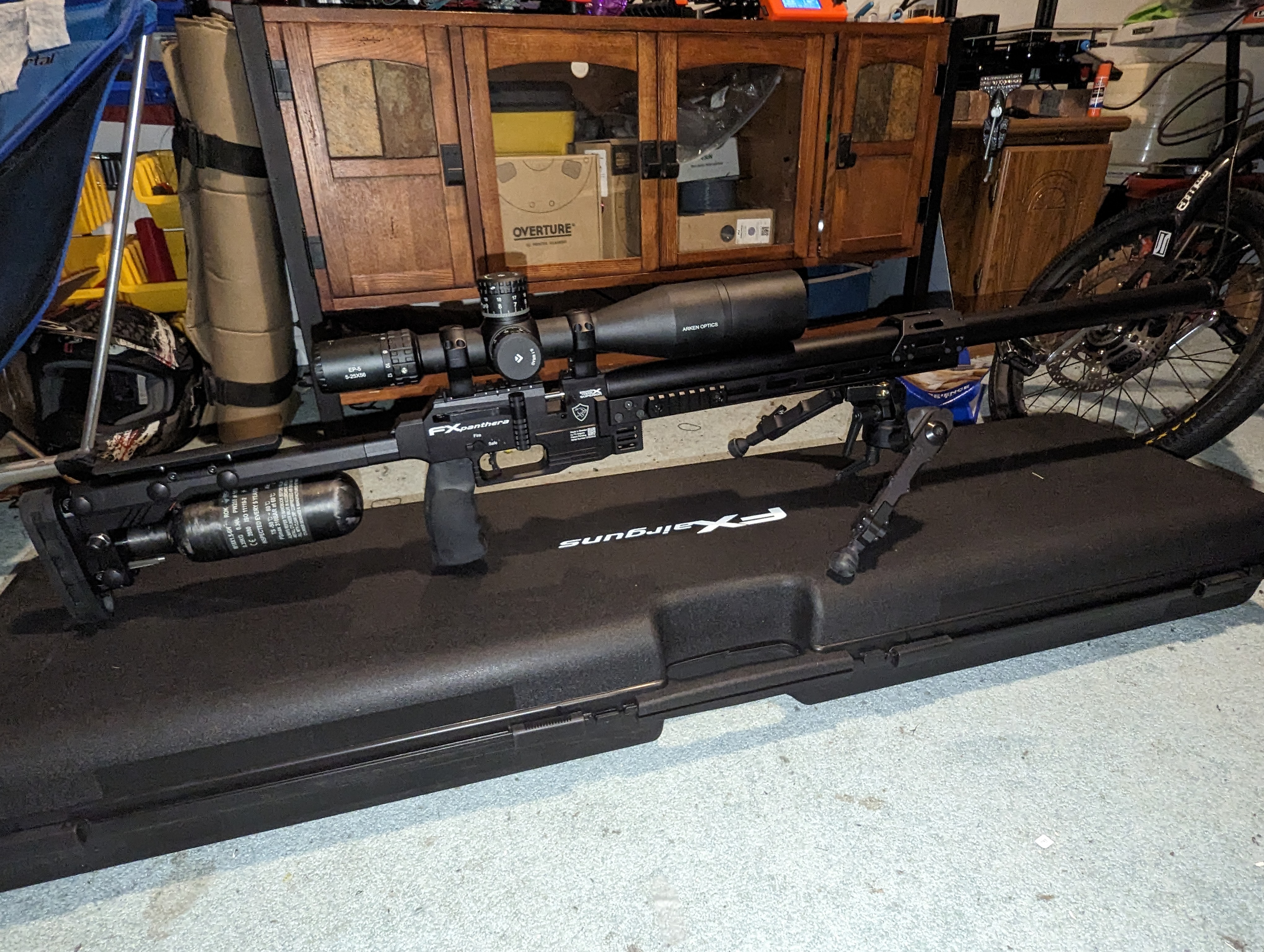

So.. first thing.. I had to take the shroud guard off to tighten the block at the base of it. I noticed the barrel shroud/plenum would touch the guard on one side. Got all that tightened back up, mounted my Arken 5-25 EP-5 (barely cleared the magazine with the mid height rings), and dug out the chronograph.
Reg was over 150 bar. Power wheel on max and micro at 3. I tossed in some Javelin 34g .218 and ran a string. Cocking lever is MUCH more stiff than my m3. Some of that is the detents and some of it iss the heavy hammer spring. You can tell they set these up to make some power
Reg settled to 135bar and the slugs were moving at 996fps. (75fpe?). My basement range is SHORT... But outside of the first shot with the high pressure in the plenum, it was hole in hole. So that's promising.
Something else that surprised me is it feels light compared to my M3 and all the crap that's bolted to it. Excited to take it out and dial here in and see what it can do.
