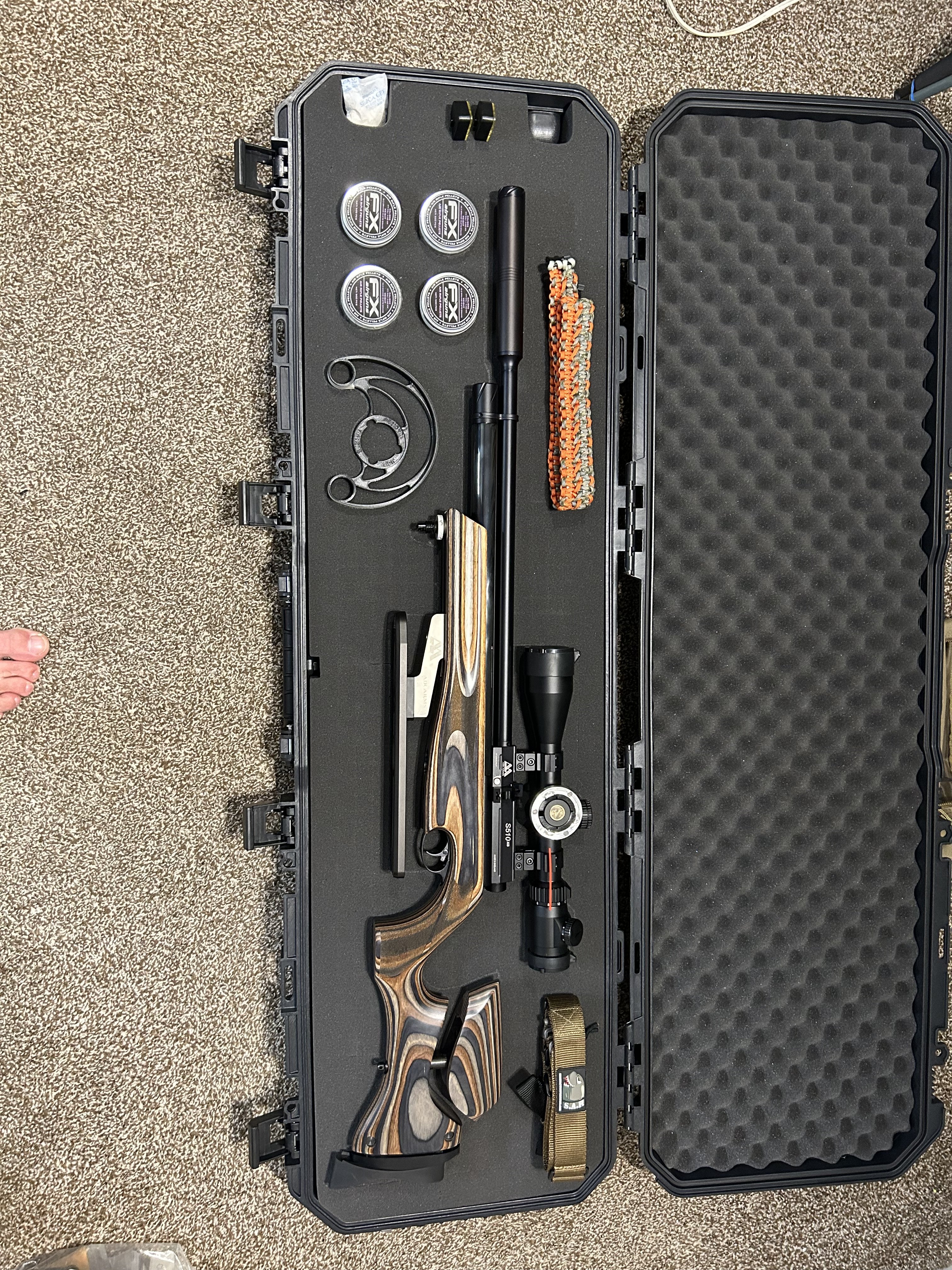

Very very good choice. Shoot very accurately and are so smooth. I got the Rowan auto pop out single shot tray. Used mags too. Both work great.
This is the carbine version. They make one longer. You shoot 60 shots a match. The full size you wont have to refill but my carbine i need to after 40 shots but not an issue.
