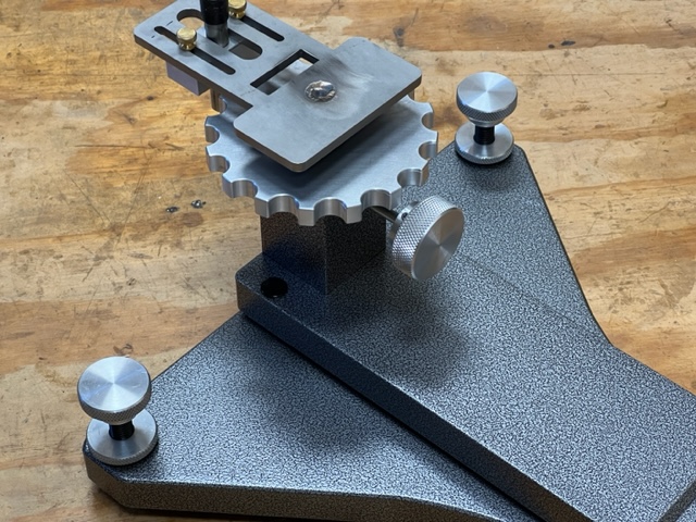

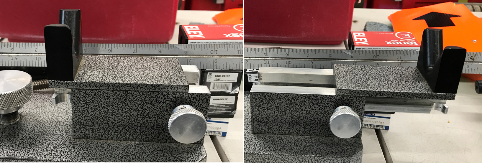

This is a nice Randolph feature. It allows better tuning.
7-1/2" adjustment range

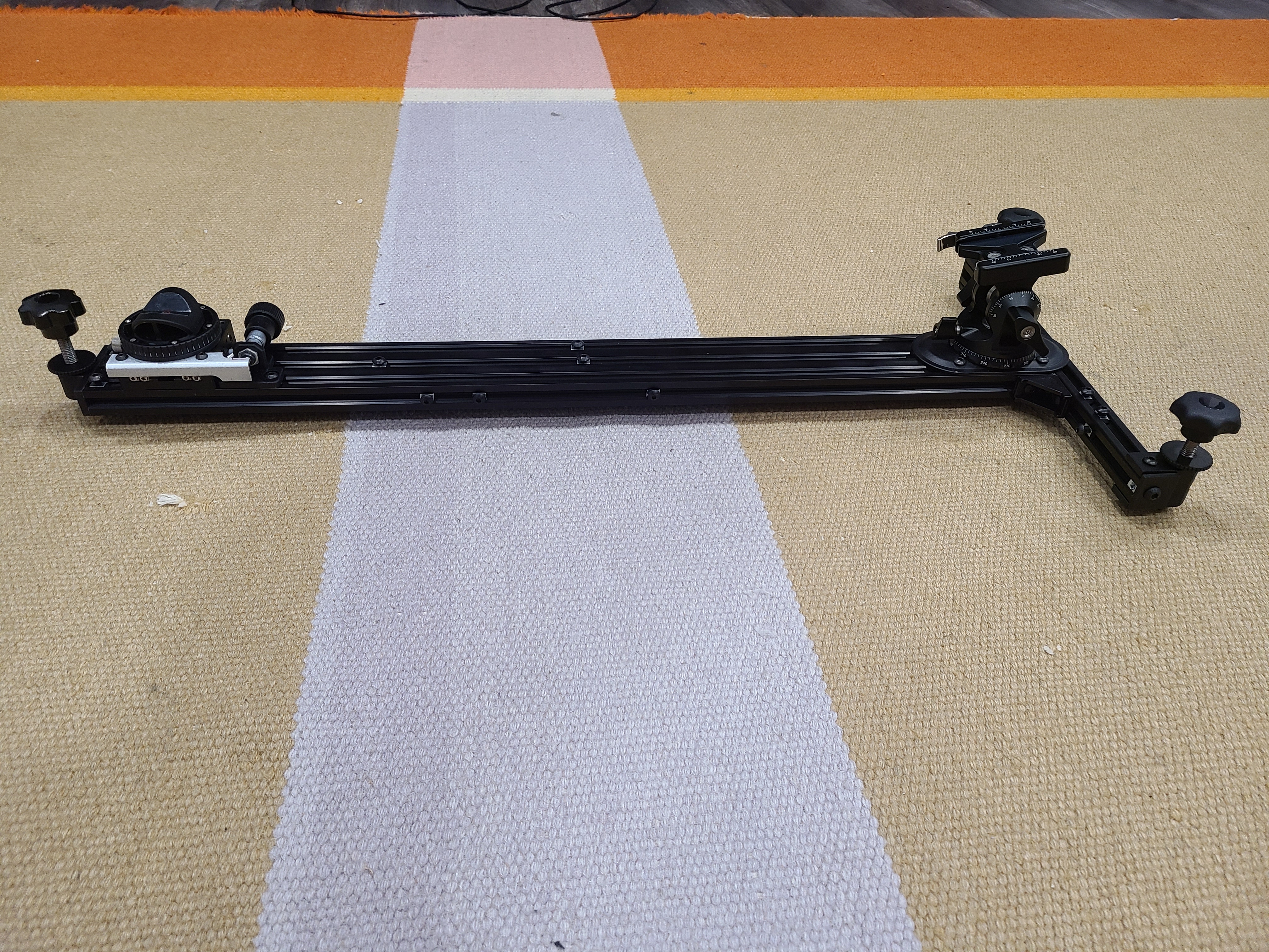

The Pappas, Hall and PQP will not work because there is not the adjustment the Randolph has in the rear (see pic of Loufish ). The rifle in its earlier production state is not long enough. Some mods and yes can work. Cliff Arnold from Arnold Machine will make you a rest that has different slots in the rest that can be moved fore and aft. Wait time will be long.
