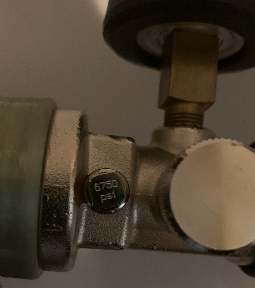

I’m not sure of the size you’ll need, but in my Air Venturi Jubilee valve it appears that my burst disc is rated for 6750 psi. This is on a 90cuft, 4500 psi, carbon-fiber SCBA tank.
At first glance this burst disk appears to be smaller than the burst disk in my Evol.
Edit: It appears yours may be a 7.5k burst disk. Different valve pictured below, but for a tank with the same working pressure rating. @kayaker 's advice is sound.
Reactions: JimNM
