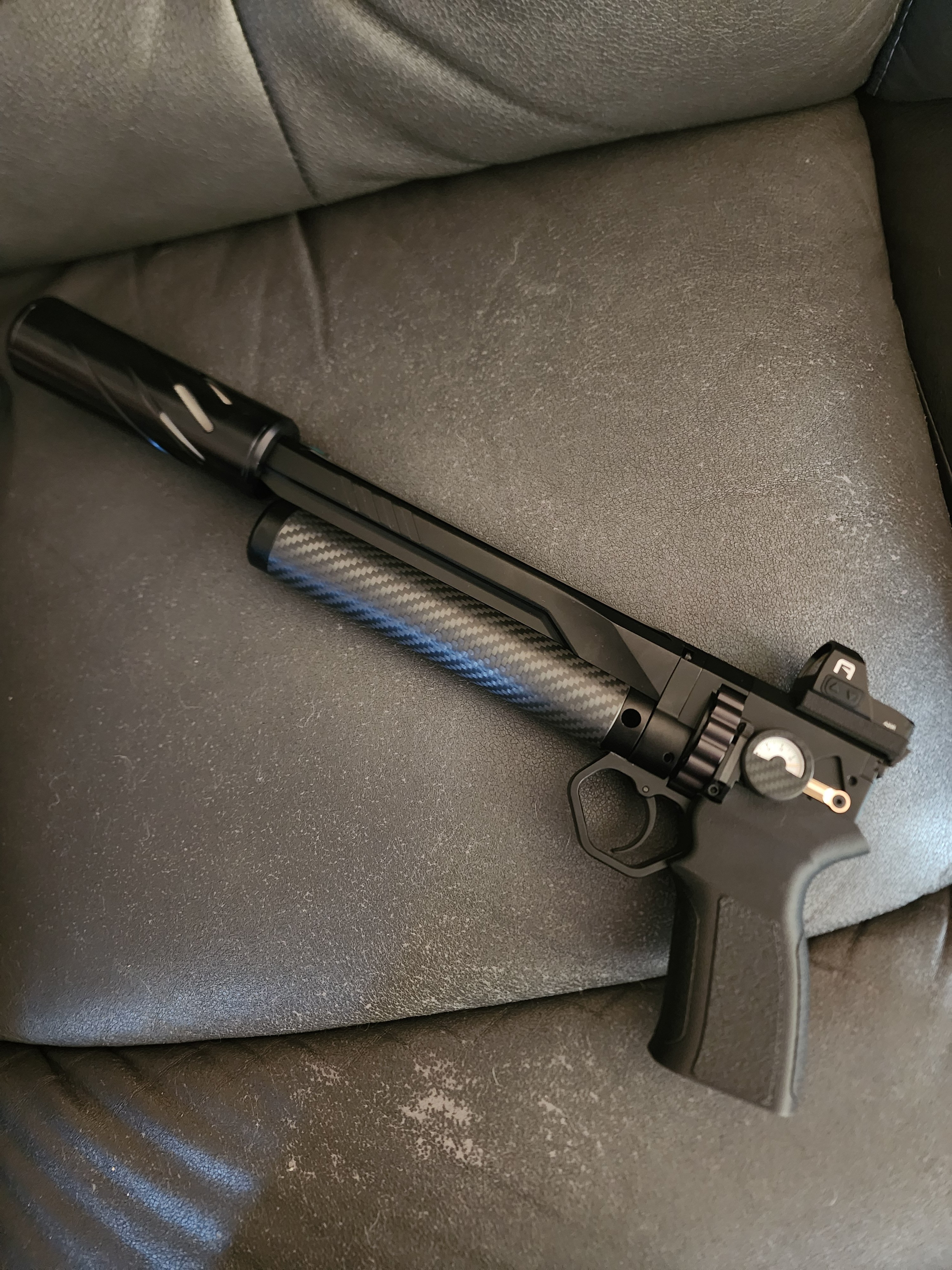

I'm using a subscriber bore test .22 ldc on my .25 gk1 shorty amazing how well it works and pretty dang light.

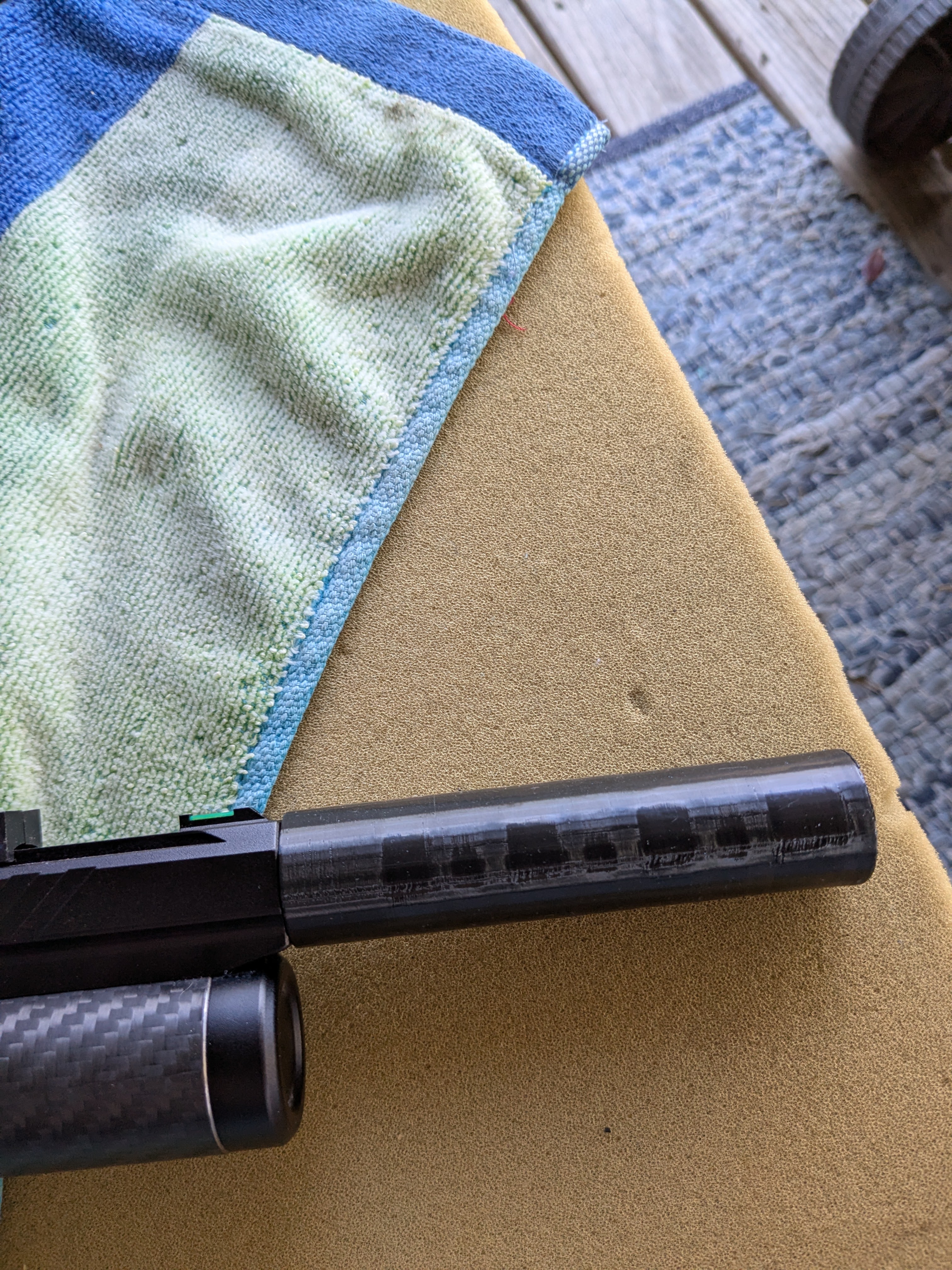

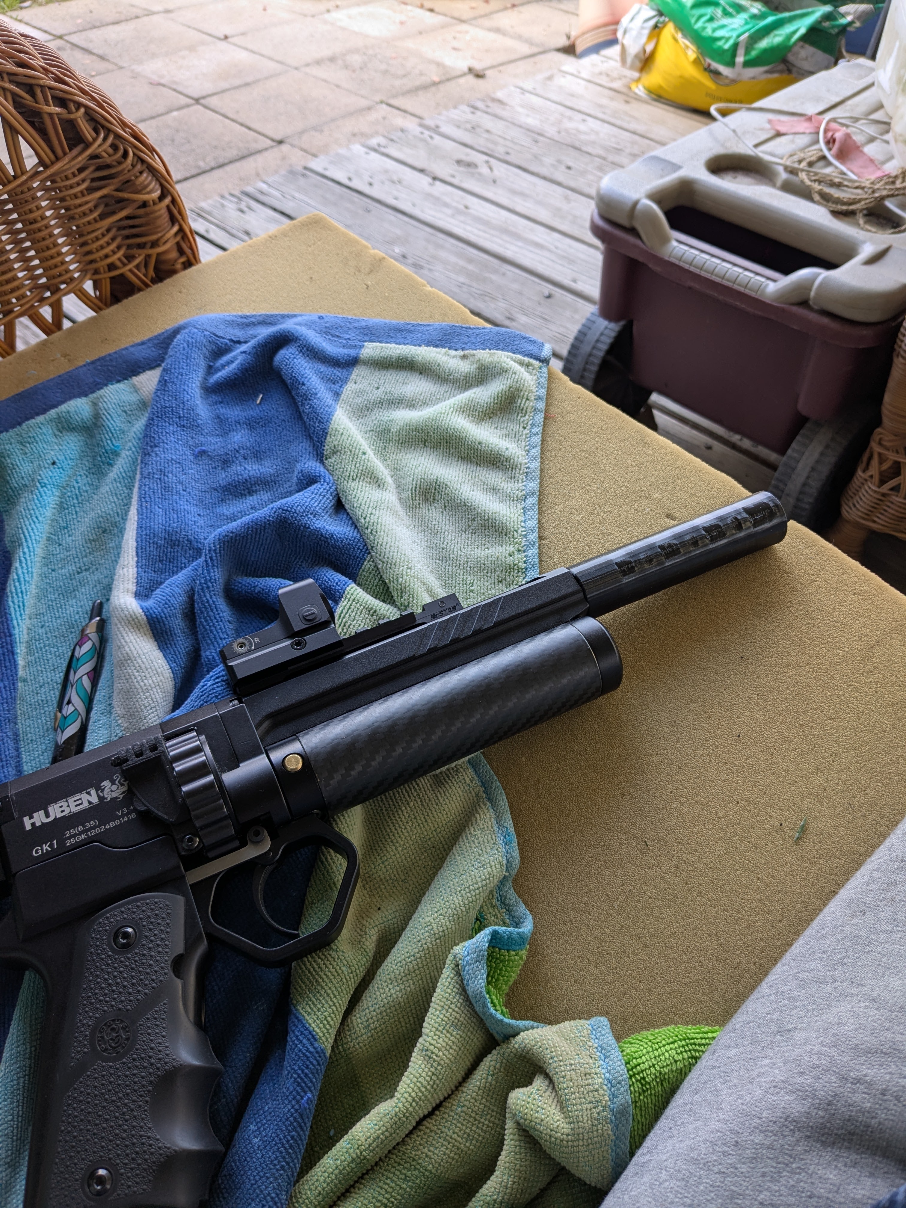

I don't know how quiet you can make an 80fpe quite. I have a gk1 in 177 with a custom carbon fibers shroud moderator. It's so quiet you could be standing right next to the shooter and you wouldn't know that it was a gun and went off.

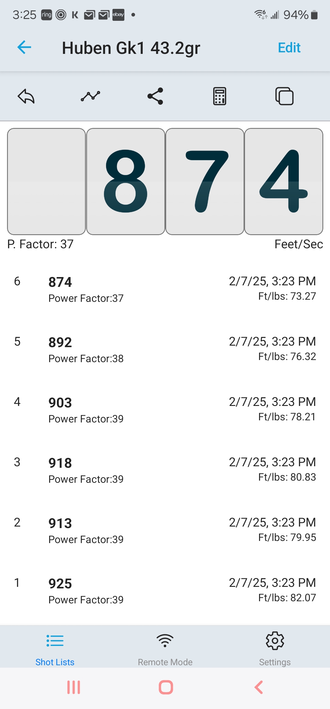

The gun does more than 80 fpe the hugget mini makes is neighborhood friendly sounds like a nail gun sort of with the moderator

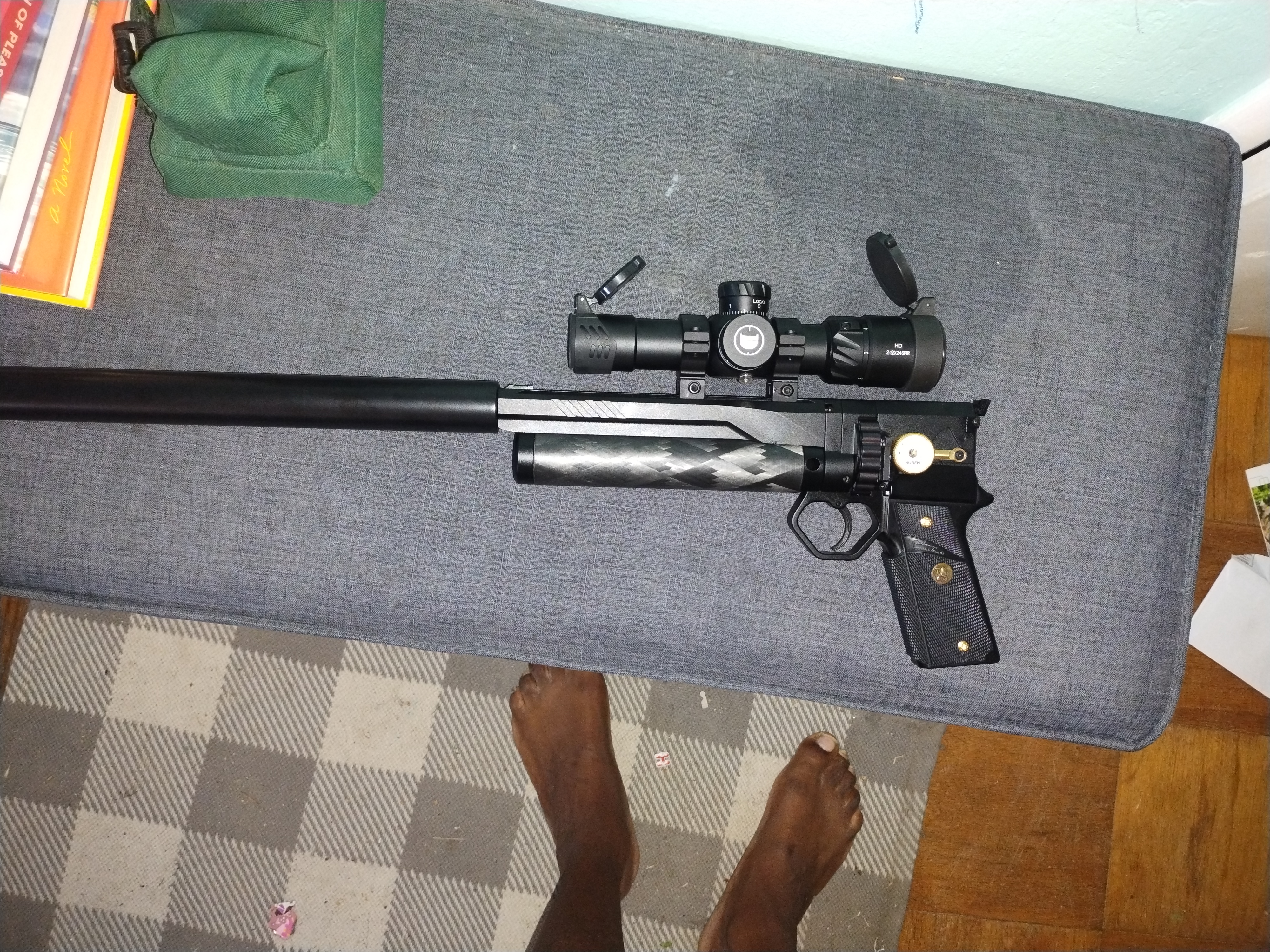

Yes, you can silence a .25 for backyard use, but you do not need to shoot with energy levels higher than say about 40 lbs. If you adjust the power to about 700 fps, you can shoot one full magazine (17) starting at 300 bar and end up with about 220 bar left, which will give you 17 rounds at a very consistent velocity. I then recharge the gun back to 300 bar from a bottle in about 10 seconds. Do not shoot the gun without a pellet, because of the way the valve system works as the muzzle report is much louder. On another point, I make my own silencers and I use a much smaller moderator bore size than most commercial moderators. That makes my moderators quite a bit more quiet than commercially sold mods.
