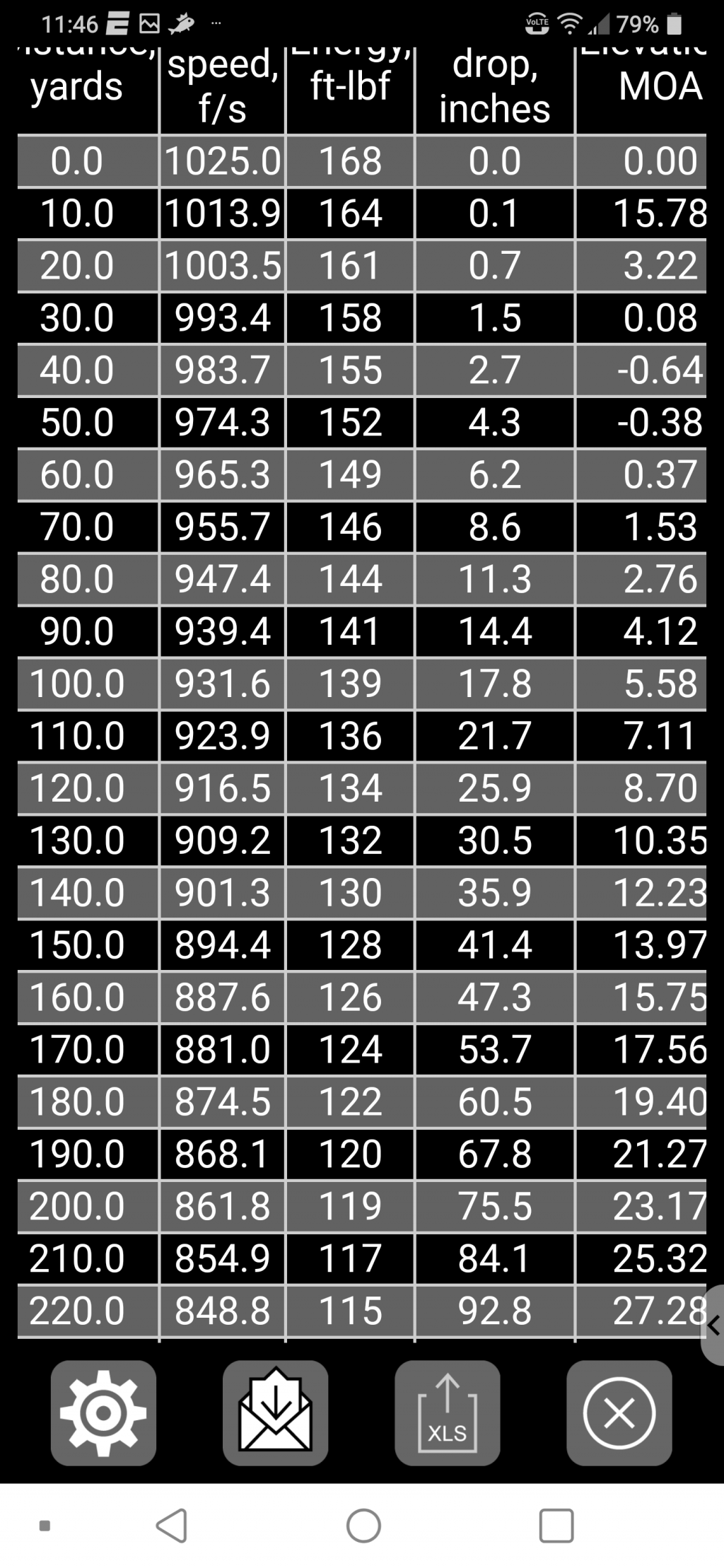

I posted early in tread. Shooting arsenal 257420 72g. @ 140 yds 130fpe.
