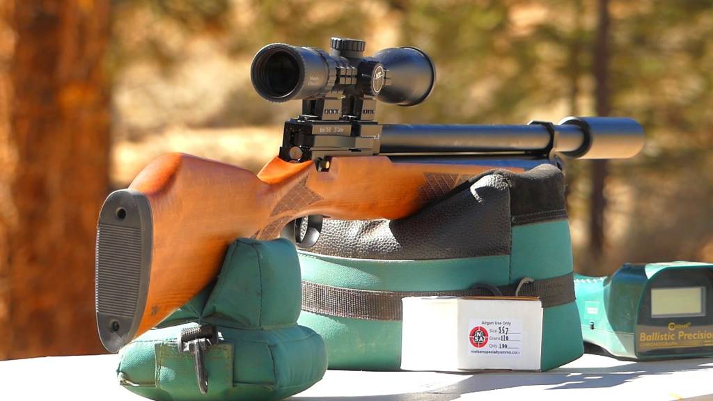

A .357 Benjamin Bulldog is definitely capable as is a big bore Airforce Texan. A stock Bulldog’s probably your best bet for that price range. I’ve read that AEA makes capable guns, but I’ve never used them and don’t know much about the accuracy and particulars of various models. They do seem to be affordable and powerful though. Maybe someone with experience with them can chime in.

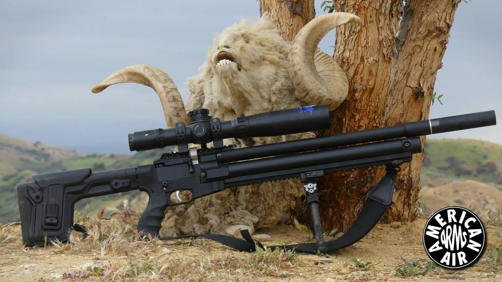

No votes for the AAA Evol .30 for coyotes? (The Evol is directed toward @KevinTN’s post).
In the $700 range I got to say my recent experience with the Winchester Model 70 .35 has been really good. I really like the gun for predator type hunting. The accuracy I'm getting with the 110gr NSA's are really good out past 100. The gun is putting out a conservative 130 fpe over 8 shots.
Yeah the EVOL is a badass hunting gun for sure. Didn't mention it due to OP's budget as this is a commitment.

I’m in need of one mine was takenMan, that's a gorgeous Winchester Air Rifle.
