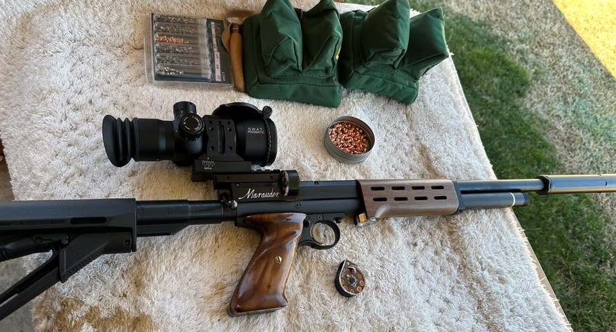

Since "looks" is important to you, do you like the looks of this P-Rod converted to a carbine? The MTC S.W.A.T. 12x50 scope really lightened it up. A perfect backyard friending .22 for me. Deadly accurate.
