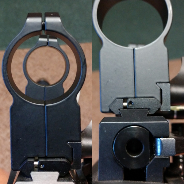

Just recived the BKL dove to pic adaptors, lines up the scope with eye sight real nice.

i have not had any use for this type of conversion, but if i remember correctly BKL makes top of the line products in this area.
Putting the BKL adaptors on my Texan with high rings really put the scope in a better position then just using tall rings, I’m going to order another set for my Texan 45, now I don’t need to tilt my head so much, but now I need to re zero and will see how adding that extra 1/2 inch to scope height will effect everything, other then that I don’t know where else I’d use them either.
