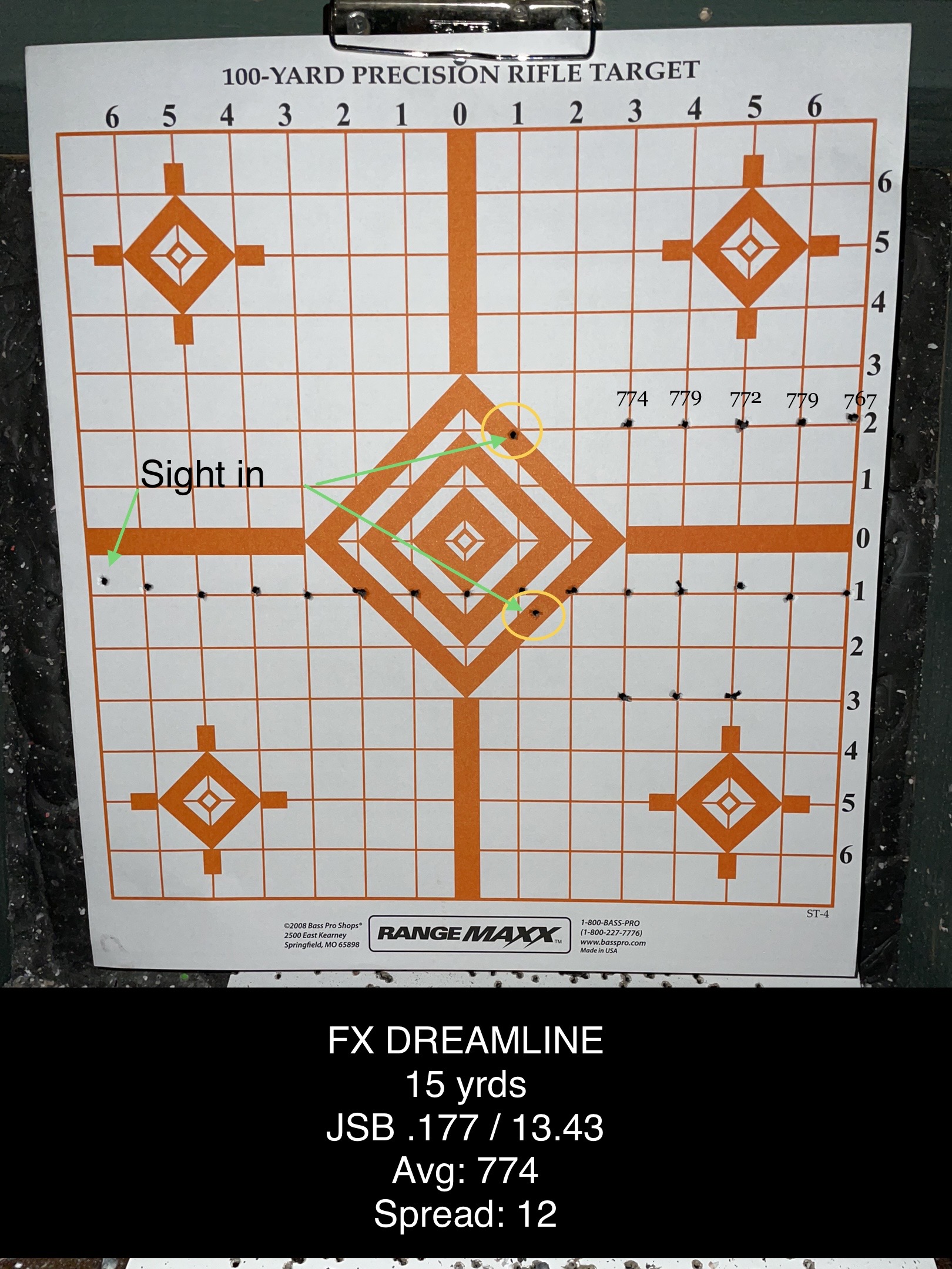

I’ve had mine for just over a year now. Ordered the .22 GRS version and have since put the .177 barrel on it. I‘ve been shooting springers for awhile and decided to blow the dust off the Dreamline tonight. Forgot smooth the action is And the trigger is much better than my impact.
Shot this tonight before dinner.
