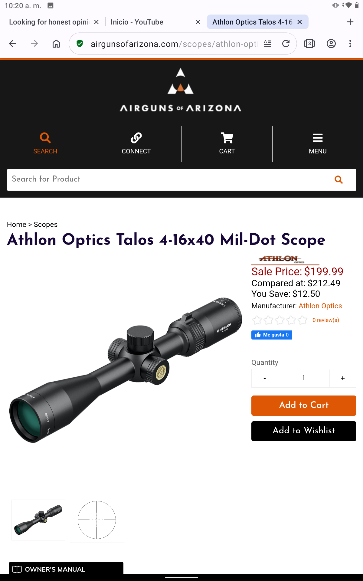

IMHO, the gun is too good for that optic. 24X is overkill and the higher the magnification on a budget optic, the more you will notice the failings. I would suggest moving up in quality and down in mag. Something like the element helix 4-16 FFP.
Quick question: I'm looking at the optic you recommended but I really don't have a clue what the different versions mean/which I would want. APR-1C-MOA, APR-1C-MRAD, APR-2D-MOA, APR-2D-MRAD ... if you have a moment could you maybe give me a tl;dr?
--HDMurex
https://athlonoptics.com/product-category/rifle-scopes/athlon-optics-rifle-scopes-talos/ Other than MOA and MRAD, yes, the reticle names are very confusing. Look at the various models, and you will be able to see the different reticles.

Moa/Mrad are the us/metric units for the reticle and 1C is clean crosshair whereas 1D (meaning dirty) is a Christmas tree reticle with 2D holdovers. Just google the terms for reticle explanations and pics. I use the 2D moa.
