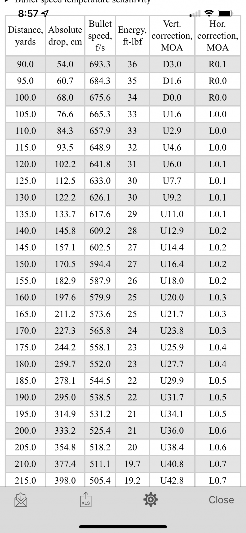

You really haven't given enough data to give you a great answer regardless but I'll try. With a 100yd zero, HOB at 2", BC of .040, and a muzzle velocity of 875fps....
150yd drop would be around 28" (18MOA) and 200yd drop would be closer to 85" (41MOA)

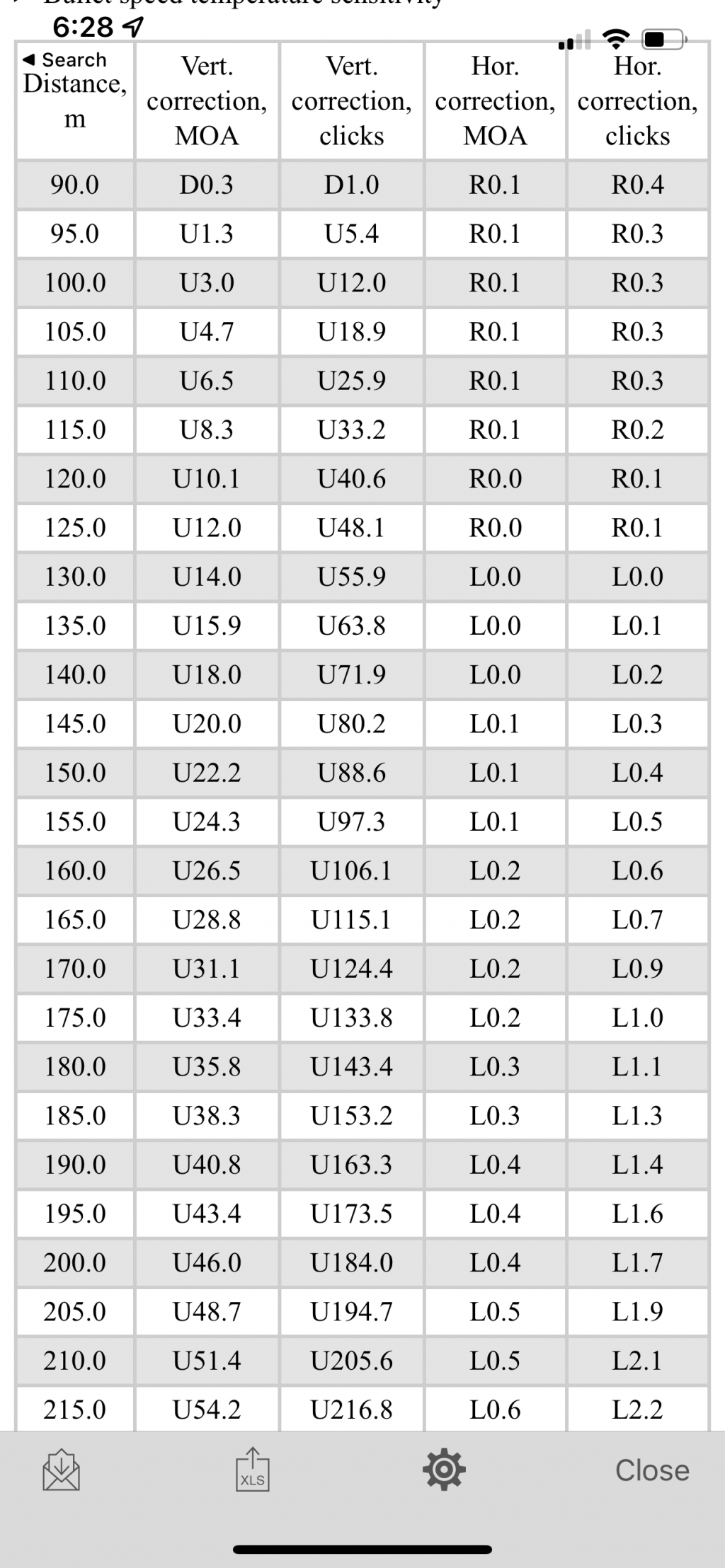

the table is assuming 5cm scope height, 100 yard zero distance, 20F zero and current temp, 50% humidity and ZERO wind so the horizontal spin drift adjustment is based on 1:22 twist rate.

Lol, I don’t even know how to interpret your graph. I’m used to using clicks to go up and down. Not MOAs…
I just started a brand new job at 59. I’m in the middle of trying to learn all the systems of a huge corporation. I’m not sure I could learn street lock right now…Yes, I saw the typo, to me it is street lock.
I would love to understand how I would look at that graph, and be able to figure out how much holdover either in centimeters or inches and then of course I could convert that into the clicks.

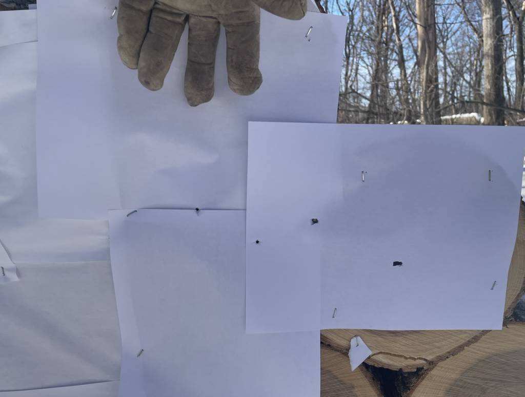

It worked great thank you. Usually I can shoot into something around the target like brush or dirt and get some idea of my point of impact.
Your calculations were right on. I only had 150 clicks. And I followed your math I would’ve been doing about 160…I was about 6 inches low. My hold is approximately where my fingers end.

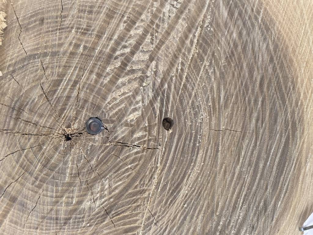

A pellet, next to a slug hole at 200.
