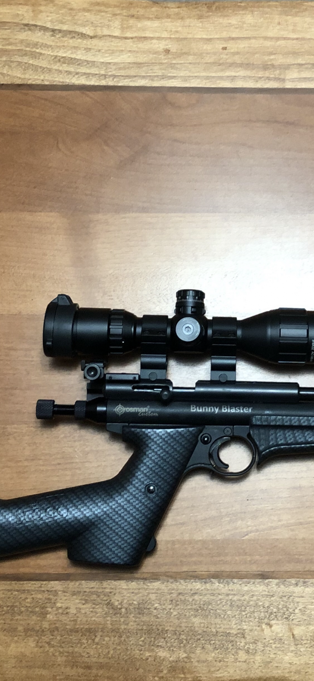

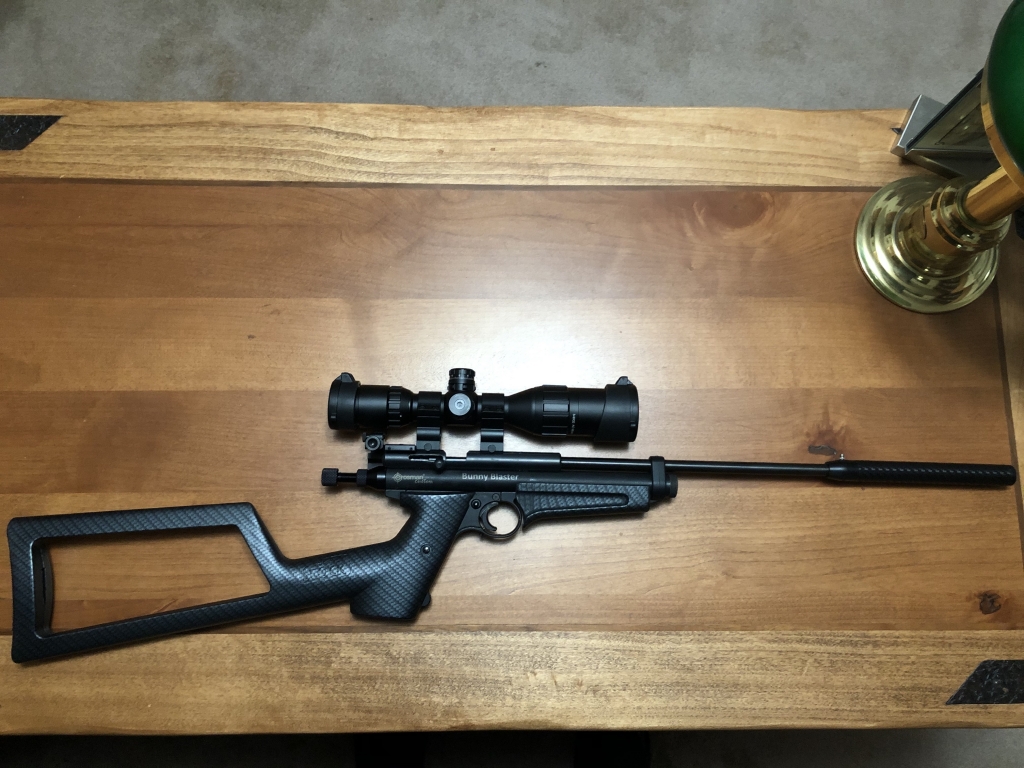

For me a Williams peep sight is strictly for a rifle and the Williams notched rear sight are for pistols. I have Williams peep sights on several rifles including my 2400KT which I have the peep sight mounted under a 3-9x32 BugBuster with see through rings. The setup isn’t for everyone but it works well for me. I like to shoot with both scope and iron sights and this way I can switch from one to the other as it suits me. As long as I remove the front scope cap I have enough clearance and field of view for shooting with the peep sight. I also have a long neck so the slightly more forward mount of the scope isn’t that uncomfortable for me.
I installed a SuperSear which really improved the trigger a lot over the stock trigger it came with. I recommend them and will be installing them in all my Crosman 13xx and 22xx guns from now on. Very easy drop in installation. Only thing better would be to install a marauder pistol trigger group.
I also added a power adjuster from Magnum AirPower. Which might be about the nicest power adjuster out there that I’ve seen. Haven’t had a lot of time to play around with it though.
