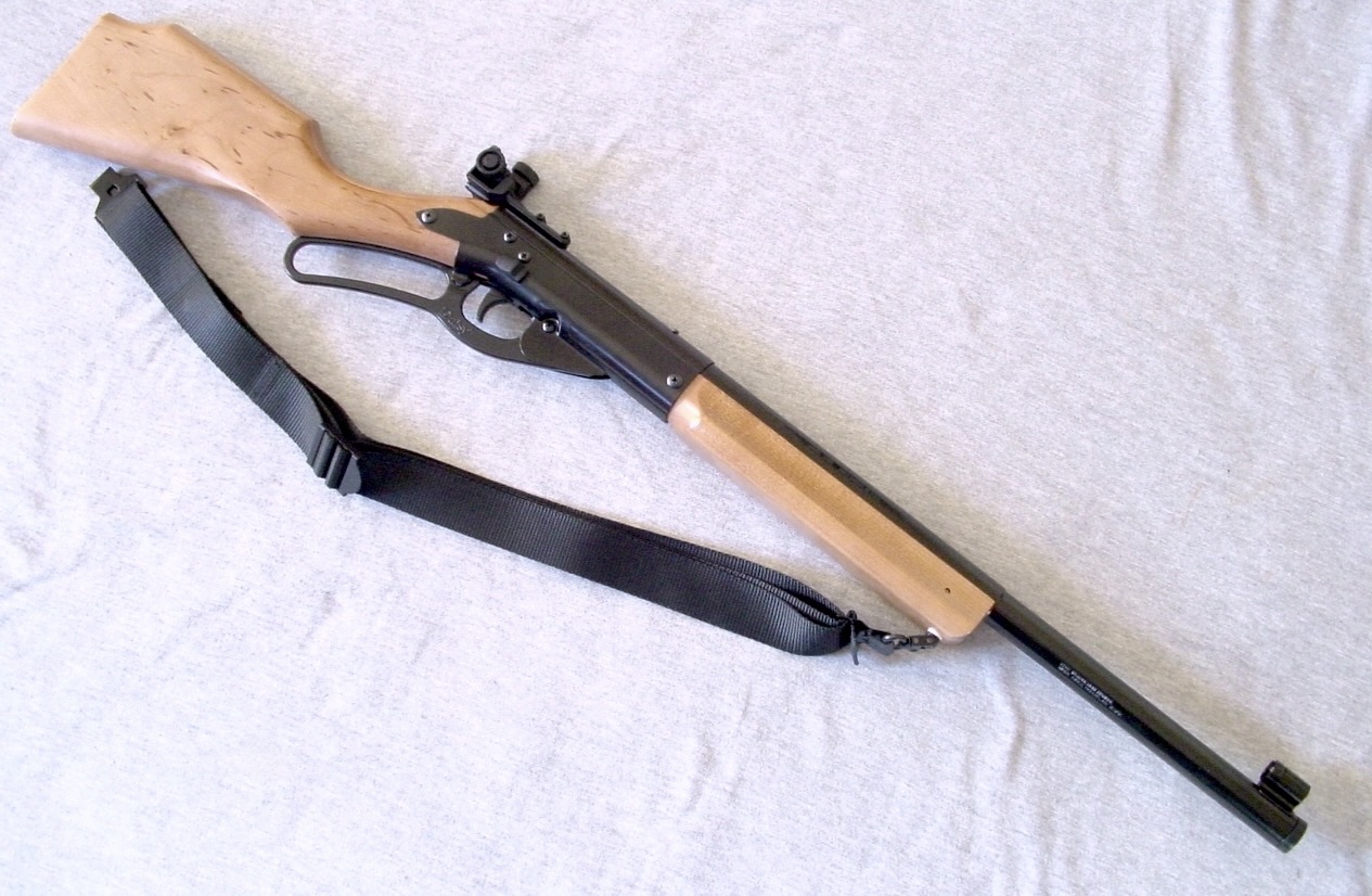

The 499B is a great rifle. I bought one from PA a couple years back. I set it up with the wider single point sling that comes with the Daisy/Avanti 753S, and I added 6oz of ballast to the ballast compartment on the inside of the forend to get some more weight further forward. Used small diameter lead shot mixed with epoxy. With Daisy precision ground shot it shoots through one hole at 10 yards. Most accurate BB gun I've ever shot.

I have a 499B. I set it up with the wider single point sling that comes with the Daisy/Avanti 753S, and I added 6oz of ballast to the ballast compartment on the inside of the forend to get some more weight further forward. Used small diameter lead shot mixed with epoxy. With Daisy precision ground shot it shoots through one hole at 10 yards. Most accurate BB gun I've ever shot.
AHHH to have that rifle 70 years ago , and lever action to boot !
I'd sure like to see a pic of those 10 yard groups, if you have one…
