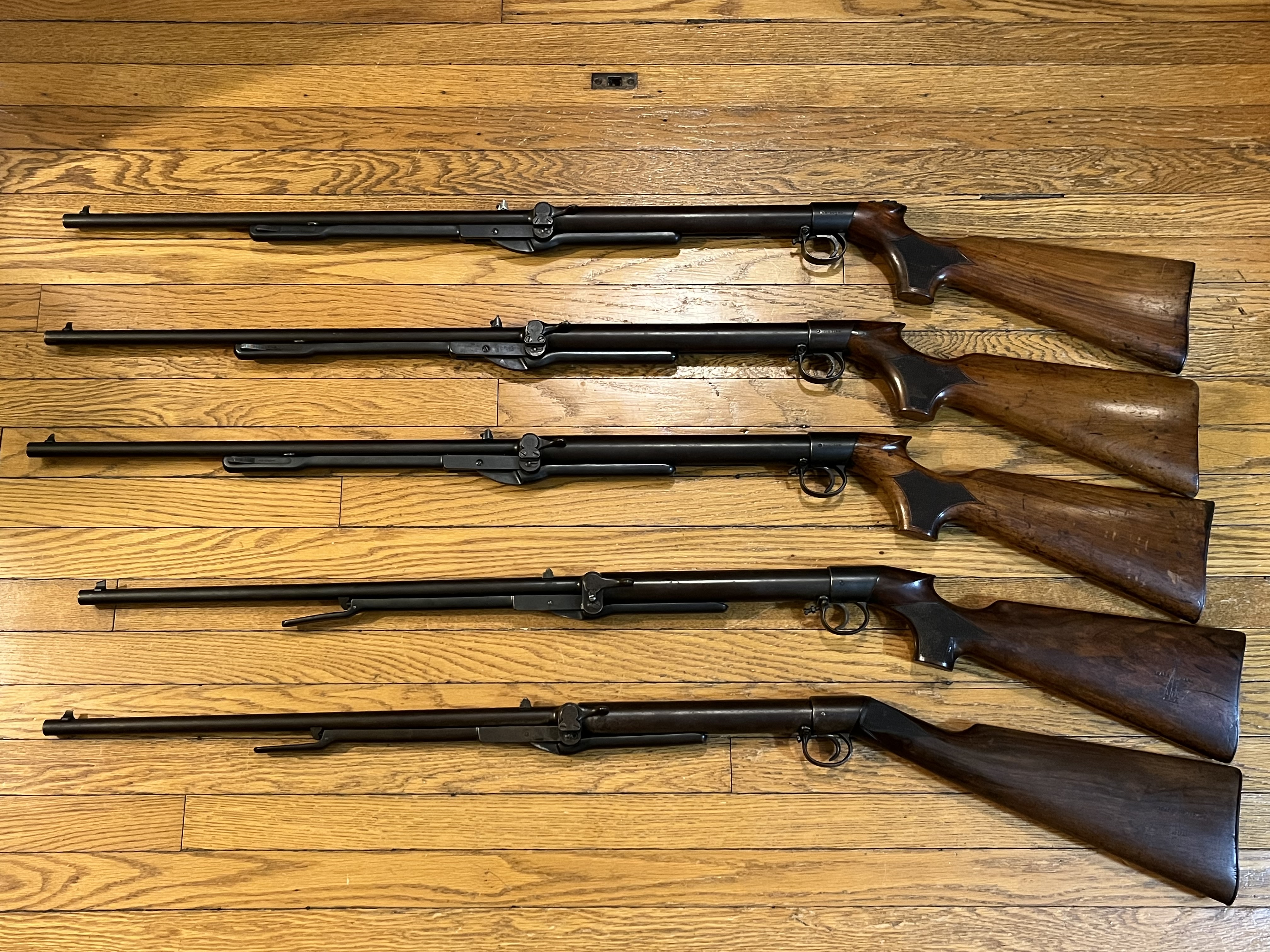

3 Improved Model D Sporting pattern and
2 “BSA AIR RIFLE”
1906 and 1907
Second rifle from the bottom is 1906 from the second batch of Bsa air rifles made.

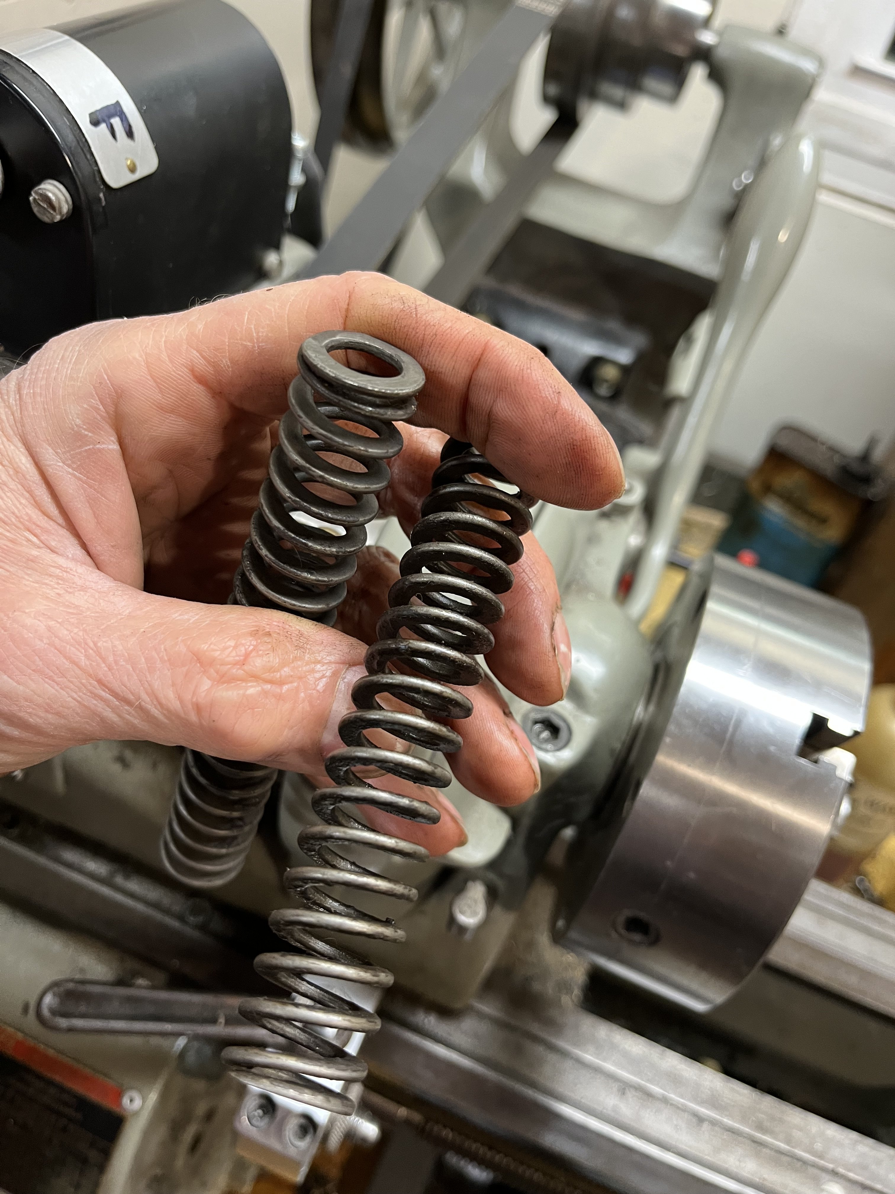

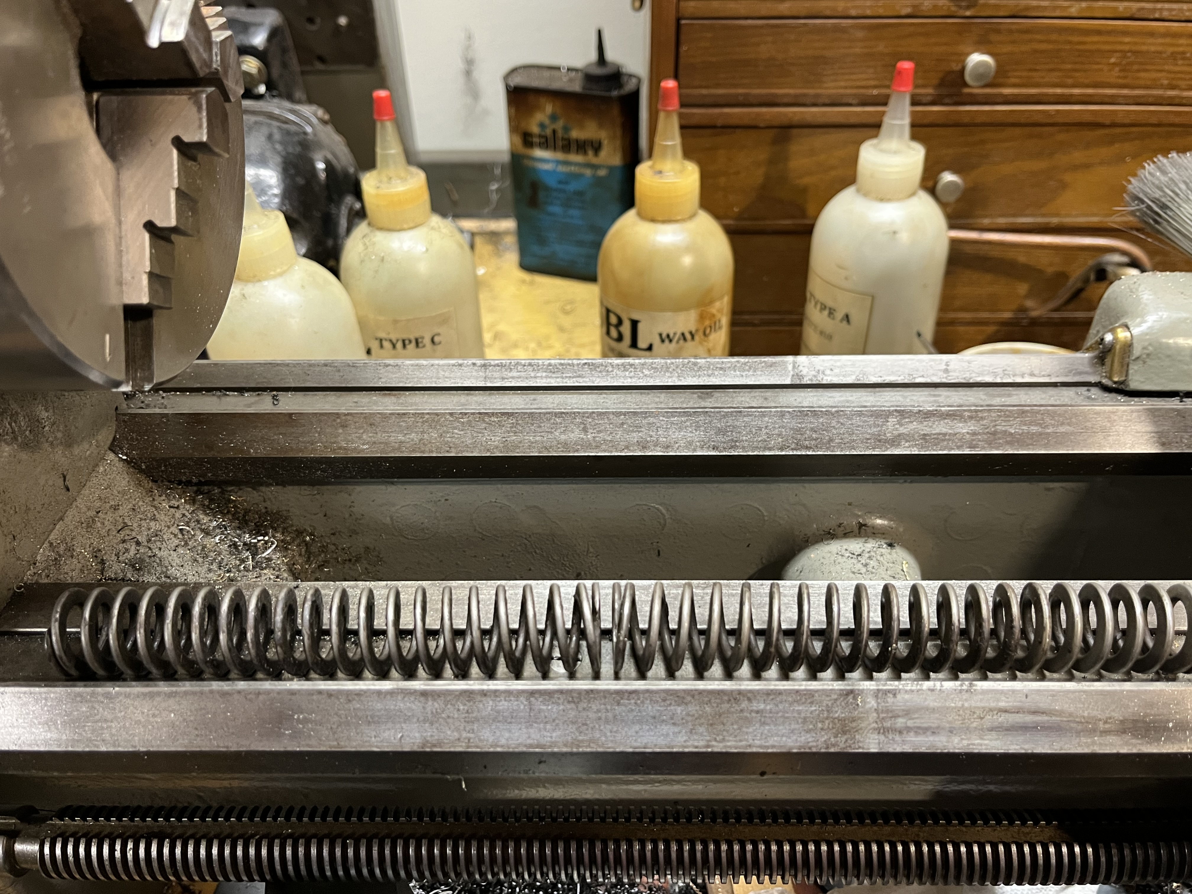

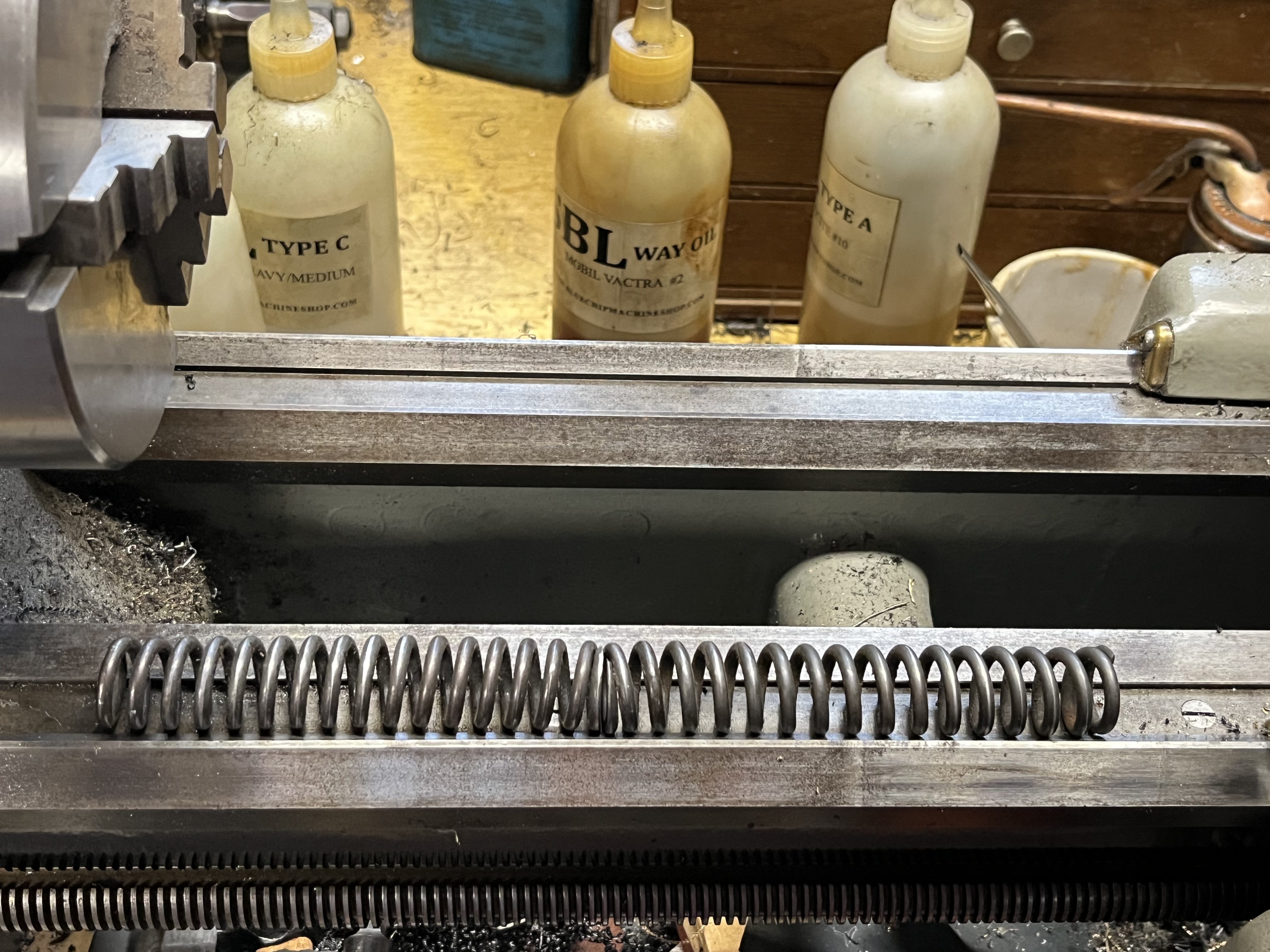

That should work. Might be a little soft. Sporting pattern can run up to 12 ft lb. The original are .134 counterwound dual springs.Yes, a side lever button. I found a .120 wire spring from an old TR Rob kit that came with my HW77 years ago. I shortened it to the same 32 coils that the original .132 wire was.
I just shortened the spring another inch, was worried about the preload. Shooting around 9 ft lbs.That should work. Might be a little soft. Sporting pattern can run up to 12 ft lb. The original are .134 counterwound dual springs.
are these springs attached in the middle ?That should work. Might be a little soft. Sporting pattern can run up to 12 ft lb. The original are .134 counterwound dual springs.

Noare these springs attached in the middle ?

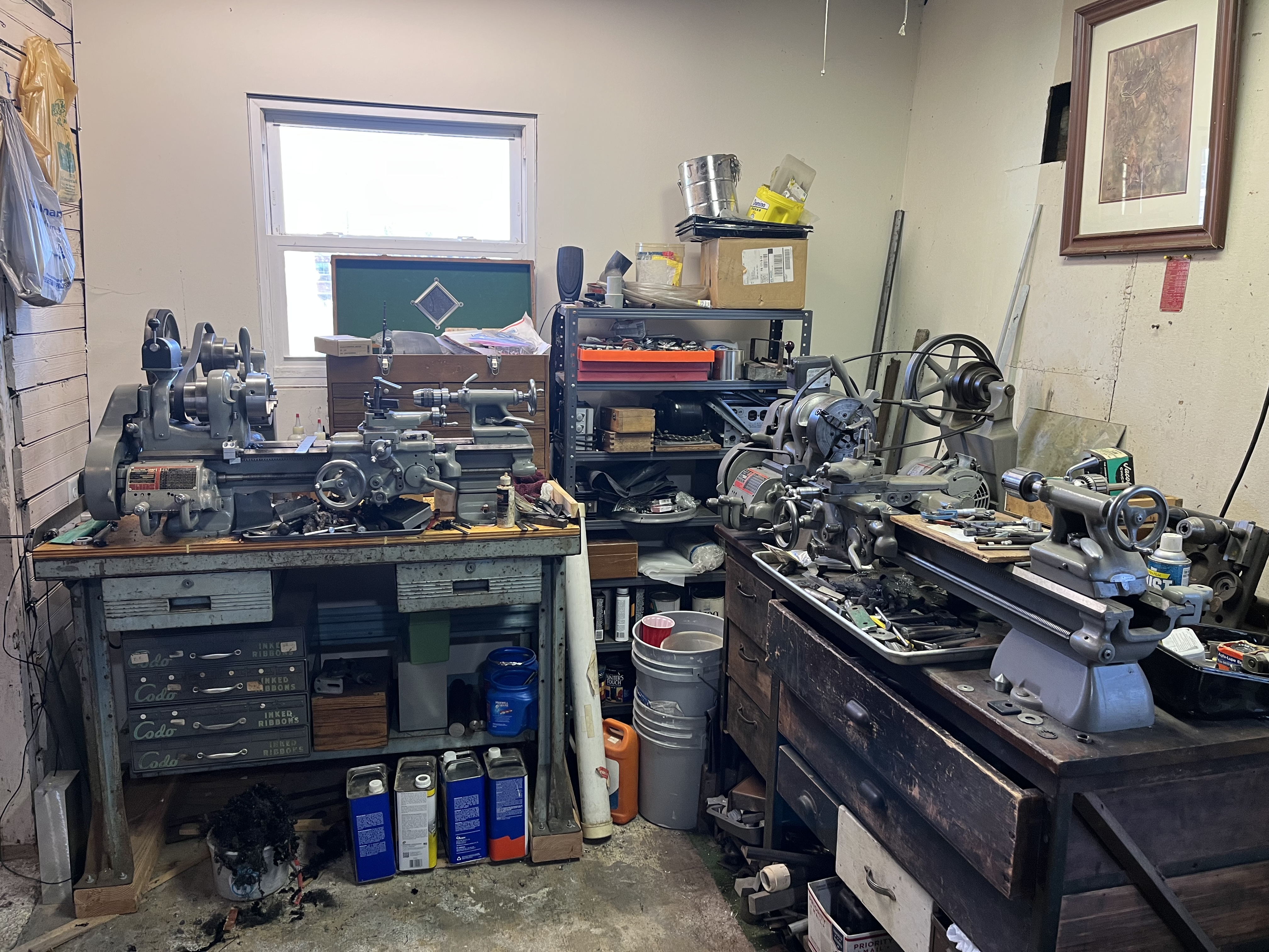

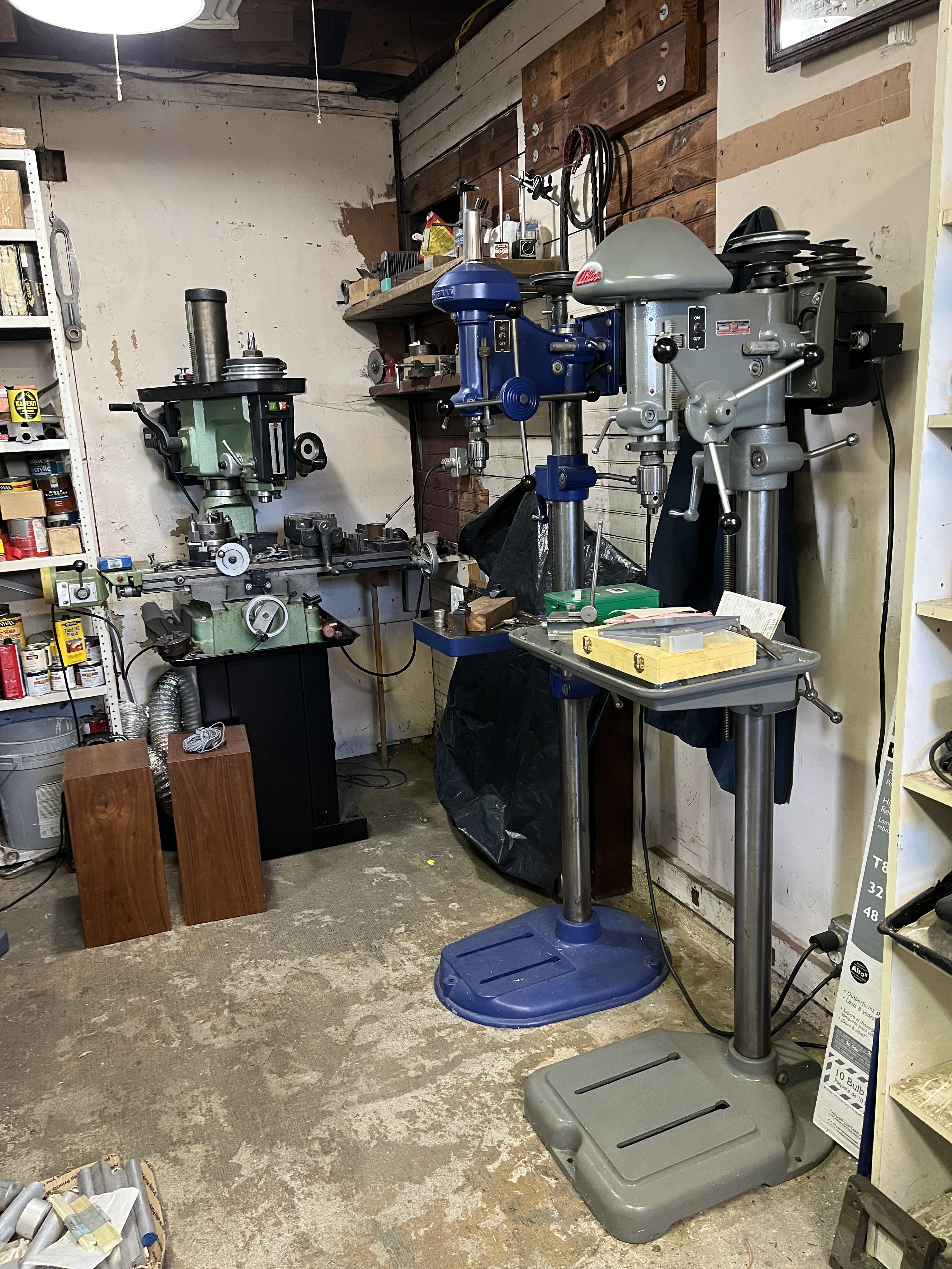

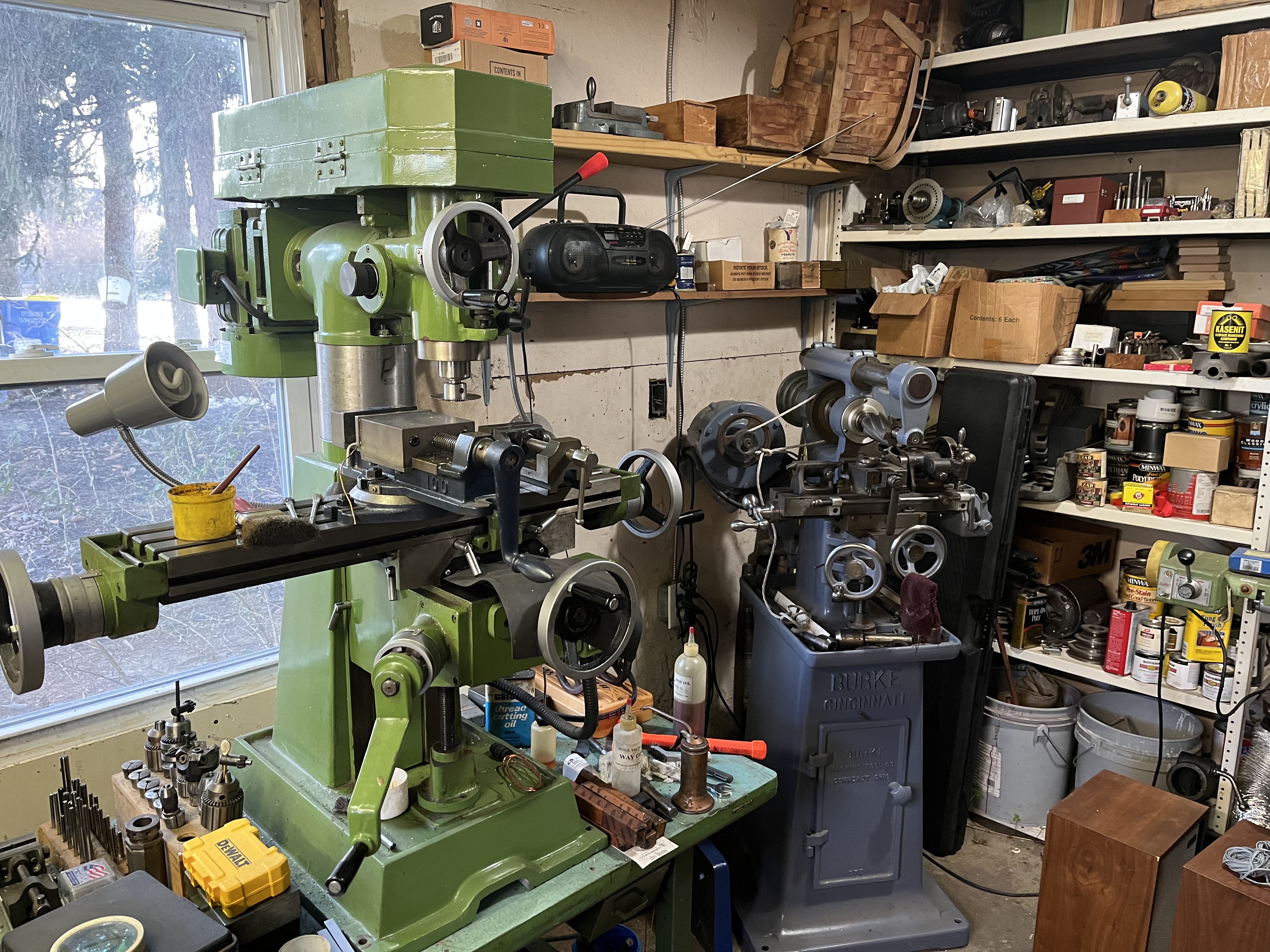

Karl impressive machines I will look thru my old lathe & mill tooling and send you some endmills, and lathe HSS, blanks and lathe carb cutter inserts. Remind bro I lots of tooling the govt paid for and I have no machines. Randy
Could always tell you had talent and experience from reading your posts. Now I see it!
